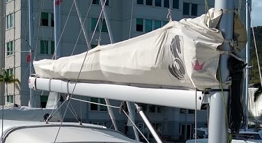

beside the rake there is a 6 or more inches of bend. When the sail is all the way up the boom does not sit as high as i would expect. so the stack pack and lazy jacks remain tight.
Here she is at the dock, the boom sits in about the same place under sail. Soon there will be two more 38.1s in my harbor so I will be able to compare. I'm wondering if anyone with a similar rig would say theirs is straight as an arrow. I never had a in mast roller, but i would expect them to be straight, so why not my rig?

A furling mast needs to be straight to accommodate the furling mechanism, so the structure of the mast and the cut of the sail are are pre-built for that assumption. A conventional main is cut very differently, with extra cloth in the luff to accommodate mast bend instead of a hollow there to furl tighter.
Looks like your boom sits pretty much horizontal. I would not expect it to move above that angle once the sail is raised. Having the boom above horizontal would just mean there is wasted area that would be better used as sail.
I’ll defer to any with more stack pack experience to say what adjustments may be possible there, but I don’t think the mast bend or sail are the problem.

The boom height in the picture looks about right..but that's not while it's flying...so hard for me to really say. Boom height is a function of the mainsail leech length and also rake...
