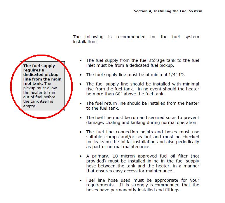

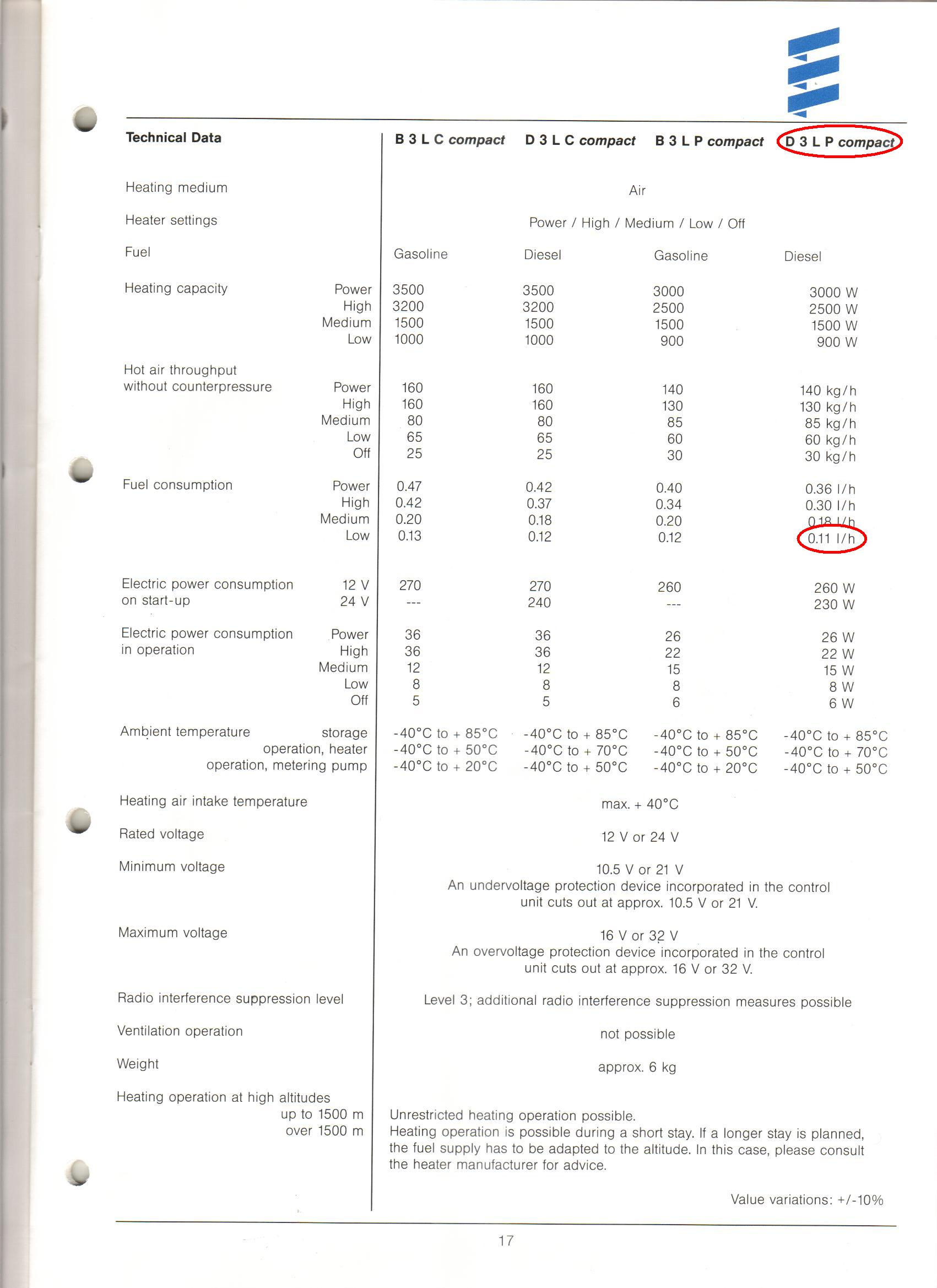

Joker460 - yes, that would be the best location, but the previous owners installed a secondary diesel tank there for the Hurricane heater.
I've got to wonder why the PO installed a separate fuel tank for the Hurricane heater unless he stayed in the Arctic as a live aboard .
Looking at my Espar heater for a comparison, I rarely go above low heat once the boat interior is warm and we're out late in some pretty cold and wet weather. I burn a little over 0.11 l/hr. Your boat has a little extra volume so you might burn 0.20 l/hr. as a worst case.
I see that Hurricane Heaters (both space and hot water) have no problem with taking fuel from the main tank.
Given this information, I would consider removing the heater tank (which is wasting space) and using that space to install your extra holding tank.
