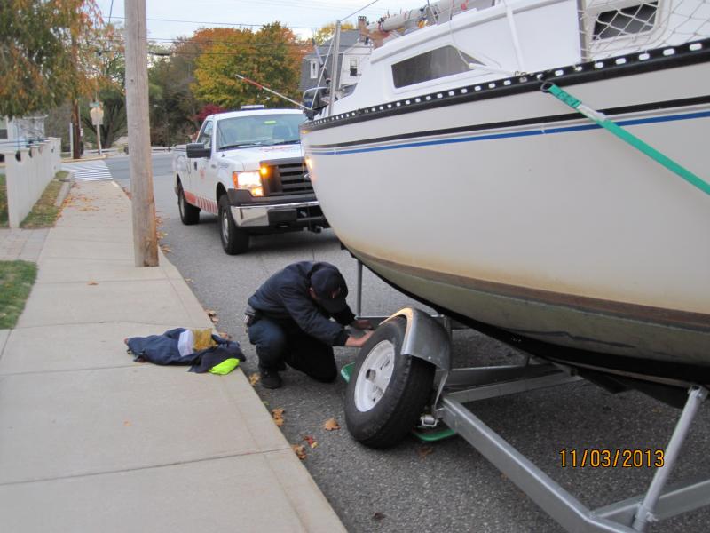

Well, it's the end of another sailing season here in southern NE for me, and time to haul out the boat (1981 H22 swing keel). On the way home with boat on the trailer I notice a billowing cloud of smoke around the right wheel. This trailer is an original (Magic Tilt, single axle) and I'm the 4th owner. Pulling over to a side street, I see the right wheel suddenly and magically "tilts" inward. I wondered if THIS is what is meant by a "Magic Tilt" trailer.. naahhh, couldn't be. :-}

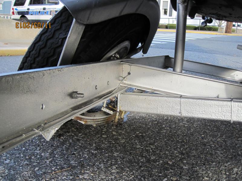

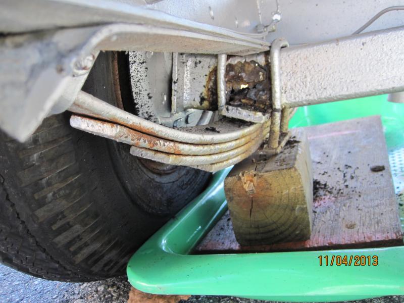

Upon further inspection, yes you may have guessed it, the axle failed... right under the leaf spring u-bolts area. It had rusted through inside to out. I kept up with visible rust control & painting, and the trailer only saw salt water 2x / year: launch and haul out. I have yet to take any long trips with it, and am content to sail on Long Island, Fishers Is, and Block Is sounds. Saying something like 'OMG' comes to mind now, but what I ACTUALLY said, I'll leave to your imagination. And to think that I was only ~200 yards from my street... Home sweet home was beckoning to me and my now lame trailer.

Do you have a photo showing the damage to the trailer?

"Damage pictures"?? ... yes, see the original posting.

Yes the leaf springs ARE shot...I may not stop there. Call it overkill, but a 32 yr old trailer could be hiding some other secrets that I am not able to detect.

SeaTR: From the deep pitting beneath the trailer paint that you probably put on, I understand why you do not want to rebuild it. My 1974 Clipper Marine trailer was deeply pitted like that and I always worried about it even with 2 axles. I also completely restored the boat but not the trailer.

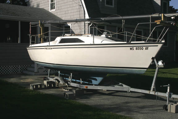

Maybe try to find a dual axle fresh water trailer in the local boat salvage yard and have it modified for your boat. A good welder would take the specs from your existing trailer runners and make it up. The picture of your boat/trailer indicates it might be a pretty straightforward job.

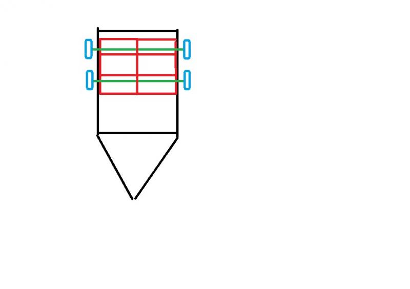

SeaTR. I'm not sure that the axle that broke on you is the original. It just doesn't look right ware it attaches to the dust cover of the hub. It kind of looks home made... Another clue is the plate that the spring is attached to... What is that for? I've always welded the spring shackle/holder directly on to the frame. Never to some other piece that is bolted on.
I think your going the right direction with repair.
I'd go with a double axle myself and weld it to another sub frame (Box) that gets bolted inside the one there now. This will keep the wheels strait and allow for any twists the frame may have. It will keep the trailer the same height as well.
See drawing. The axles go under the sub frame. Place the subframe so it is strait.

c-channel...AND it's a bit twisted from the ordeal.
At least you can be sure of no hidden internal rusting with the c-channel. Looking at the pictures: l wouldn't hesitate for safety on replacing/welding on new leaf spring brackets and
Unfortunately, i don't have any experience on new sailboat trailer recommendations. BUT Take comfort in your remaining pieces of the trailer. They look to be in GREAT SHAPE. If there are any other design deficiencies, those can certainly be adressed as well while still WELL under the cost and headache of new or retrofitting a different trailer.
