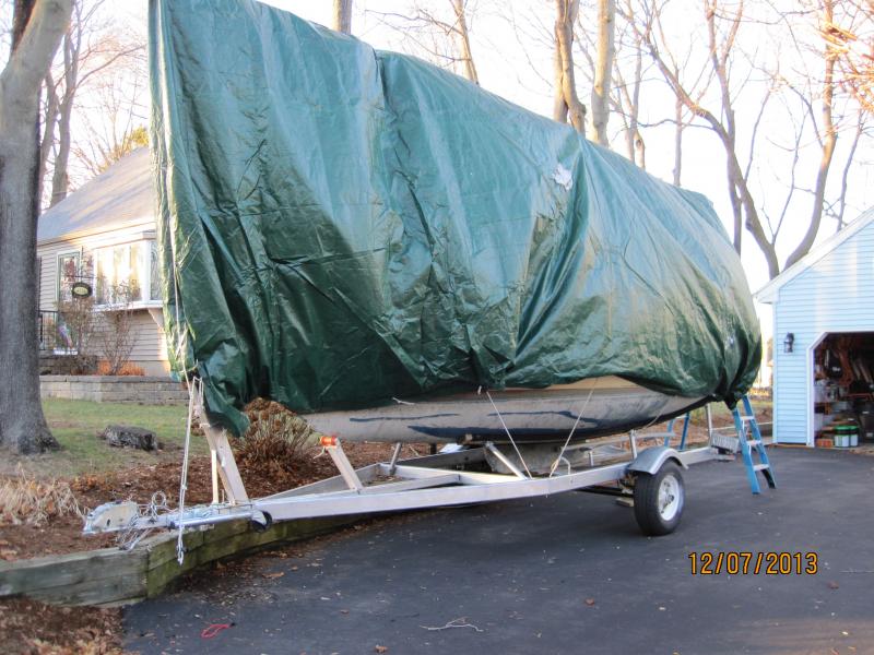

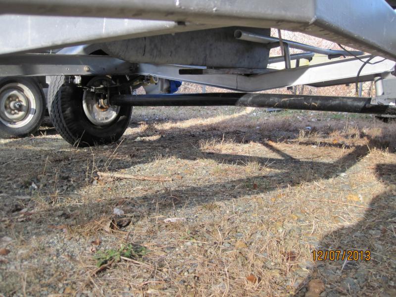

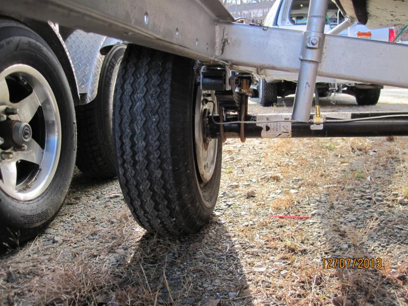

Chief, thanks for your input and perspective. The more I look into the 'new trailer' idea, and balancing out the existing 1981 Magic Tilt trailer's overall status, the more I'm convinced that axle and leaf spring replacement is the right way to go. The pitting that you see under the paint is associated only with axle. Glad to hear you had a (seeminglly) good time in Bodega Bay (10 days).
Apex, thanks for your assessment (..."(trailer) look(s) to be in GREAT SHAPE"...)as well ! Maybe I've now gotten over the initial shock of the event.
It's all about the threshold for taking on risk, I suppose... E.g., I received additional quotes from some of the 5 manufacturers. They were in the $4,000 - $7,000 range, including delivery for a 3000#, single axle, galvanized, bunk, with surge brakes. It's surprising the difference is prices (keeping in mind that some of the higher prices were due to delivery from the factory, as opposed to having the trailer shipped to a 'local' dealer and not paying delivery fees directly).
rgranger, nop, I want to stick to a single axle...for now, unless there are compelling reasons for the dual axle for my 2600# 1981 Hunter 22' swing keel boat.
Dave, check your email...
All Ya'll,
Thanks for taking the time to chime in !! Each of your inputs are helpful to me in response to this 'event'. I had a heck of a time TRYING to get someone lined up to SAFELY load both trailer and boat onto their flatbed tow truck...and STILL haven't had it moved from its breakdown site yet !

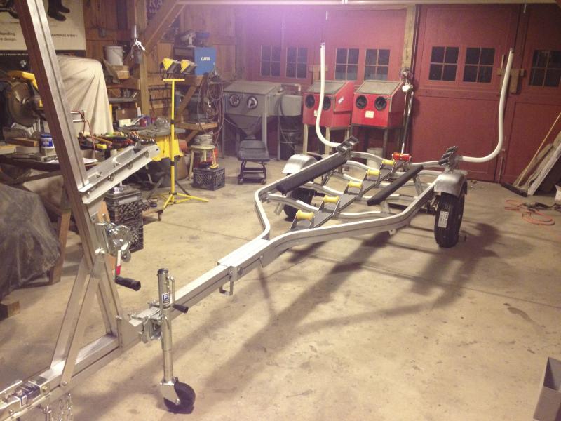

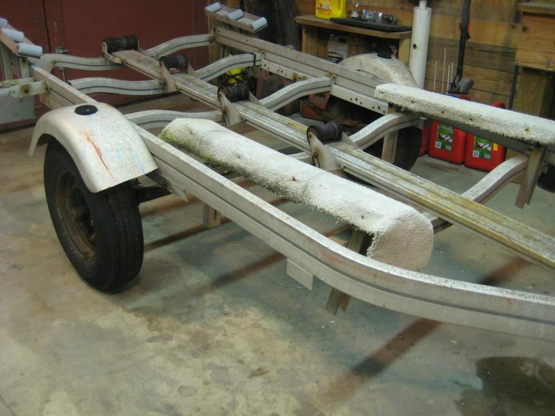

The bad news is, you can't see inside the axle to identify any rust problems. The good news is, you can identify any rust problems on the frame as it's c-channel and it's all visible.
From what I can see, the frame looks fine, but to make sure, I woulld examine every inch.
If the frame is ok, a set of springs,u-bolts and an axle with hubs is probably less expensive than you think and installation is pretty straight forward.
Probably well under $500 for everything.
On the other hand, a decent trailer, $2500, 3000?. And then there's the work to get it set up for your boat, which can be a pia. I'd rather replace the axle than set up a new trailer.
I got a aluminum trailer, [1969] with my O'Day, and was thinking it was scrap metal. Then I started pricing trailers, and the same aluminum trailer is $3000-3500 today.
I replaced axle, springs, u-bolts, all the rollers, jack, winch and the padded boards for less than $1000. Including the new taller winch support to hold the mast.
The math seemed pretty easy to me.
[sorry, shots are "after" then "before"]

Well the axle, U-bolts, leaf springs and both wheel cylinders have been replaced. The boat now rides a bit higher (~10") than previous...which I like. It's good to get boat and trailer back home again.
Thanks again to all for your input. Merry Christmas and hoping you have a great sailing year in 2014!
