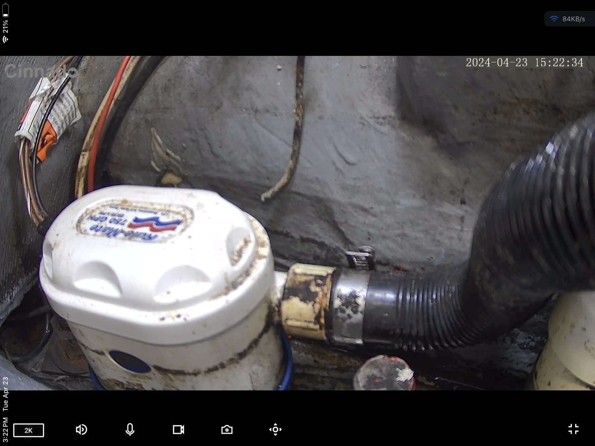

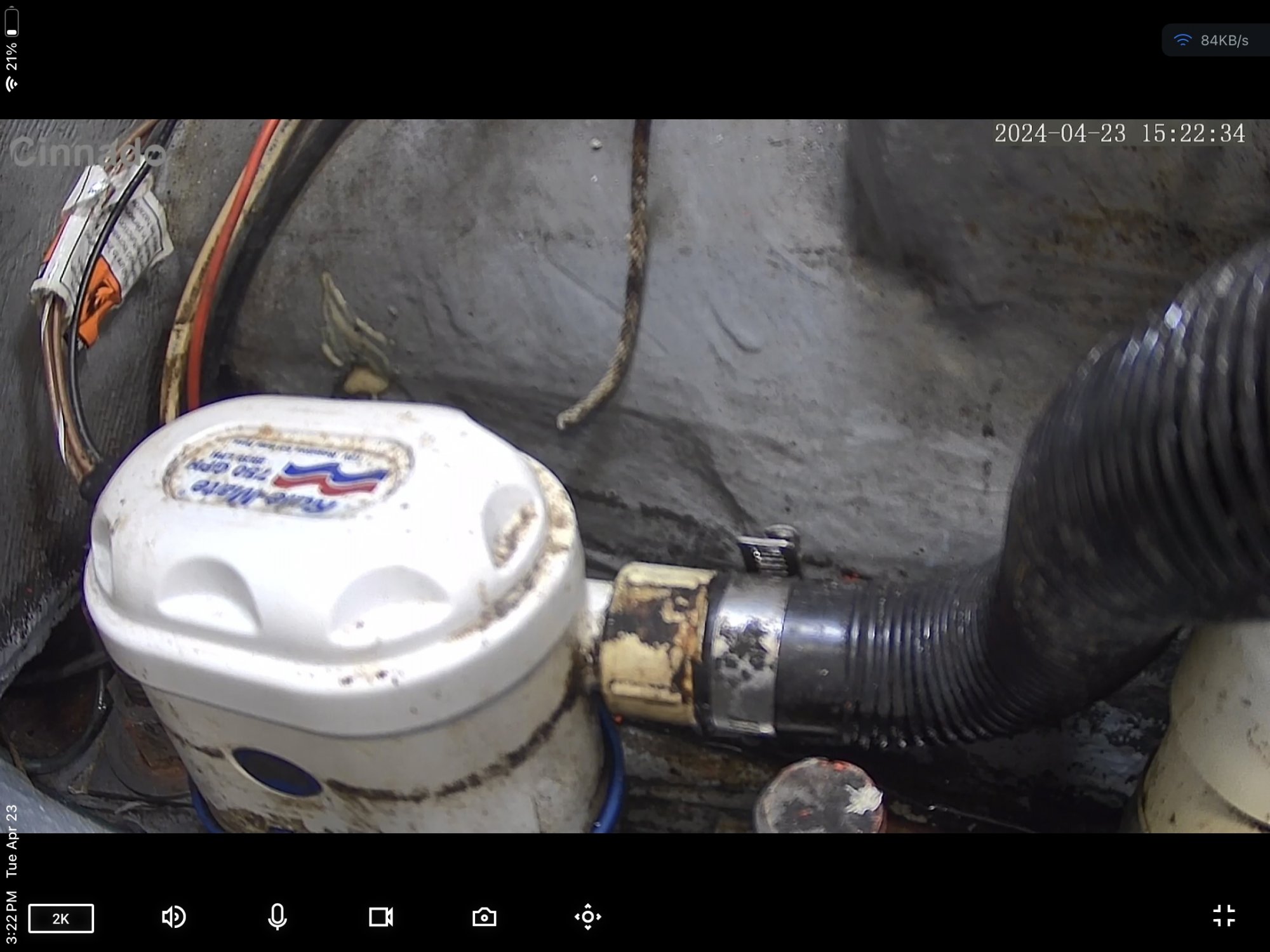

While I was at the marina I installed a wifi surveillance camera that I bought for my house….you can connect to it where it is, as long as you have wifi there….
Every year when I launch Tally Ho, I get a lot of water in the bilge….I have no idea where it comes from….thruhulls are closed, no water around the various transducers…maybe rain water trapped in the pan…
So when I left yesterday, I set this camera down near the bilge, and I was able to monitor it for several hours. I could see the water rise to the line on the bilge pump, hear the pump kick on, see the water level drop and then slowly fill up again. But being able to see the pump do it’s thing made me feel better :cool:
The camera has infrared so even at night in the dark, I could see a black & white image of the bilge.
Today, after going to the marina and checking thing over, I used a shop vac and sucked the bilge dry….
and this afternoon ( photo was taken around 3:25 this afternoon)….bilge looks pretty dry :)

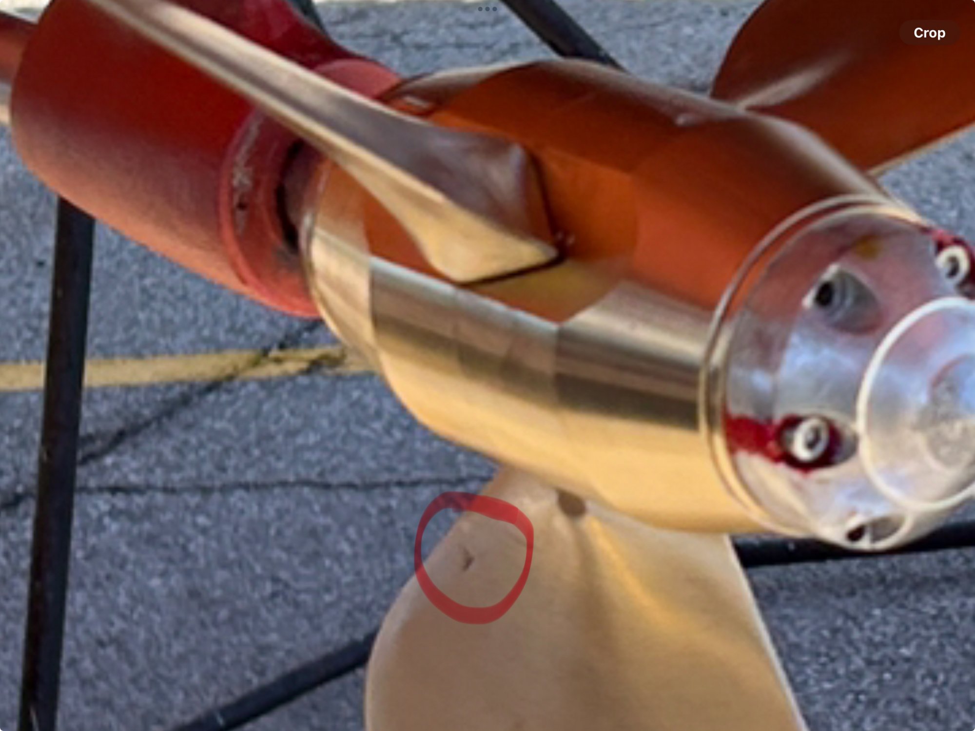

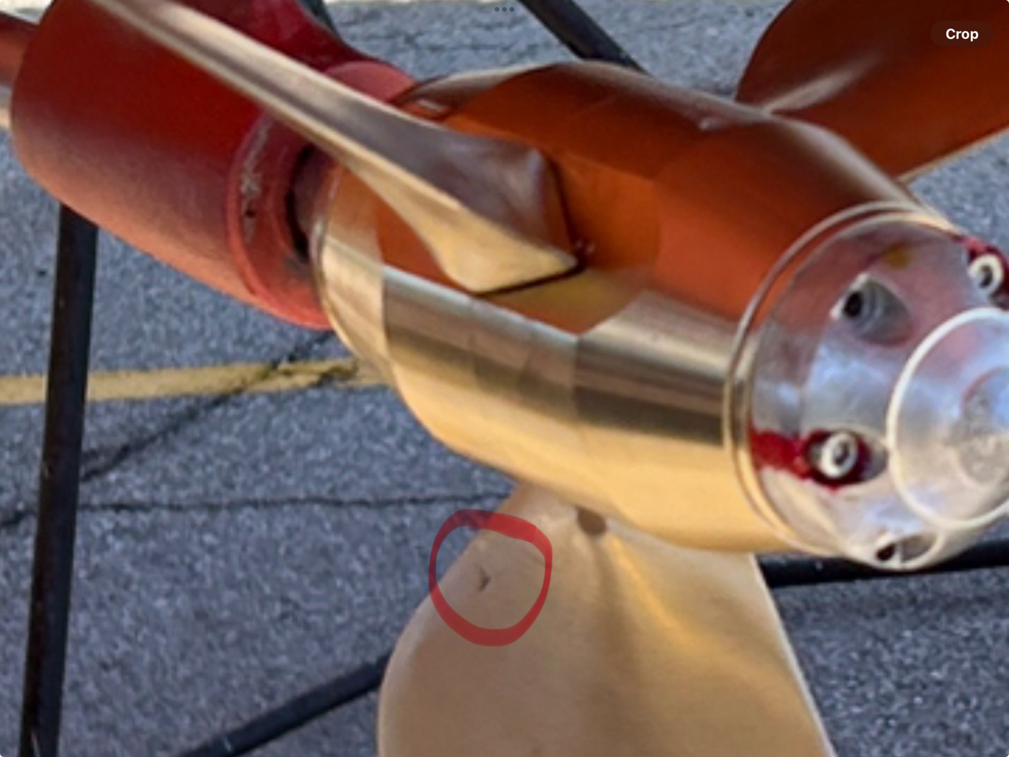

Fred gave me the best clue (wish I knew it before I launched) that the little triangle arrows on each blade are supposed to point AFT when the blades are feathered.
As can be seen in this closeup, the arrow is pointing FWD :banghead:
Oh well, if I can get hauled and hang in the slings a few hours, I am sure I can get it right !

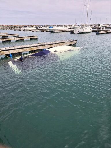

The problem is that it says O'Day on the side of the boat ;) Mine will stay dry for a few days and then fill with water for the rest of the season.
This guy had a very bad launch day at 31st street yesterday. I'm not sure who's responsible for the plug but it wasn't installed

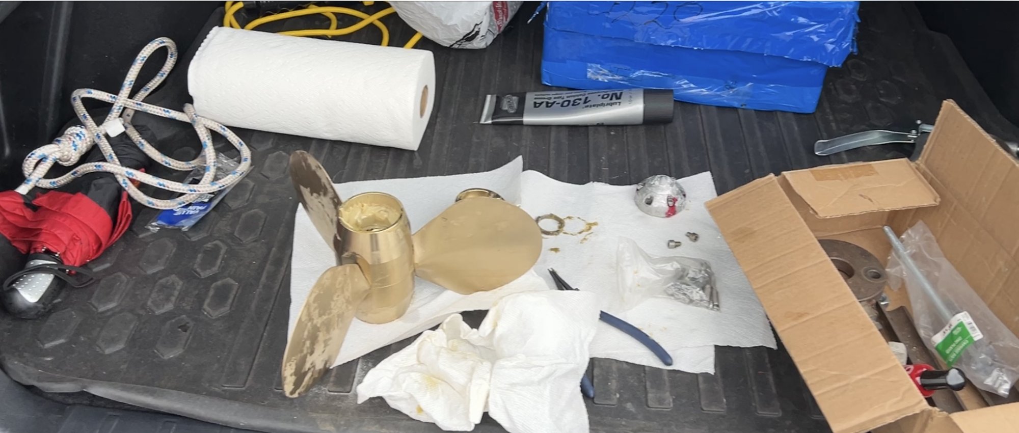

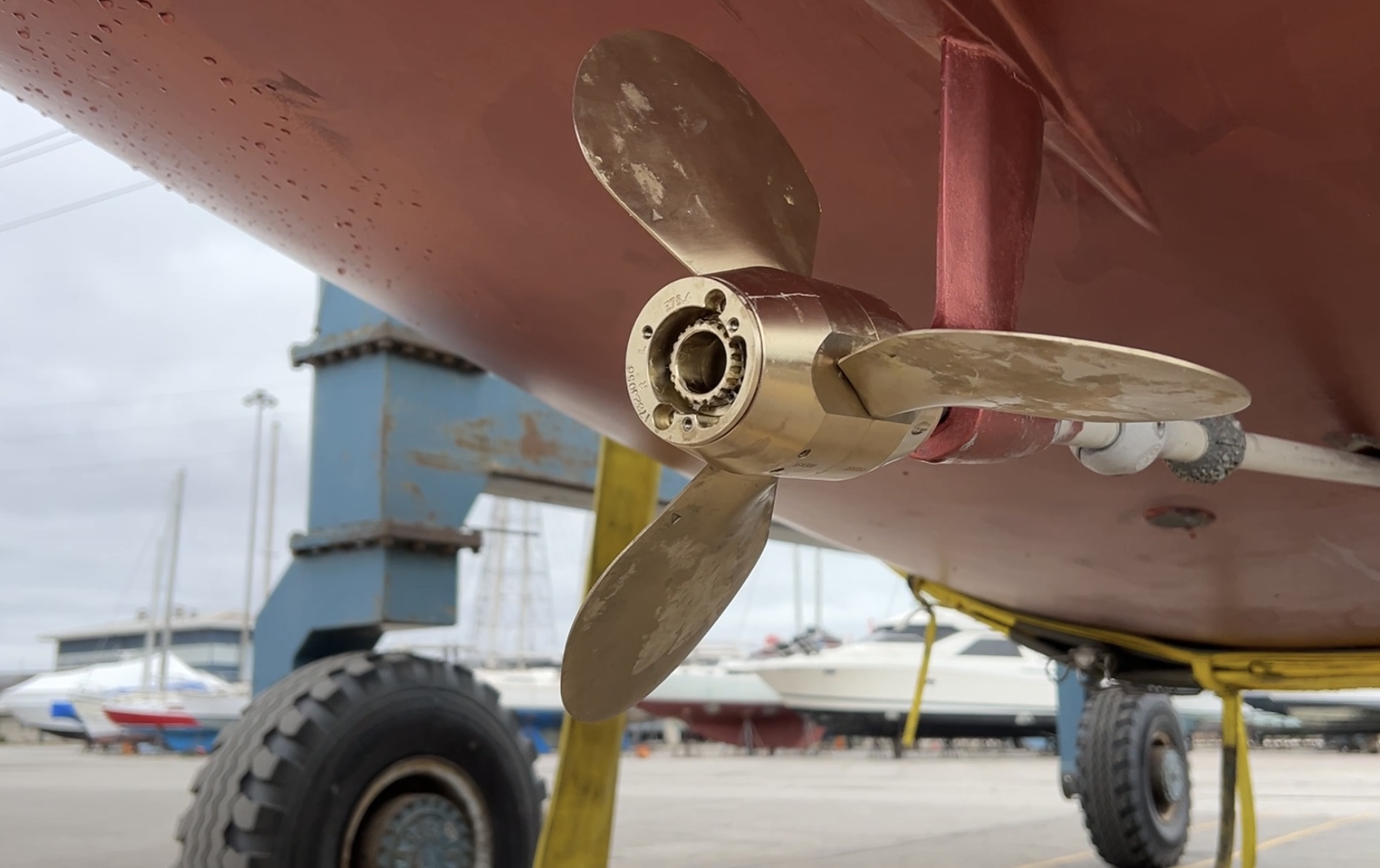

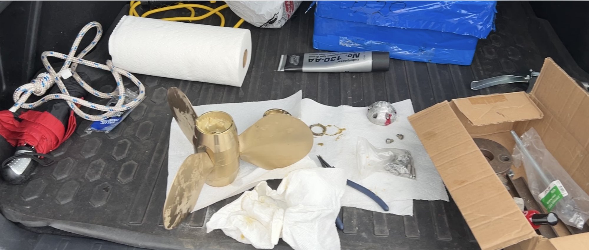

Happy to report that the marina hauled me out this morning around 10:30, and left me in the slings for an hour. I had all of my stuff ready to go and was armed with information after watching the PYInMaxProp disaaembly/assembly video a few times last night.
My prop pulled would not fit on this prop, but the prop comes apart, leaving only the spindle on the shaft…so I could reassemble everything pretty much right on the shaft. I did not need to open the body of the prop or remove the blades (which might have been a pain to reassemble without octopus arms). I did call Fred at PYI once to ask about separating the 2 halves of the body (his video didn’t show any screws holding the 2 halves together, but mine would not come apart…the 3 screws are new, and not in the video).
My mobile workbench
Getting the circlip on was the worst part. Had to remove almost off the grease in the body before I could get the circlip fully in place… not something you want to come off (although I think the prop nut would keep the thing from coming off completely)…

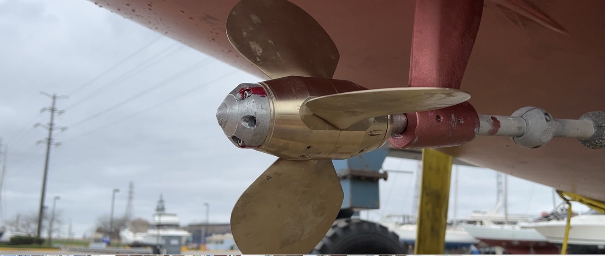

All done and ready to put Tally Ho back in the water…
I had the lift operator hold me in the sling so I could power forward and see if it felt “right”…sure didn’t want to pay for another lift (and it was blowing a stink today and I was solo…so getting into the slings was a real treat…and I didn’t want to attempt that again either).
Difinitely had good bite in the water (FWD and REV) once the prop was on right! The pitch seems pretty right on…Seemed like I could get higher revs without blowing black fuel out the exhaust. And boat speed was 6+ knots in not smooth conditions…

I notice you've got two zincs on the shaft, forward of the strut. And that LOOKS like a big heavy zinc on the end of the prop. Are the shaft zincs required now ?
Yes. And those had best not be zinc. In Chicago they should use Aluminum or Magnesium. :beer:
PYI says to keep the anode on the shaft, and they provide the big cone one with the prop.
I sure don’t want a $3000 prop eaten by galvanic corrosion, so yes, I will keep 2 on the shaft (I replace the oldest one each year). I will see how the cone anode hold up after this season.
