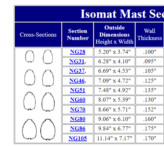

I know it depends on a lot of variables to include spar height, but does anyone know the nominal wall thickness of an aluminum mast? The estimated height of my mast is 34'. I do not have any other dimensions but just trying to get a nominal wall thickness. My uneducated guess would be about 3/16".

...............it depends on a lot of variables to include spar height, but does anyone know the nominal wall thickness of an aluminum mast?..............

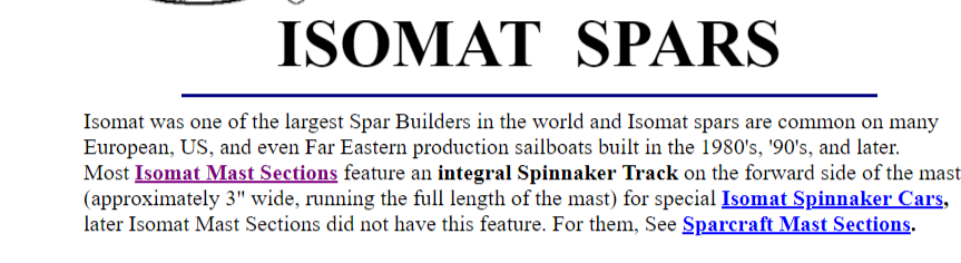

You are correct mast thickness depends on many variables. For example, take a look at Rigrite's mast thickness dimension tables in the link below as you might be surprised at the thickness depending on mast type (e.g., traditional, mid-ocean racing class, high performance, cruising, in-mast furler), shape and outside dimensions.

Thanks for the links. I looked and could not find any info on wall thickness, but I guess I was not asking Google the right questions.

Brian, left click on Isomat Mast Sections and you will get the table below.
