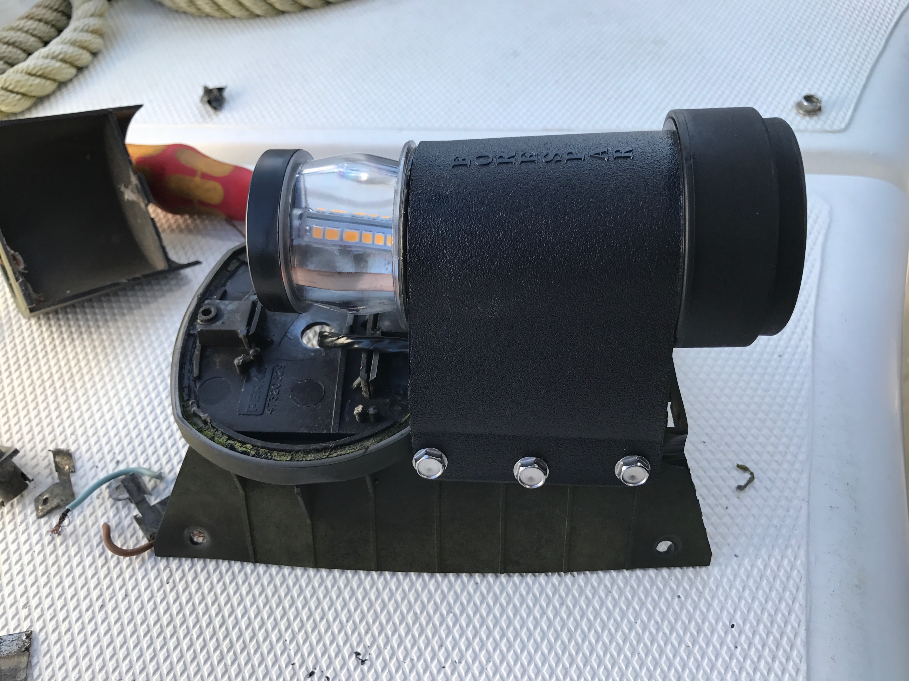

I just had good weather and time to install this deck/steaming light LED combination in post#7.
The Good News...
The light appears well built and as advertised.
The Bad News...
The mounting bracket (which is moulded part)...WON"T mount.:mad:
It won't conform to any large masted boats. My guess > 25' sailboat mast.
Plus it must have newly tapped holes in your mast, to conform to its mounting bracket.:doh:
Then leaving the old mount screws to "plug" the old mast holes.
My non elegant solution was to mount the new light to the old bracket.
I used the stainless self tapping screws that I was going to use to mount to my mast, to mount new light to old bracket. Mounted so easy and doesn't look ugly from 20' above deck.
Jim...
