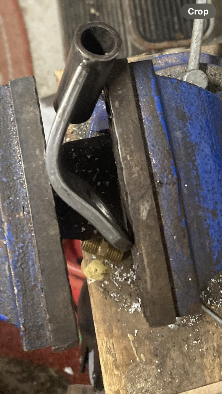

It turns out the noise was not coming from where the boom meets the mast. The pin that goes through the bracket securing the
Forespar Yacht Rod Boom Vang to the mast seized, preventing the bracket from swiveling as the boom moved across the boat causing the bracket to bend see attached picture. The noise was the rod of the boom vang rubbing against the bracket. I'm planning on calling Forespar on Monday to see if they still sell the parts. If not, any suggestions on who might sell used parts?

Wow. It’s nice to discover the problem. Bring the sound of silence to your boat.
You may not be able to find an off the shelf solution. I would seek a local machine shop. Ask them to build one.

Hello All, As it turns out the swivel and bracket for my Forespar Boom Vang are not OEM parts. I was able to have the swivel
reinforced. I want to make sure I reinstall it properly. However, there is no user manual on Forespar's web site, I also called and have not received a return call back. If you know where else I might obtain one or have one can you send me some pictures of it so I can see how it is attached.
