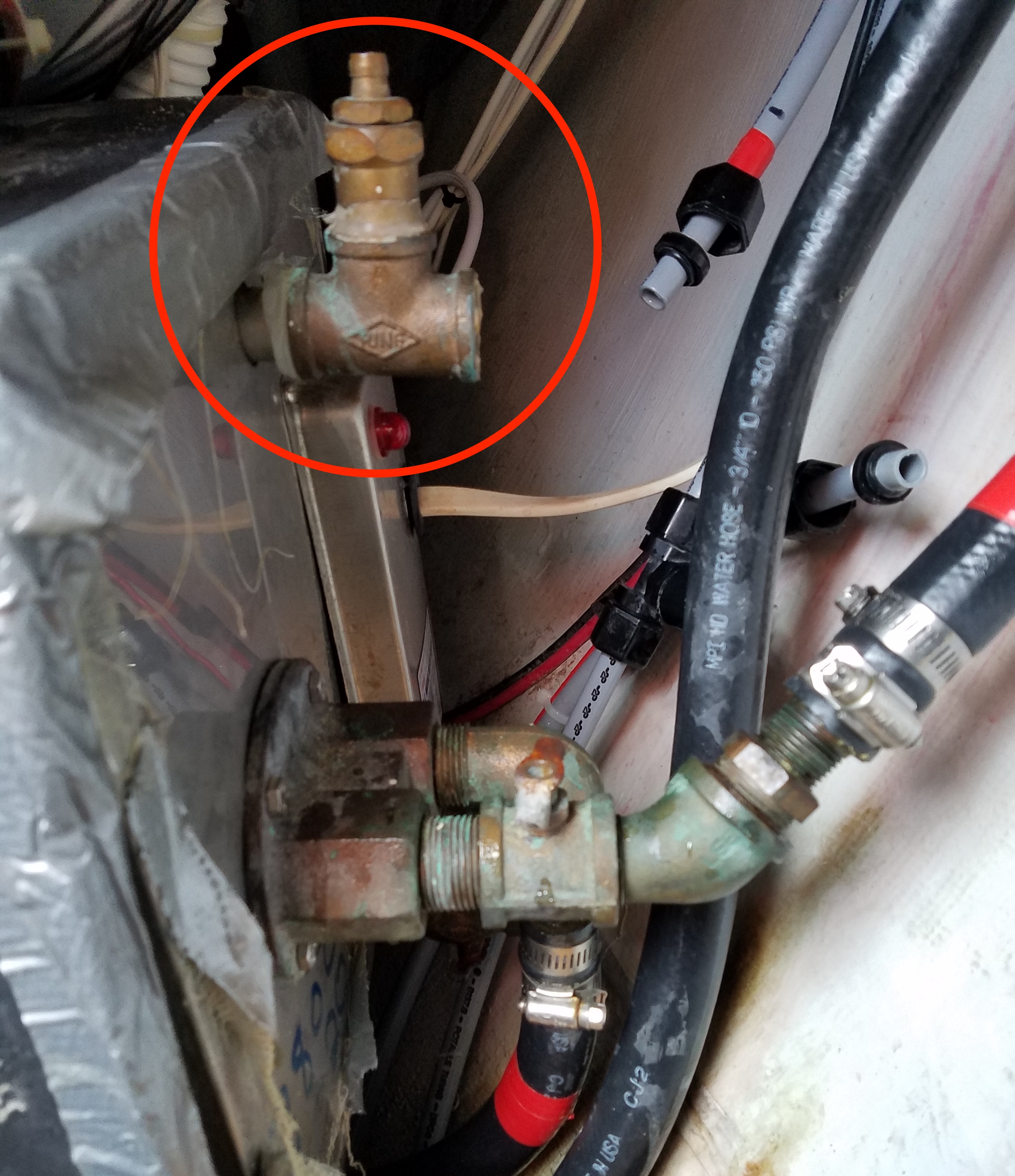

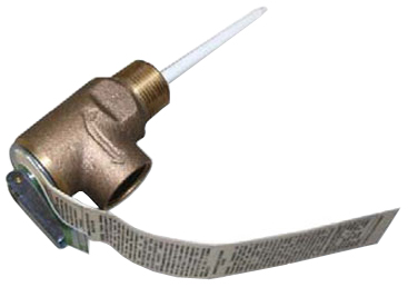

Dunno, JV.. That looks more like a mixing valve.. (I see hot in from left of tee, cold in the top nipple, tempered hot out the right side of the tee?)
The T&P may be on the other end? of the heater, opposite that stuff.

There is, I think. I'm not very familiar with what these things look like on boats, but it seems there is one on the top connection, which was plumbed previously as the outlet for the hot water from the heater. Do you think it faulty, or perhaps it is adjusted incorrectly?
Strike that. I spoke too soon. I don't think there is. There is what appears to be an over-pressure relief valve.
How do you strike though text like that????? I've never found a way to do it.
I get that, but I'm pretty sure it's a pressure relief. I unscrewed the top and inside is a ball poppet and spring. The nipple on top is presumably to attach a hose to direct overflow.

Interesting.. I'd be a little leery of that valve/fitting.. It doesn't look right.. Usually the T&P is in a dedicated nipple.. I think the mfg standards require that it be .. Not saying ya need to be worried that it doesn't meet code, saying that ya might want to figure out what P.O. was thinking when he put that in there.. My T&P drools when it goes from hot to cold because of water expansion.. then it doesn't drool after it heats up.. He may have been directing the drool ..
