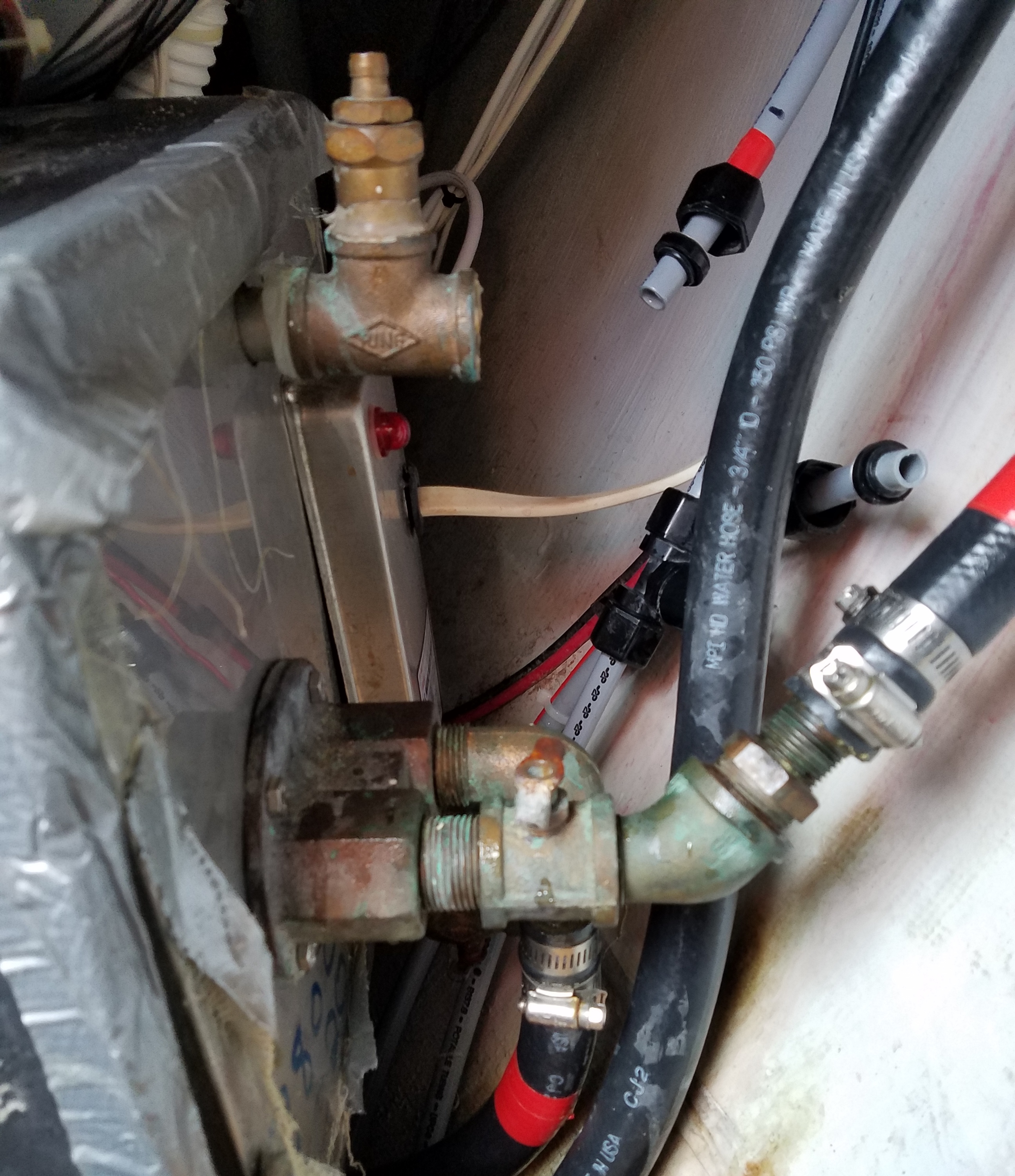

Found a pic of mine from the Fall. The h/w outlet is disconnected, and I assume that big, brass thing is an overpressure relief. Make sense?

jviss you have a bleeder valve on what seems to be the hot water outlet.
Or is that the engine in and out?
jviss
Feb 5, 2004
7,090
Tartan 3800 20 Westport, MA
The larger black hoses with the spiral clamps are engine coolant hoses. Not that there are three: the one from the bleeder valve goes up to the secondary coolant tank, the other from the heater goes down to the engine, and the third goes from the secondary coolant tank to the engine. In this pic all of the potable water hoses are disconnected from the heat; in fact, the potable water bypass setup was broken and leaking, and was removed before this shot.

There are four connections, the cold water in is hidden in the pic by the coolant connections. Please note, this worked in the fall!
