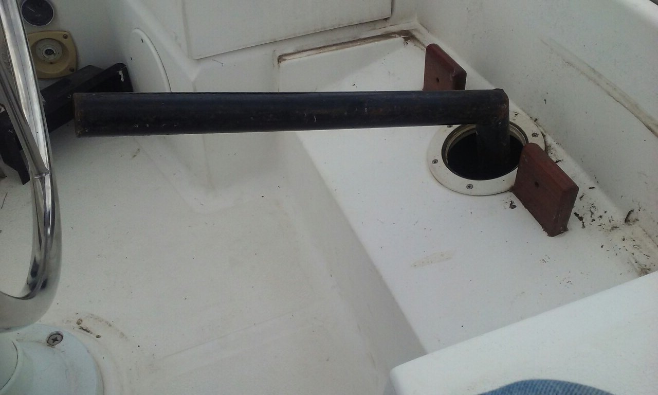

I realize this is a bit of an older thread, but I have a Hunter 28.5, 88' and there is an emergency tiller extension that came with the boat that is stored in the lazzeret. It fits into the notch in the back of the cockpit that you pictured. As far as, it came with the boat.

The photo of the port opening was Hunter installed. One thing with that handle in use for steering, you do not have the mechanical advantage like the wheel and will find it more difficult to steer with so watch the speed.

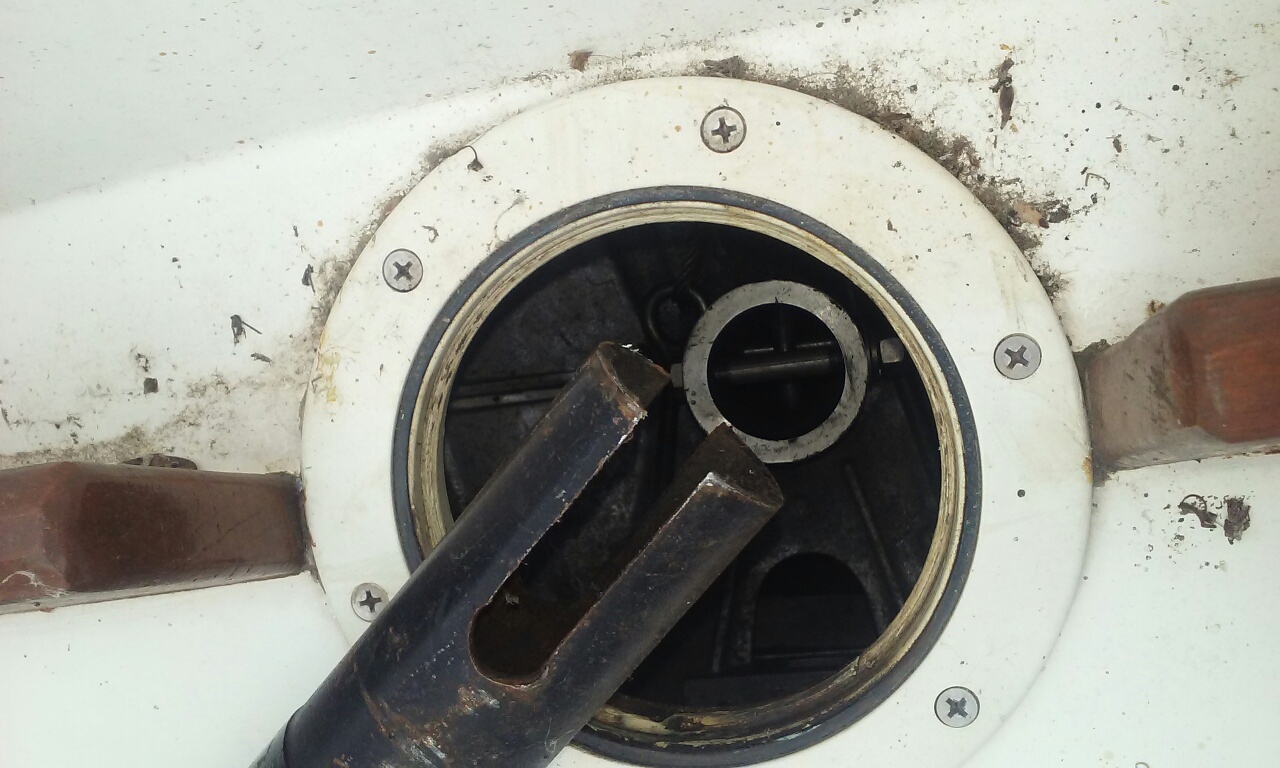

I'm not sure if you are still interested, but I did take a couple pictures and some measurements of the emergency tiller.
The lower part into the rudder is 12.5" long, the upper section which tilts forward is 19.5" long. The outside diameter is one and three-quarter inch, and the slot at the bottom into the tiller is a 1/2" wide, and 2" deep. The angle is about 115 Degrees.

The ET will be a major arm fatigue since the force applied is a simple lever arm ratio. That is limited by the clearance horizontal arm swing. Note the welded on port/starboard rings on my post #17 above.
I bought 2 cheap "come alongs" to hook to my stern cleats and those rings. I will use the "come along"
to move the ET and hold it in position.
It will take an amazing amount of arm strength to steer and hold in even moderate seas.
