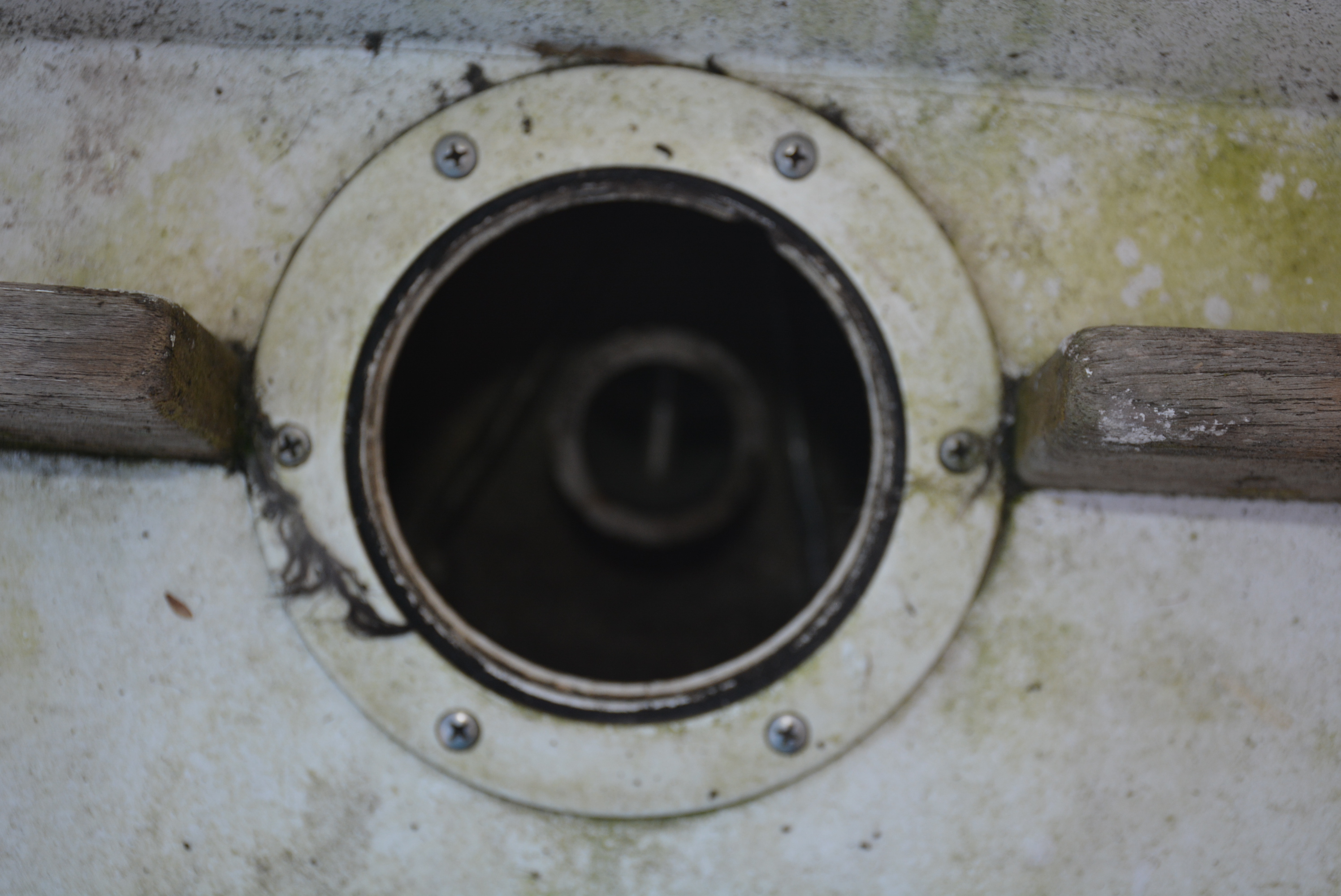

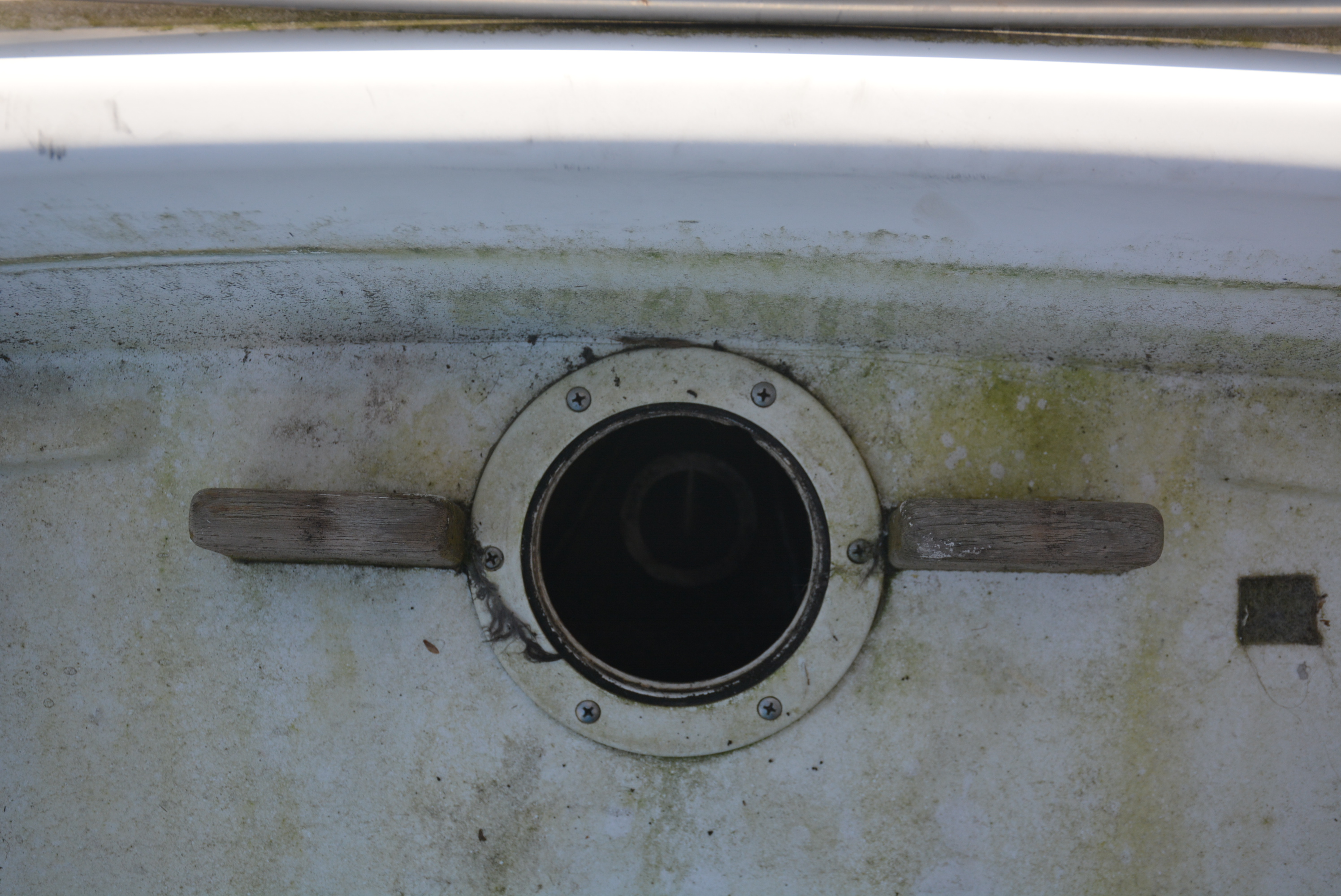

The little port below the slatted seat in the cockpit looks to me like it's an access to the rudder shaft. That pin across the shaft opening looks like I'm supposed to slip an emergency rudder device over it.
DID I GET THAT RIGHT? WHAT DO I WIN???? :)
The PO told me he thought the PO before him installed the little port. From looking around the site here, looks like it's a factory job!
I have no emergency tiller handle, seen one a member built back in 2013.
I can build one, I'm sure... but what do you all recommend for materials?
Once I make those slots in the end to accommodate the pin in the rudder shaft, I'd want my e-tiller to be strong enough to hold up to some major leverage right?
Handle length? I know I'll have the wheel to contend with unless I remove it.
Just want to do it right. Thanks

Looks sorta like my old H 30 C's set-up.
There is supposed to be an aluminum tube that fits the hole with a slot cut in the lower end that fits the pin you see. The upper end of the tube has a welded post that is shaped exactly as the wheel post that you actually fit the wheel over to use to steer. There are pics in the archives of this set-up.
A special tiller could be made from scratch that will work without removing the wheel. I made mine from 1.25 in. SS tubing shaped as a triangle with a key way welded at one corner that fit the post. You would also have to make the post and tall enough to clear the seat elevation.
Hope this helps.

For an emergency tiller there is no need for it to turn straight (fore-aft) like a traditional tiller. Many emergency tillers are shaped like a T to stay clear of wheels and the like.

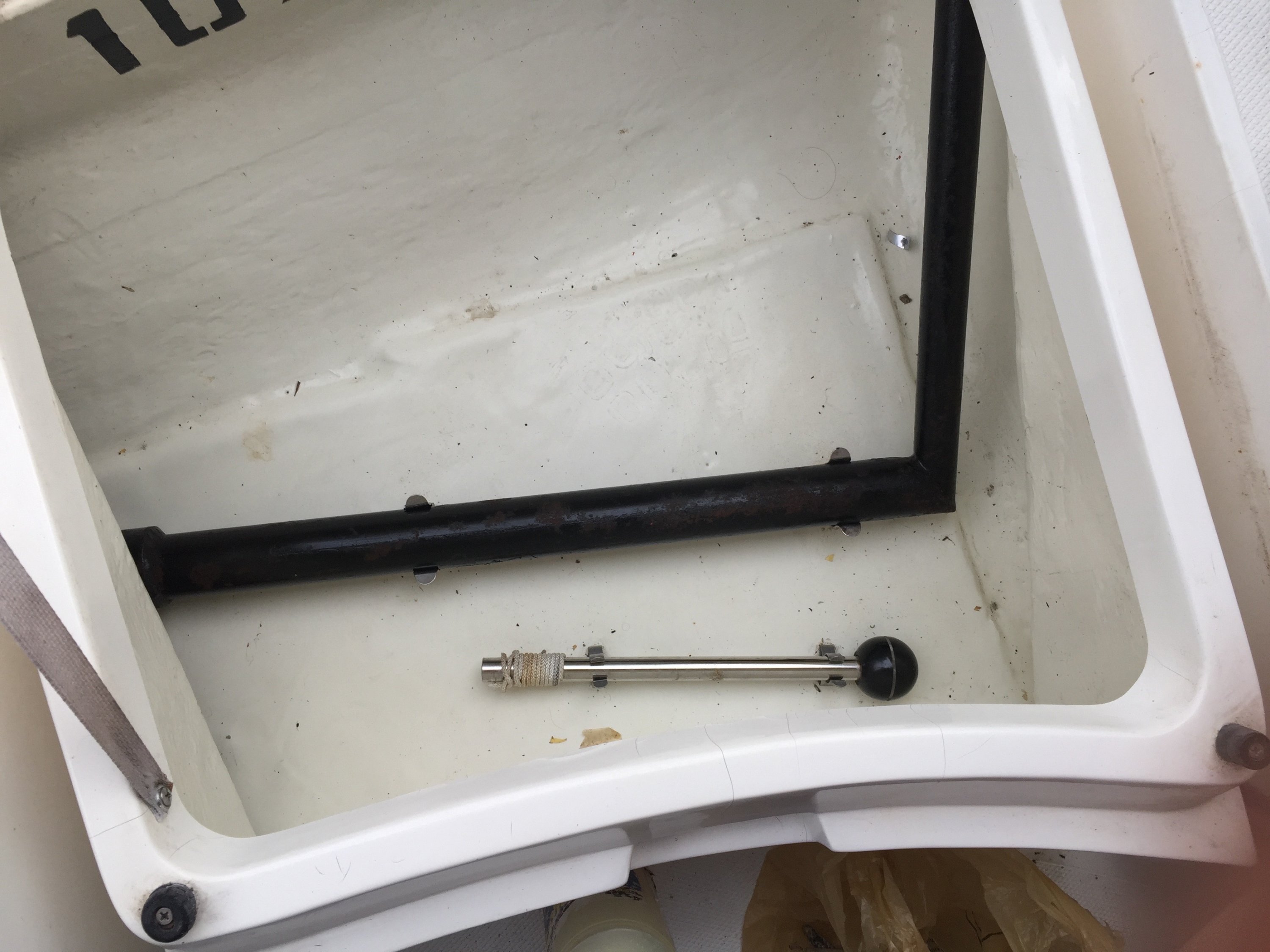

Steering took to BIG men, one on either side of the ET braced against the cockpit sides, feet pushing on what looked like a big tire iron.
:plus:
When I found mine (for my rudder size) I was first shocked, then impressed. It is OEM.
It is a ≈2" carbon steel pipe "L" shaped for the tiller arm (called lever arm) has a welded hand grip, slot cut for matching cross bar (in you pict) on the rudder, and angle brace. I also located my gusher pump handle. The tiller arm does clear the helm wheel.
Wow, as Gunni noted, imagined holding course in heavy seas and hand pumping your bilge a same time.:yikes:
I can send a picture of my ET if you want to down size it for your boat.
Jim...
PS: The key to design is the "lever arm" distance, but I would maximize it to just clear the helm. BTW I do a annual inspection and maintenance of my steering. It has been mainly visual and a dab of chain lube.

Just get a long enough tube that fits into the top of the rudder shaft and cut a slot into it then at the top drill a hole to run a shaft through it. The length of the shaft handle is determined by the wheel or other obstructions. Usually heavy and cumbersome steering but much better and safer than none.

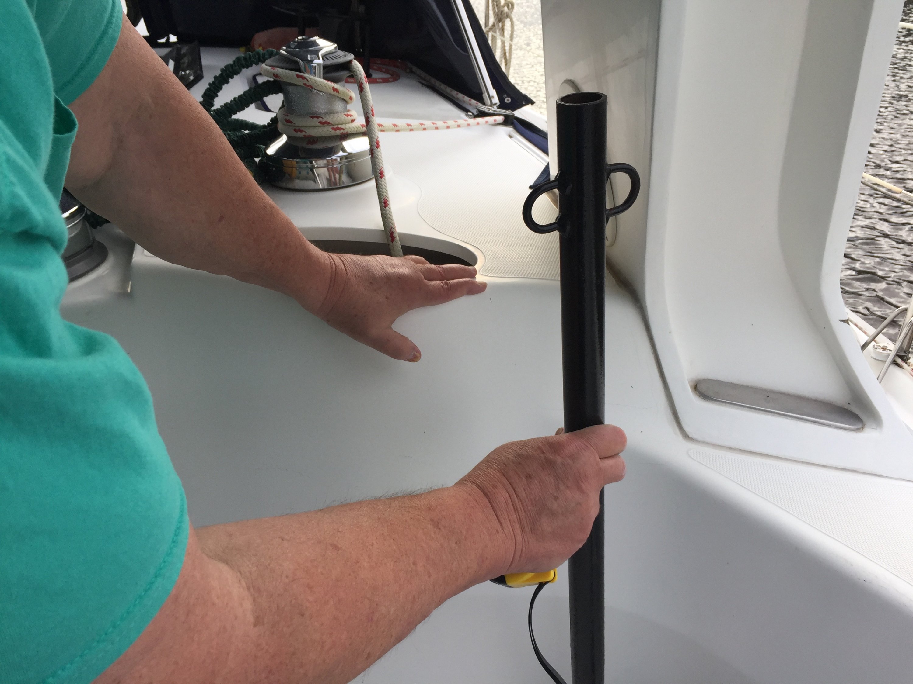

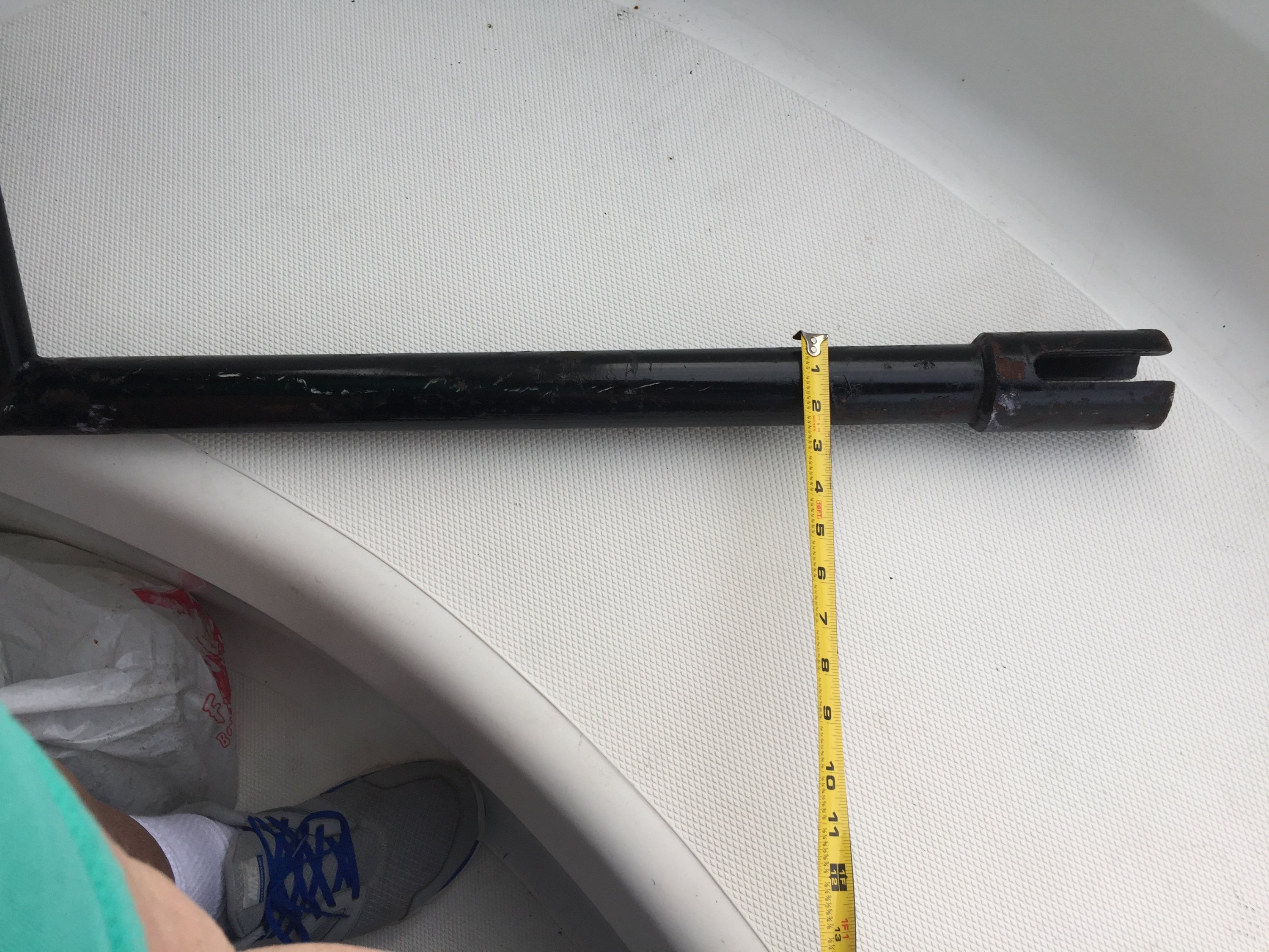

I went to the boat to get my ET and picture for you. Glad I did, it had started to rust. Going to sand and paint then send pict. That way no "wise crackers" will tell me to paint it first.
Tip: Even algae and mold have to live too.:stir:
It is 2" vertical/shaft, steel pipe welded to 1" pipe, tiller arm.
Glad I did search, discovered a bunch of stuff from Previous Owner, still trying to figure out what functions they serve. Xmas every day.:)
Jim...

Ok, we sanded and sprayed with rust neutralizer/primer and still needs a finish coat.
No wise cracks...;)
The working end is 2.5" (4.5 inches long) with the slot cut and fits over the rudder bar. You will have to figure your size.
The ET and the gusher pump handle have "broom snaps" to stow without banging around.
Maybe someone can tell me why the (non hull number) stenciled number are for in this Port Lazarette.
Finally the 1 inch pipe tiller arm clears the helm and has some welded rings to tie the rudder on a course (manual strain reducers). Tiller horizontal length is 28" and height was also 28"
We stow our emergency lines on top of the ET, which are shown in pict 1.
Good luck...
Jim...

I forgot the picture of the welded tie off rings.
Also my son-in-law tried to move the ET and couldn't budge it. Why? Nothing on the autopilot chain or rudder cable was broken. So no ET steering while main steering works.
Jim...
