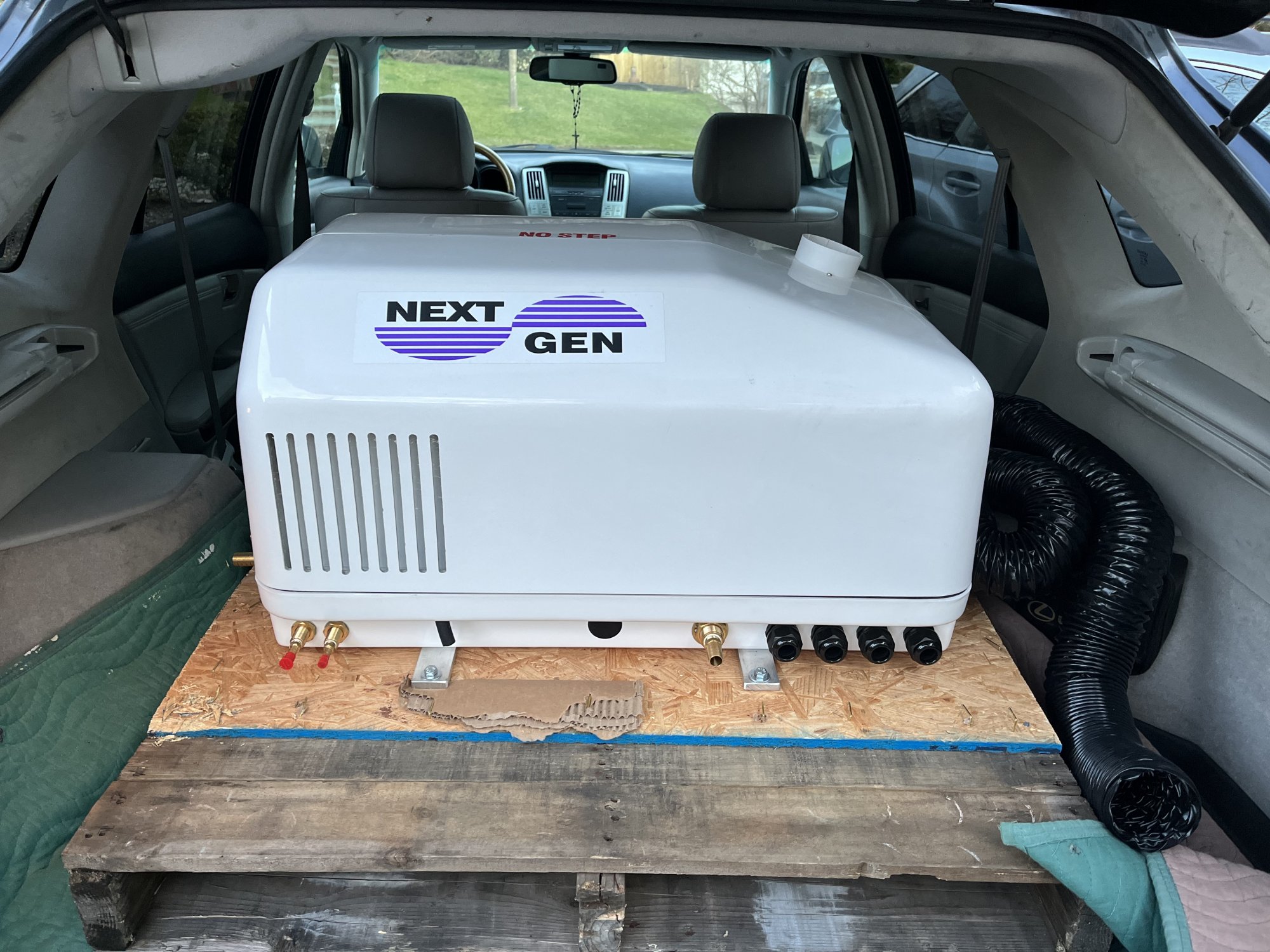

Old thread..... but I just took delivery of my Nextgen 3.5kw genset. They are made in America and not a re-brand.... sort of like a beta marine with no electronics and a simple unit to work on, Kubota engine. People at the company are very happy to talk so far and also the dealer I bought it from, Joe Demers of Sound Marine Diesel in Ct is a great guy.
Looking forward to the install.....
