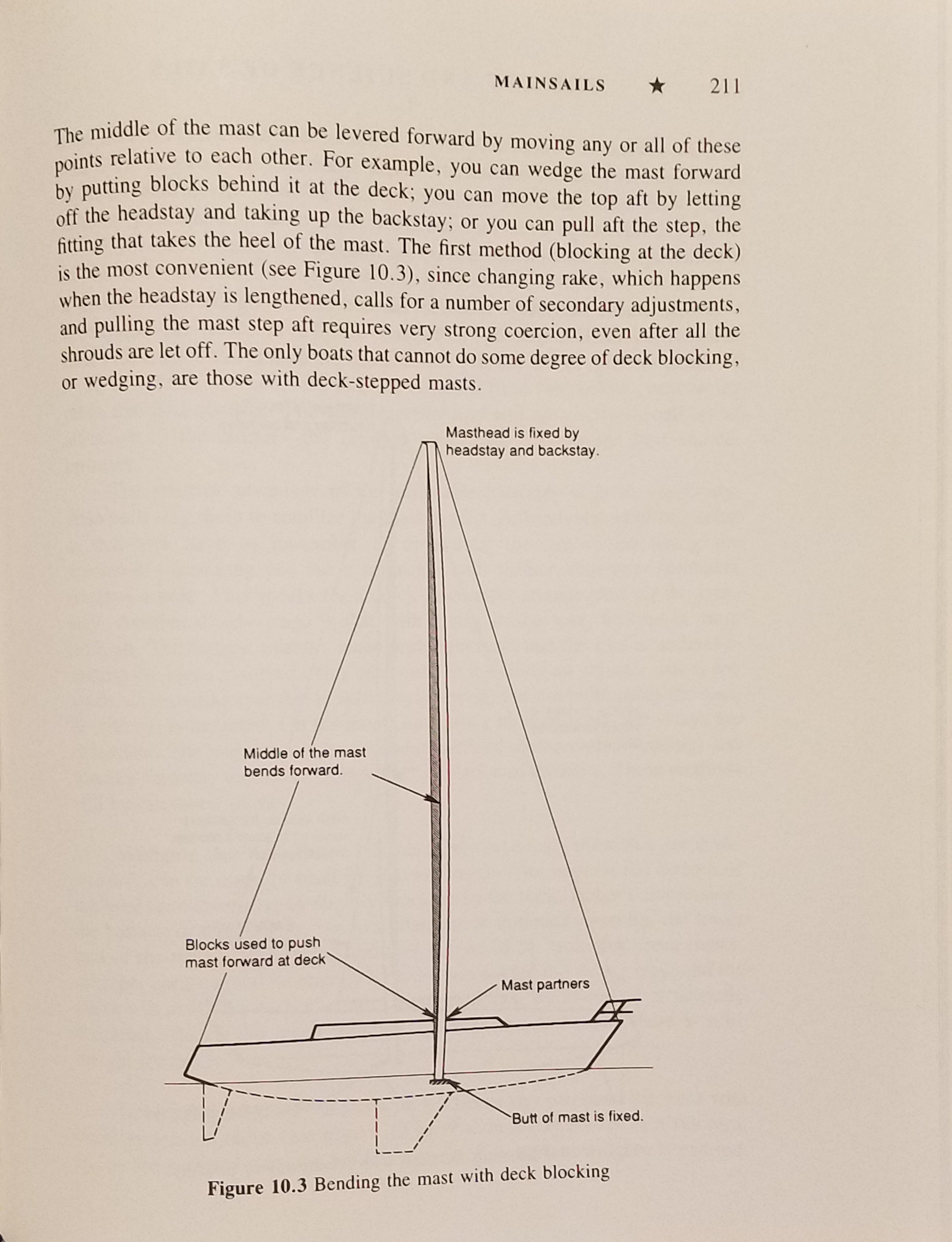

I also wonder about a previous comment, that one can't bend the mast to affect mainsail shape with a masthead rig. My main has a quite pronounced luff curve. Since I have a hydraulic backstay and a baby stay, I assumed I could bend the mast, which would simultaneously flatten the main and tighten the forestay, flattening the jib. I even thought I could do this on my previous boat, which was a masthead rig with a backstay tensioner and no baby stay, but could have some pre-bend tuned-in via the lower shrouds. But what do I know?

John, I'm afraid that's just not so. There are lots of references and tutorials on this. For a fairly authoritative reference, see Tom Whidden's The Art And Science Of Sails, chapter 10, section "Bending The Mast," and in particular, page 211, reproduced below.
Have you ever handled an aluminum mast? I built a new rig for a C36, and spent lots of time with that 52'2" extrusion. It was a straight mast, and it was downright whippy! If the boat is rigged to do it, it will bend, a lot! It's tougher with triangulated shrouds, but it can, nonetheless, be done, and to great affect, for flattening a main. The C36 has a straight mast and triangulated shrouds; the T3800, a tapered mast and non-triangulated shrouds. Both masthead rigs, both keel-stepped masts, both bendable spars (as I set up the C36).
