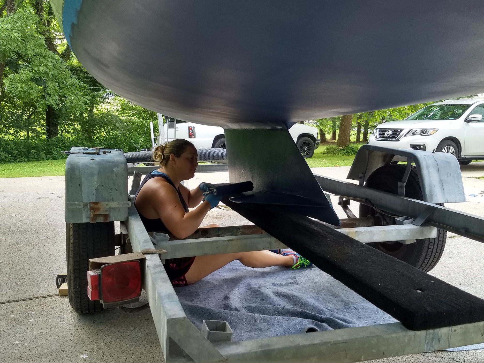

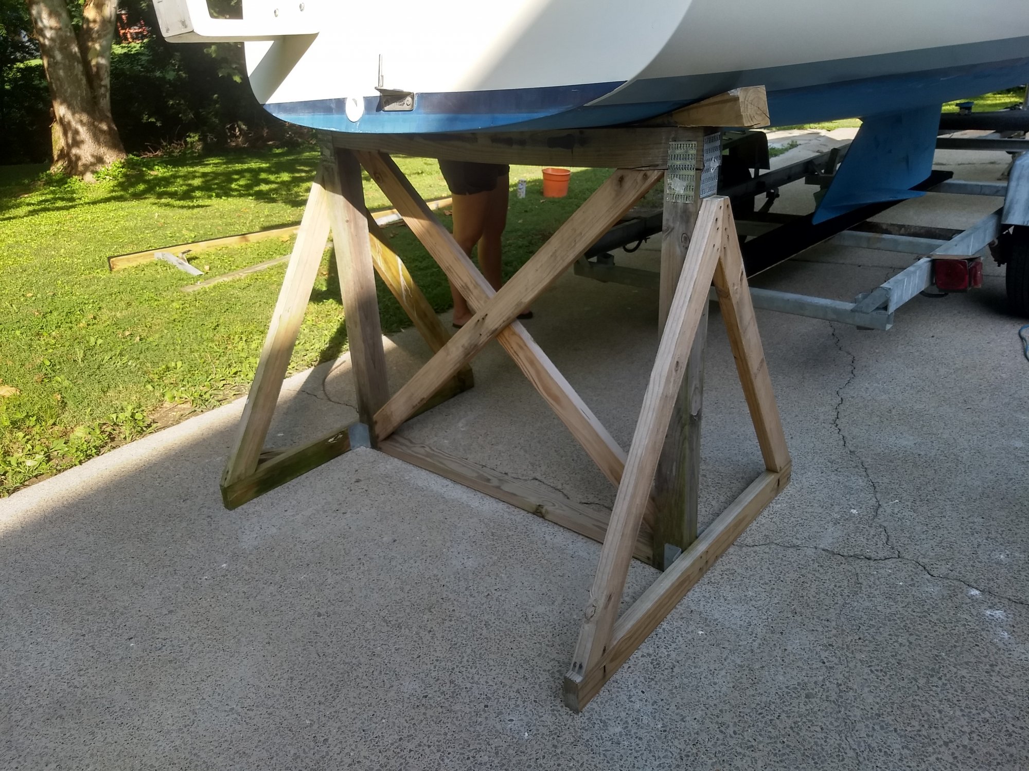

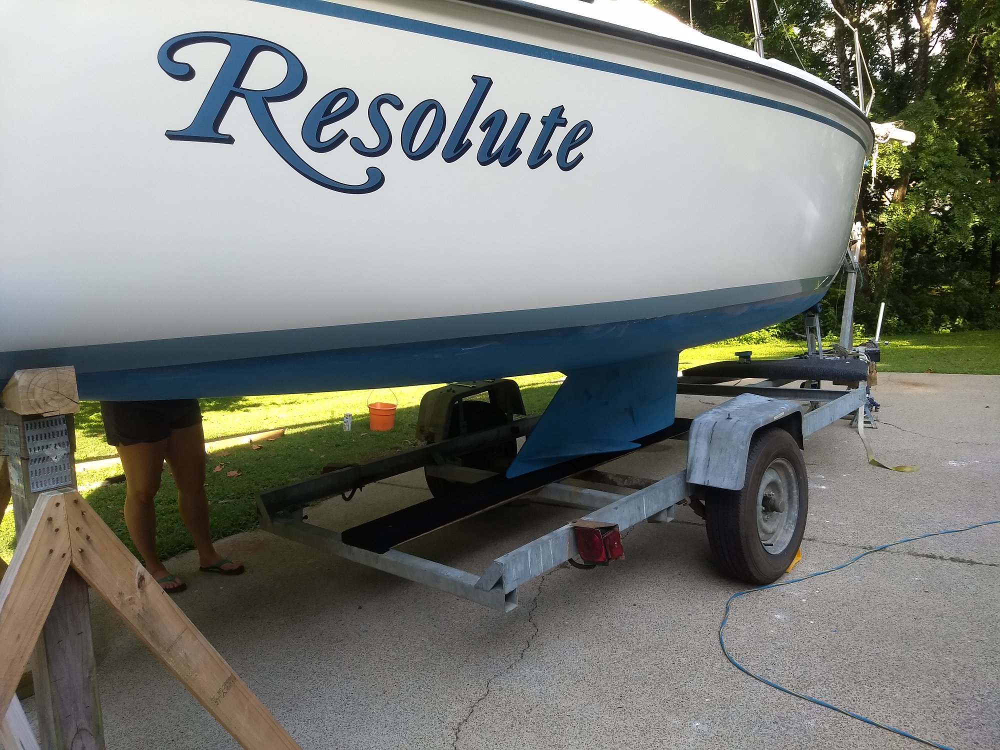

I cantilever mine up like this for bottom painting. Then I get the bunks very close to the boat right before the keel touching. this keeps the weight on the keel and bunks lightly supporting and holding level. I measure all meticulously to be sure everything is even.
P100D
Jul 24, 2016
129
Hunter 23 Nashville TN Percy Priest lake
I sand everything that is possible with it fully on the trailer then raise and sand a bit more on bunk spots and paint.

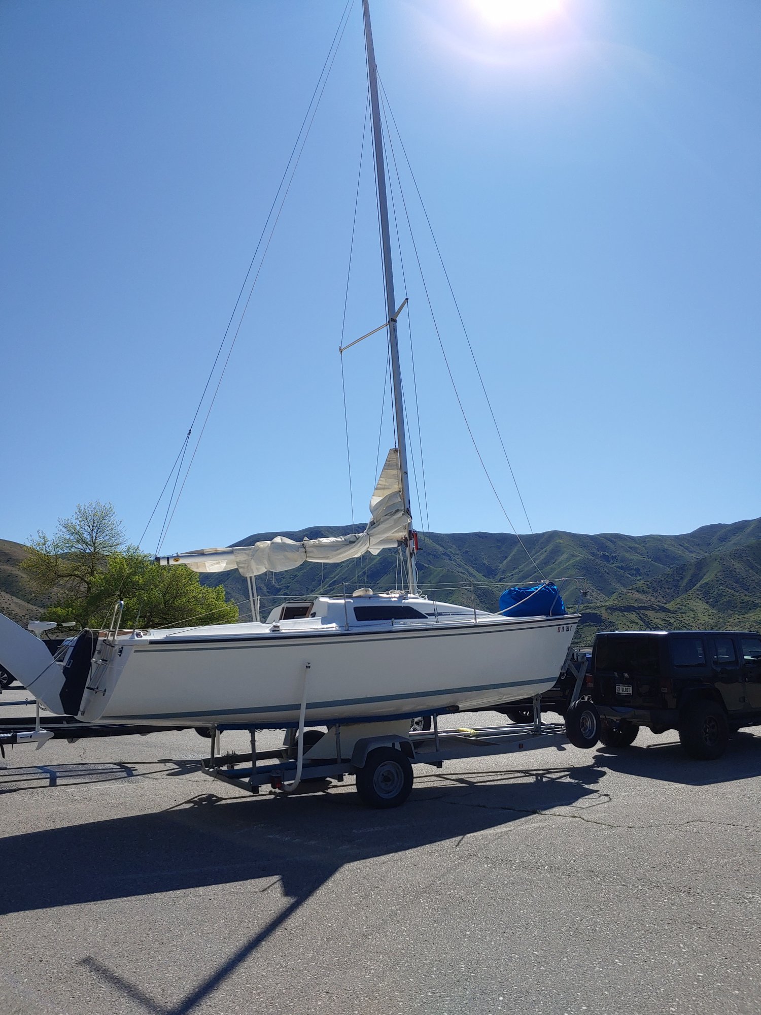

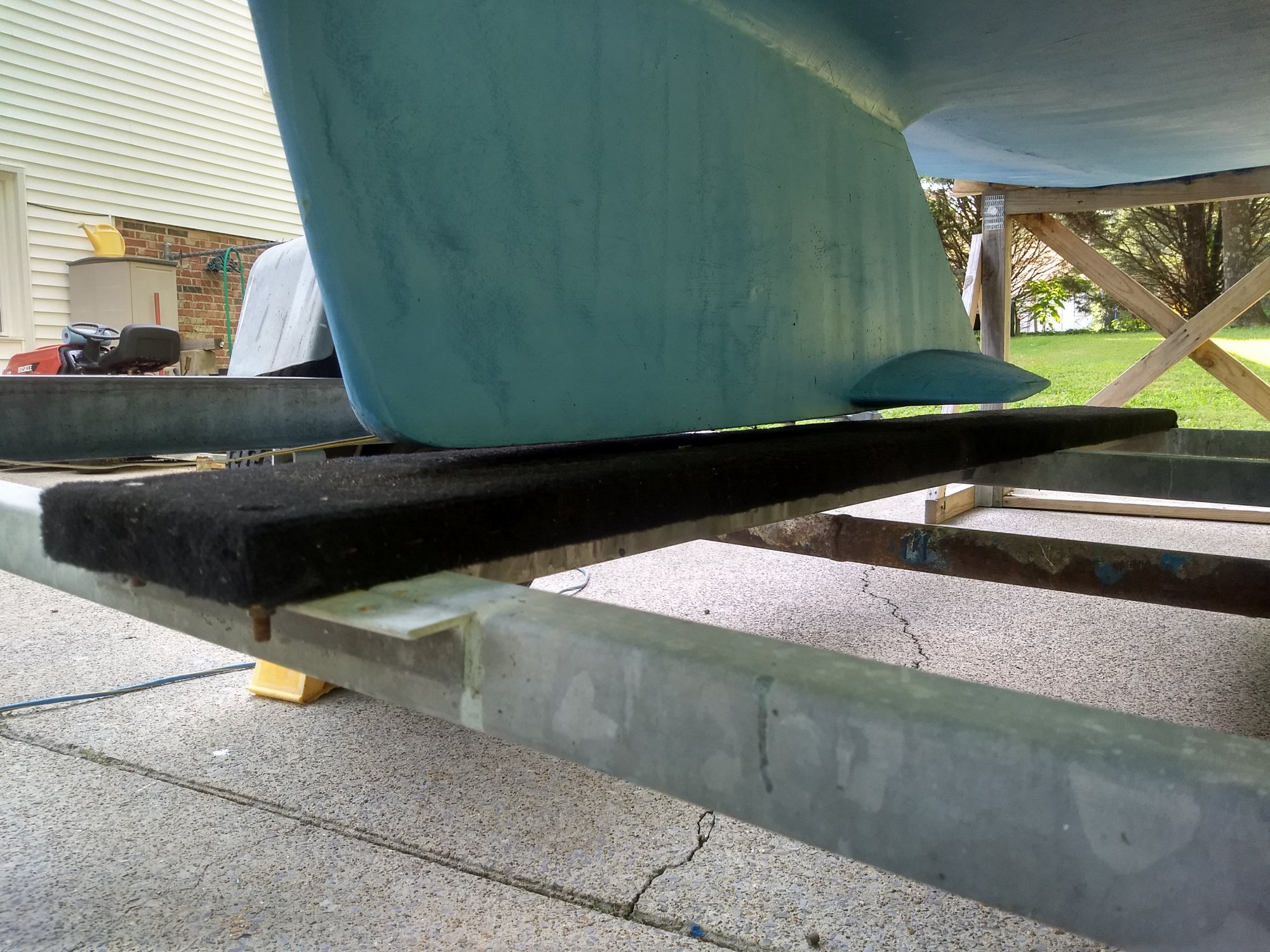

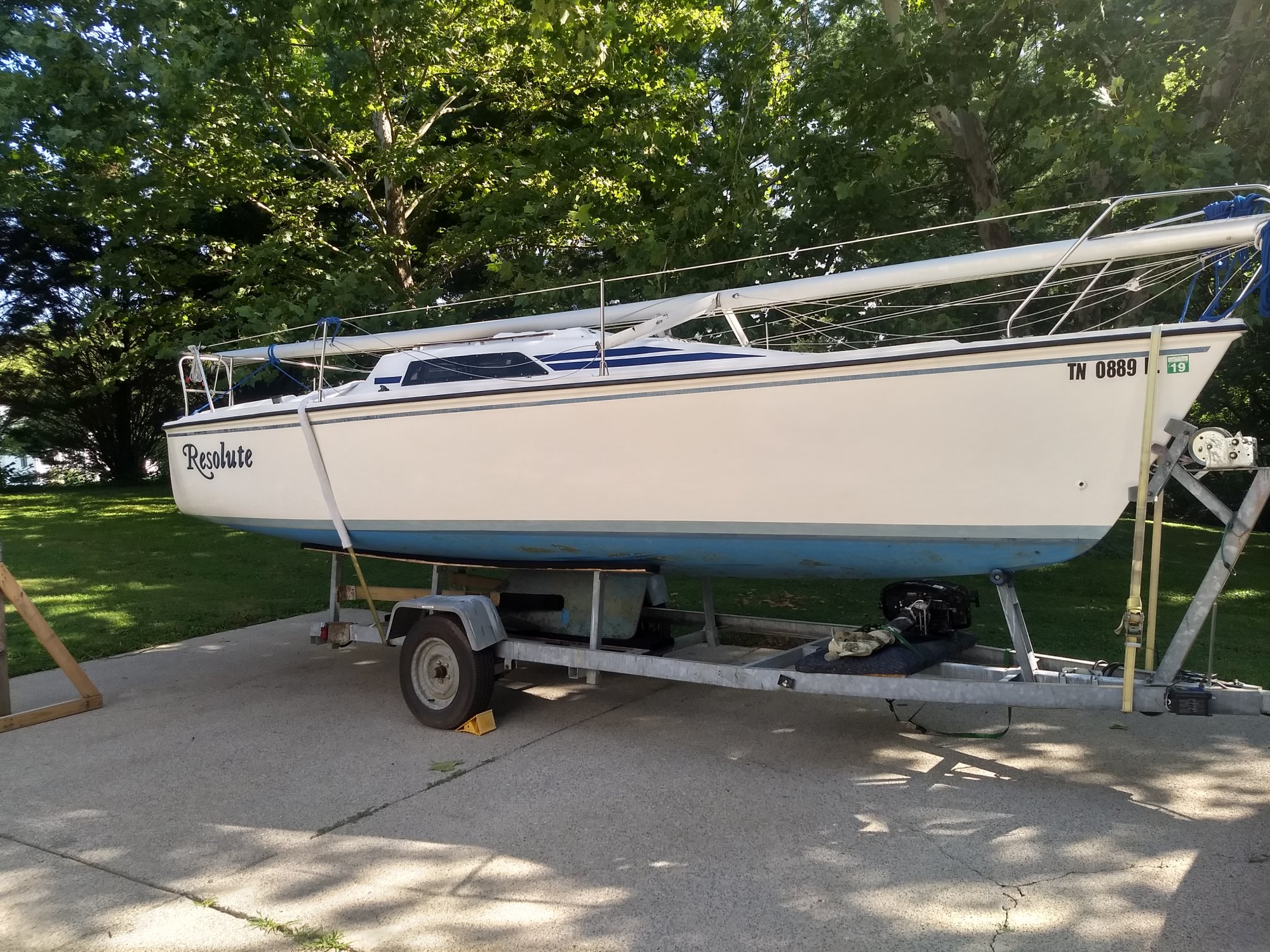

I did not like the Plywood for the Keel board and replaced with a 2X12. Mounting the outboard to the "V" of the trailer helped add the tongue weight needed for the trailer to track much better on the highway. I have also moved the Battery to the front of the boat that helps even out the heel on tacks but also adds forward weight to the boat on the trailer. And I have changed the broken surge brakes to electric which allows me to brake the trailer if any sway occurs which is rarely since mounting the outboard forward. The electric brakes are awesome for extending the tongue and collapsing at the ramp.

Maybe that can help on how to adjust the bunks for your question.

A friendly reminder on a trailer with a fixed keel. The weight of the boat with keel should be supported on the keel tray. The bunk boards should only keep it upright. If any oil canning of the hull is happening, that means the support is too far up and should be lowered accordingly. Whether or not the oil canning of the hull will ever come out only time will tell. If not , live with it. Depends on the boat. If it ain’t broke, don’t fix
