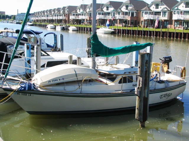

I have had a Walker Bay 8 for over 15 years and am very happy with it. It's a plastic boat, somewhere between wood and an inflatable for looks. I drag it up the beach, sand or rocks, I can easily lift it off the dinghy rack and launch it off the dock by myself. I did put it on the deck of my C&C 27, haven't tried on the Freeport 36 but I'm sure it would fit no problem. The 8 footer is great for 2 people but I have had 2 adults and 2 kids in it several times. It rows very well with one, ok with 2 and it can be done with the family of 4. In a rigid boat, go for at least 9 feet if you want to be able to fit 4.
If you are towing, you could easily accommodate a 10 footer behind your 30 foot boat, just don't expect to bring it on deck.

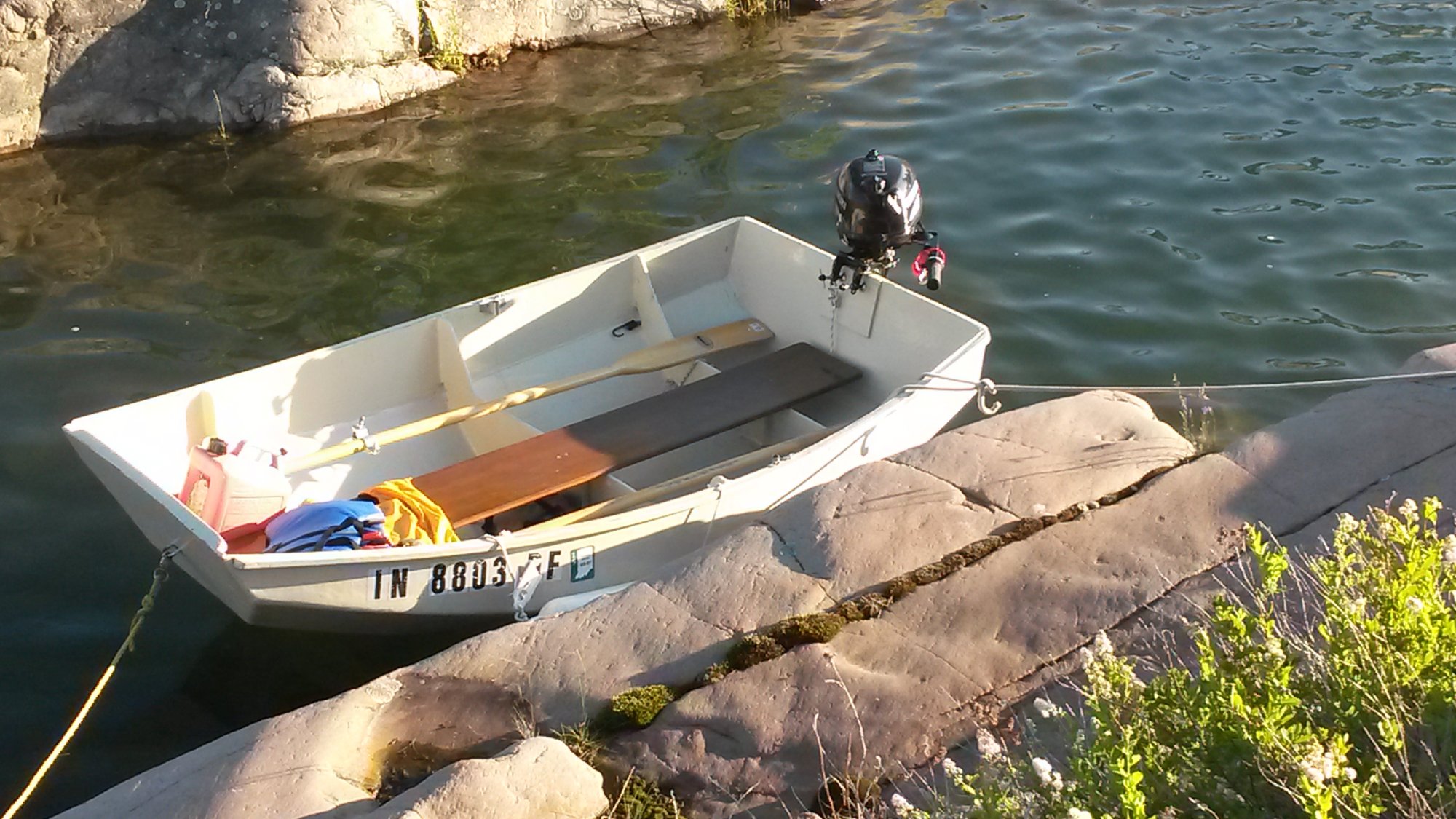

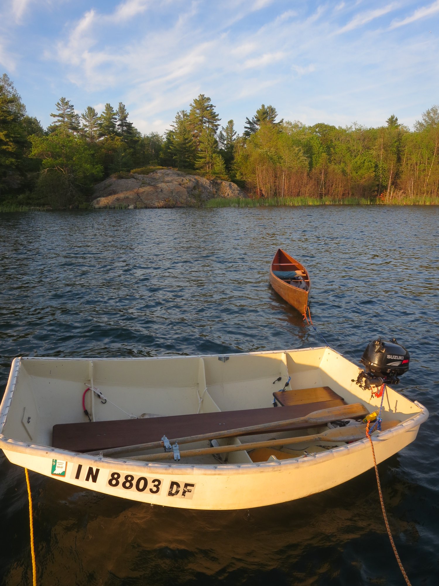

I built a Rubens Nymph (1' wider than the Nymph) designed by Phil Bolger.
We are very happy with it.
Extremely stable, no problems towing, rows well and turns on a spot. I row it most of the time for the exercise, but I have a small outboard that I can use if I want. It can be sailed, although I didn't build the components for sailing. I've had it on the bow of my Gulf 29' for a long trip up Lake Huron, but that's too much trouble to do that routinely. 8' is a good size for the two of us.

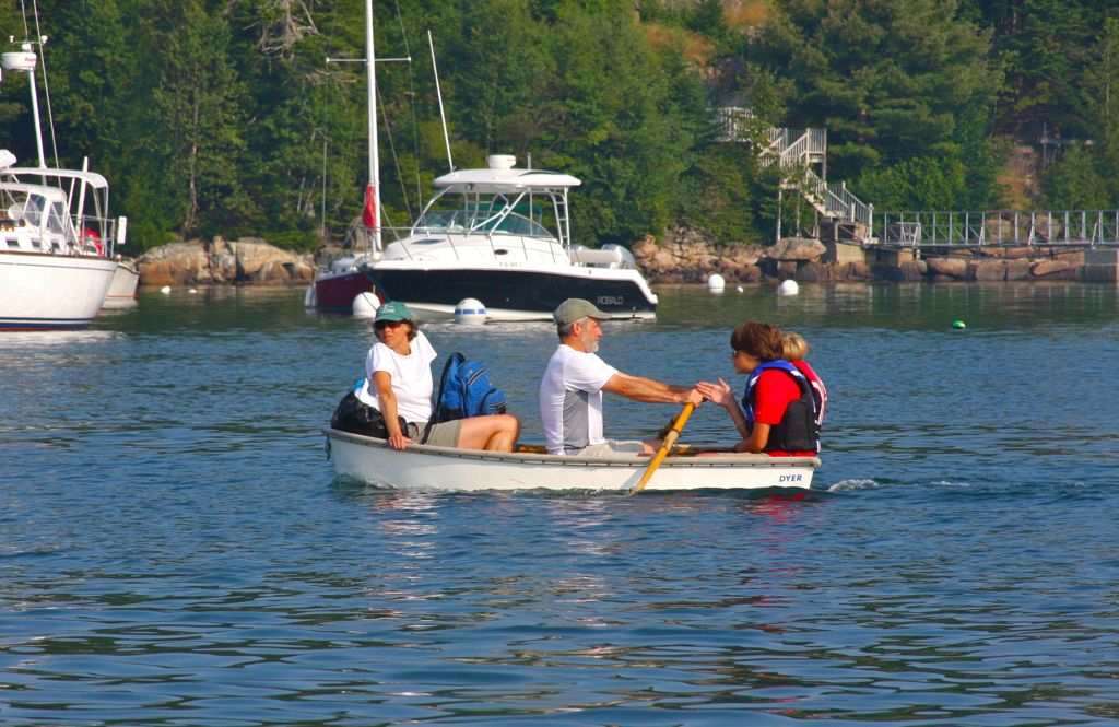

The length of a small boat pretty much determines the boats function, in all respects. The difference between 8 and 9' is night and day when it comes to stability and load carrying. A great example is the Dyer dinghy's that are popular in the NE. They have an 8' tender called the Midget. Nice tender for two people and a little gear. But if you have often need it to carry more than that it will become a tub to row. Worse, any overloaded small boat becomes dangerous in even mild conditions. Here's a Midget in a protected harbor with too big a load. No problem in here and if the row is short but if any sea or wake came along it could become dangerous.
A friend has the next larger Dyer tender, called the Dhow. It's 'only' a foot longer, but that foot is a mile in boats under 10'. They have had it since they started sailing on a 21' boat , with two young boys. Today they have a bigger boat (Hinckley Pilot 35), the boys are nearly grown and they have a dog. That's a pretty big load for a 9' tender so with they added a Torqueedo to help move a typical load from dock to their moored boat about 1/3-1/2 mile from the dinghy docks. But once underway, they don't need the Torqueedo much and have no problem getting to the boat while cruising our coast.
The family in the above shot would have no problem in the larger Dyer.
But in the end, the 8' tender performs best with one aboard. Two begins to slow it down, a little gear and it becomes a tub to row.
The 9' performs nearly as well with 2 as 1. Add a third person and it begins to slow down. A fourth, and it becomes a tub to row.
[URL unfuView attachment 186255
Love the seat! That's great for fore/aft boat trim. It works with one, two or more people. And their weight is in the middle where it should be. For my Peanut Pram I used an "H" shaped seat. That is a fore and aft athwartship seat with a middle section connecting the two - actually it was one piece. It was stitch and glue so it needed some stiffening from the seat. Nice build!

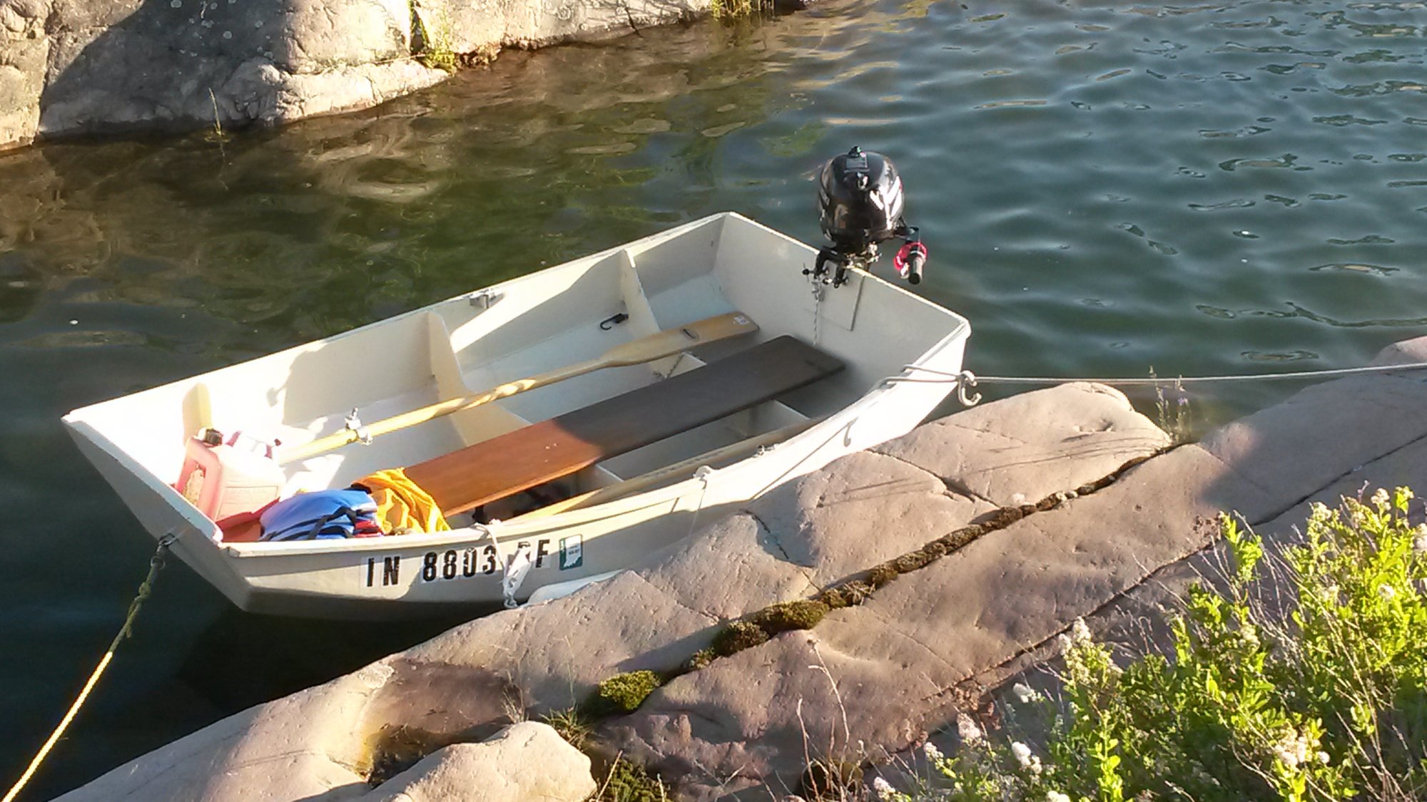

80
Gulf 29 Little Current, ON
Yes, the seat running down the center does allow for good weight distribution. This dinghy works well for three persons and has lots of freeboard. It proved somewhat awkward to use the outboard while seated on the center seat, so I added a small seat to get me off-center (visible on the starboard side in this photo:
