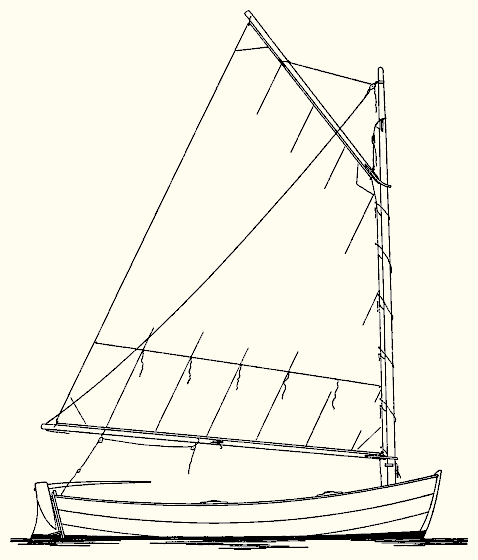

Any obvious issues with using a rowing/sailing 11-foot catboat as a tender? We are likely no more than weekend sailors with an overnight here and there, so I anticipate only towing her around Maine waters and using her to go ashore on overnights. Generally it will just be the Admiral and me, but would like to comfortably be able to take another adult couple and if the three kids are home, would be nice to be able to get them aboard.

Something like this?
24,949
Tenders need to be able to ride on the stern wave of your boat. Sometimes you find they just do not tow well. Often those tenders saw through their tow line and go adrift.

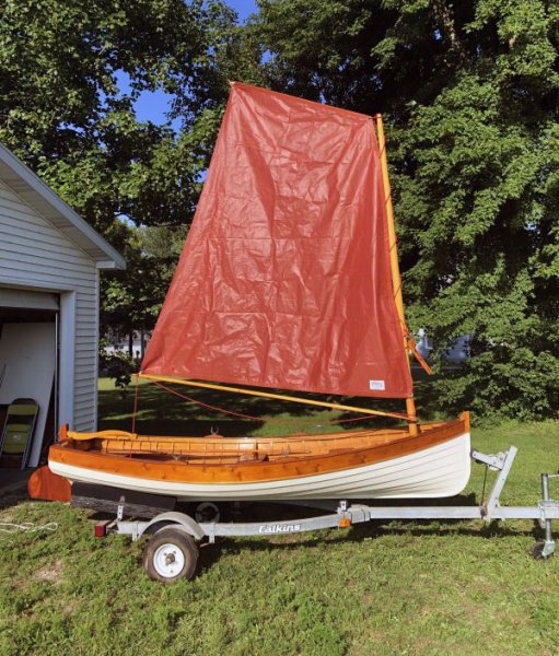

Here is a picture of the one we are considering.
That is a beautiful boat! What a joy it would be to row and sail, even with a friend or two onboard.
In sheltered waters and conditions, it should serve your purposes well. If you decide to range out of Casco Bay, I'd consider a smaller easily towed tender. You could have both.
Maybe it has one already, but it will need a stout towing attachment point, through bolted and low (to keep the bow high), on the stem.

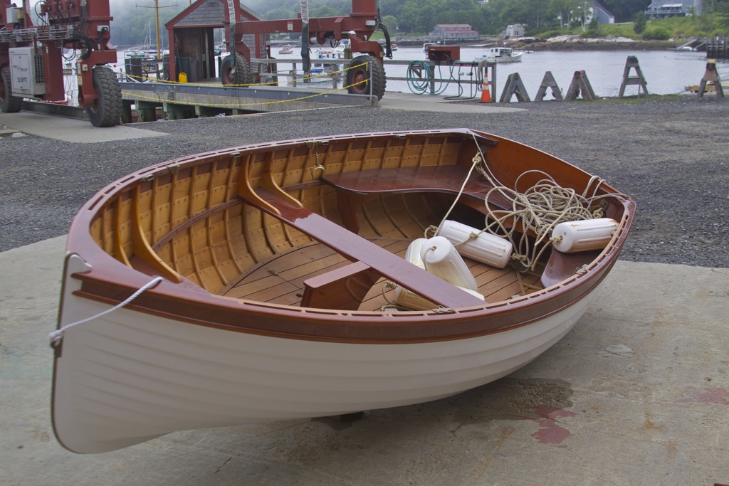

When I see tenders like that used I often see quickly deployed fenders tied inside that can be thrown over the gunwales to tie up alongside the mother ship. The Lawley tender above has both; the bow attachment point, and fenders strung on a line from stem to stern, all of which is thrown over the gunwales to tie up alongside.
24,949
That looks like it would be a fun boat to have. Looks in good shape and has been cared for. It appears to be a bit long for a tender. I suspect it would tow ok as long as you can keep the bow high.
What makes it look to be good for rowing, might make it a challenge as a tender.
  • Good for rowing are the long sweep of the sheer and the wide low mid section. A solid extended center keel would help it track well. The lapstrake hull would help to deflect moderate chop.
  • On the other side, the short mid and transom length brings the gunnel down close to the water line. Chop hitting the boat when towed might ship a bit of water into the boat. Having an auto bailer might help.
It is no good to have to stop and bail the tender while cruising.

I wonder how well that plumb bow would tow. If the bow were to dig in at all the boat might veer quite a bit. Most towable tenders have the tow point farther ahead of the knuckle at the water line to help keeping the bow pointed in the right direction. Or, in the case of inflatables, spread it out with a bridle which would also help directional stability.

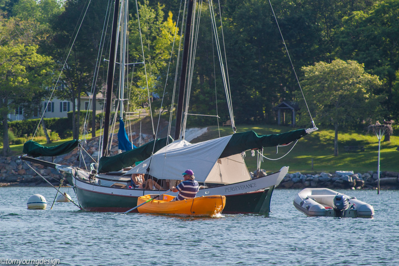

That's one of the more charitable reviews I've seen of the Pudgy. Bob Perry says they make him think of suppositories.
Pudgy's have a small following in my harbor. Not a bad tender, they tow fine but drag nearly as much as an inflatable.
They row poorly (everything moves and flexes). Not as bad as rowing an inflatable but many end up with outboards if the owner needs some range(good Torqueedo fit).
Sort of a Maine enigma. :)
