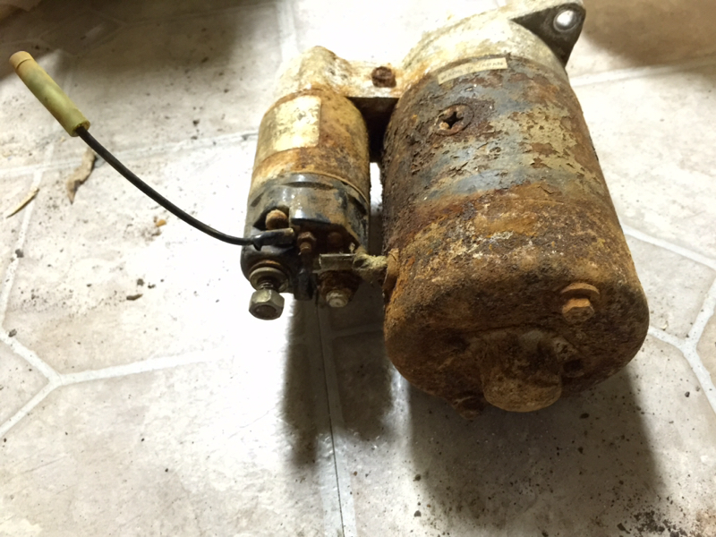

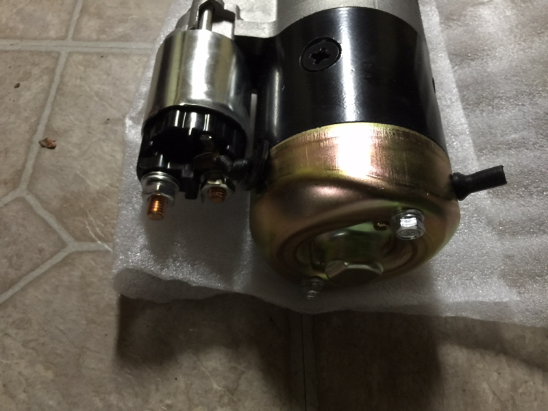

new starter arrived today but too late for me to try and install. but i was comparing it to the old starter and the old starter has an extra wire. Captnron and I have been talking about the gasket my old starter had. I suspect that the extra wire is the ground for the old starter and the new starter is grounded through the mounting bolts. has anyone else had to replace their starter on a 5411 and have this similar problem?

image-3987770355.jpg image-4117045211.jpg New starter and old starter comparison. Old starter has an extra wire??

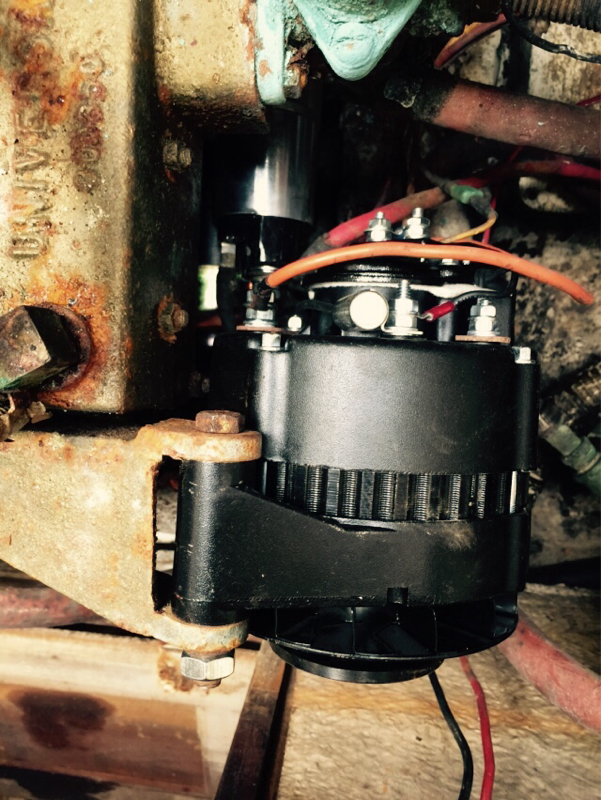

New starter and new alternator installed. Installing was a breeze. Found out however that the old belt is too short with the new alternator. There is no automotive parts store near Herrington Harbor. So I had to go back to the parts store near my house and I'll try to see if I got a long enough belt tomorrow. Will post pics once belt is on.

well i know i promised pics. but i was working alone again and couldnt take any. i did manage to change the oil and filters and install the starter and alternator and replace the belt....whew. even writing about it makes me tired all over again.
