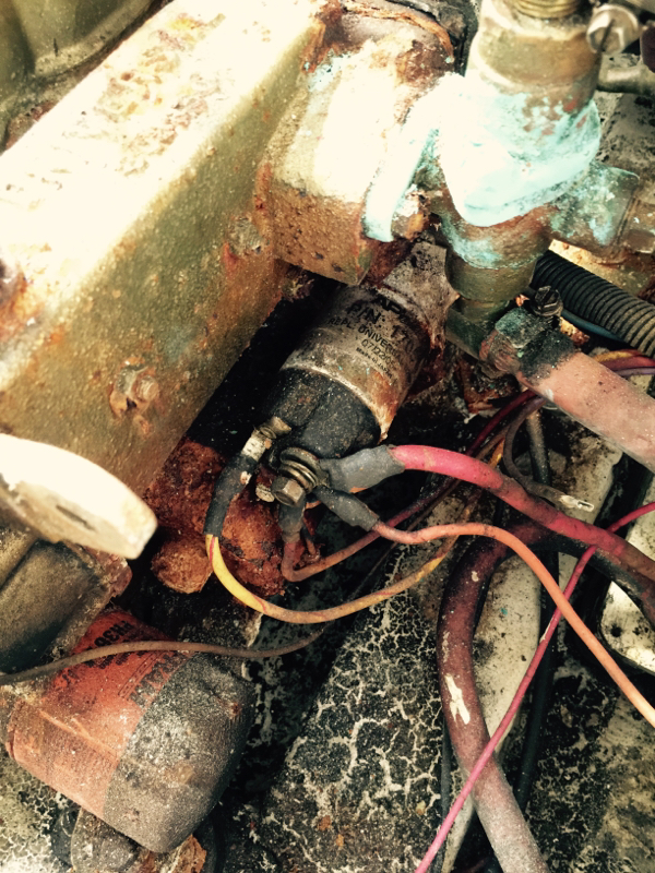

worked on the engine today. removed the alternator and starter. i tried to turn the crank but i didnt bring a socket or wrench big enough. image-39055618.jpg image-4285064353.jpg image-148133165.jpg
Sep 26, 2014
107
Catalina 30 mkI Herrington Harbor
Did you check voltage at the starter after you installed/wired the batteries?
unfortunately i did not. i probably should have but i didnt bring a meter with me anyway. the alternator was seized up and the starter was so corroded. you can see from the pics.

Gotta tell ya JTuner, after seeing your close ups of that engine it really looks bad.
That engine was definitely submerged in water for a long time, as you mentioned that there was quite a bit of water in the cabin. I would try to get the motor to at least turn over before I put any real money in it. Because if water got in through the air intake & corroded the fuel injectors, injector pump, seals, wiring, etc. then it may not be worth fixing. My 5411 has been rebuilt & is by no means perfect, but this is what it should look like in decent shape:

I know the pics don't look too encouraging. But they are just bad pics. It's really not as bad as I made it look. Or maybe it's just me trying to think positive. Lol. I appreciate the concerns fellas. I know it looks like it could be a tough fix but I'm trying to be optimistic. What I could use are some links to some cheap parts.
