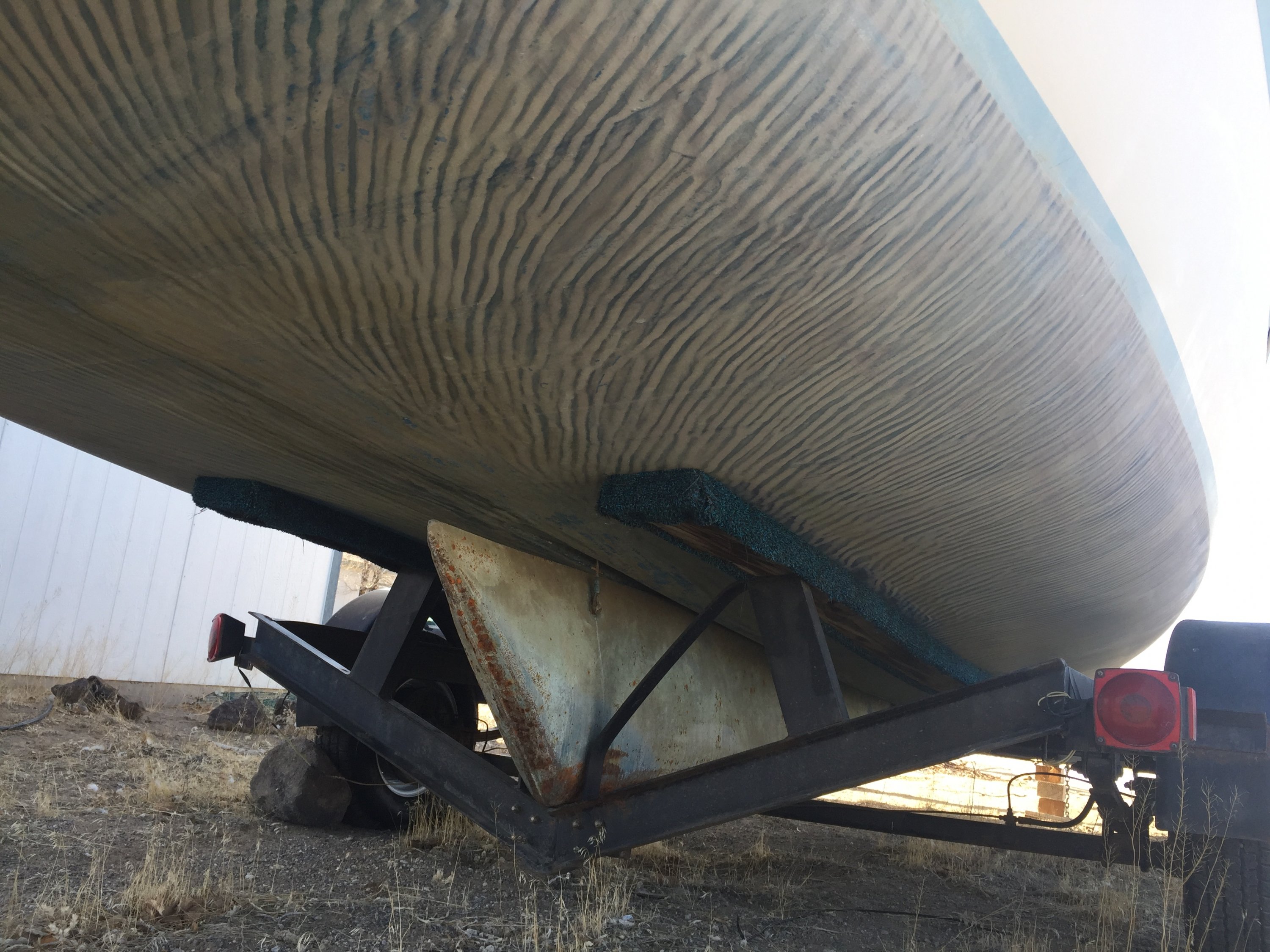

The hull appears to be in great condition structurally, however it has a strangely scuffed paint job. I will post pictures. No cracks that I have seen yet.

Good deal on getting the boat home and it looks like you are on the way to having some boating fun!!
..... however it has a strangely scuffed paint job...........
If you are talking about the bottom it looks like it had bottom paint on it keep barnacles from growing. Most trailer boats us ablative bottom paint that keeps wearing off to be effective. Google it.

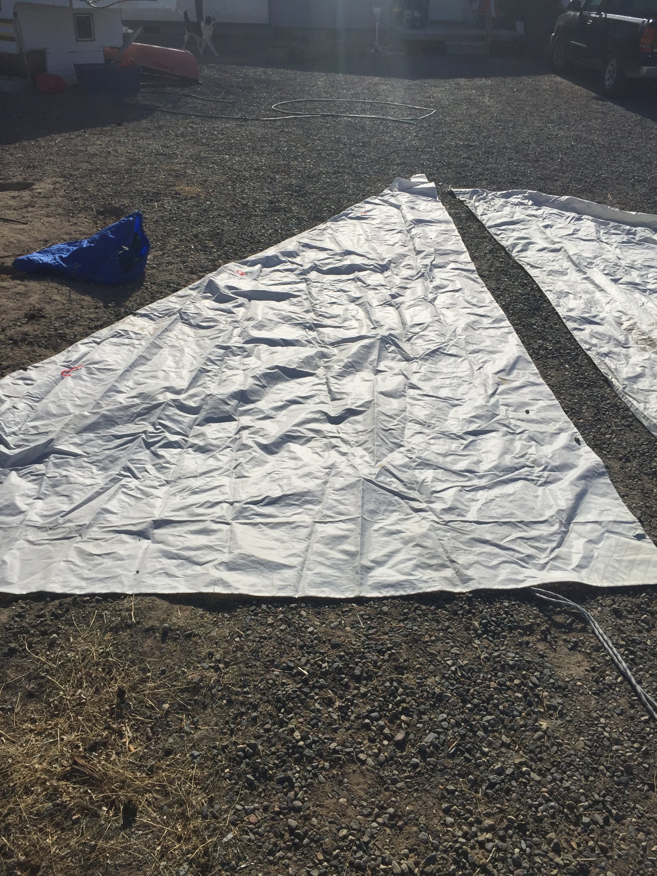

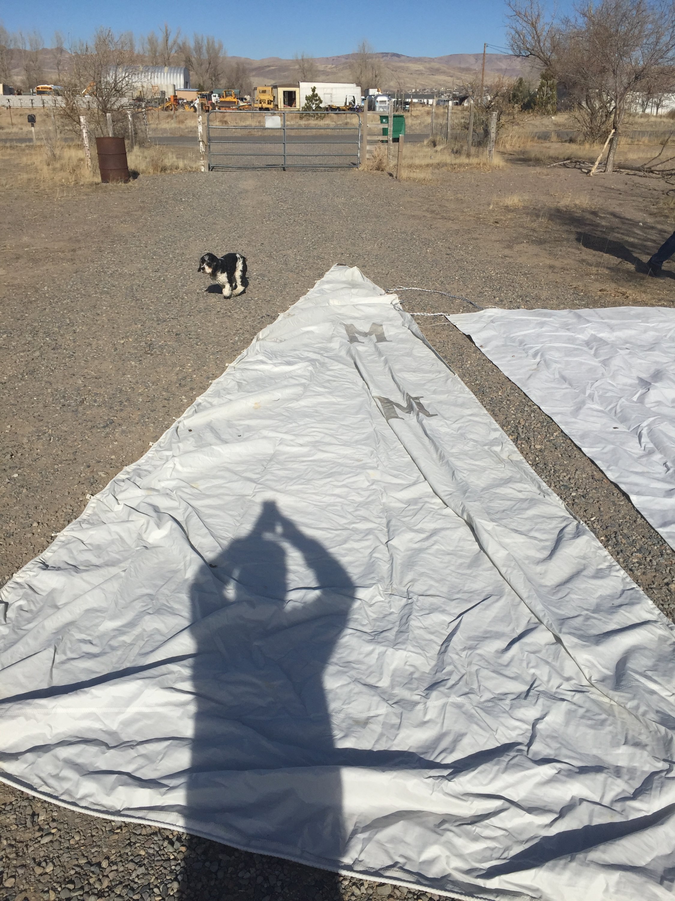

- I pulled the sails out today and laid them out on the ground. They appear to be in great condition. There are no holes/tears. I did see one patch, but it appears to be sound. All the stitching appears to be fine.
- I had a better look at the hull today and it is in really good condition. I googled "ablative bottom paint" per Sumner's advice and I believe that's what is on my hull. Pic attached. Feel free to take a look and correct me if I am mistaken. Please also feel free to criticize anything I am doing. I want to do this thing right.

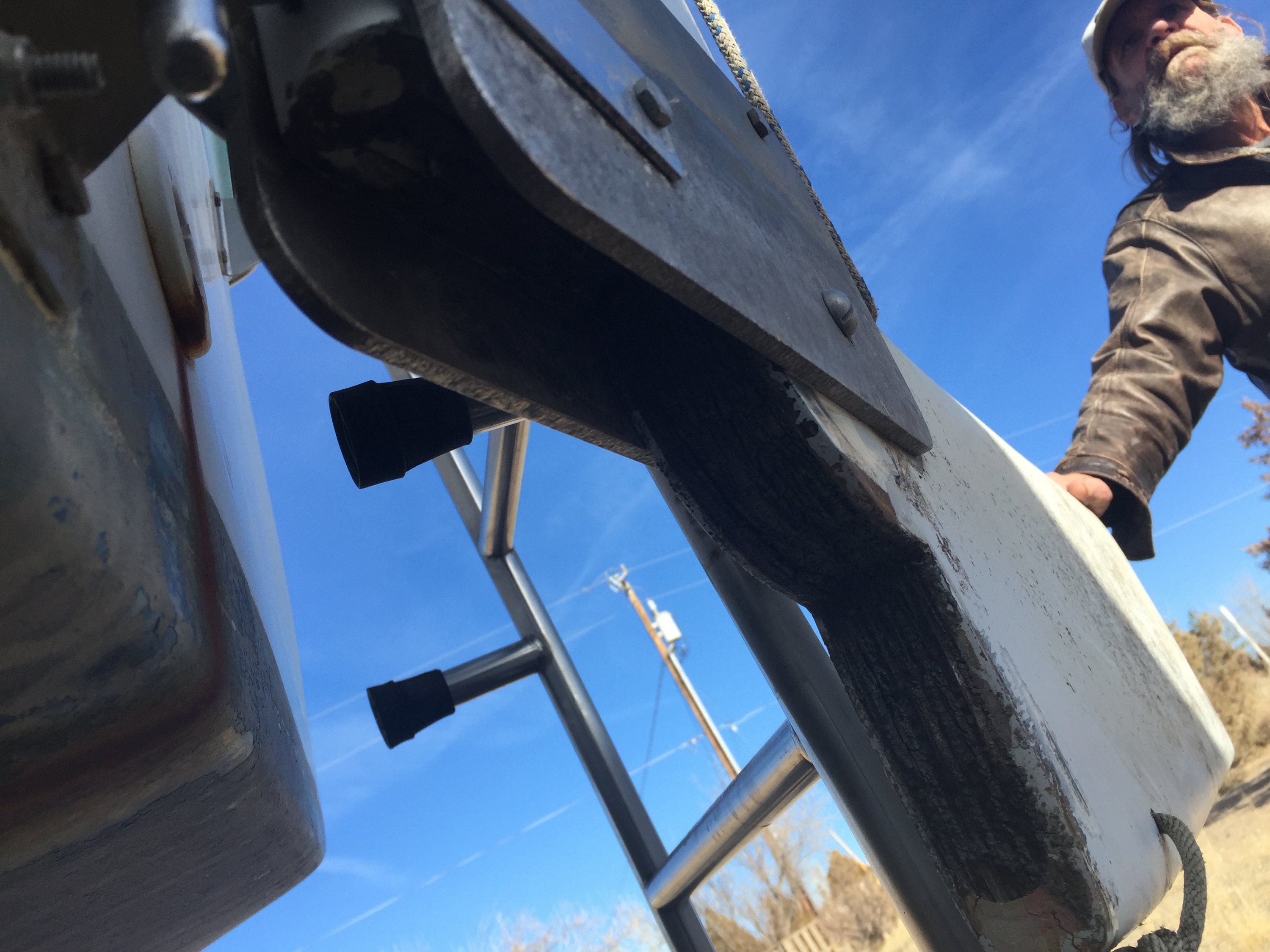

- My rudder appears to be pretty rough. It appears to be glue-lam plywood encased in fiberglass. It is hinged and the wood is exposed in the hinge. (pic attached) Some of the paint is chipping off of the fiberglass and the wood looks warn but not damaged in the hinged area. The rudder swings just fine, and the hinge works, but I am concerned with the state of the exposed wood. Please take a look at the attached pictures and advise.
They do look good, I wasn't so lucky and sailed 5 years on blown out sails

- My rudder appears to be pretty rough. It appears to be glue-lam plywood encased in fiberglass. It is hinged and the wood is exposed in the hinge. (pic attached) Some of the paint is chipping off of the fiberglass and the wood looks warn but not damaged in the hinged area. The rudder swings just fine, and the hinge works, but I am concerned with the state of the exposed wood. Please take a look at the attached pictures and advise. My rudder is solid wood. So no comment.

Rudder: Seal the exposed wood, but don't build up so much as to interfere with the parts mating. Store with the bottom part in the up position so that water drains off. Sail with the bottom part in the down position. It probably floats, so you may have to secure it in the down position. I'm guessing that is the function of the line attached to the lower part's leading edge.

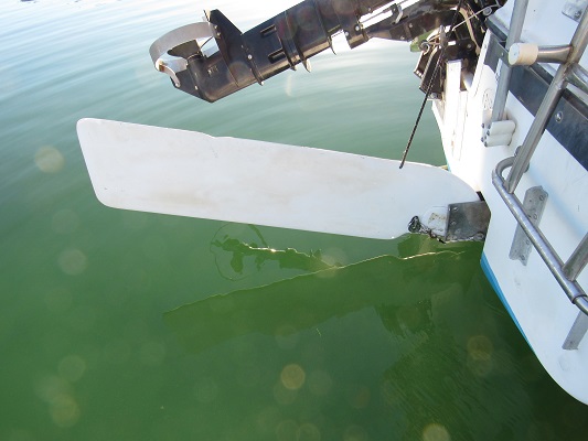

One note.. I cant tell if its the angle the rudder is at in the picture but it also looks like it might be a little short? I have a ruddercraft aftermarket rudder on my 26S and I didnt have a tape measure but estimated that the rudder itself is about four feet long - ie,, the section that is actually in the water is about four feet. I took this picture this morning. I think the 26S is similar in many ways to the 25.
I would not at all worry about this now - just go sail the boat. Things like rounding up from a rudder stall could be from all sorts of things but it could also be from too small of a rudder. Or.. maybe it was just the angle in that picture..

Walt, the 25 rudder is significantly different than the 26. Our neighbour had a 25 and that was at one point a topic of discussion. (No resolution but I recall lots of beer)
