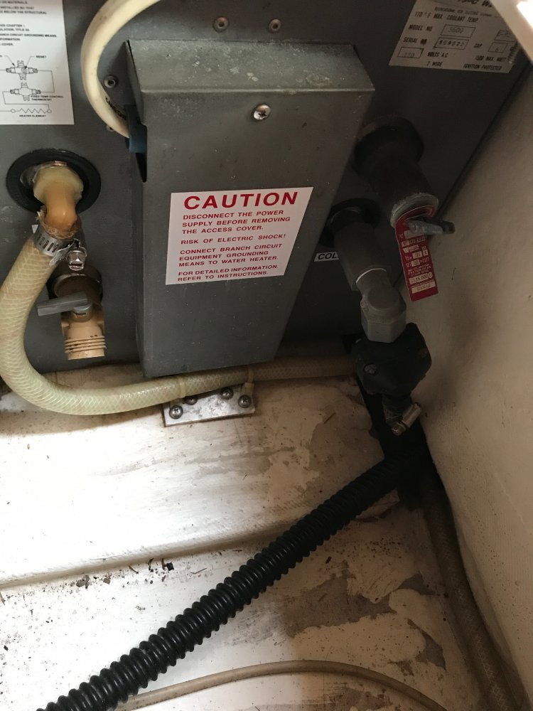

6F0377C2-7FCA-44B8-9009-6DA4238B9667.jpeg 33C79511-4259-40CA-9545-1B0450991C82.jpeg For the leak if fresh water and not antifreeze I would guess your pressure relief needs changing or you engine is running hot. The pressure relief is located right on the heater.

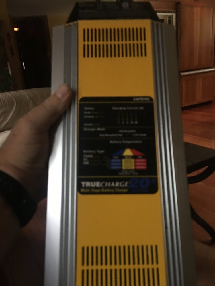

For the charger I think they rebadge xantrex truecharge. There was no switch in the one I took off / only the circuit breaker. All the DC wire terminals are accessible with out pulling any screws/panels. The AC requires removal of two screws on either side of the Black warning plate(see photo below). First look fo LED showing status. If no lights Check AC voltage By pulling the panel.
24,797

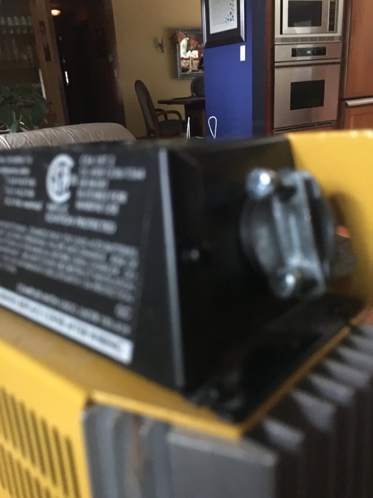

West Marine often labels their name on a charger manufactured by another party. Picture of charger, model number, both would help to identify the unit. How old is it? All would help to identify if "it is a lost cause".
The switch is often the AC power breaker labeled "Charger".
As for the leak. Put on your Sherlock Holmes hat and begin tracing all of the lines for water, dampness. You say it happens when you are running the engine. Is it clear or colored. Clear indicates likely from the fresh water in the heater, colored could be antifreeze. How old is the waterheater? Could it be reaching the end of it's life?

I installed a new fuel sender today and while the compartment was open I took a pic of the starboard end of the water heater for you. Guess my memory was not very accurate as I thought all hoses were on the port end but I was wrong. Only the engine coolant hoses on the port end.
Looks like the hot and cold water hoses run in front of the water heater.
Hope this helps.

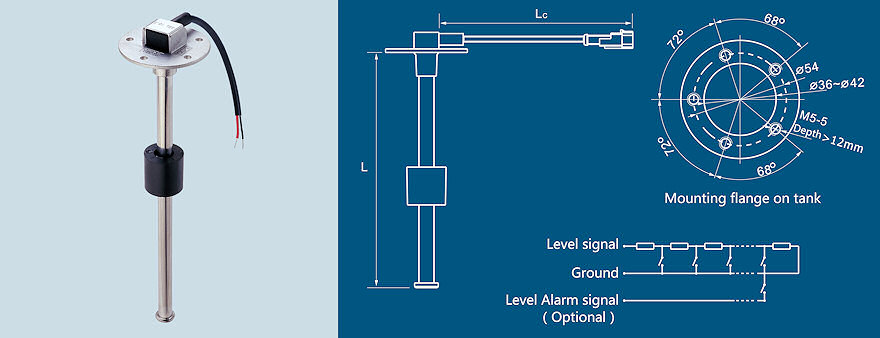

Here's a picture of the unit I bought.
http://www.wemausa.com/sensors/level-FuelWater.shtml
Need to size the unit to the tank.

Hi again Ward,
Did a bit more investigating on the leak. Turns out it was not the water heater. I had disconnected the fresh water, pulled and connected the engine hoses for bypass. I also completely drained the unit.
The leak only occurs after the engine warms up. No leak when engine cold. There is a small puddling of water under the cabin floor next to the stuffing box compartment where all the hose tees are. Stuffing box not the culprit. None of the connections are leaking and there seems to be no water trail leading to that point. My next attempt will be to try to pull as much of the hoses away from that area to see if any are cracked under the "no see" area I described.
