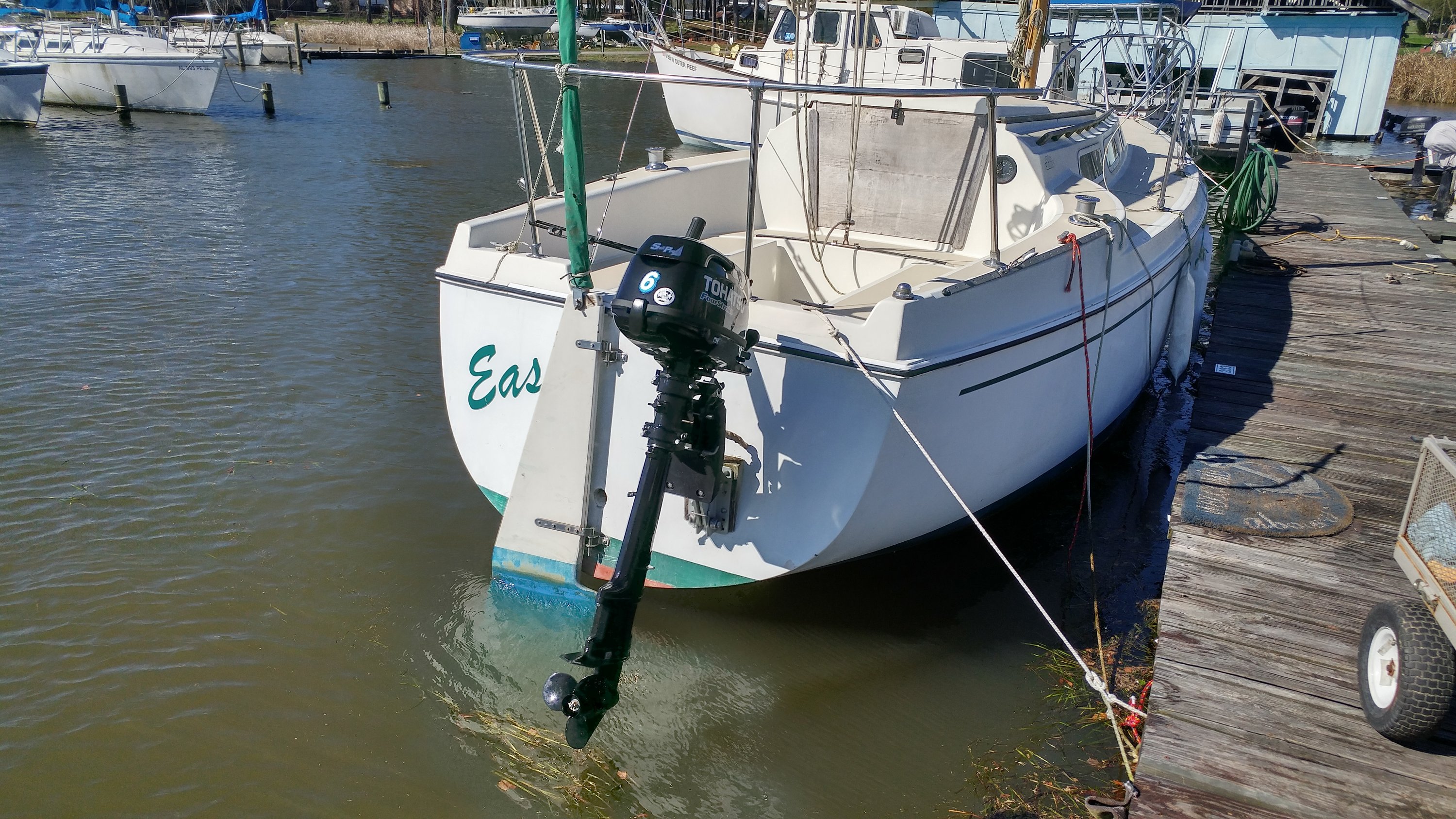

Can't wait to try out the new motor.

Tracks and traveler are on the list, but will probably have to wait a bit. I really hadn't planned a new motor but after 2 estimates, it seemed like the better money was on a new one with a warranty. I got the 25" long shaft which looks like a good improvement for depth compared to the old 20. I also reduced my stern weight by 10 lbs with the new motor too.
