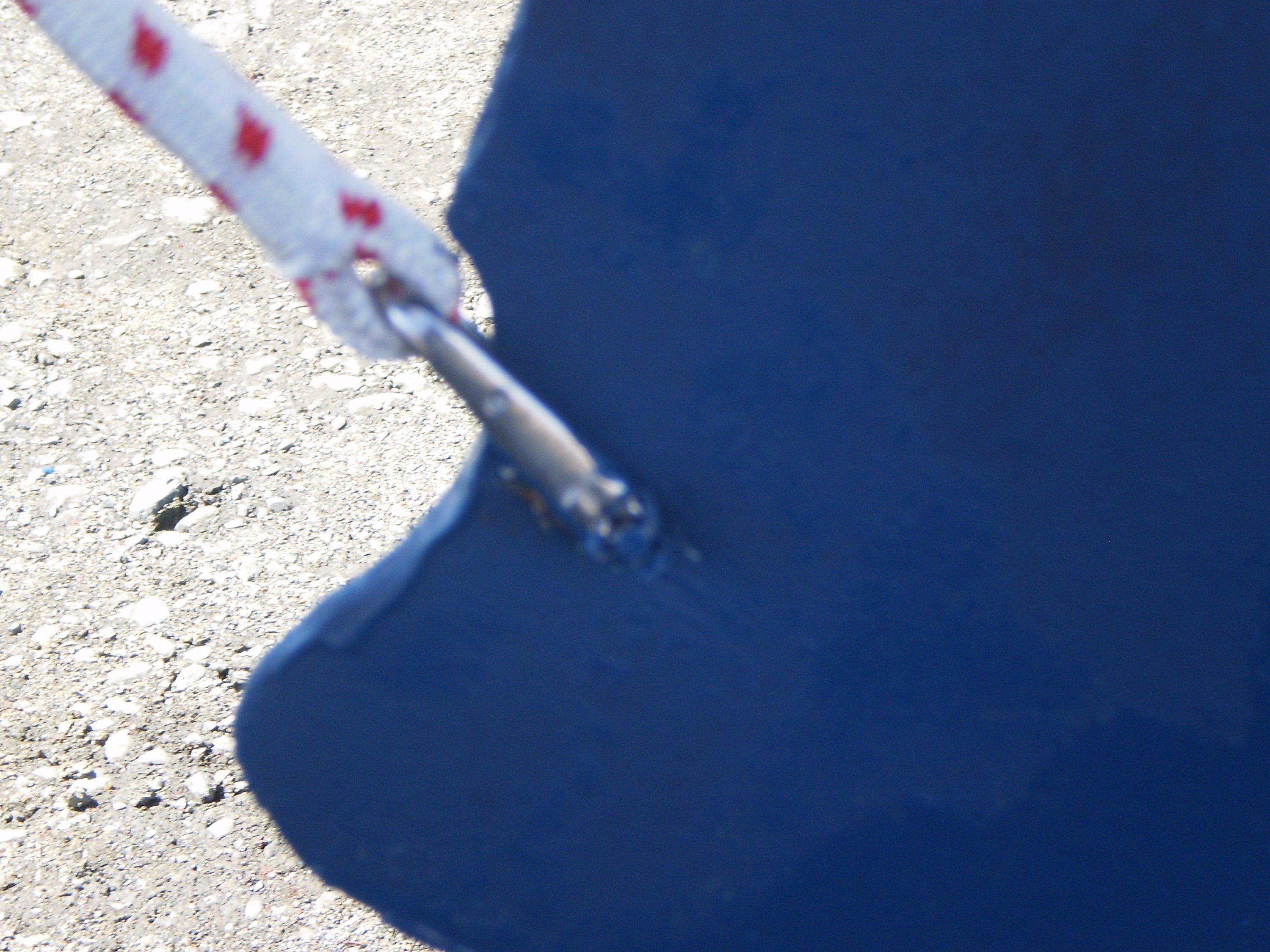

@John Tubb When my CB would get stuck up all the yard needed was a short pry bar to get it down with a quick flip of the bar at the rear of the CB trunk. Of course that was while hanging on the lift but underwater should work also. I tried my self underwater with channel locks and could not get a grip. I didn't have a boat ladder at the time so I never tried it again myself.
Here is what I would do. I would first take down some metal pallet strapping, the 1/2" or so wide stuff or something similar, about 18" in length. Wearing gloves I would try sliding it between the board and trunk on both sides. If it is clear, then I would know it is a pendant/shackle issue. If not either foreign material, swelling or crack.
Then I would try the small pry bar. Once down, if the strapping found a tight spot I would give that area good look and feel if I got the board down. Might tell you something. If it didn't find a tight spot concentrate on the way the line is tied to the CB. Shackle? Does the clevis pin feel longer than needed? Is there an eye splice or is it tied on with a knot? Or is it rigged another way? Is the pendant line oversized? (1/4" is fine, no more than 5/16" or it could be catching on the worn groove of the tube)
Remember, the trunk narrows near the top so anything that is none OEM may be causing you problems.
Good Luck. If you can't get it down, you can still sail. Just not as close to the wind without a bit of slippage.

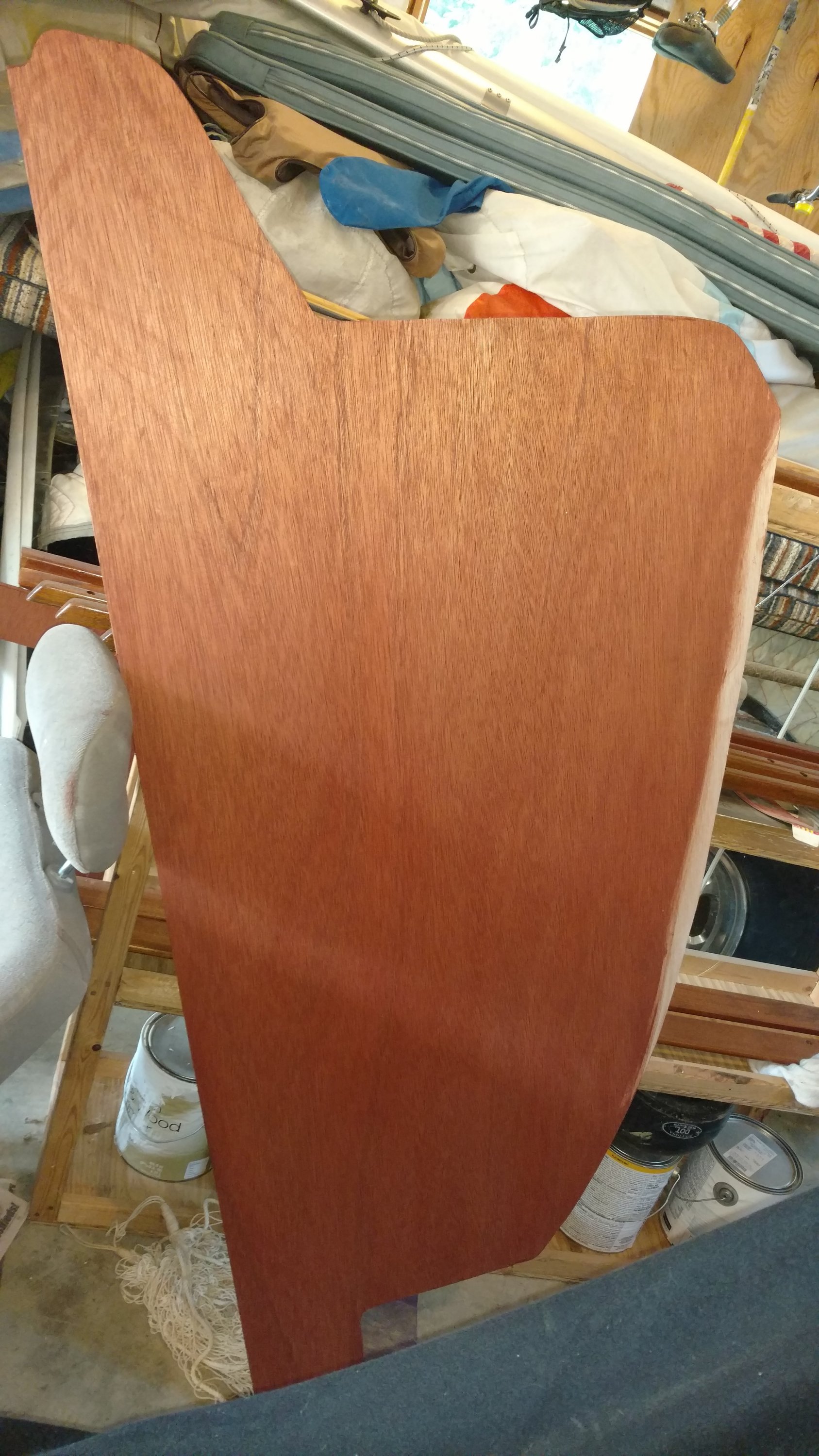

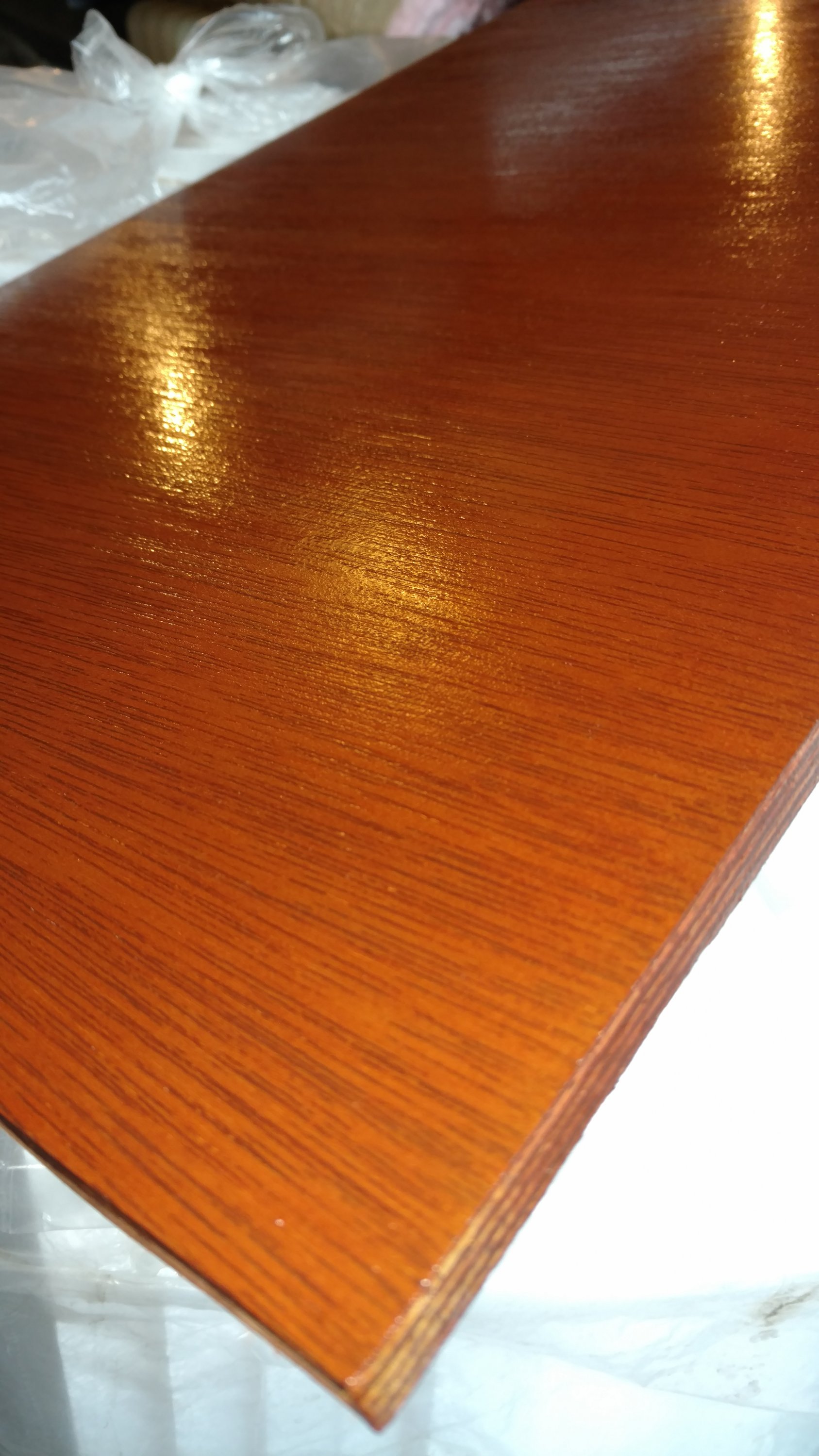

So the compression post is a SOLID Piece of Ash, Rudy, who worked for ODAY who is now with DR MARINES as verified that. He is a pleather of fantastic information for any ODAY out here. I actually have replaced my bulkheads 1/2" you can use Marine plywood, or Mahogany, if you use Marine plywood and you plan on staining them Teak, you may have a hard time with the stains sticking. Mahogany is very durable, you can take a piece of Mahogany and leave it out and it won't rot. The very bottom pictures are the Marine Plywood, the two top is the Mahogany.

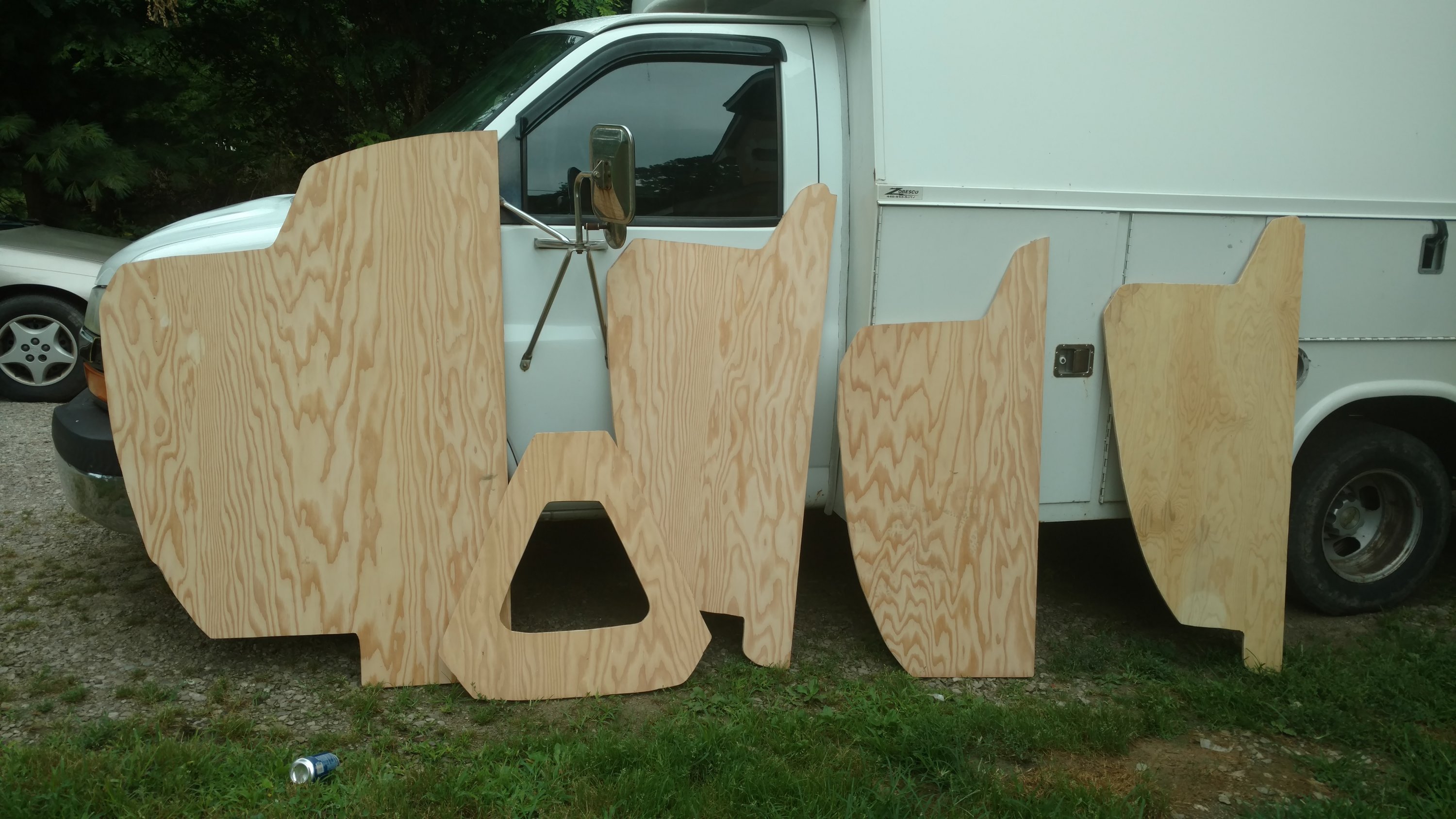

Littlebobber those sure are some great looking bulkheads and the finish looks top notch.
Thanks Pat, so far the boat has been great for our use, it has been a few weeks since we sailed because of a move and weather but I'm sure we will get out soon again.
So my Port bulkhead is in great shape and solid with no rot above the chain plate, the starboard was a different story with rot above the top fastener. The compression post was black, but dry as was the starboard bulkhead. My initial tempory repair was to install SST backing plates that extended 12" into the bulkheads inline with the glassed tabs that hold them to the hull. I then used the git-rot penetrating epoxy on the rot in the bulkhead and even did the bottom of the compression post. The good news was that there was solid wood in the compression post for the penetrating glue holes I drilled, it was actually dry and very solid. I still think I want to redo the bulkheads this winter but my chain plate backing and git-rot is probable good enough for our day sailing adventures for awhile.

Fun family sail day, not a lot of wind but managed to make it out under sail. Did a heave too and went for a swim with kids and a very quick dive got the centerboard down. Really didn't take much to get it unstuck. The water was too murky to get a clear look but I bet it is the shackle.
