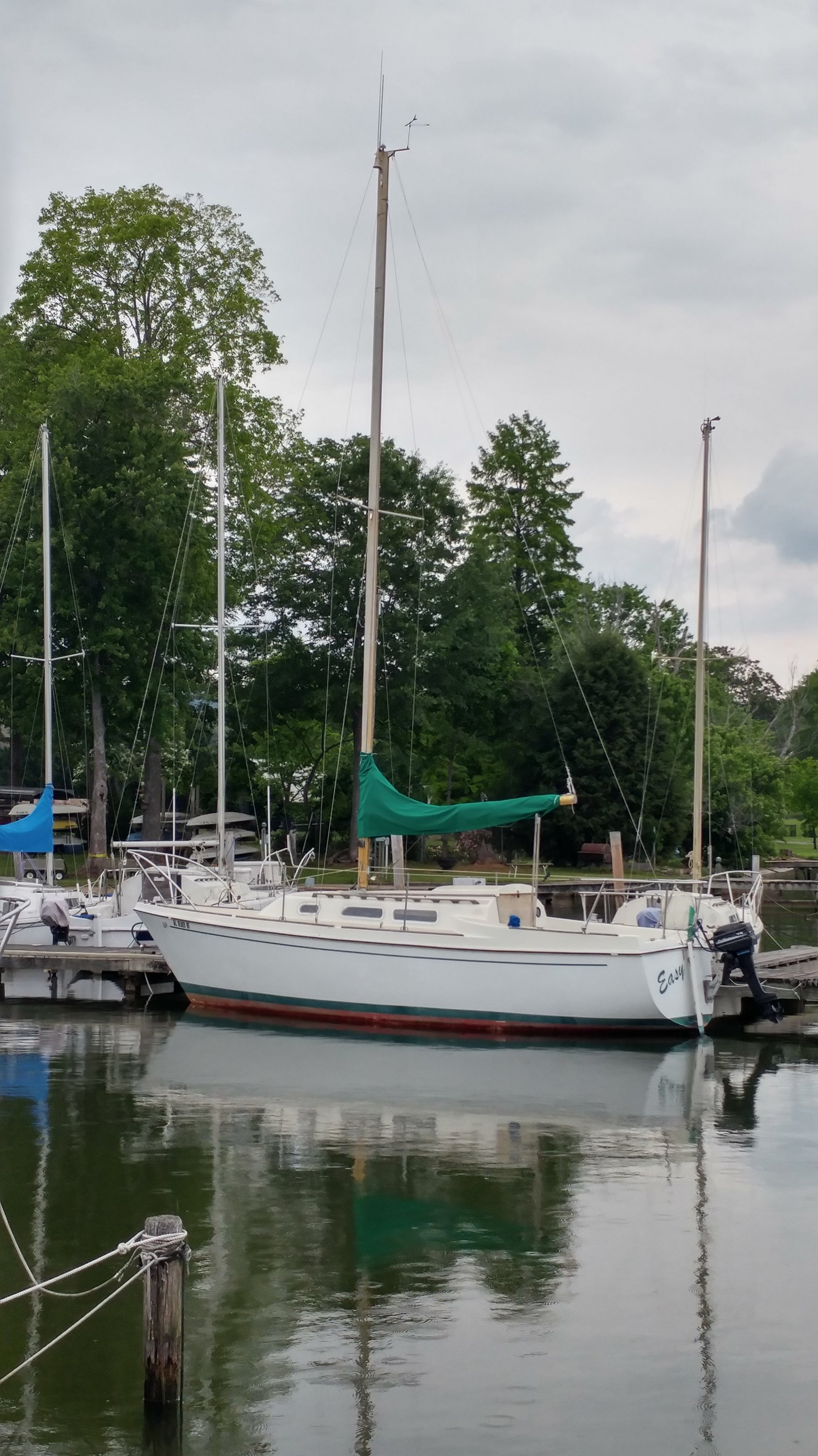

My manager said I had too much vacation time and need to burn some down, so I went to the boat for a few odds and ends and cleaning for mother's day sailing.
Likes: Ward H
Ward H
Nov 7, 2011
3,843
Yep, that is what I would use. Then measure and get some spares.
Boat looks good sitting there.
Weather has been slowing us down here in SJ. This coming week it is going to warm up and be a nice week. Took some V time to finish spring maintenance. I'm on the schedule to be dropped in on Saturday, a week later that I wanted but still on schedule for June 1st when the word "schedule" is dropped from my dictionary.
JRT
Feb 14, 2017
2,059
I did a few things, replaced the 2 bus bars with proper marine ones, cleaned up the very half donkey electric water pump electrical and plumbing, then some organizing and securing of things in the cabin. Had a nice lunch on the boat, AC rocks even if it is a bit homemade.
