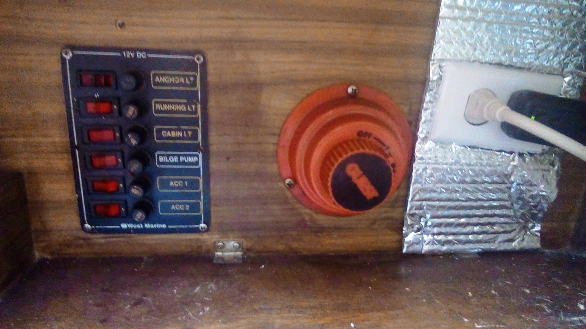

This picture, the "on red" light burns out, dam bulbs up top burn out too, bad design... I'm trying to find something to chew up and spit... bulb is out top mast, 14 months, that's anchor light but I added extra one 39 inches off Gunwale starboard rear, full " I can see it " value, no ticket please. I don't care that the light switch red light don't work as long as the switch itself works. The round thing is banks, solar on second bank would be nice.

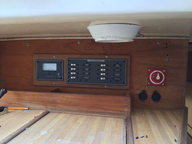

Ward H
Nov 7, 2011
3,792
Found this pic of my "new" panel. That light was replaced with a new Marine Beam fixture with one of their Red/White LED bulbs.
The volt meter is not be the most accurate way to check state of charge of the battery but works for me.
I have one group 27 battery. I run my GPS, Depth Finder, Auto Tiller Pilot, occasional LED lights and occasional charge of cell phones. My OB has charging and runs for about 3/4 of an hour for each sailing trip. I went out something like 300 times last season including some late night outings. Battery holds up fine for my use without additional charging.

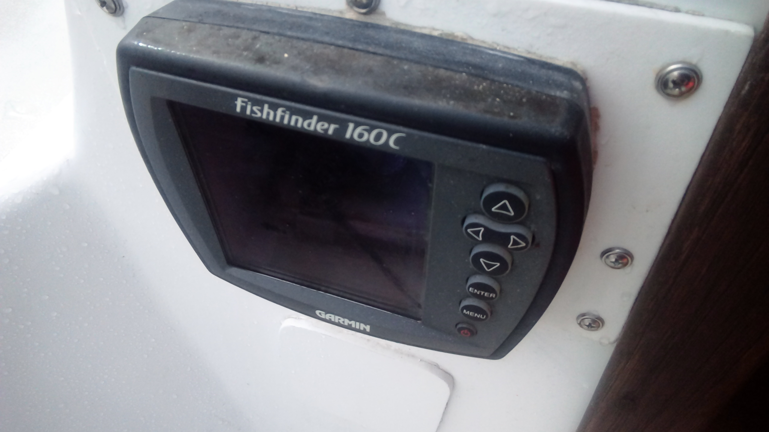

My fish finder, Garmin connects directly to a battery. The sensor at rear so when I hit sand bar then the depth alarm goes off. I don't know what I think about all this other than it's wrong some how.
