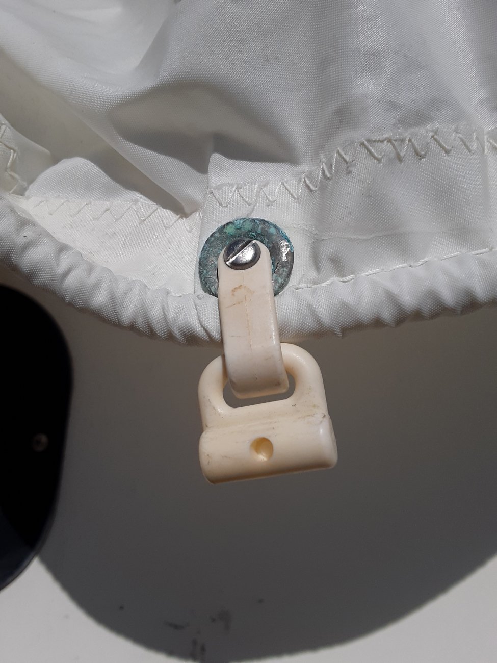

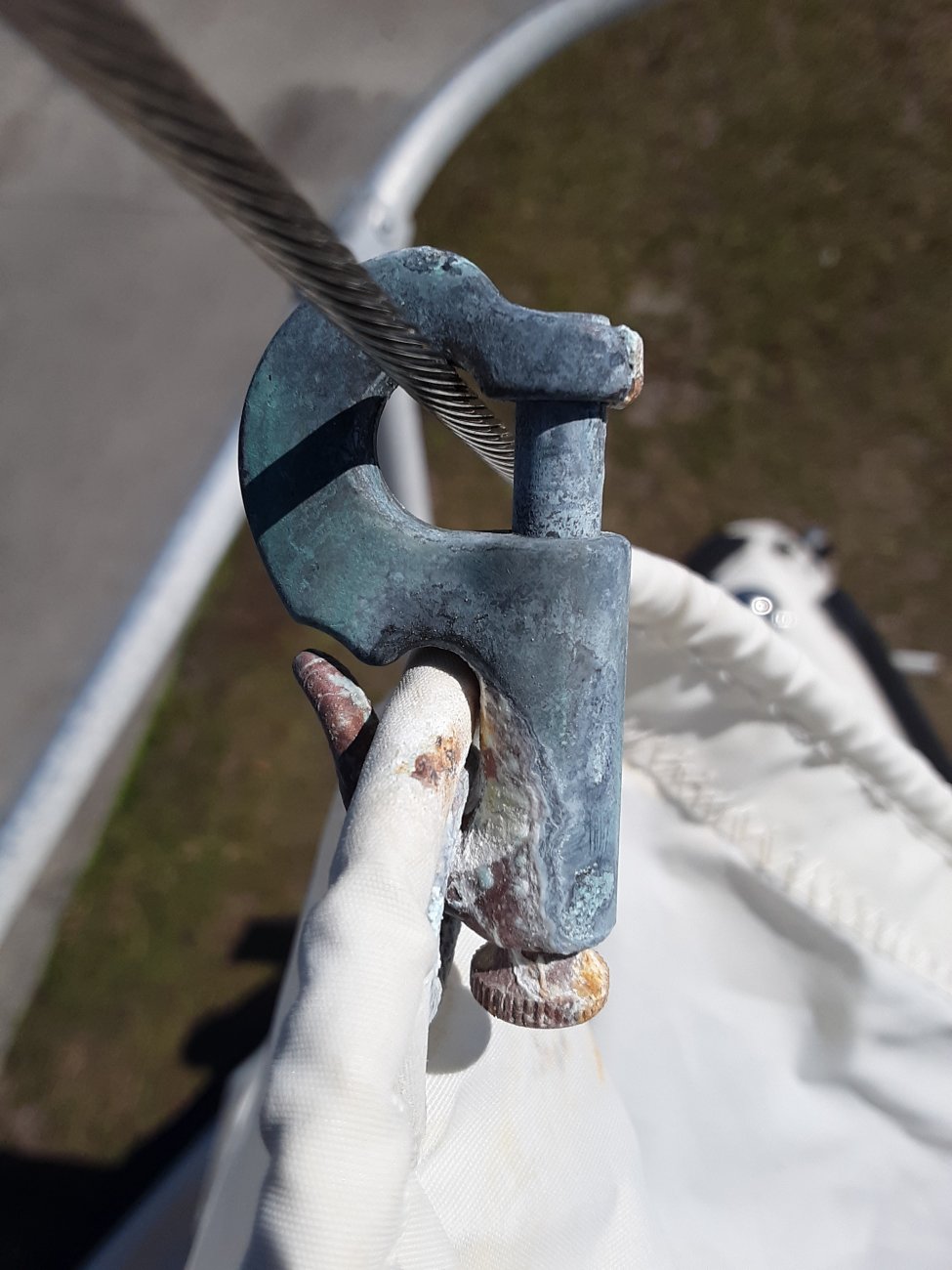

Thank you to everyone for your help, now on to other news...she's officially mine (took today off for title and registration transfer)!!:clap: Since I was left "unsupervised " I stretched the sails out to see what I have, turns out 1 main, 1 jib, and a Genoa. Question about the hanks and sail lugs, most of the pins on the hanks move, some however need a little encouragement, replace or refurbish? The lugs are plastic and the UV hasn't been nice to them, do they come in aluminum by chance?

Shop around, but piston hanks are not that inexpensive (for example: https://www.sailrite.com/search?keywords=piston hanks). So I'd be inclined to try and clean them up. At around a buck a piece, sail slugs are cheap, I'd buy a bunch and replace them as they fail (https://www.sailrite.com/search?keywords=sail slugs) There are likely other sources for these items, it was just very easy to find them on Sailrite. Try looking in the SBO store too.
To free up the hanks, I'd try Liquid Wrench or PB Blaster being very careful to keep the fluid off of the sail. A little probably won't hurt, but too much might weaken the fabric. If you try to remove them, the tab may break.

Ya, I would not start throwing money at the sails, if you have 3 sails and they are Neil Pryde Sails, I bet they are original and not that great based on the hank condition for sure. That slider doesn't look correct for the mast, it should be a flat slider. That on is probably for the clew and I bet that main is also attached to the boom the along the foot, which is also just terrible for adjusting sail shape. Save your money and get new sails. Did we mention D&R is your new best friend in O'Day parts that SBO doesn't stock?
http://www.drmarine.com/products.asp?cat=187

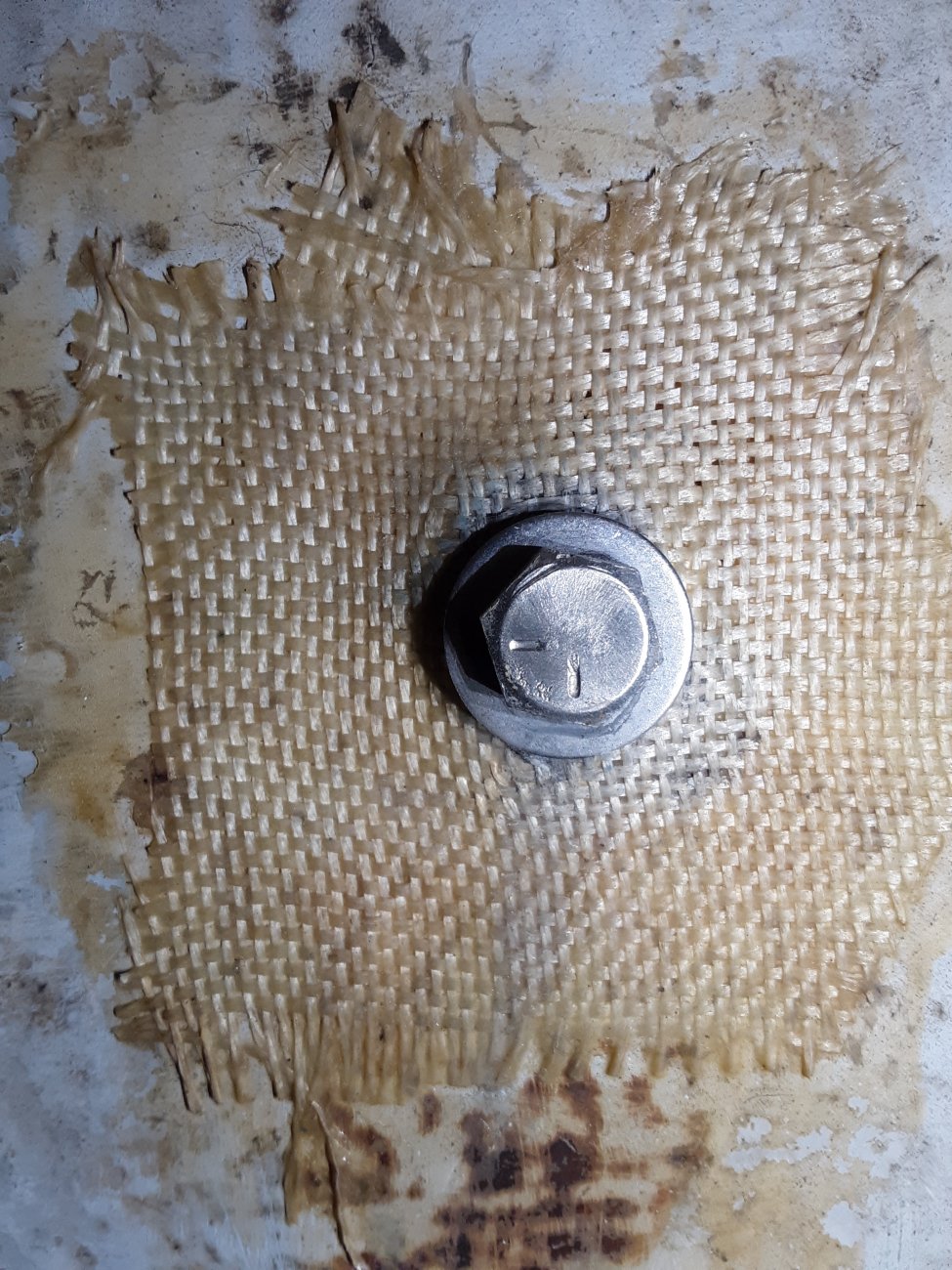

Good morning all, sorry it's been a hot minute since I've posted, been installing new parts and rigging. We finally got her out on the lake and had a great time. The general consensus from the family on a scale of 1-10 is a 8.5!! Everyone enjoyed it!! I ended up coming across a 70# minn kota which pushes my little boat just fine. We had a few hiccups, 2 of the little plastic deals that hold the sail slugs on the main broke, we couldn't get the main raised to the top of the mast, oh and she's taking on water. We found the water intrusion problem is that pesky CB pivot bolt, I don't think the PO took maintenance or repairs seriously. That's it so far, I'll be in touch with more pics and updates as soon as I'm able. And I want to thank everyone again for the great advice and answers.

Those plastic deals are called slugs. These degrade in the sun and break. Most chandleries that cater to small sailboats will have some, or check Sailrite.com or Defender.com or even here on SBO. These are not expensive, shipping will probably cost more the slugs. Get extras.

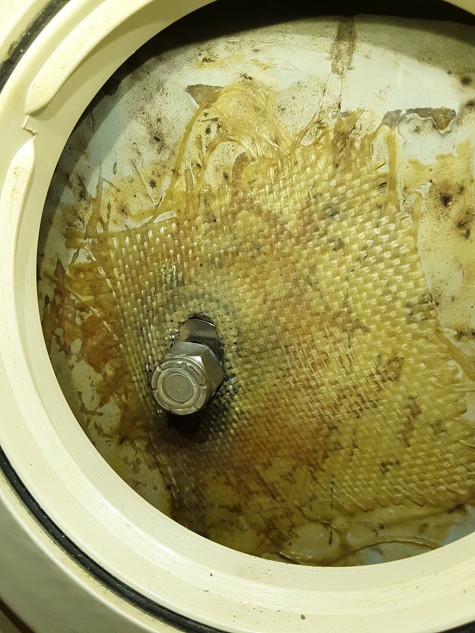

That patch on the pivot bolt is poorly done. There is not enough resin in the glass. If I was to do the repair I'd think about some sort of more durable backing plate glassed to the CB trunk. Something substantial that the bolt can bear on.

The CB bolt is one of the most common places for water intrusion. Here's a link to an SBO discussion about that very issue:
https://forums.sailboatowners.com/i...-fix-a-leaking-centerboard-pivot-bolt.165760/

As Dave has pointed out the centerboard patch bolt hole needs more work. It will temporarily hold but it will breakdown and again leak. The problem is not only the water splashing in but the centerboard slapping about in the well. Water splashing up in the well is normal.

I definitely agree with the shoddy repair to the CB trunk. I'm torn between glassing in stainless plates or marine grade plywood, and access to the starboard side is going to be difficult as there is only a 4" inspection hatch to work thru. One option I have considered is just getting a larger port, but am unsure if that would adversely affect the strength of the footwell (sorry, lack of a better term and no pic of it either). Any suggestions?
I also took a look at the CB itself (haven't removed it yet, want to get measurements for spacers while it's still in the trunk). It looks to me like the bolt hole thru the CB is wallowed out, so I'll have to sleeve it or upsize the hardware. Any thoughts or advice on that issue?
Basic plan so far is make my own CB pivot bolt and washer setup as suggested in the thread (thanks will ), and reinforce the trunk. Not sure about the CB yet until I get it down and out.
24,455
For best ideas perhaps a picture from further away to give us context would help us closet engineers with more info on existing structure.
