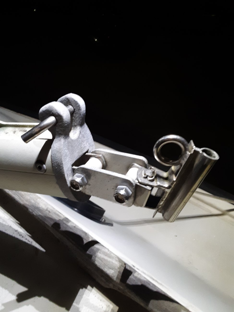

I know the sail lugs and rounded end of boom hardware (sorry, forgot the name of the part in question) go into the masts slot, but what holds said boom up when we decide to lower the main?
Welcome, we're always glad to answer questions from new sailors and encourage them to sail.
The fitting that connects the boom to the mast is called a goose neck.
There are several options to protect your wife's head. A topping lift is a line that goes from the top of the mast to the end of the boom. Make it adjustable so it can slacked off when sailing.
A boom kicker can be installed that supports the mast when the sail is down. Works with a vang.
Finally a short line can be attached to the back stay that can clip on to the boom and support it when not sailing.
Google Sanibel 17/18 images to get some ideas.

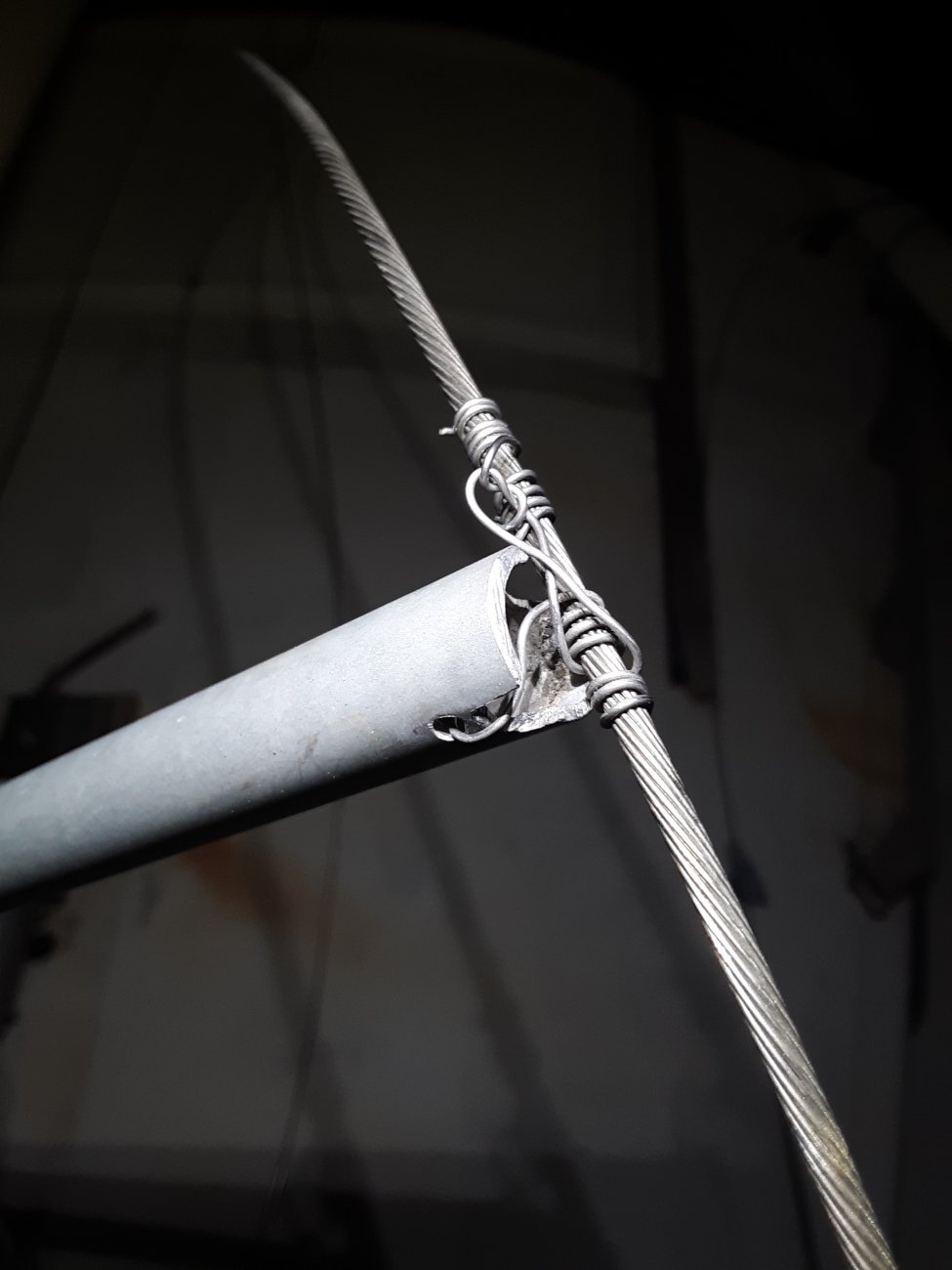

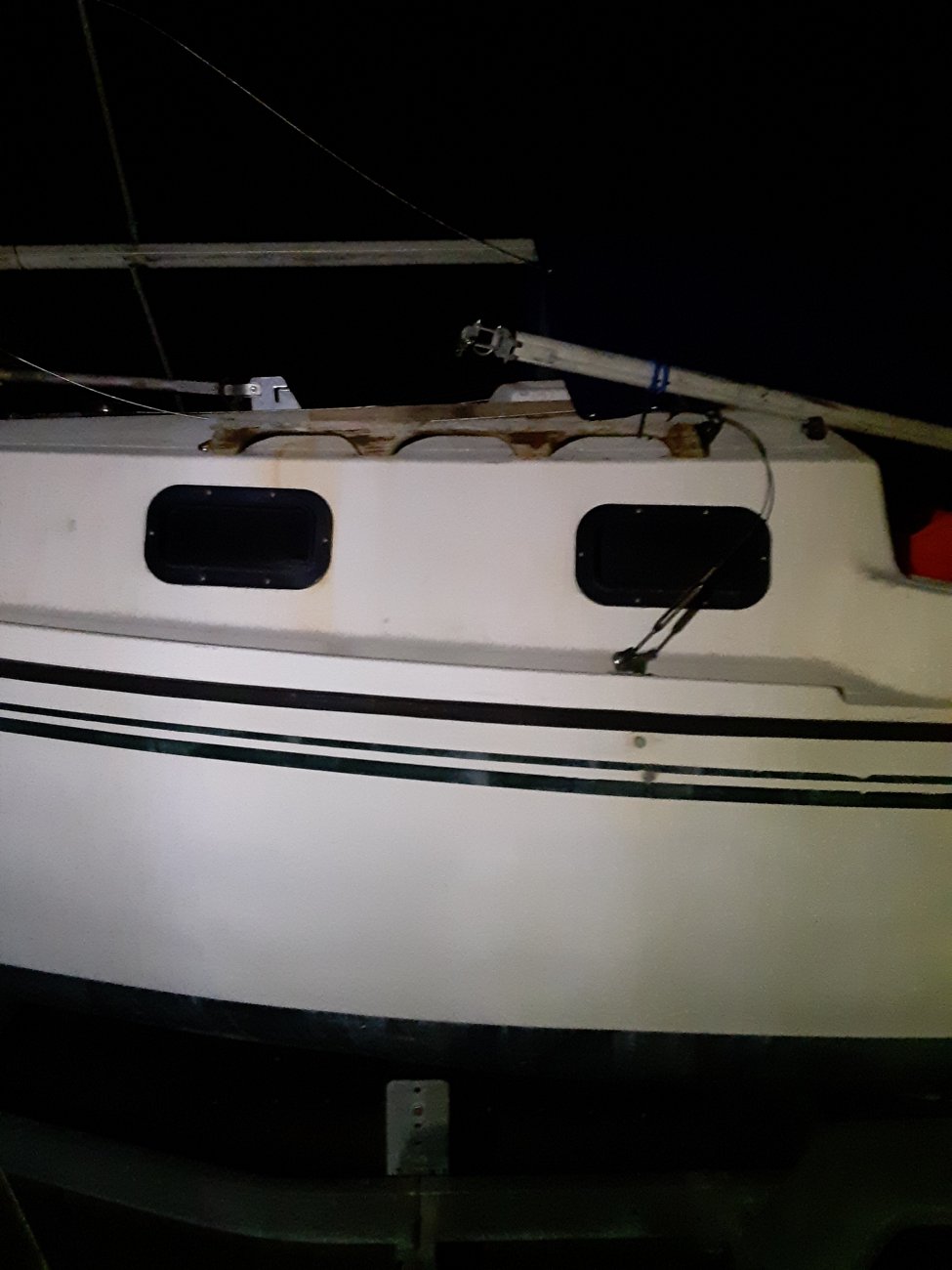

The spreaders are also a concern, something just doesn't look right. And lastly should there be an aft stay? There's no place on the mast head or stern that would indicate one belongs there. Or do the shrouds act as the aft stay since they attach approx 2' behind the mast step?
Yeah, the end of the spreader looks a little shabby. There should be a better way of holding the stay in place than some wire.
If the spreaders are swept back, then the boat was likely designed without a back stay. The swept back spreaders serve the same purpose.

(1)Check sailboatdata.com for information on your boat if you do not already have weight, length overall, waterline length, etc. If there is a drawing of the boat it will verify whether there is a backstay or not. Small boats often rely on the shrouds and the forestay to hold the mast fore and aft when the sail is lowered or removed. The sail, through use of the mainsheet, will pull aft on the mast when you are sailing.
(2)The forward end of the boom has a fitting called a gooseneck. It fits just as you mentioned into the sail slot on the aft side of the mast. You can purchase a thumb-twist fitting to stop the boom from falling too far when the halyard is released to lower the main sail. The forward end of the boom also has that bent key that will hold the tack fitting on the sail (forward, lower end grommet). The ring on the gooseneck is for a "down haul", a line to hold the boom down when you raise the main sail. That fitting might be installed upside down in the picture because the ring would be more likely on the bottom, I think.
(3) The end of the spreader does look a bit funky. Is there a broken piece of metal there? The shroud should go through the end of the spreader and it should have a 'boot" on the end to prevent chaffing (sp?) of the jib. The wire needs to be replaced, although a wire is necessary. Small size stainless steel wire is good...doesn't need to be very thick.

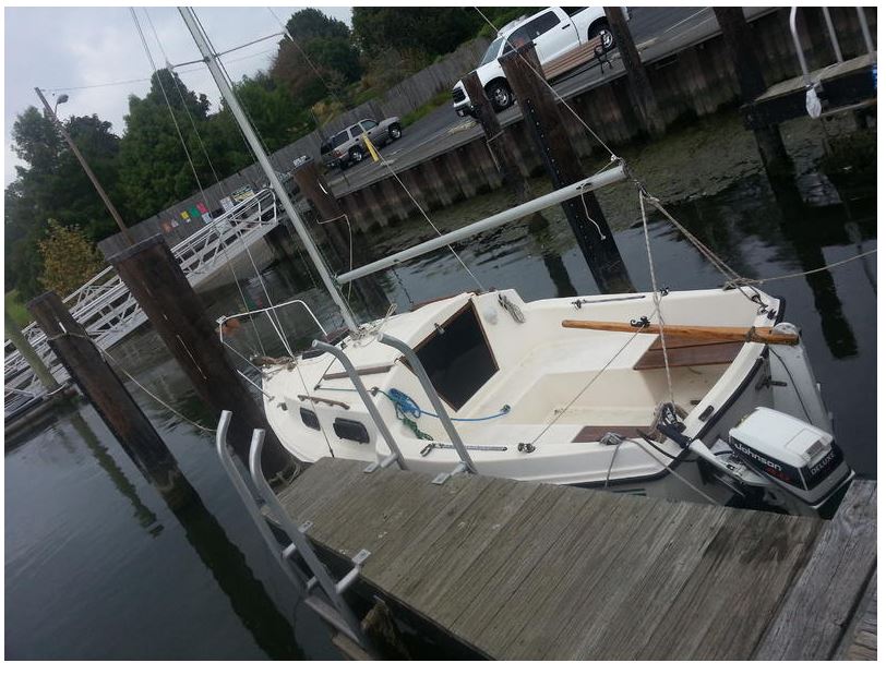

The sailboat data web site might be of interest to you. It's very basic but there is a rigging schematic that shows a backstay. https://sailboatdata.com/sailboat/sanibel-1718 Topping lifts are probably the most popular way to hold the boom up.

I'd look at the top of the mast, is there a tang or bolt hole for a back stay, it is a fractional rig so the fore stay is obvious on the front of the mast below the top some distance from pictures.
Here is an 1986 listing with a clear phot of the stern, sure doesn't look like a back stay on that and the mainsheet is an interesting arrangement.
http://sailingtexas.com/201101/ssanibel18102.html
I certainly won't fly any large overlapping jib with that rig or spin in any serious wind conditions. I bet some racers added back stays them to fly big sails, but sure looks like you would have mainsail interference.

  1. Yes your image of the spreader looks wrong. Worn. It would help if your have a picture of the other spreader. Often on boats with 2 of something (spreaders) there is a good one and a bad one. Matching the set up on the good one is the easiest trick to repair. Of course that assumes the one not shown is a good one and not something a previous owner mad up on the fly. Then you need a new idea. What looks bad is that there are several holes through the end of the spreader. They look like they have had the spreader run through them (spreader broken, drill hole, put wire thru, go sailing) repair. The repair was done poorly and then done again. It is a repair without considering the materials. You want spreaders to be light weight. Yet strong where needed. If the repairs were done as conjectured, then I would want to inspect the stay for damage. If the stay did wear the holes long then it is possible that the strands of the stay were damaged while the boat was sailed.
  2. The gooseneck... may be inserted in the boom upside down. This is based on the SS ring welded to the slide. It could be rigged with the ring up - as a cunningham (https://en.wikipedia.org/wiki/Cunningham_(sailing)) to run a line up the luff of the sail and back down pull the sail luff tight (you would need to examine your sail), but more likely it is rigged with the ring down and used as a downhaul to pull down on the boom until the boom is level and the sail luff is then tensioned using the halyard. Either way you adjust the luff of the sail to optimize the sail performance.
  3. I am of the opinion that the rig does not use a backstay. First because the tiller is in the way (unless the rig had a split back stay) and the positions of the port and starboard stays (shouds) are back far enough to support the stress on the mast against the foe stay. Clues (picture missing) would be the on the top of the mast. Is there a fitting and wire on the aft end of the mast head to rig a back stay? The pictures I found online do not indicate a back stay. My 15 Montgomery was rigged in a similar manner. Note when it comes time to tune your rig I would expect the boat to sail faster if the stays are somewhat loose.

Neighbors of mine just bought a Sanibel 18 last Sunday. I can drive by and look at that boat and see if it has a back stay- I don't recall one, but could have.
Agree on adding a topping lift- easiest way to hold boom up. Those pigtails hanging from the backstay are dangerous things. When I was associated with a sailboat shop, we ALWAYS cut them off and rigged a topping lift.
Looks like one of the smaller Dwyer spreaders to me. The ones on my Gloucester have an aluminum fitting that the shroud rests in, but the little ones just have a slot in the tubing for the shroud with a hole inboard for wire.
The gooseneck … more likely it is rigged with the ring down and used as a downhaul
That's how it's done on West Wight Potters.

Got nasty, wet and cloudy, and wind jumped into almost 20, so didn't take any pics-But- the boat has no backstay- has swept back spreaders. Does have a topping lift.
