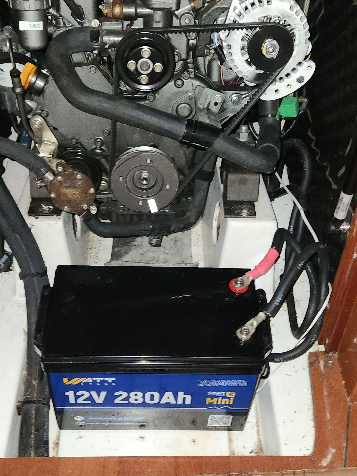

I just replaced two group 34 AGM batteries with one LFP. I saved about 20 pounds and have about 6 times the usable capacity.
The install isn't finished yet. I need to buy some hardware and strap the battery down. I also need to add a DC to DC charger.
I have reprogrammed the charge and float settings on my Pronautic P1230 charger. I set it at 14.2 charge and 13.2 float. I verified that it stopped charging when the battery was full.
The alternator is presently connected to both the house and start battery though an isolator. With the charger on and the engine running the charge current was at about 45 amps. I ran the engine for about 5 minutes at cruise rpm and the alternator barely got warm. The charger is only connected to the house battery. It pumped out 30 anps for hours, it got very warm.
I will probably add a DC to DC charger. It with draw from the starter battery and feed the house battery while the engine is running. I am also considering adding a trickle charger for the start battery.

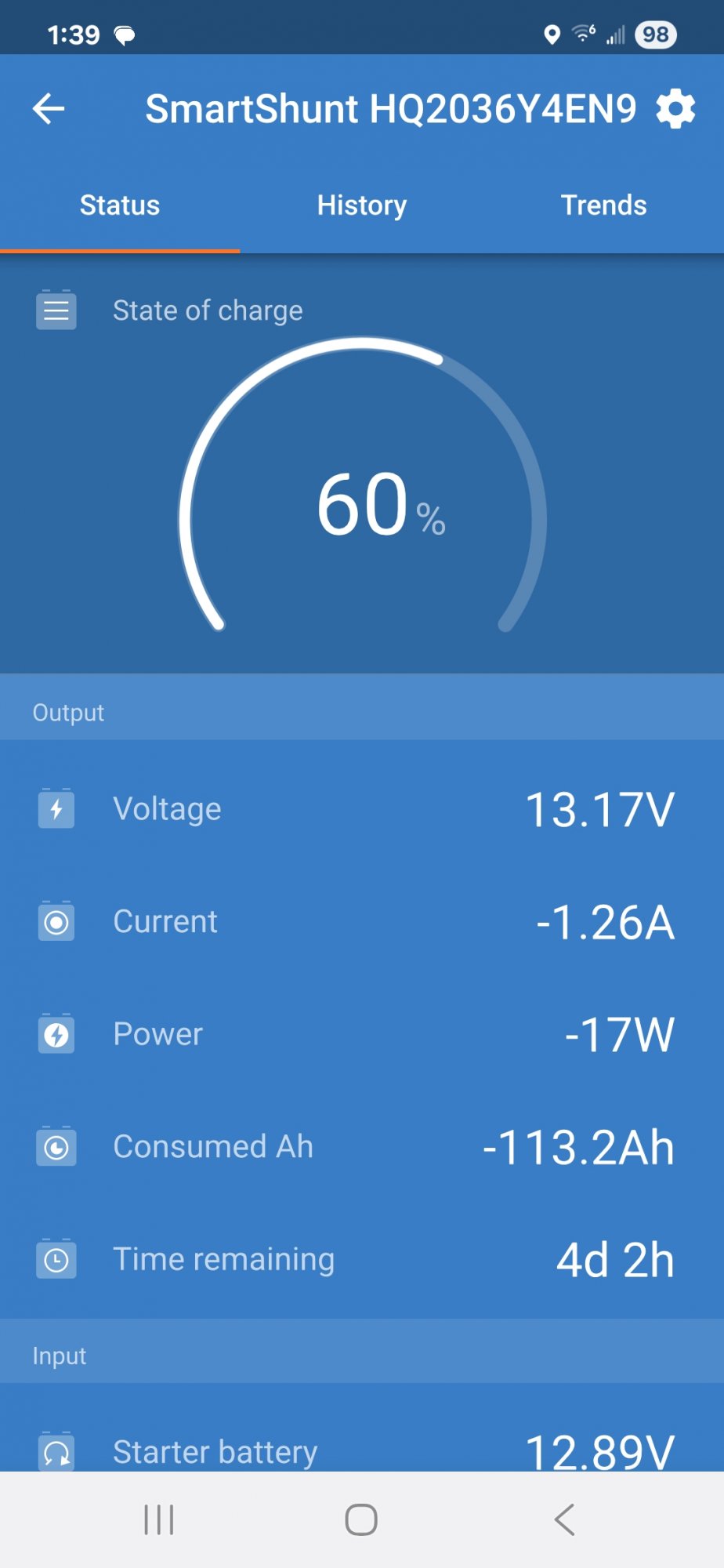

I also have a Victron Smart Shunt to help keep an eye on things.

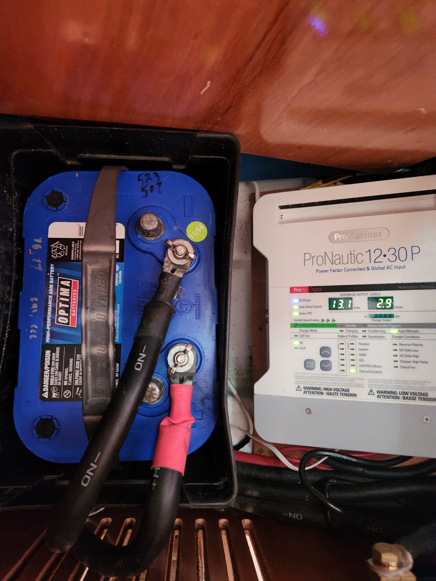

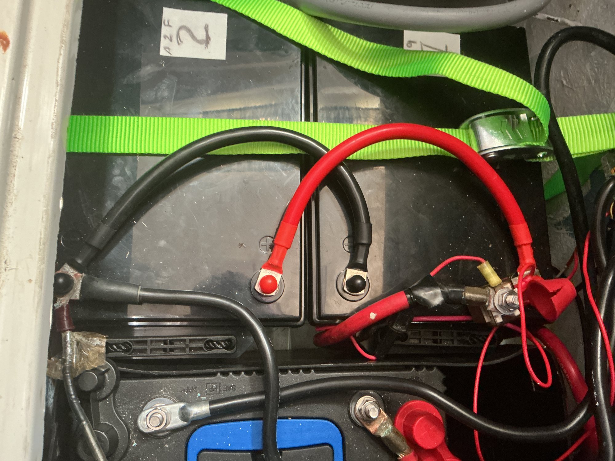

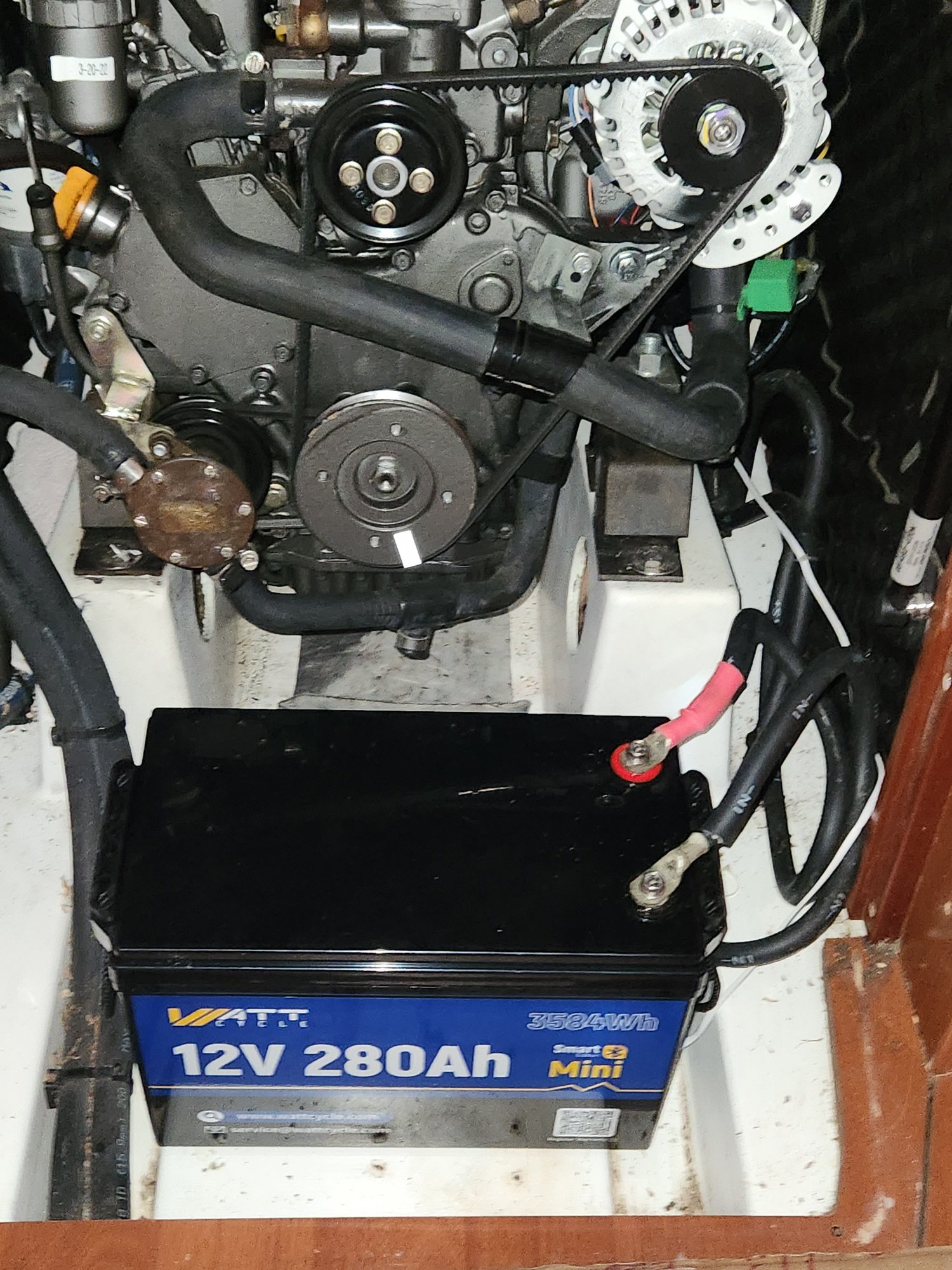

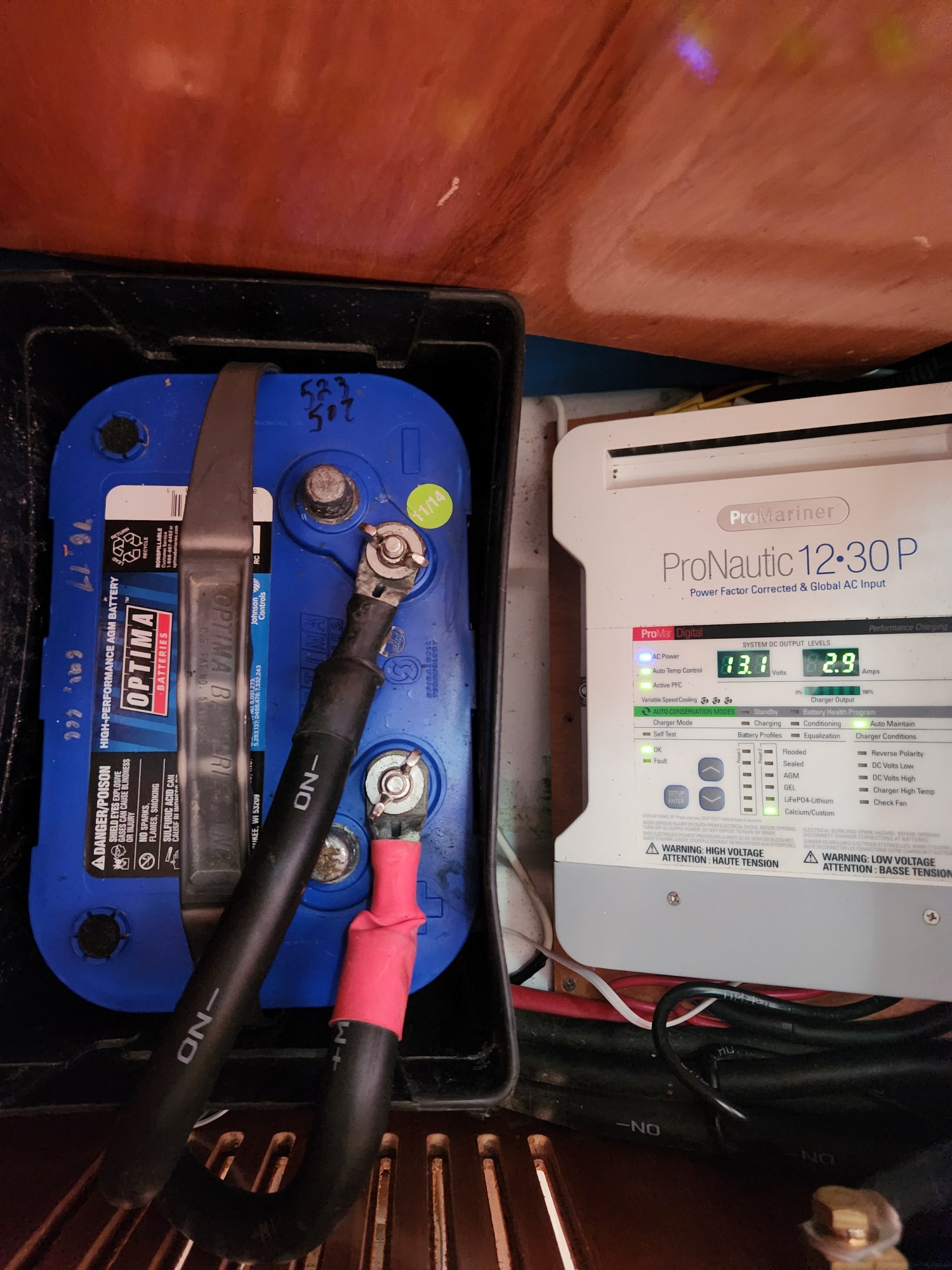

I would put a safety cover over the positive start battery terminal or put it in a battery box. It looks like an accident waiting to happen in that location below the engine.
Jul 23, 2009
926
The start battery is in another location and it is in a box.
If I can find reasonable covers I'll add them to the house battery, the one in the picture. I don't have room for a box, the battery barely fits as it is.

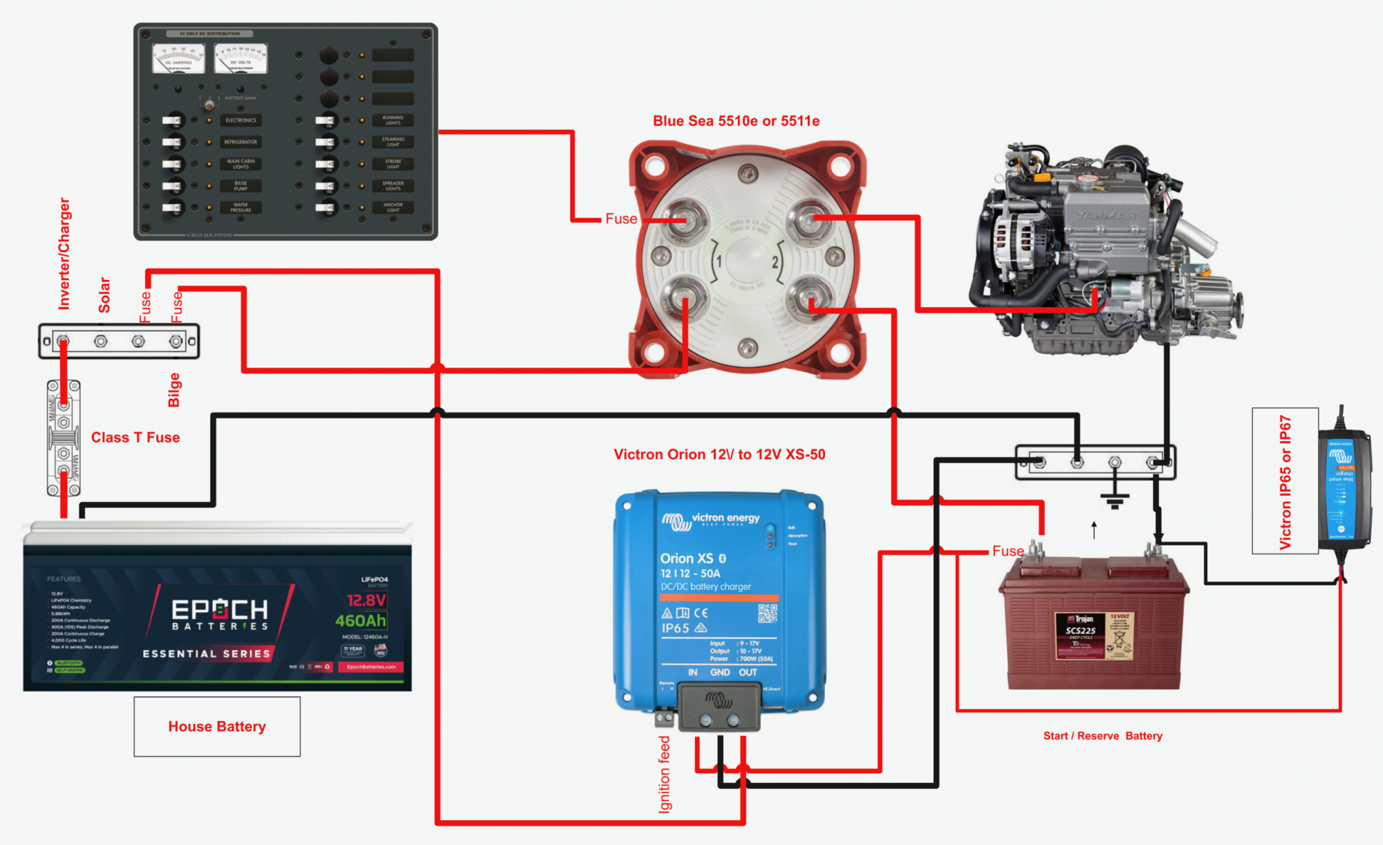

24,745
Doing the same type of install. Following the diagram worked up by Maine Sail.

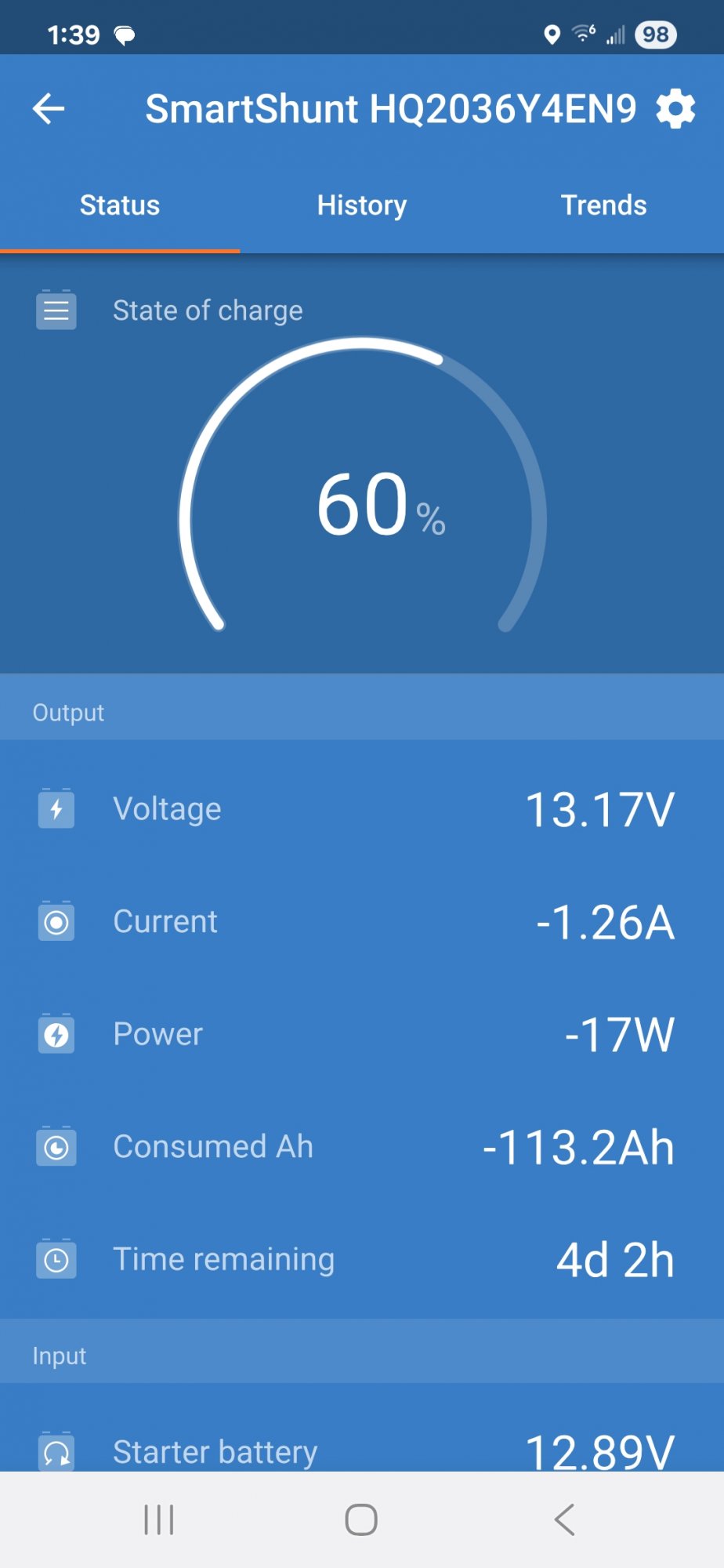

Since I have solar, I always leave something on. When I was away from the boat for 2 months over the winter I left the AIS on. Now I just leave the refrigerator on. The batteries will cycle.

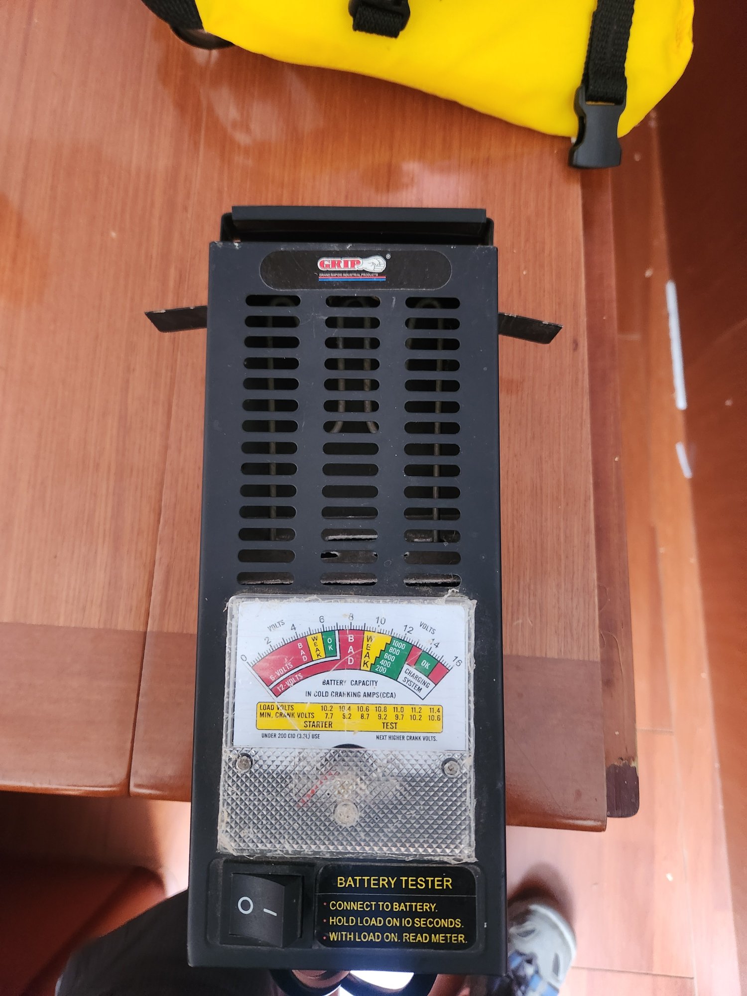

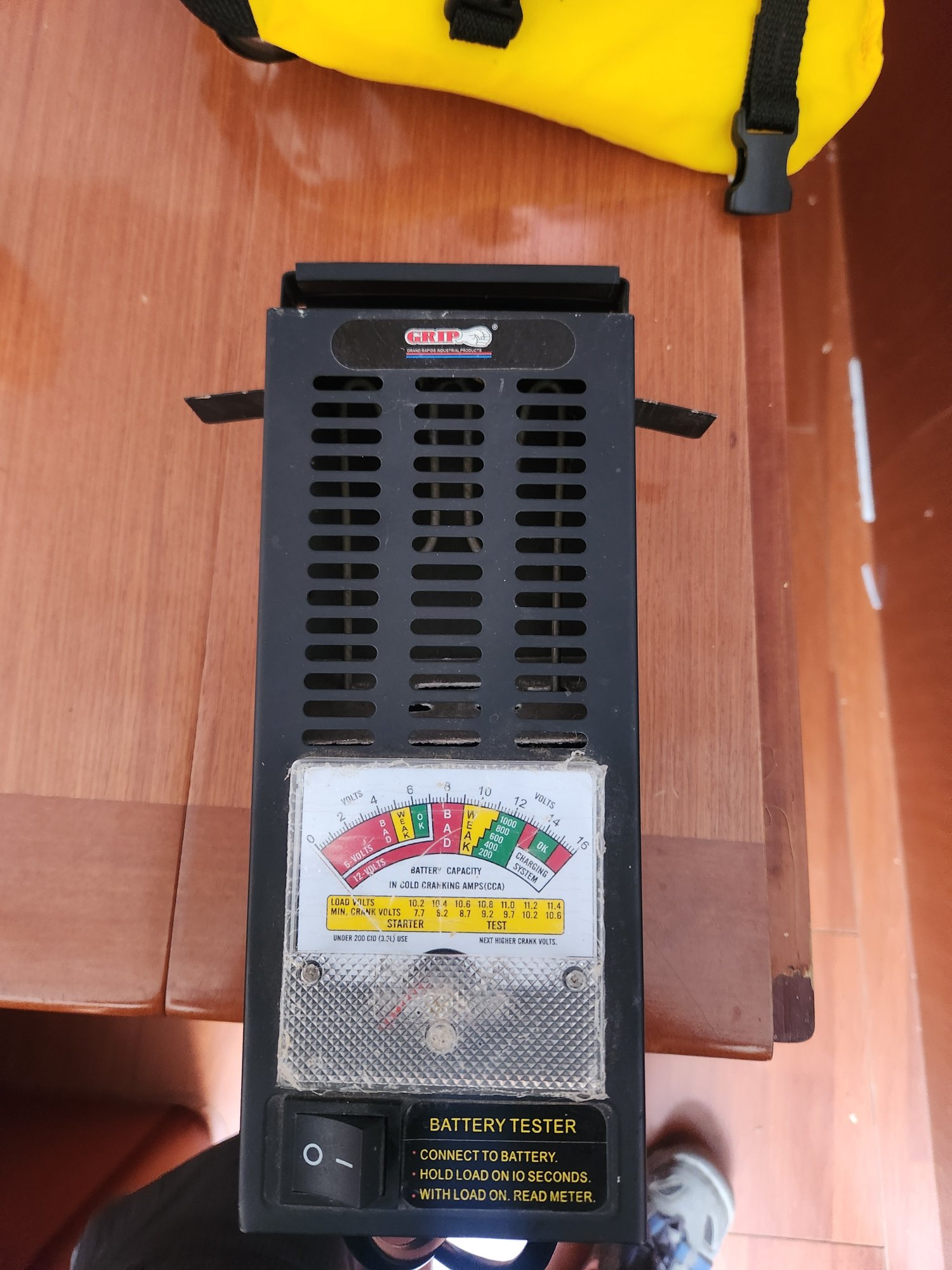

Check out the date code on my start battery, November 2014. I just tested it at 800 CCA with a cheap but reliable tester. I had to replace my mower battery this spring and it was from January 2016, I thought that was impressive.
I'm sure it will fail at the worst possible time. I do have a jump pack on board.

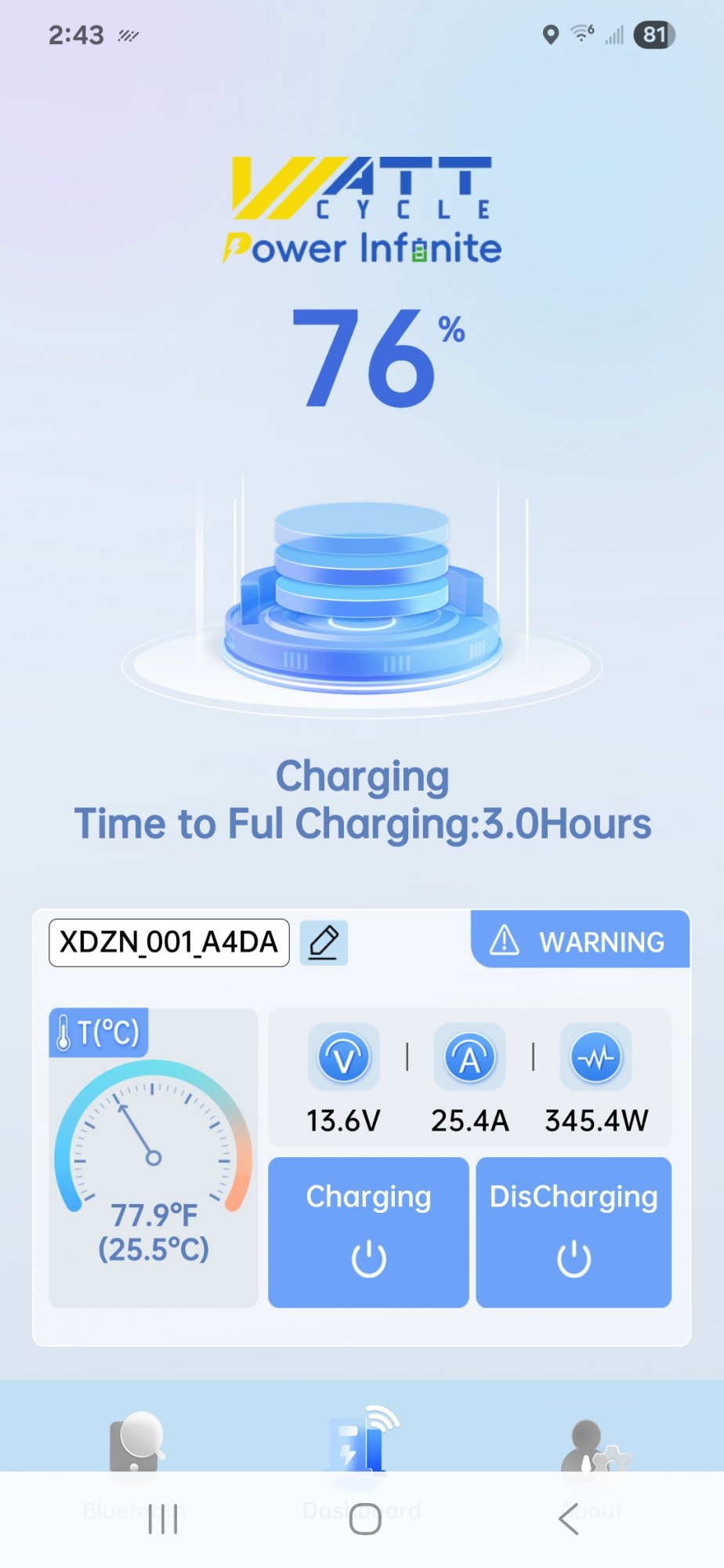

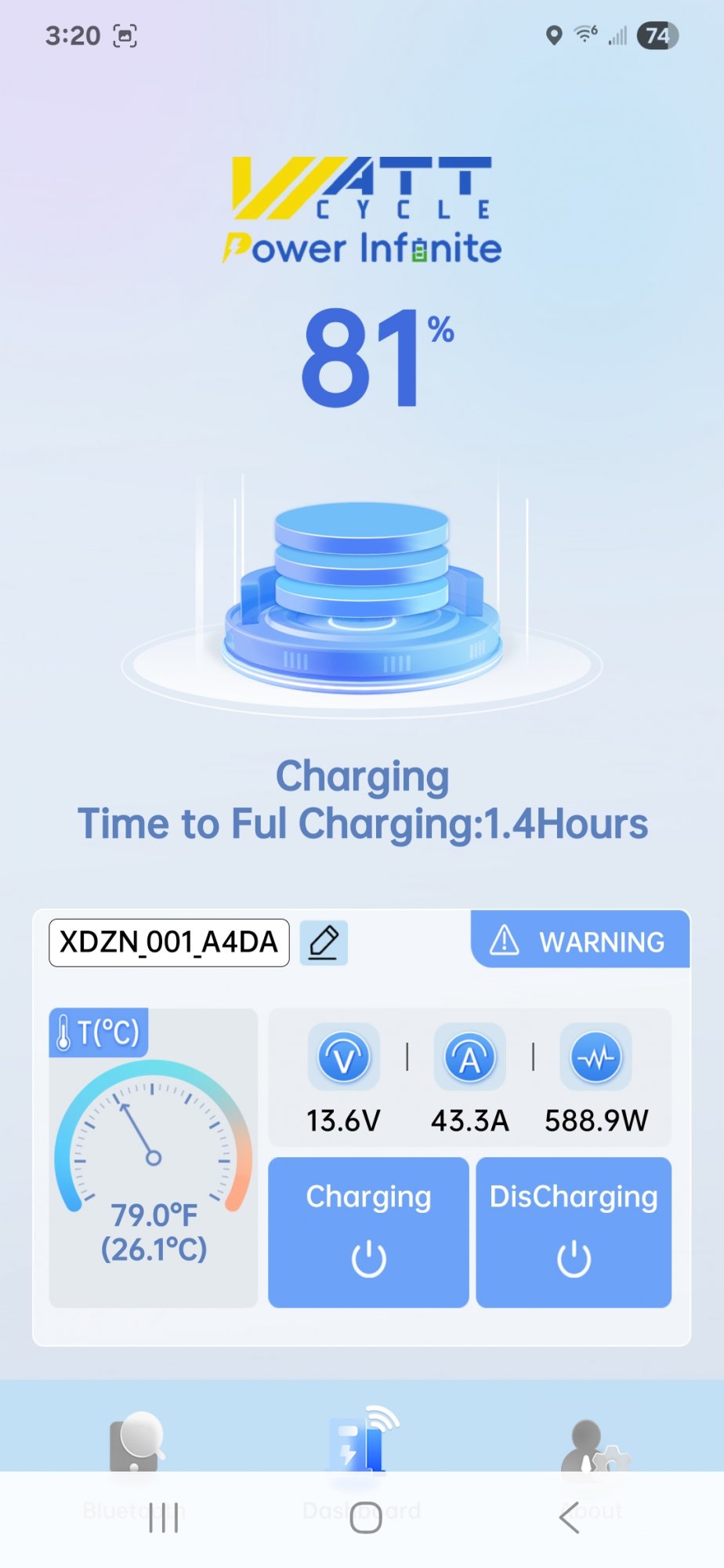

Out on the lake today i saw a maximum of about 45 amp flowing from the alternator into the house battery, it tapers off to about 13 amps at idle. I think that's good. I'm gonna wait to purchase the DC to DC charger.

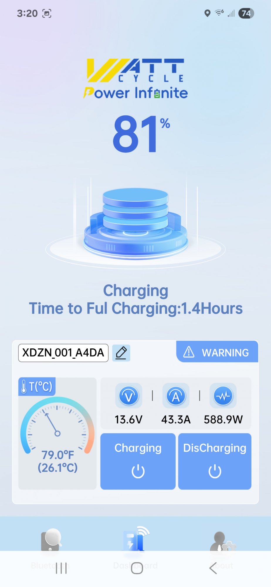

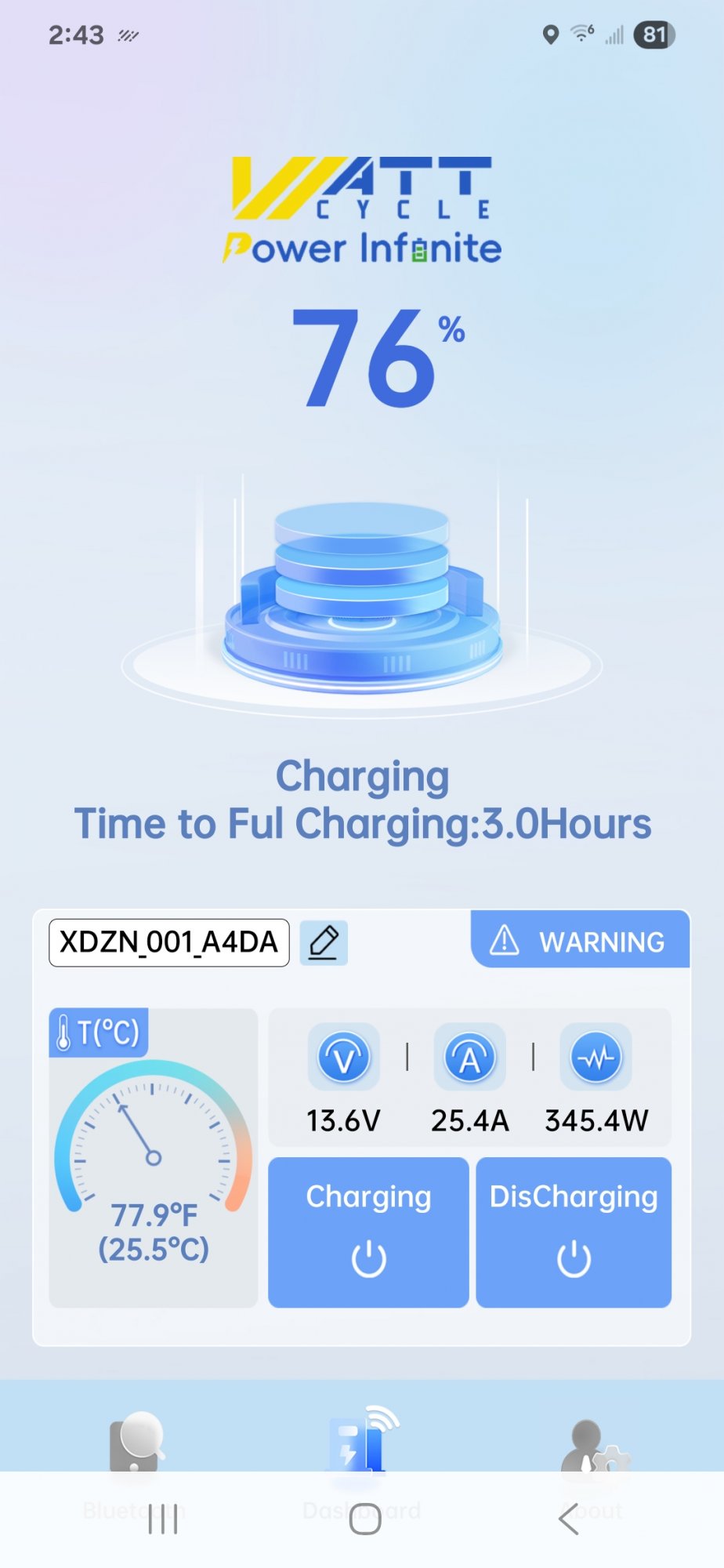

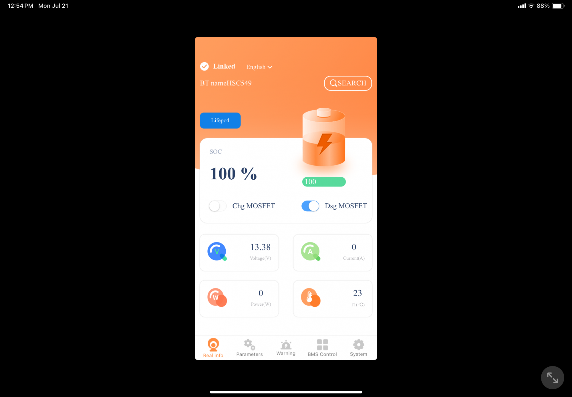

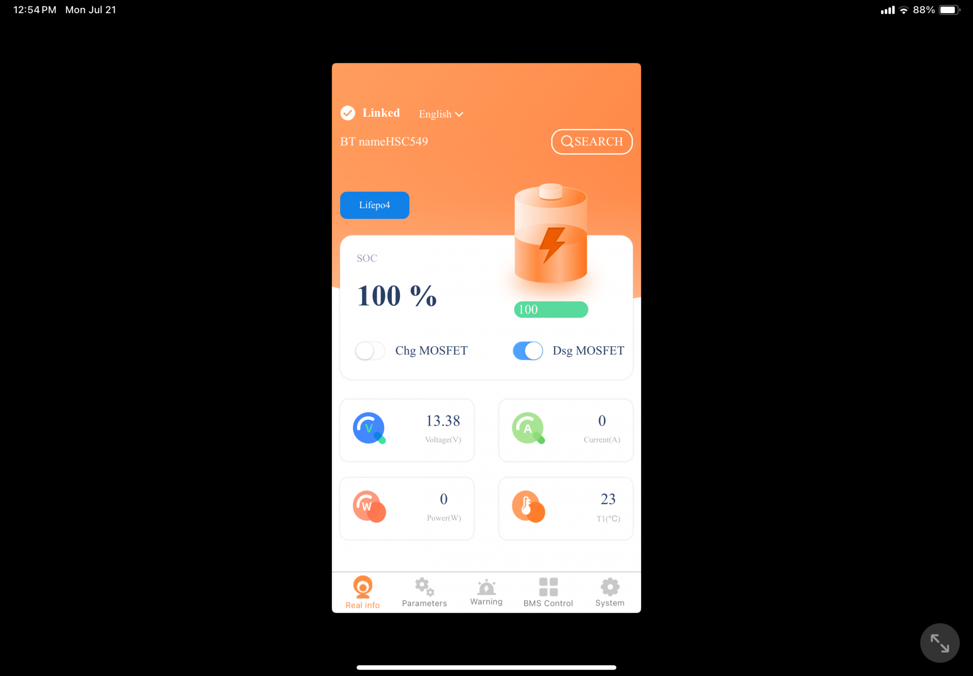

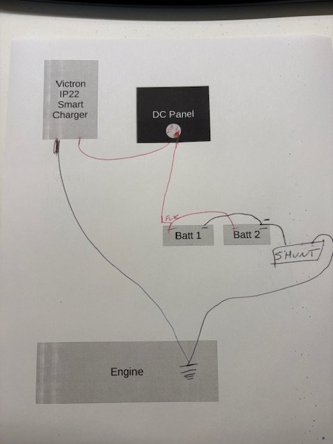

I don’t want to hijack @SycloneDriver’s post, but this is AlFP system related, so hopefully not egregious… if I should start a new thread, please comment,

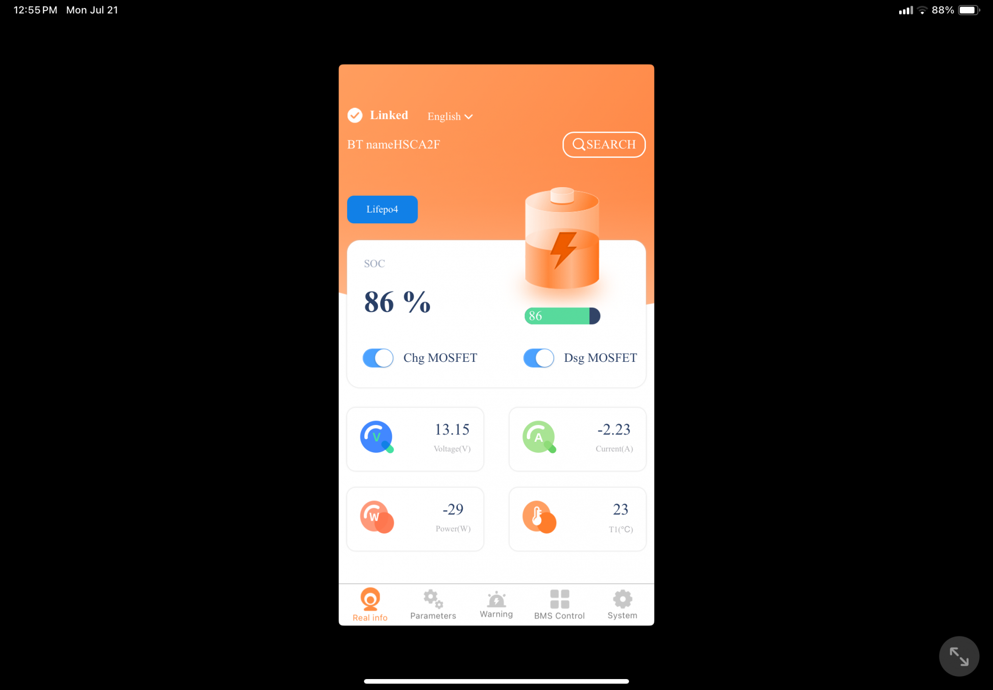

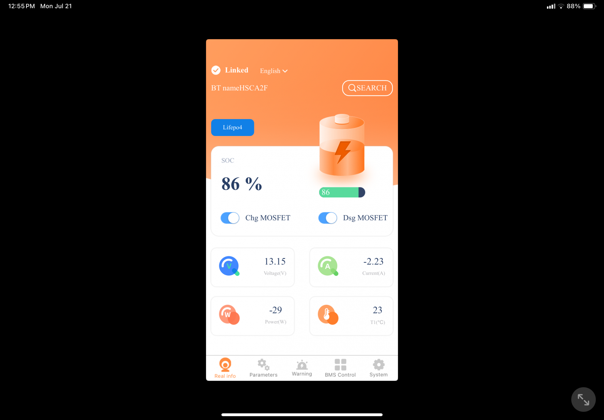

I was checking my new Humseink LifePo4 batteries today after the batteries have been on the charger for a few days. Batt 1 showed 100% SOC and Batt 2 showed 99%. Interestingly, the BMS on Batt 1 shut off the charging switch. I assume since it was at 100% and couldn’t accept any more charge. The batteries are paralleled (see photo below).
I went out for a 2.5 hour sail today, with a light load on the house bank (fridge, VHF, stereo, CP & instruments).
When I got back, I left the charger off until I could check the BMS for the 2 batteries. Now, Batt 1 still showed 100% SOC and batt 2 was at 86% SOC.
I am not sure why these batteries, if wired in parallel, would not supply power to the house system in equal measure. Instead, it seems that one battery is doing all of the work :yikes:
I have written to Humseink to see what they can tell me (if anything). I have discovered that their BMS app will not let me see what the individual cells are doing :banghead:. They did say that their engineers are working on an upgrade to the app.

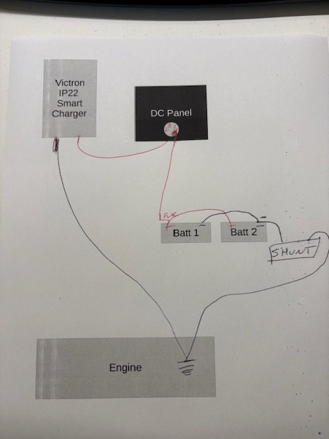

So, here is a crude drawing of my DC system (left out the AC side of the equation for now)...and only the house side. Left off the starter battery, switch, charger, etc for that.
Does anyone see anything blatantly wrong with this set up (I hope not, as I have sailed with it a few times now). Or could this just an issue with the batteries? One thing I could try is to install a positive and negative bus bars and hook each battery individuslly to the bus bars. But the charger would charge the bus bars (single output charger ). Not sure that changes things much. Does paralleling LFP batteries need to be different than FLA?
