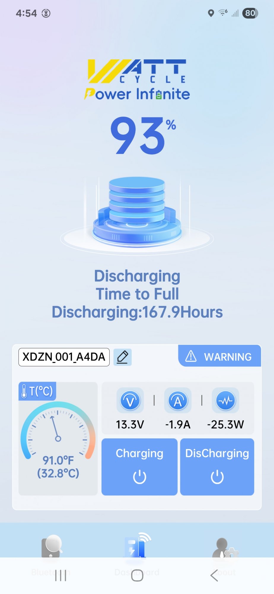

I got back to my boat today. Over a week ago I adjusted the float voltage on the charger up from 13.2 to 13.4. The battery is now resting at 93% SOC instead of 66% at 13.2v. I'm reasonably happy with that.

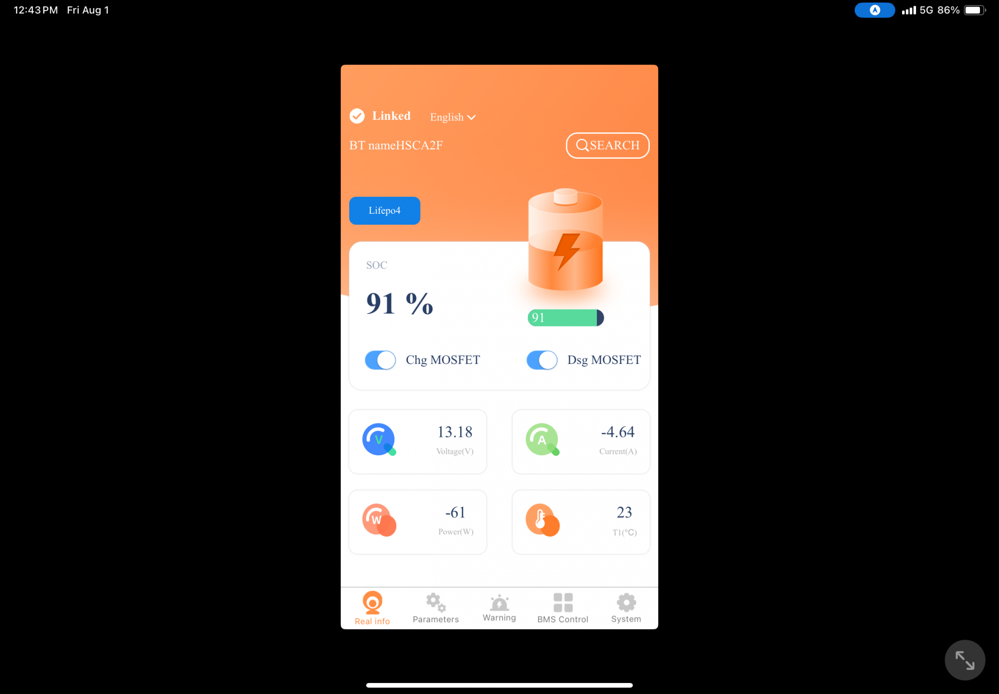

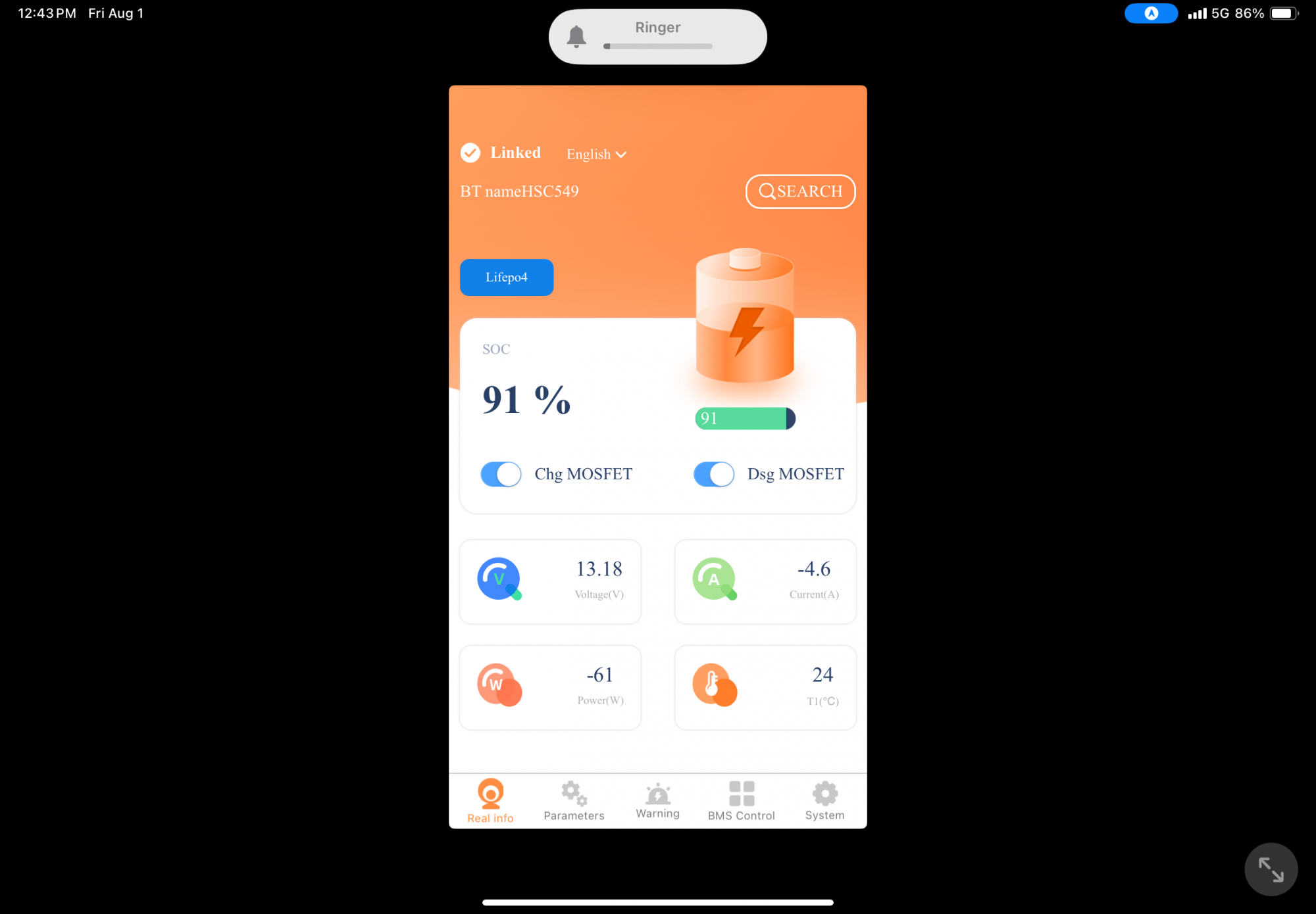

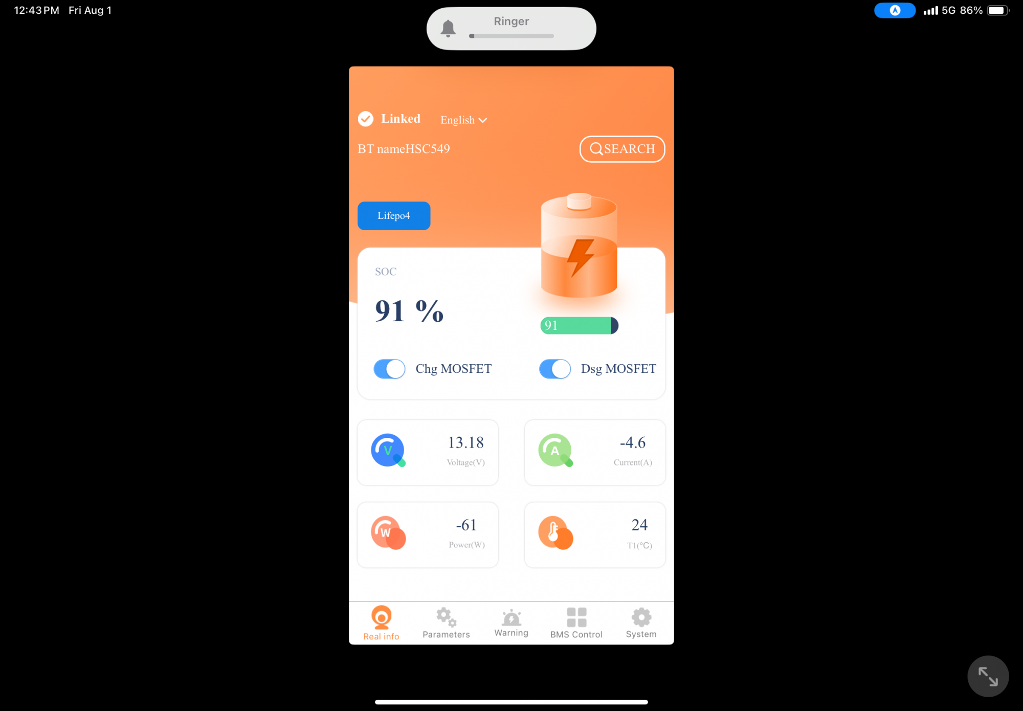

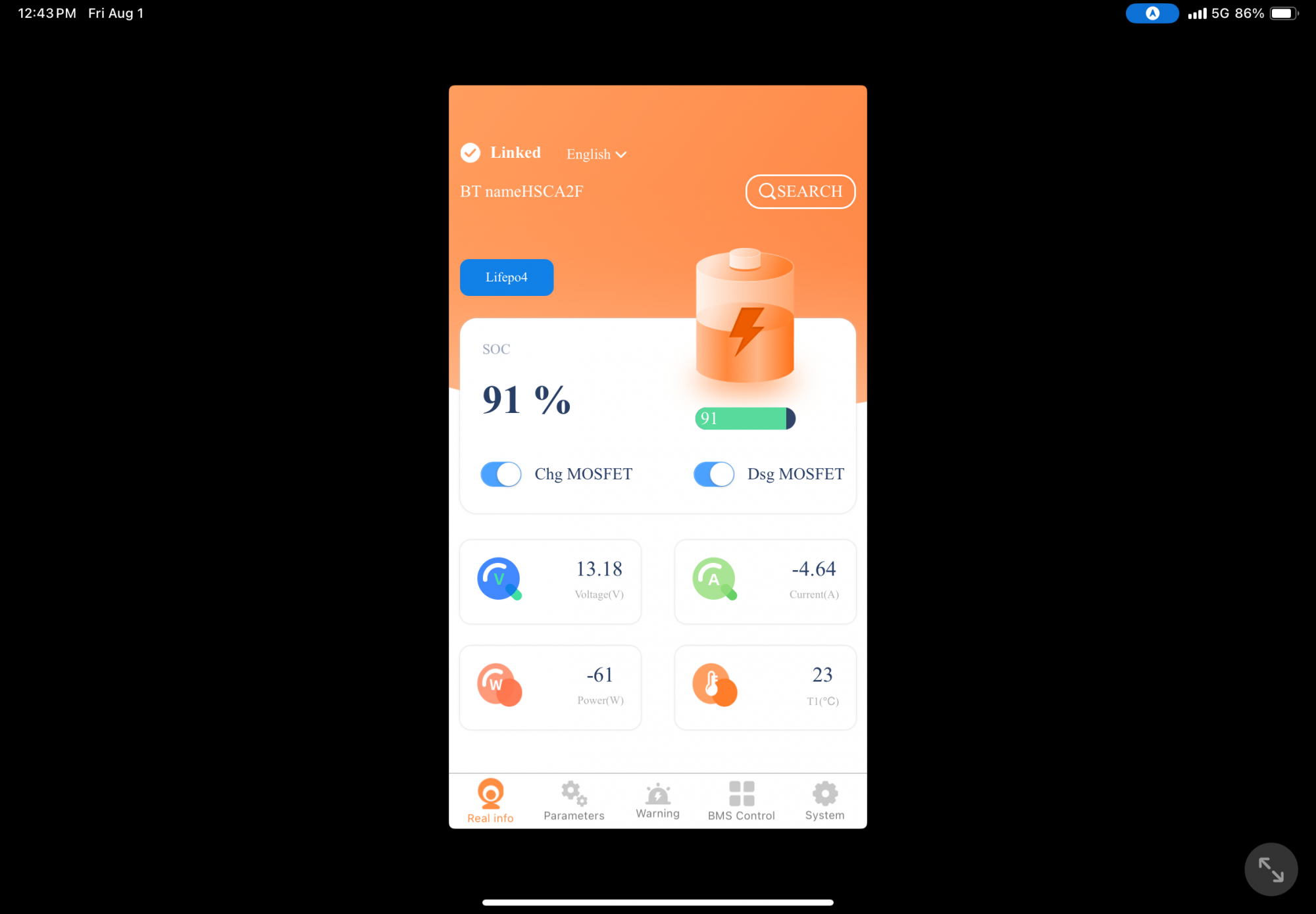

An update on my new LFP battery bank…
I had communicated with the mfg (Humsienk) and they asked me to independently charge each battery using a 14.6 v and 5 amp charge, and to leave it on the charger for a couple of hours. I did each one, somewhat unsure of what good it would do since the batteries shut off their CHG switch once they are at 100% SOC.
But I did as instructed.
I reinstalled the batteries yesterday and left them charging over night (fridge and a few other things are on, so there is always a small load on the batteries).
Got to the boat this morning, batteries were within .1 volt of each other, and both were discharging (sharing the load). :thumbup:
I took the boat out for a 3 hour sail, leaving fridge and other electronics on, including using the AP a bit. I was very happy to see that both batteries were at same voltage, both discharging and sharing the load! When I got back to the dock, and before turning on the new Victron charger, Voltage and SOC were identical on both batteries. This is what I was expecting to see.
If I were to do it again, I might opt for a single 200 or 300 Ah battery to avoid the paralleling issues, but if these now are “equalized” and stay close to each other, I will be very happy.
Greg

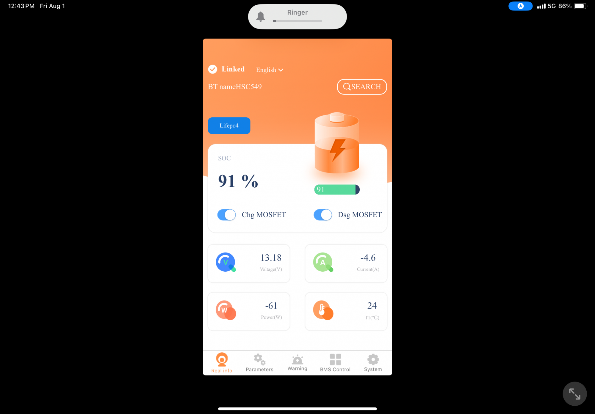

View attachment 233372 View attachment 233373
Greg
All correct !
Lithium wired in parallel must all have the same state of charge before wiring them together... Ideally cycled once or twice as well.
Recheck individual cell balance every 6 months or more based on usage and separate, recharge and then recombine...
Lithium does not mean maintenance free....

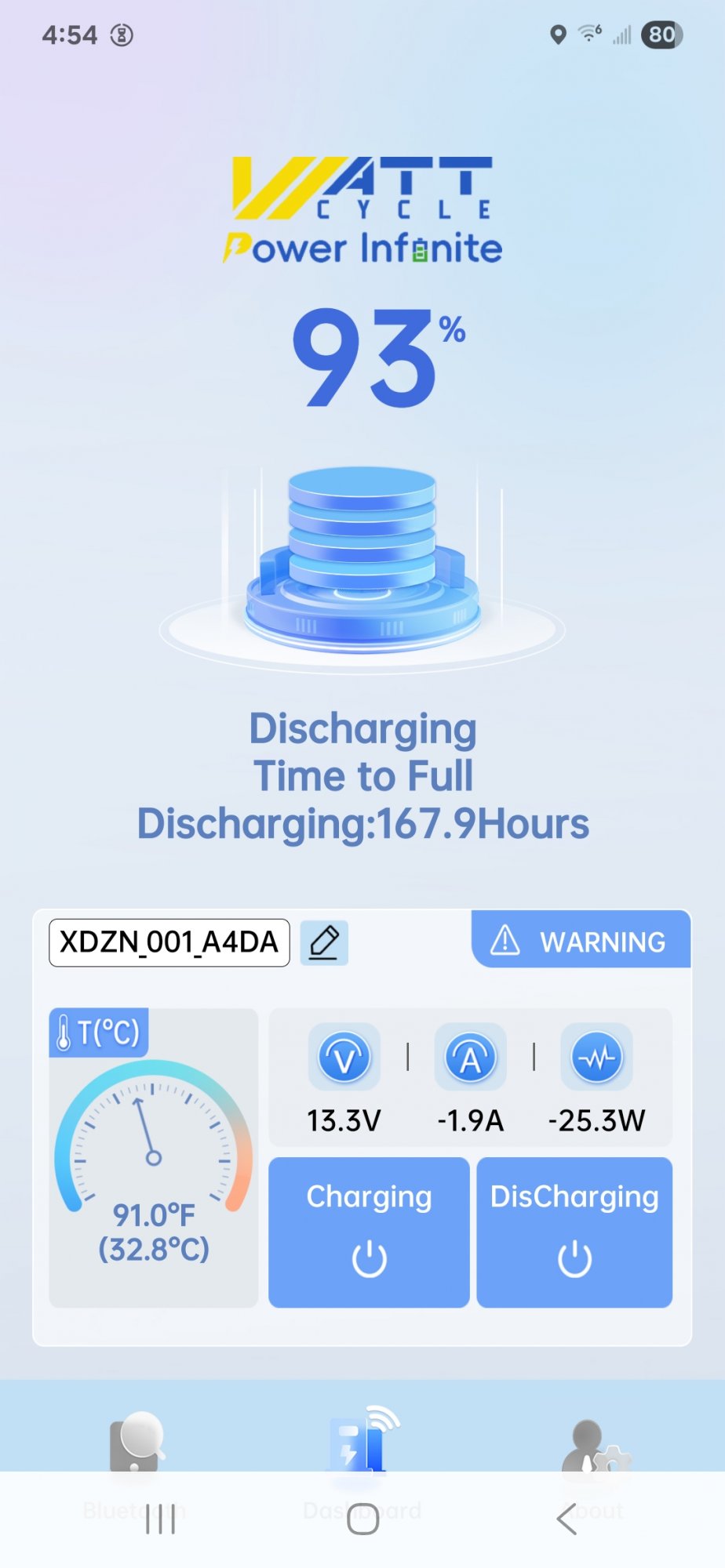

Update
My WattsCycle battery in my boat has been doing great. The shore power hadn't. But my fridge stays cold and I'm not damaging lead acid batteries every time the shore power falis. I'm still not quit finished with the install yet.
On another note, I recently replaced 34 AGM batteries in my solar project with 2 WattsCycle 24v 314ah batteries. They are big boys at almost 160lb each. My biggest complaint is that the bluetooth has very limited range and the decimal point in the hours remaining, in the app, seems to be off by one place. Now that I can see real SOC I'm surprised at the amount of power 3 refrigerators, 1 TV, 2 blower motors (AHUs) and a dehumidifier use. It appears that they use about 24 to 32kwh daily.

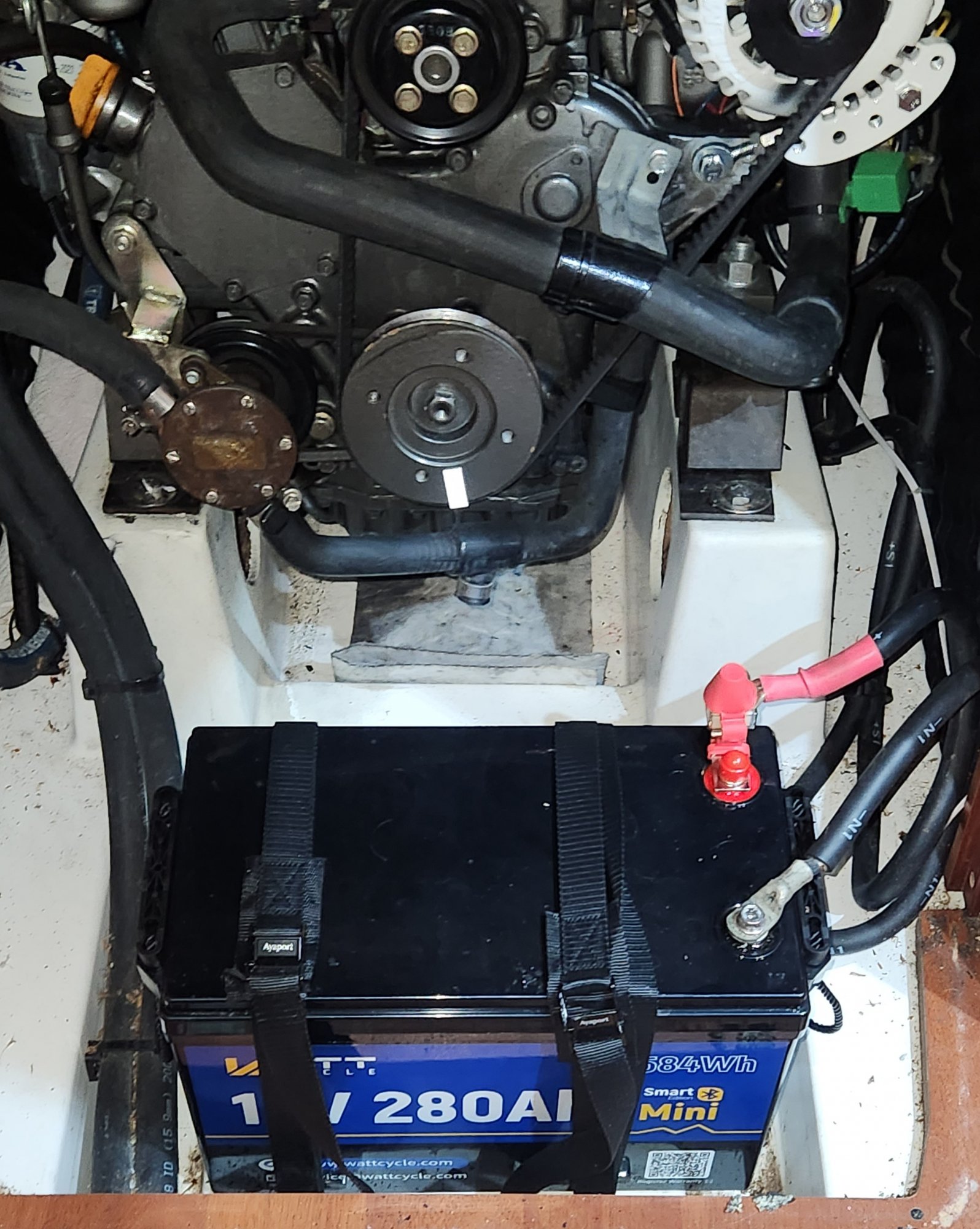

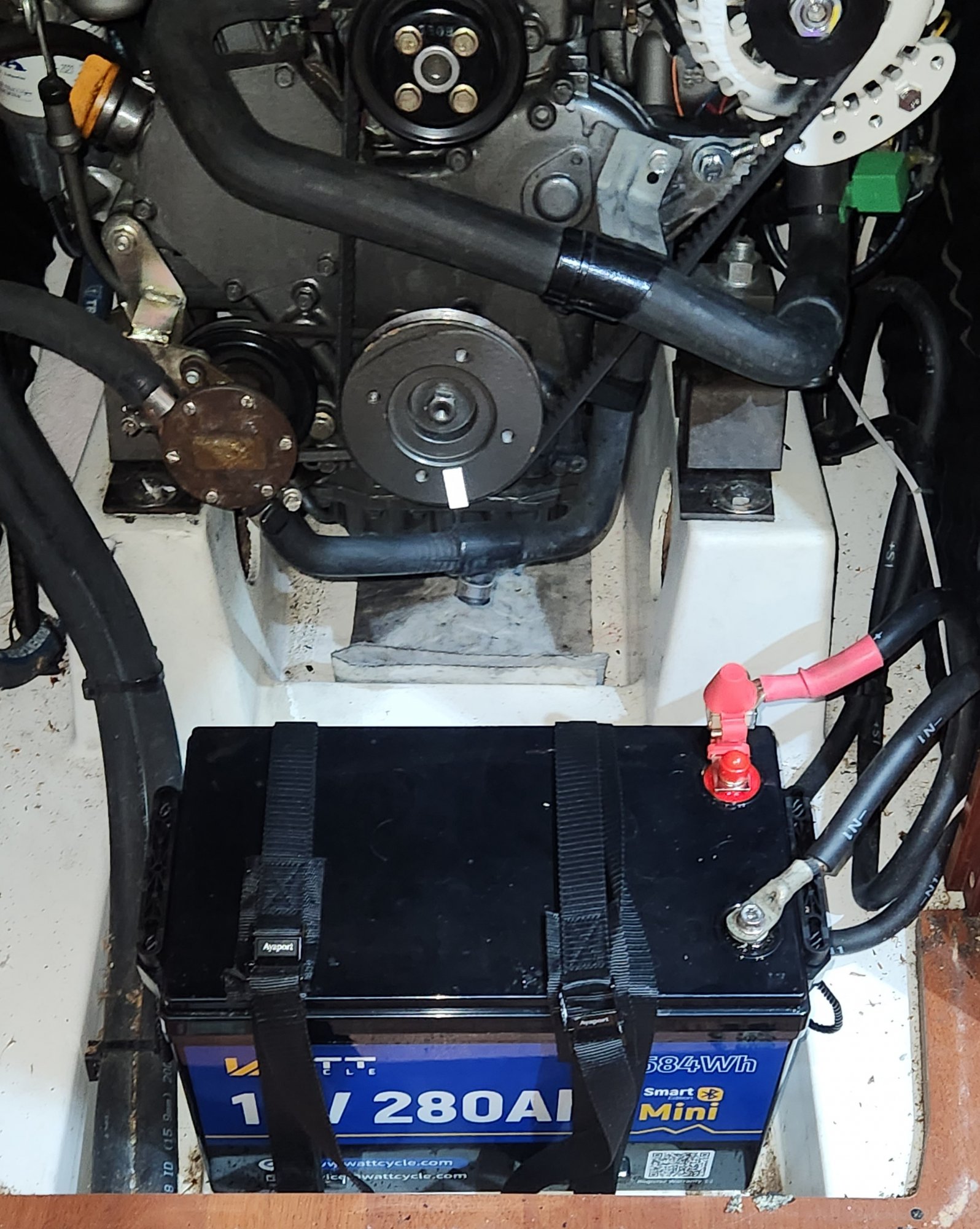

The battery now has hold down straps and a fuse. I realize that I should have used a t-class fuse, but this was so easy. I have also lowered the float voltage to 13.2v.
Jun 17, 2022
436
Hunter 380 Comox BC
That looks better. It might be the photo, but looking at it from here, it looks like there's an issue with the negative cable lug? Is there corrosion on the wires as they enter the lug? There should be heat shrink to seal the lugs to the cable sheaths (even on the negative), to prevent moisture intrusion.
As for the positive,ideally there would be a boot so that no portion of the batteries positive terminal is visible (or touchable with a screw driver!). That's an area of the boat that is frequently accessed with tools, so full coverage of the positives is important (to avoid doing accidental welding).
