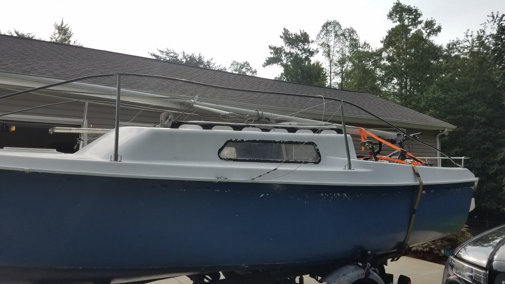

Hello everyone. My dad gave me a Kells 23 that has been fully gutted on the inside. It appears Kells 23 info is limited on the internet. I have never owned a sailboat nor been sailing but am an avid DIY'er. I have some gelcoat cracks, missing the front hatch, and the companionway hatch has had a piece of plywood screwed to the top. The winch for the keel looks in rough shape. I have cleaned all the mold out of the inside. I would really like to get it water ready asap if possible but have the winter to work on it if not possible. I really am not sure where to start. What should I do first. I have a mainsail and jib. I would appreciate all the advice I can get
9,203
Welcome to the forum!
First, get it rainwater tight.. (ports, hatches, deck hardware bedding) Next, structure inside (replace rotted and delaminated stuff.. add stuff if missing).. then it is time to get the mast and rigging looked at and if OK, take her out !.. next is cosmetics. Good luck

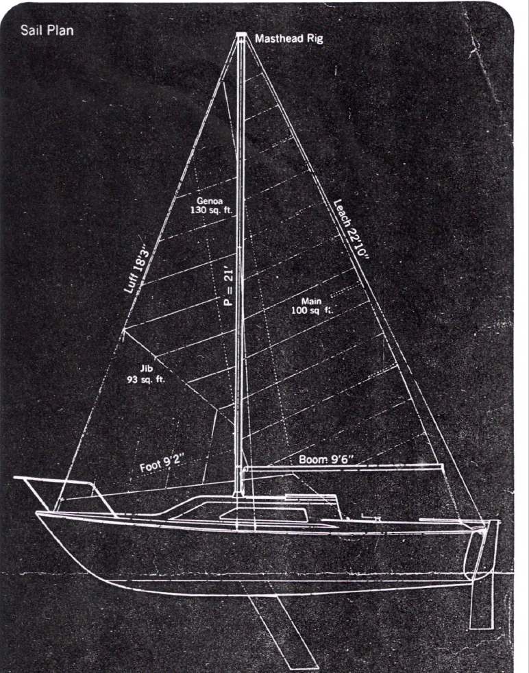

http://sailboatdata.com/viewrecord.asp?class_id=63 and this :) can't find parts for the thing though... gotta find out who manufactured the mast if you want to rebuild it... or you're stuck fabricating your own parts. sailrite has sail info tho https://www.sailrite.com/Kells-23-Mast-Head-Rig-Sail-Data but ... seems lacking. https://forums.sailboatowners.com/index.php?threads/wood-block-under-mast.173280/ other kells owner on this thread but almost 4 years ago. http://www.cruisersforum.com/forums/f116/my-kells-23-in-need-of-help-16965.html another but even older.
https://www.dwyermast.com/items.asp?cat1ID=20&cat1Name=&familyID=41&familyName=DM-450+Mast i kept hitting dwyer trying to find the mast manufacturer. ... no promises though. might not hurt to contact and see if thats actually who did your mast.
If it were me, i'd probably go over the top engineering it all out. But at the end of the day if the mast will mount solidly and the compression to keel is good and the keel retracts and deploys and same with rudder and rudder moves free... you can always get a tow back in. haha. i'd personally try to find a outboard, 6 or 8 would be plenty of hp, so you can save yourself, as well as get away from the shore before pulling up the sails first time. anyways. fun project. i'm glad mine is sailing but i'm kinda jealous. :D

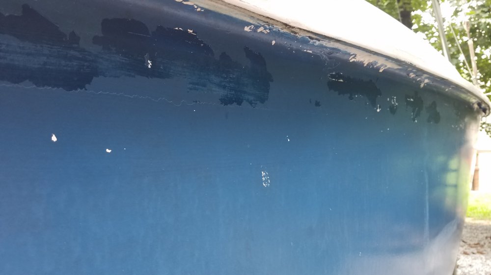

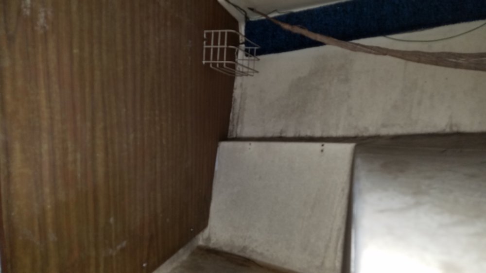

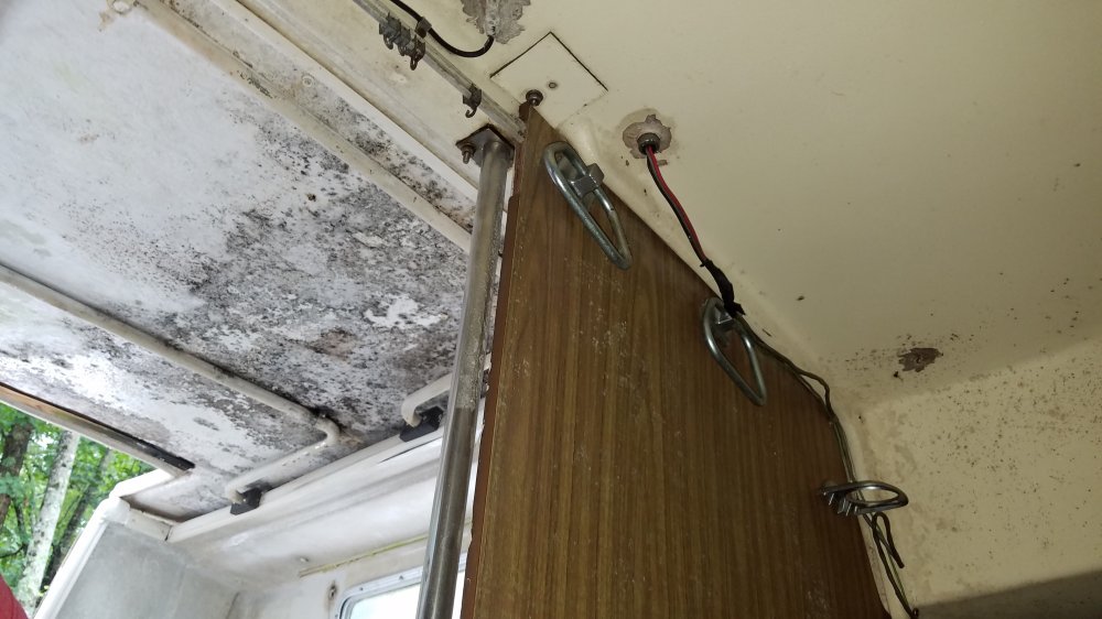

Some Updates. I have been working on the boat here and there and watching TONS of YouTube videos (especially from Boatworks Today) about gelcoat repair, fiberglassing, etc. These are two things that I know nothing about really but as I said before, I am an avid DIY'er so I think it is something that I can tackle. I have totally removed everything from inside the boat. There is currently no wiring, nothing remains but the sink and the winch (which is currently disconnected from where it was mounted below the companionway. I have been sanding inside the boat mostly with 80 grit sandpaper on a orbital sander because an owner prior to me painted the inside with latex house paint.

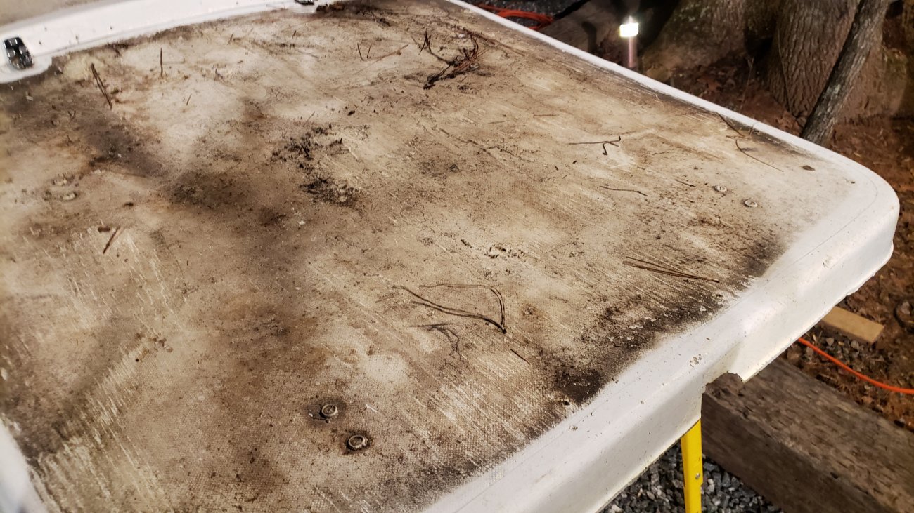

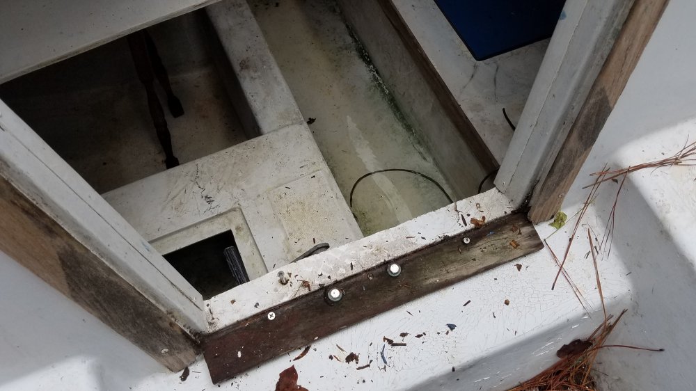

This first pic is my pop top (if that is the correct name) It had a piece of plywood screwed to it, assuming for strength, so there are all kinds of screw holes in in that leak. I plan to grind it and reglass the entire hatch. There appears to be something missing from the from that from what I can tell, maybe hooked into the track on the mast to hold the top open. I have seen something from StingySailor to assist in opening this top with gas struts as it is heavy, but haven't seen anything about the missing piece. Can anyone tell me about it? Also, where the hatch lays against the boat ( the actual opening, it appears that all the wood around the edge of the opening is all rotted or at least separated. I am hoping to be able to glass that shut....maybe??

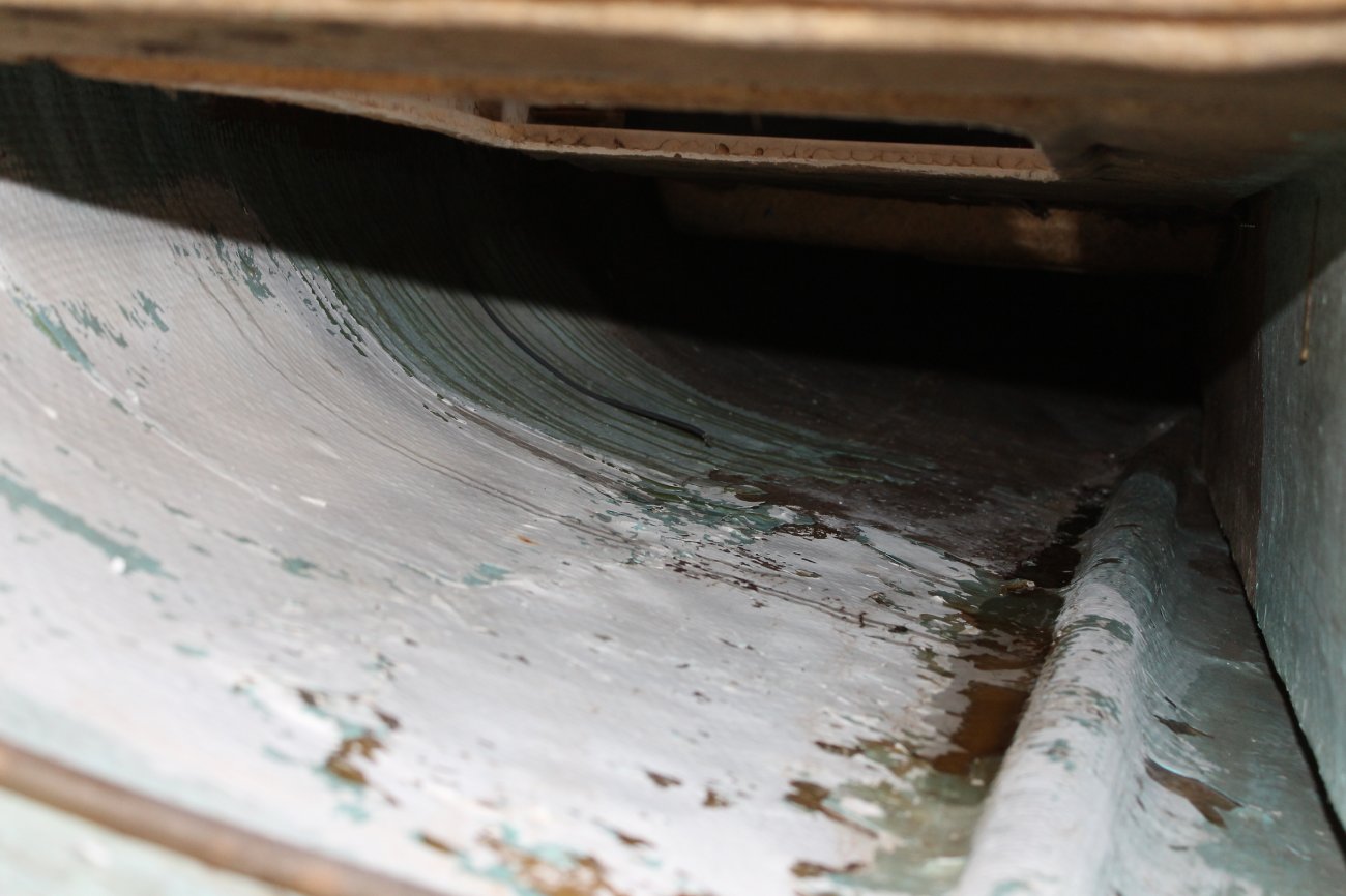

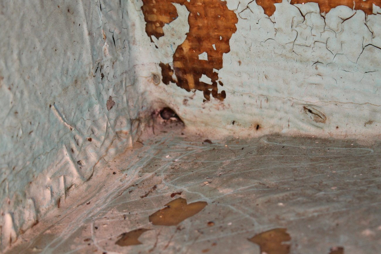

This next few pics are inside the storage compartment under the dinette and underneath the starboard storage. This is what most of the underneath storage looks like. Most of it is down to the original fiberglass hull. Do I grind/sand all this out and paint it or were there coverings or carpet or something that went in those areas?

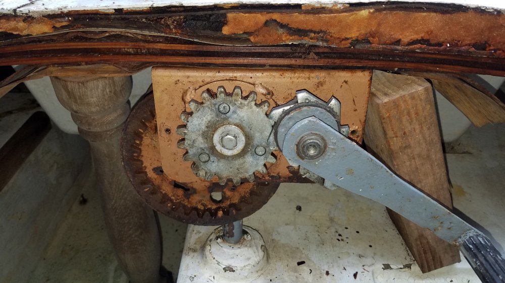

I pulled all the silicone from around the keel bolt inside the cabin, which looks to me like someone has just stuck a large nut and bolt in there. I am certain it's gonna leak. I will upload some photos of this as soon as possible.

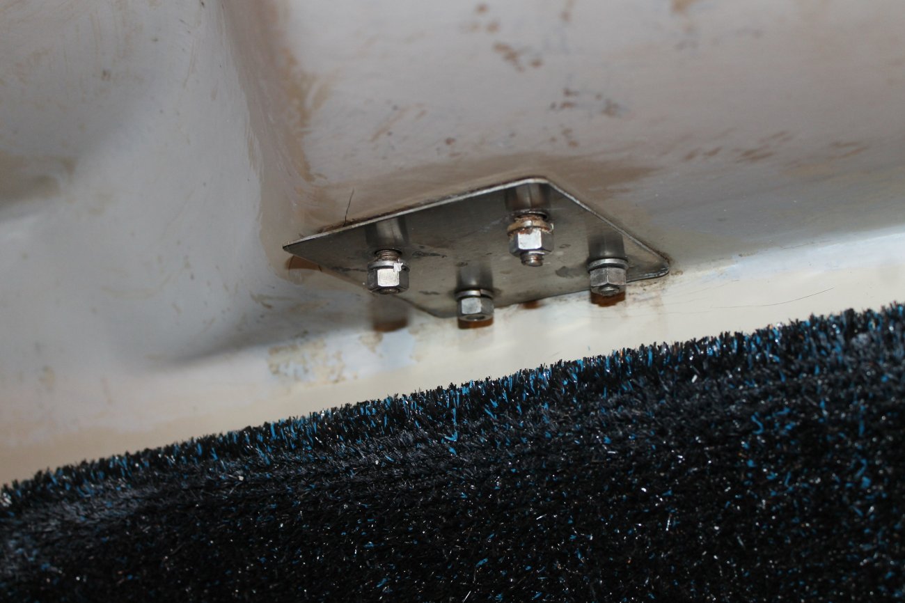

The hull/deck joint looks real bad on the inside. It used to be hidden by some wood that was covered in marine carpet. It does appear that water might have gotten in there in places also. I have watched a few videos on separating the deck joint from the outside and putting sealant inside it, resining the bolt holes, and clamping it and then redrilling new screw holes. It sounds like a rather daunting task but I don't think I can actually hurt it anymore than it is.

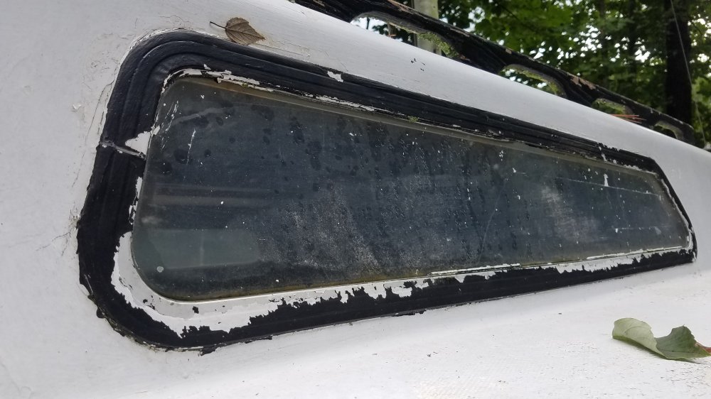

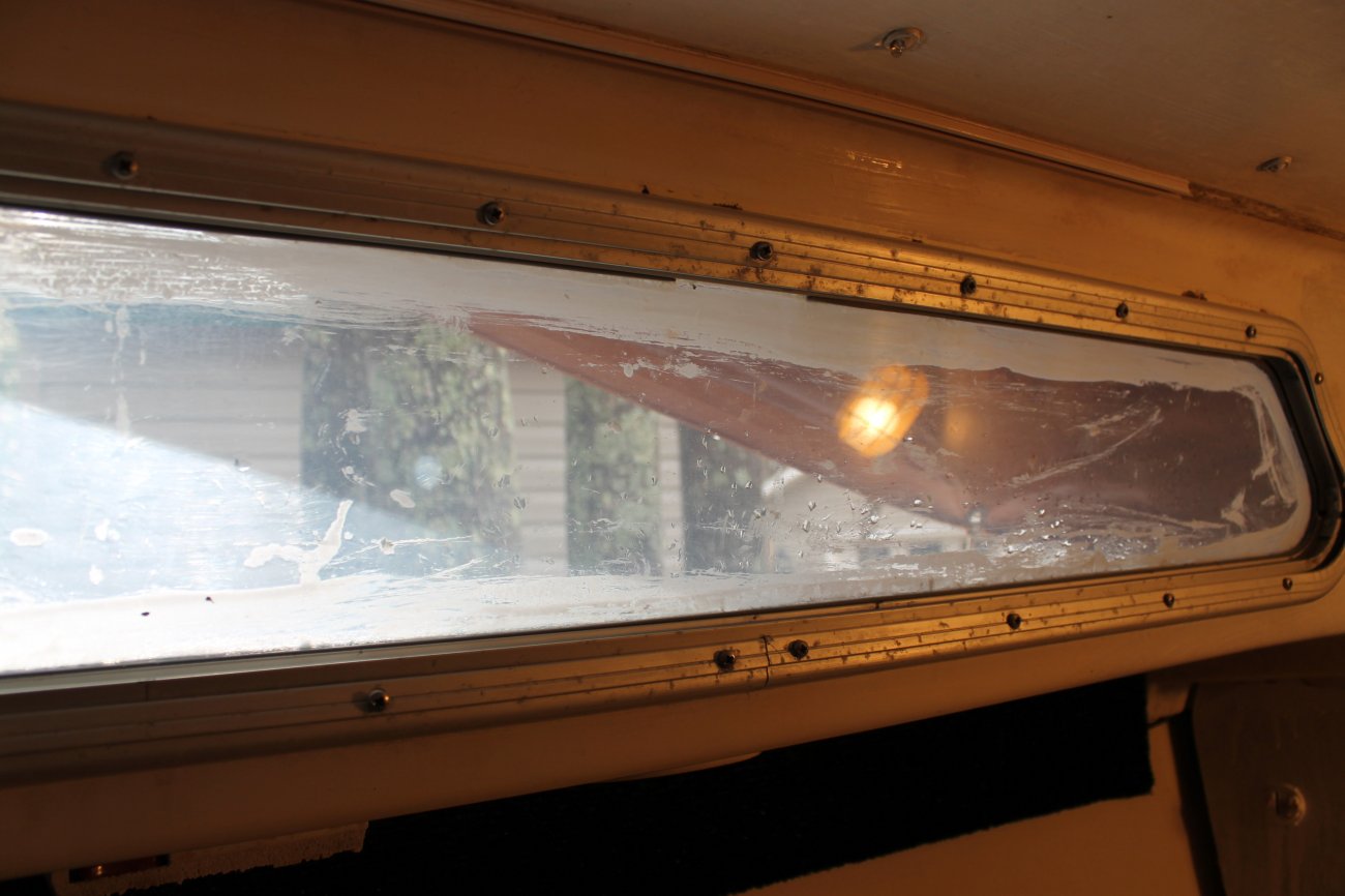

I know the portlights leak. I have taken them out but only sat them back inside without sealing them because the PVC lens needs to be replaced and I don't think all that needs to be done until I actually paint the outside.
I am pretty sure all the deck hardware needs to be removed and resealed also.

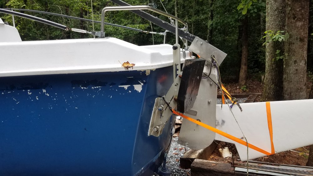

I need to get the boat up on some stands of some sort so I can drop the keel hopefully to inspect it and see if I can access the area up where the pin is.
That is all for now. I have plenty of work to keep me busy but I could use all the suggestions that you can throw out to me.

You might consider building a framework over the boat and trailer and then cover the framework with 4 or 6 Mil. construction plastic so you can work throughout the winter regardless of precipitation or temperature. A small block heater will warm the area inside the boat and under the constructed cover enough to dry out the moisture that might accumulate. However, do not run even that small heater 24/7. Just use it when you plan to be working.
It sounds like you have "jumped right into" the project. That way there are few options...….just keep working steadily is probably the best option. One of the Fein Multitools or a cheaper vibrating tool will be useful if you do not already have one. Lowering the centerboard/swing keel can be done by putting the boat onto bales of straw or onto a frame you construct to support the boat off of the trailer. There are discussions on this site for lifting/sliding/moving the hull to get it off the trailer. The pin through the centerboard/swing keel should probably have a grommet or rubber plug of some sort (on each side of the CB trunk) that the keel bolt goes through. They deteriorate over time, so that may be why a PO used silicone at the pin and washers. You might not find original equipment, but you can find a reasonable hardware store or automotive store replacement.
Along with pictures, label the parts you remove and mark fore, aft, starbd, port as needed to show its original orientation. It will save you much head scratching in the future! Wear dust mask protection when grinding or sanding. Buy a good one, not just those cheap paper models. Wear a Tyvek painter's suit. Wear chemical resistant gloves when using epoxy and gel coat. In that case even the cheaper, clear Wells Lamont gloves are useful. Epoxy will make the gloves unusable when it hardens. Have a box of rags handy and use mineral spirits to remove wet epoxy that drips where you do not want it.
If you knew all this already......good on you! Enjoy your project! I am in the middle of my own project too, but yours makes mine seem like child's play. Best Wishes.

Check out Andy on BoatWorks Today or my own channel, Yachtorials, for fixing spider cracks in gel cote! I have done a few thousand... and they look great after several years of service. During which time I have, unfortunately, made a few more on my trimaran! Ugh!
