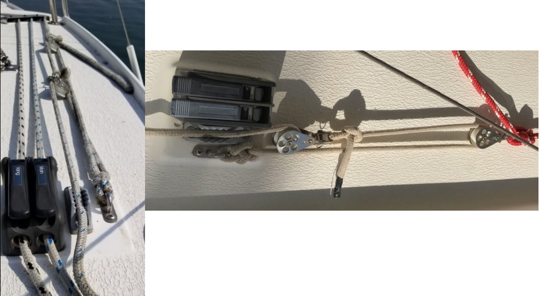

The keel drops by gravity. That pulley system is mainly to raise it. If it doesn’t drop, something is binding. Either the line is wore out and binding, or something else is binding. Mine did not go down either. In my case, someone replaced the big stainless steel bolt that holds the keel assembly to the bottom of the boat with a bolt that was too long. if that bolt is too long, it won’t let the keel drop. I ended up taking it out and cutting it. Also if the line was replaced with a bigger size line, it will also cause it to bind. The only way to check the operation of it is to either raise the boat off the ground, or put it in the water and go under it by holding your breath. Next time I go to my boat, I’ll take a picture of those pulleys for you.
Feb 27, 2004
155
SunTracker 18 DLX PartyBarge Hoover Reservoir - Columbus OH
These are about the best images I could find of the uphaul setup. Hope it gives you a better idea of how to lay it out.

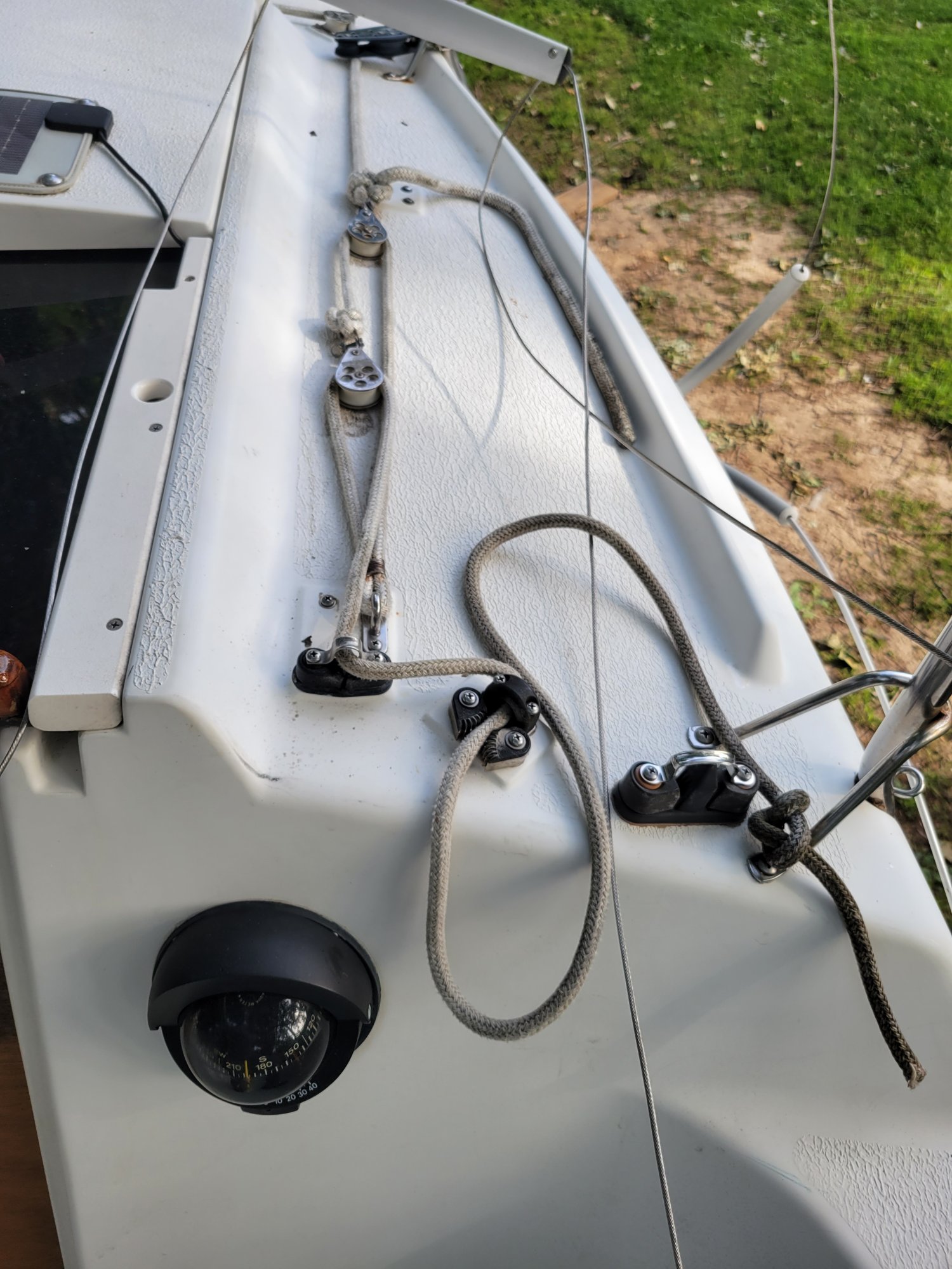

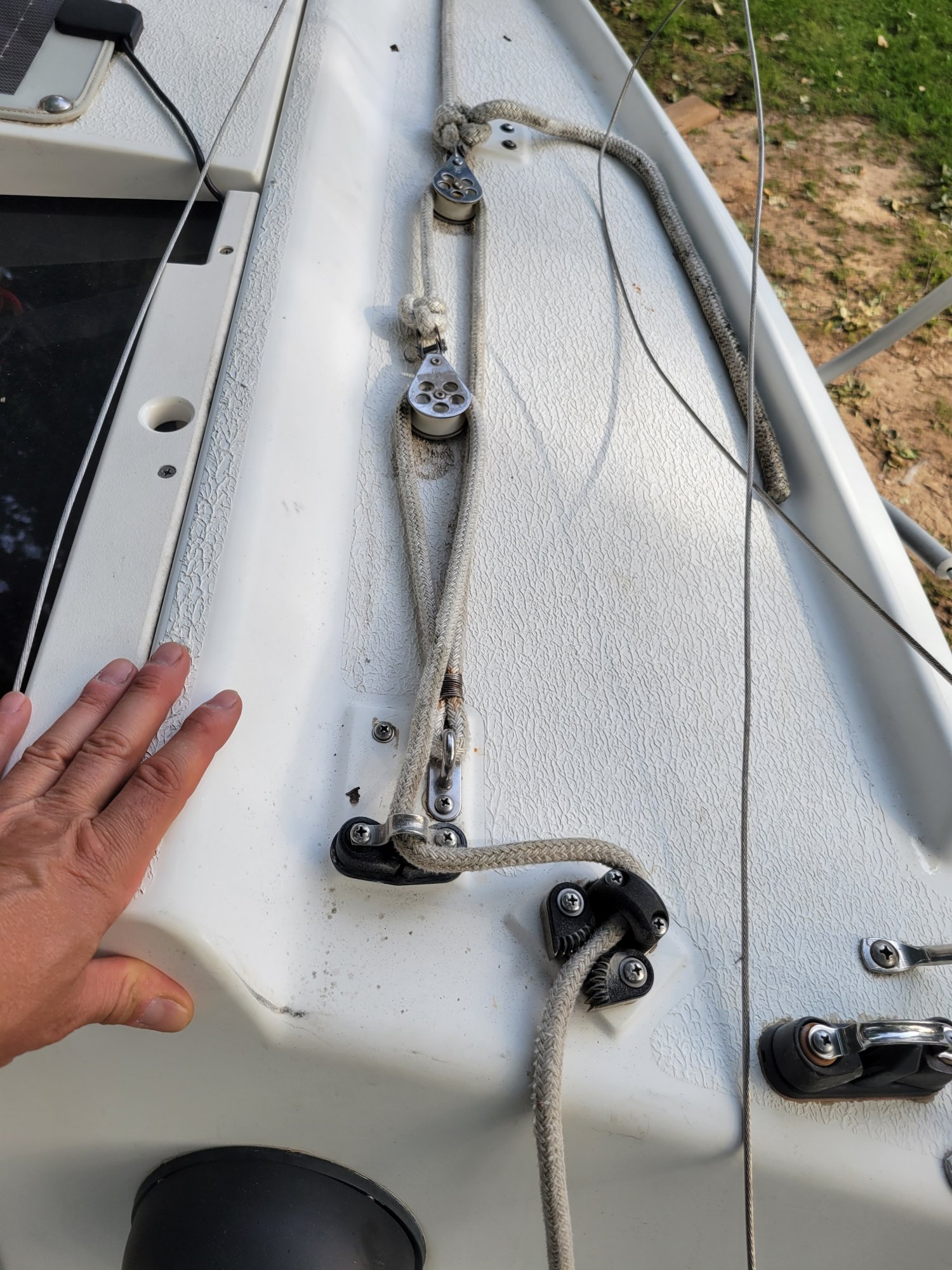

Thanks for the pics and advice everyone. I have my boat on the trailer now and was able to untie some knots. This is what I have now in the pic. Question I have is how much slack is taken up from the line when the Keel is full extended. about say 2 feet of line ?
Thanks,
Rich
Dec 20, 2020
127
Prindle 16' Corrotoman River, VA
Sorry I don't know the length on the 19. However I think the line routing isn't 100% yet. Looks like the centerboard line ends in the Jib jammer. (see page 56 https://sbo.sailboatowners.com/downloads/Hunter_26_82584071.pdf Item 16 is the port jib jammer and the similar one on the other side is the starboard jammer). There looks like an extra jammer on the deck of your boat to the right of the Jib Jammer, for a roller furler? Item 30 is the centerboard eye and 29 is the centerboard Jam. If it were me i'd route the line through the last block the opposite way (or flip the block over) and then to the jammer (29).
