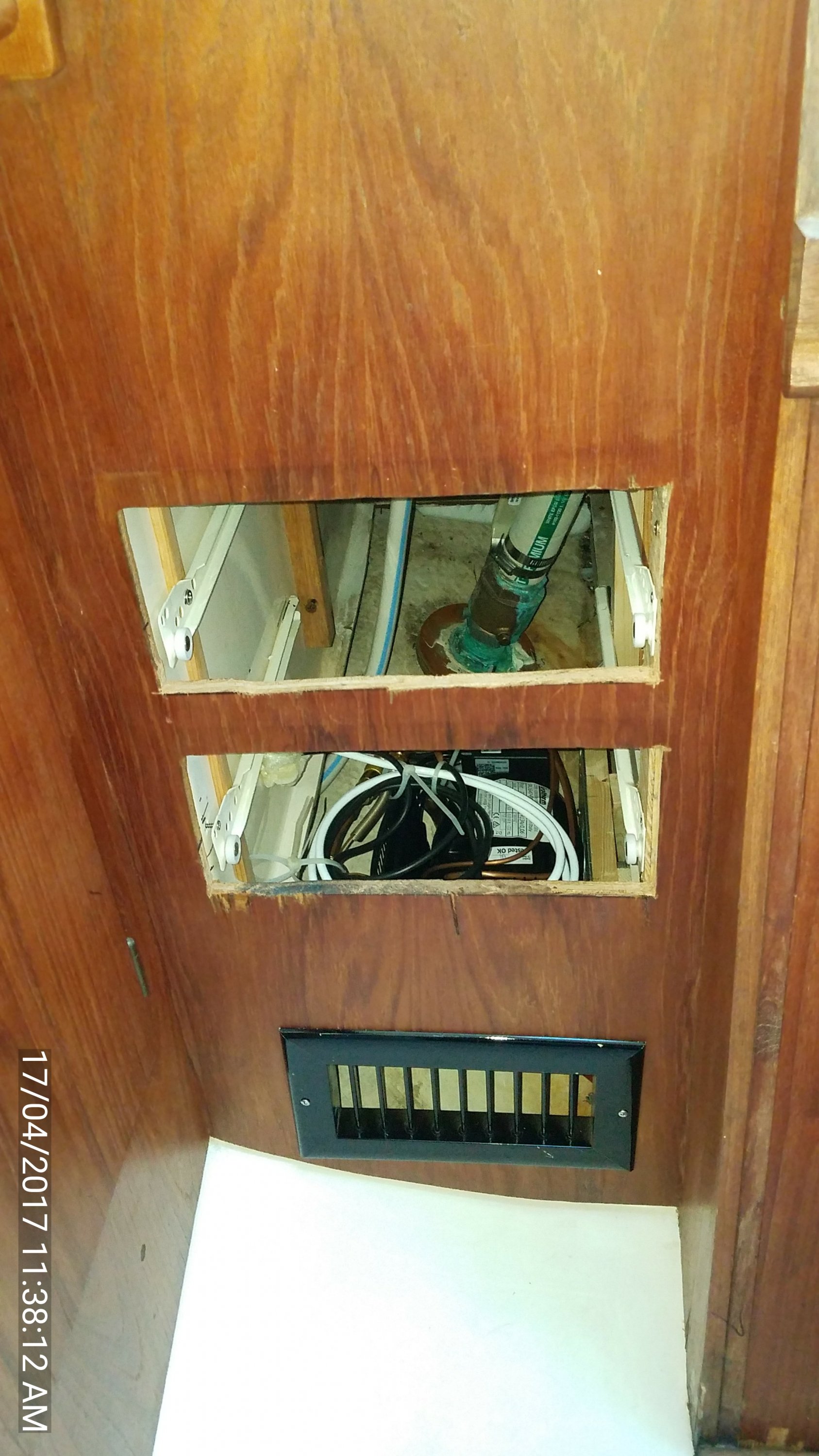

Very cool indeed, Jackdaw. Could you please tell me where you installed it and how is it ventilated? Where does the hot exhaust air exit?
Many thanks.
Jess
(Hunter 27, Jacksonville, FL)

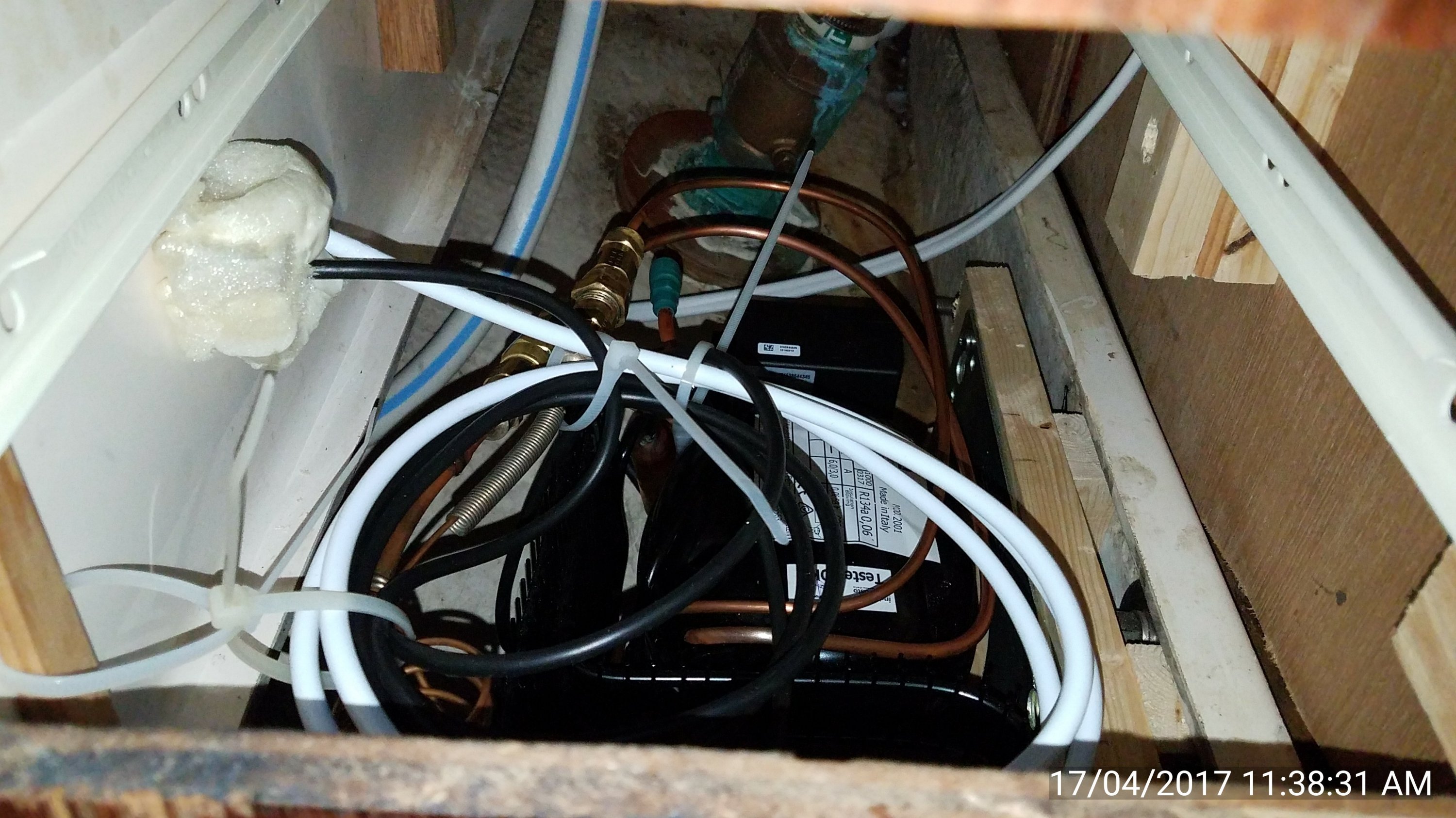

I installed an Isotherm ice box conversion unit in my H27 this spring. Here is where I installed the compressor: IMG_20170417_113812.jpg It is located below the two drawers that are below the sink in the galley. I cut out a spot to install a grill to improve air circulation. In this pic you can see where the freon lines go into the ice box: IMG_20170417_113831.jpg
