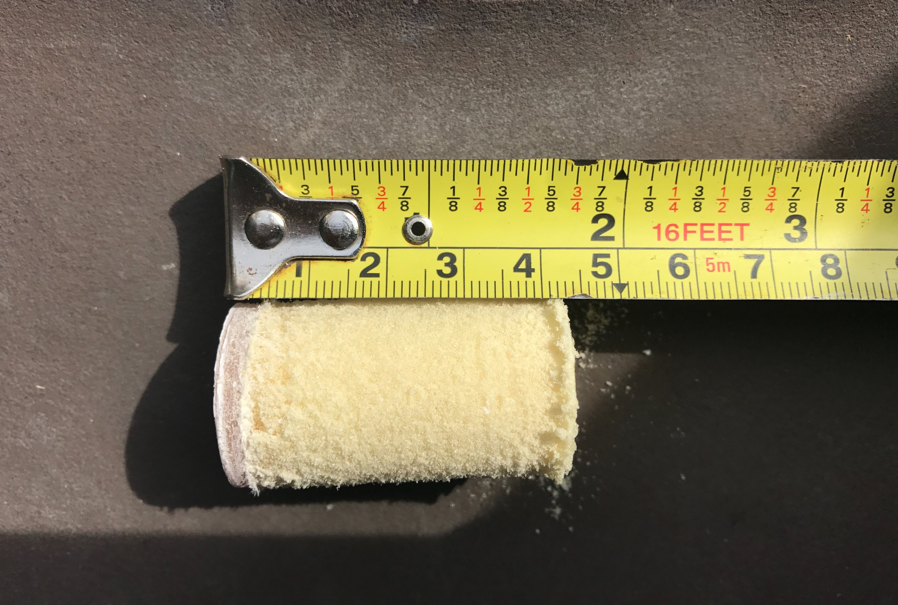

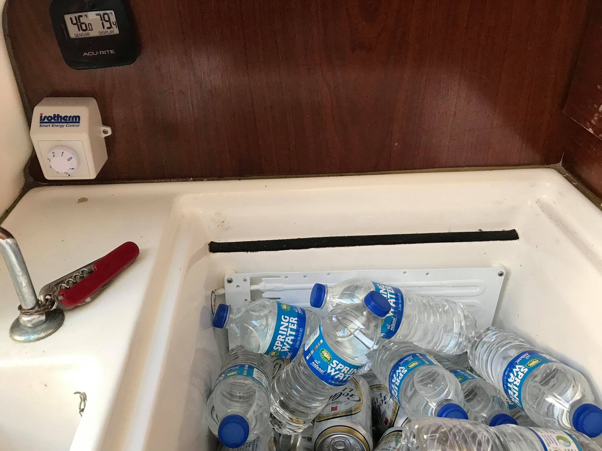

I installed an Isotherm GE 80s ISEC refrigeration system in my existing icebox. I'm very pleased. First pleased that the existing insulation in the box is thick for a 25 footer. Isotherm recommends 3-5cm of insulation for fridges <80L. Ours is 50L and looks like it splits the diff with 4cm.

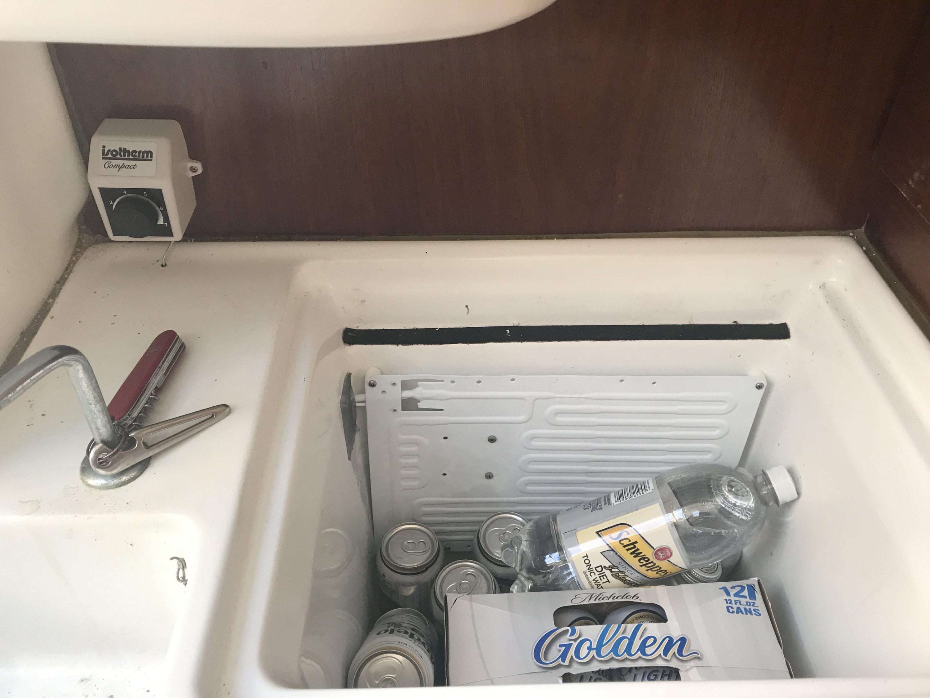

Next the install went very smoothly, and the plate fit like a glove.

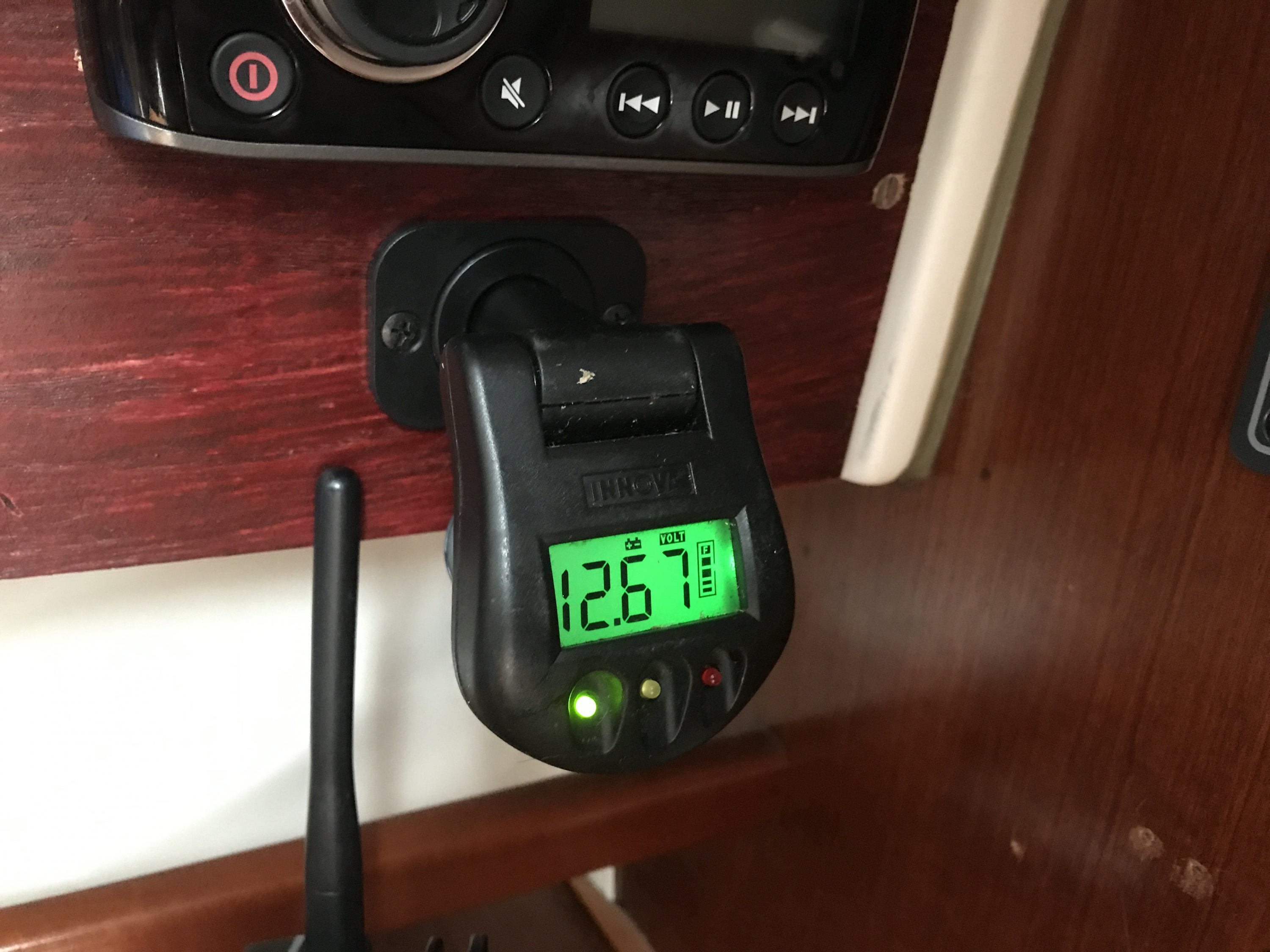

But the biggest news is the efficiency. The boat has a single Group 29 battery rated at 85 amp/hour capacity. Yesterday as a test I unplugged the boat from shore power at 7AM. It was in the 80s to 90 all day. Fridge is set at 42F. Twelve hours later I came back and checked the resting battery voltage.
That's 90% of full charge, meaning that the fridge used 8.5 amps in those 12 hours, or a 0.7A/hour run rate. Very good, and matches specs and other users observations. That's less than an incandescent anchor light!

I did the install myself, solo. It took 3 hours. It was rather straightforward... just a lot of steps.

No, it comes pre-charged, and the quick-connect connectors can be closed and opened without losing the refrigerant.

When we started, we would bring a bunch of cold beer and a bag of ice to the boat before a race and dump them in the icebox. The problem was the boat (and the icebox) was 80+F degrees, and in the 2 hours we raced the ice melted cooling the box down to 60. Warm beer. So we stopped that, and brought beer and ice in a soft cooler.
So yes we leave it running all the time, just like at home. We're at the boat 3-5 times a week, so not much sense in turning it on and off all the time. Plus the the ISEC system uses shore-powered time to sink cold into beverages in the box, and then uses much less battery for the rest of that day.

I have a suggestion. Rather than guesstimating the efficiency of the DC unit from the DC voltage on your battery, why not put in a DC Current meter so that you can monitor your battery usage by the current draw? I put a voltage and current meter in my boat last year and mounted just below the DC switch panel. Anytime the DC is turned on, the meter is on as well, and it shows how much current is being used on the boat. Even seems to be reasonably accurate below 1 amp.
Do a search for "LED Digital Volt meter Ammeter" on Amazon to get an idea of what meters are available. (Yeah, I know, things on a boat are SUPPOSED to be very costly!) The meter measures the voltage drop across the "shunt". The shunt may have about 0.050 to 0.075 volts across it. That small of a voltage drop won't affect your lights or refrigerator at all.
To install, you put the shunt (large metal bar) in the ground return lead back to the battery from the DC panel. You also connect up to the 12v line to power the meter (it uses VERY little current). Mount the meter either in the DC panel or somewhere in the area.
The current meter makes it easier to keep track of the load you are putting on your batteries so you know how much current each device requires. Incidentally, the meter won't show your engine Starter current, only the current that goes through your DC panel system.

I've thought about that, and indeed on all my other boat I have installed a shunt-based NASA Clipper BM-2 battery monitor. But on BlueJ the power loads and excursions are more modest for now, so this works.
And speaking of working, I'm not seeing what you are talking about when you say guesstimating. When trying to know how much water has drained out of a bucket, you can measure the flow in real time, or measure whats left and subtract that from how much was in the full bucket. Thats what I did, resting voltage is an accepted way to know percentage of charge remaining. No system measures perfectly or gives exact results, but this is way close enough for me; I just wanted to validate the numbers I was told to expect.

Jackdaw, 12.67V is the voltage of a fully charged battery at rest. I'm not questioning the efficiency of the fridge but don't think that little plug voltage gauge is giving a correct reading. Run the test again and let the battery rest for 2 hours and use a digital multimeter getting a reading at the battery terminals. The thickness of that insulation is impressive and it seems those units are real efficient but for your own peace of mind check out the actual power consumption. Yes, running them 24/7 on shore power is the way to go, I don't think they are going to wear out any sooner and the beer will always be cold.

I know that this little thing is probably not worth having 2 significant digits past the decimal! ;^)
However, all wet cell DC battery charge charts look something like this.
