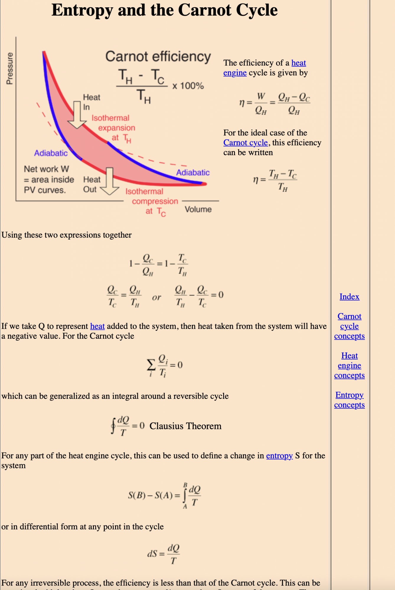

The old-fashioned steam engine worked like this.

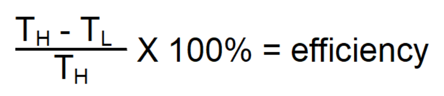

TH - TL (100%) = efficiency
T
H
Means that if the exhaust temp (T
L) was zero, the efficiency would be 100%. This would imply that all the heat energy was removed from the combustion chamber before the exhaust, but there has to be an initial ambient temperature, so there should really be a delta expression here that reflects that.
I'm not sure how it would work with a combustion motor but if you were to consider an electric motor at 100% efficiency for electrical energy, that would imply there was no electrical output on the positive side of the electrical circuit. That means no electron flow and therefore no movement of the rotor. An interesting paradox.
-Will

Of course there's room for improvement. Looking at the equation for efficiency in a Carnot cycle :
the way to make that fraction bigger is to make Th larger by higher compression and/or a hotter fire in the cylinder)
AND/OR
make Tl smaller by exhausting into a vacuum.
unfortunately much easier said than done.
Not really. Your starting temperature (pressure) and the exhaust temperature (pressure) are both measured above the same ambient so no need for a △T in either the high or low temperatures.
Oct 19, 2017
8,162
For and ambient temperature of TA you would have to do something like,
T
H - TL - 2TA x 100% = EFFICIENCY
T
H - TA
or do you already subtract the ambient temperature before entering the values into the equation? It doesn't just cancel itself out.

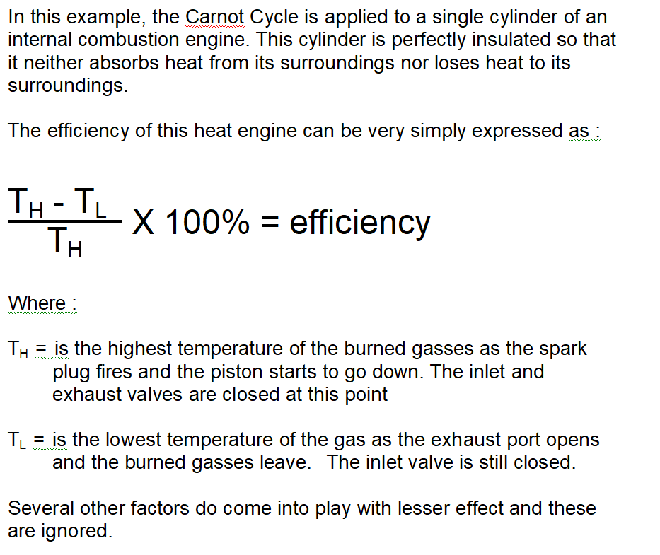

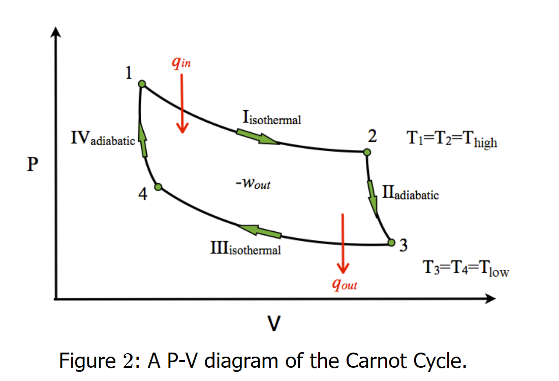

Will, you have a good grasp of thermodynamics, so you asked for it. Here's the nasty (but actual) version.
The Carnot cycle is not the same as an IC engine. The working fluid (gas) remains inside the cylinder. No intake, no exhaust.
Now this is purely theoretical. No reality here. Heat enters the cycle by removing insulation at the top of the cylinder and conducting it into the cylinder at points 1 - 2. The same goes for removal of heat at the bottom of the cylinder at points 3 - 4. The other two paths 2 - 3 and 4 - 1 are adiabatic (no heat addition or removal).
For a good description of the cycle, see :
Go no further than P-V Diagram for a very concise description of what happens in the cycle. Read the rest if you want proof of each path. I must admit, I like this one better than my old texts.

With more than 100% improvement possible based on R Diesels calculations within the Carnot Cycle, for diesel engines alone performing at 35% efficiency levels, what can be done?
Taken from my previous post #28 :
AND/OR
Unless someone comes up with a "modified" diesel engine that works on a cycle other than the Carnot Cycle, the equation says it all. Right now, we don't have the metallurgy for higher temperatures and we can't exhaust into a perfect vacuum. Back to the drawing board I guess.
