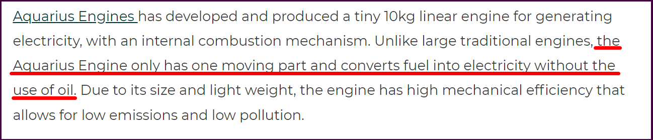

In a rethink of engine fundamentals, Aquarius has pared the range extender down to a single piston that blasts to and fro inside a valveless 600cc cylinder, generating power from electromagnetic coils with each stroke. It delivers more than twice the overall energy efficiency of a typical combustion engine, according to simulations by German engineering firm FEV.​
I am not thinking this is a panacea. I am willing to wonder, what could be possible

The Hybrid idea is what seems feasible on a boat. The use of the little engine to generate electrical power for boat electrical use to include power for an auxiliary motor. It is said to be capable of producing 32kW. It would be able to charge a LFP battery. With a fuel based charging source you would be able to have a power charging source that supplemented solar and wind. When north of the 45th parallel this becomes important during 6 months of the year.

How does it exceed any other piston engine on the road for thermal efficiency ?
Reading the material, the claim is Mechanical efficiency.
While Rudolph Diesel, during his invention period, attempted to develop an engine that could reach the "thermal efficiency" limits theorized by Carnot, he realized the goal was unattainable as his attempt to compress the engine air at a compression ratio of 60:1 was beyond the technological capabilities of his time. Had he succeeded the efficiency would have been 73%. He accepted a less than perfect system and succeeded. His first fully functional engine produces 13.1kW and had an engine efficiency (Engine efficiency of thermal engines is the relationship between the total energy contained in the fuel, and the amount of energy used to perform useful work.) of 26%. This far exceeded the 7% engine efficiency of steam engines of the time.
Even with all the advances we have to date, the engine efficiency in a typical small boat diesel is in the 35 to 40% range. The compression ratio of most diesel is between 14:1 and 25:1.
I ask you @Ralph Johnstone, if the state of the current technology is such that diesel engines are not even reaching 50% and the theoretical limit as calculated by R. Diesel was 75%, is there not room for improvement?
Could not someone develop a more efficient boat engine model that is greater than 40% engine efficient?
