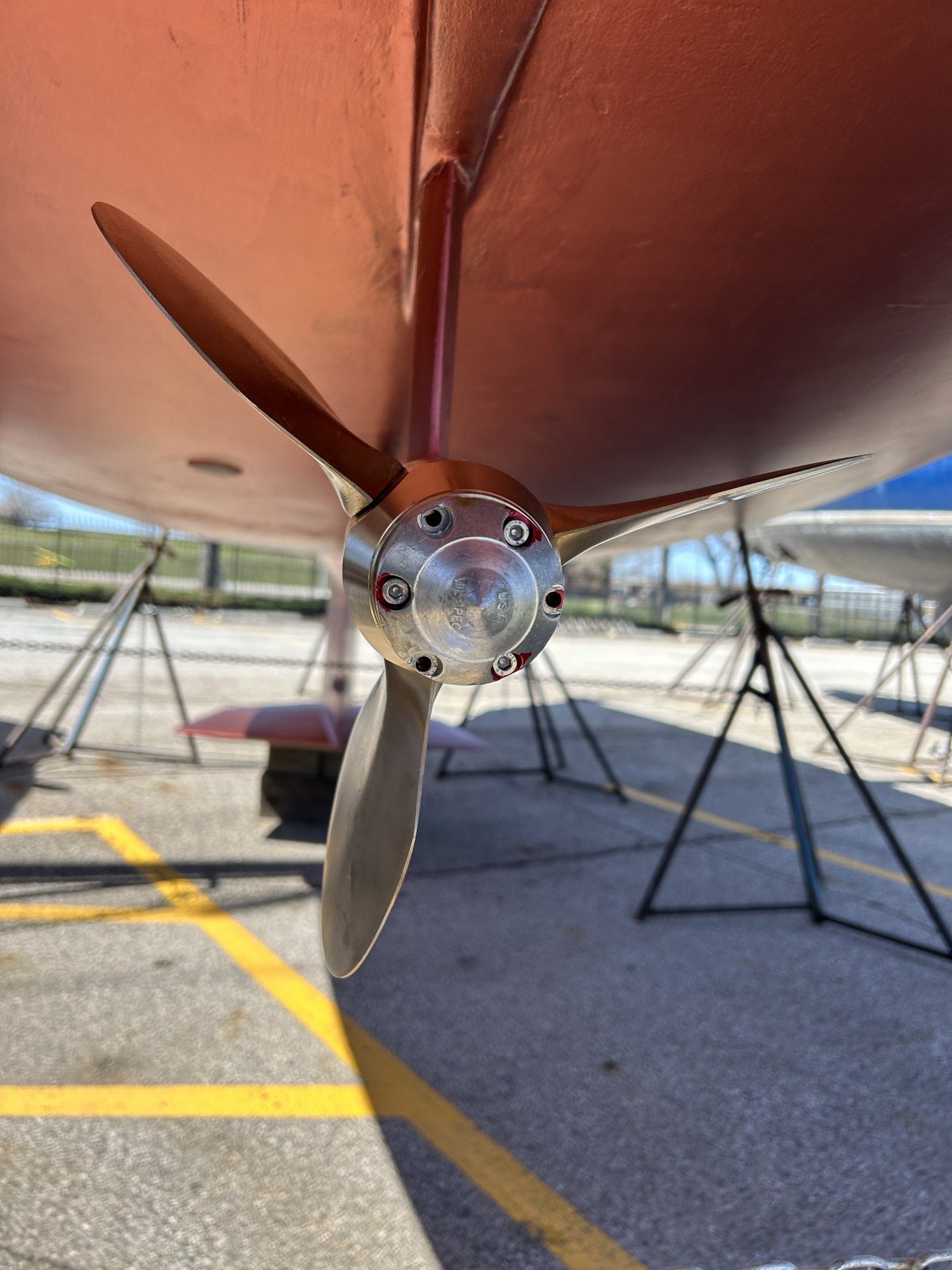

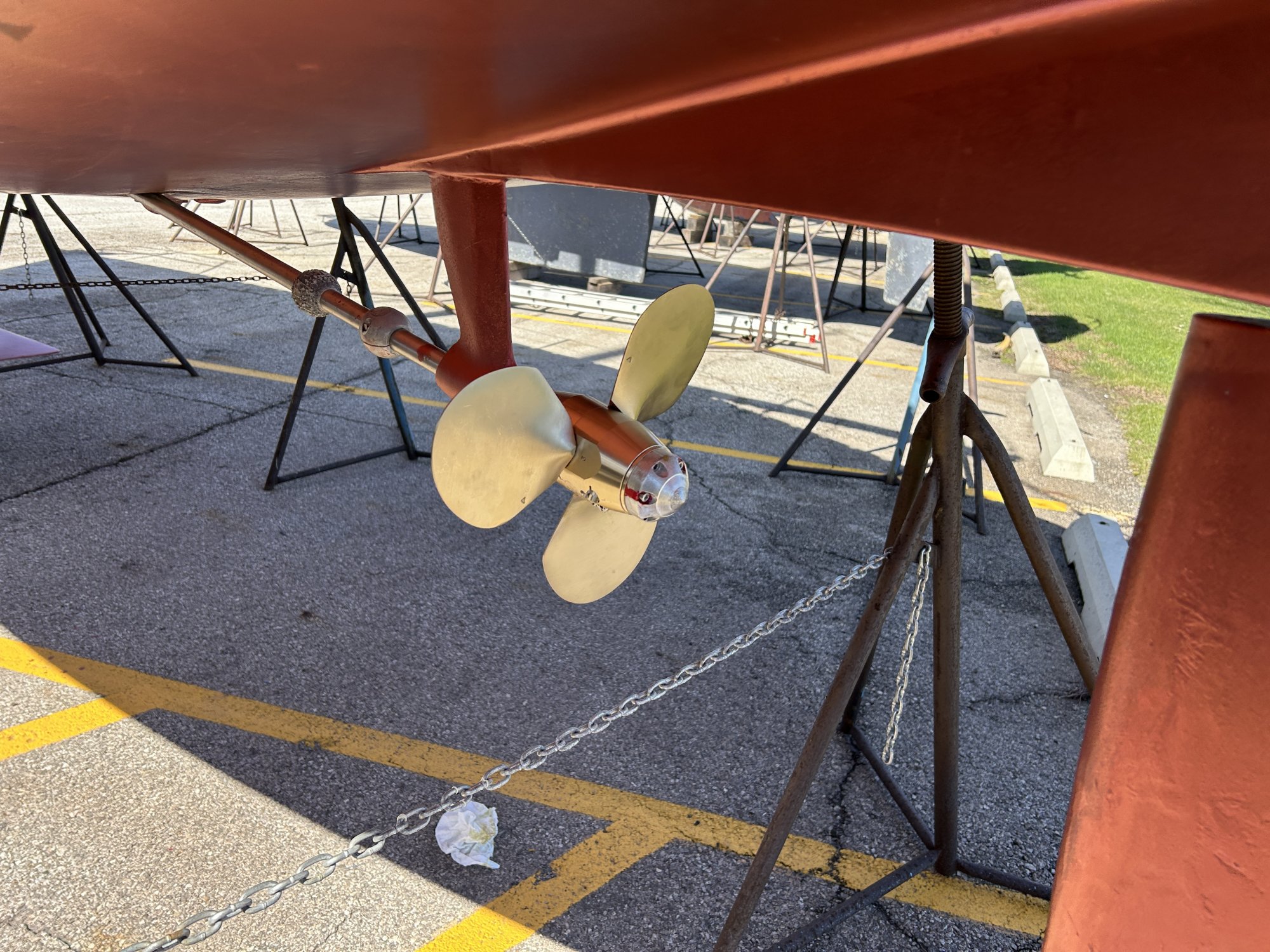

One reason I went with the MaxProp…I think mine is pitched a little less than I would like, and when I haul out in the fall, I will be able to tweak the pitch just a little. It is very smooth under power, feathers easily to add about .5 knots speed in light air, and the reverse thrust is fantastic.
