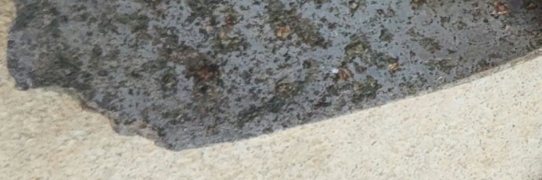

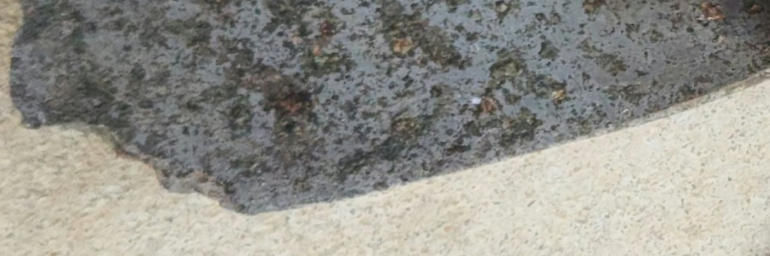

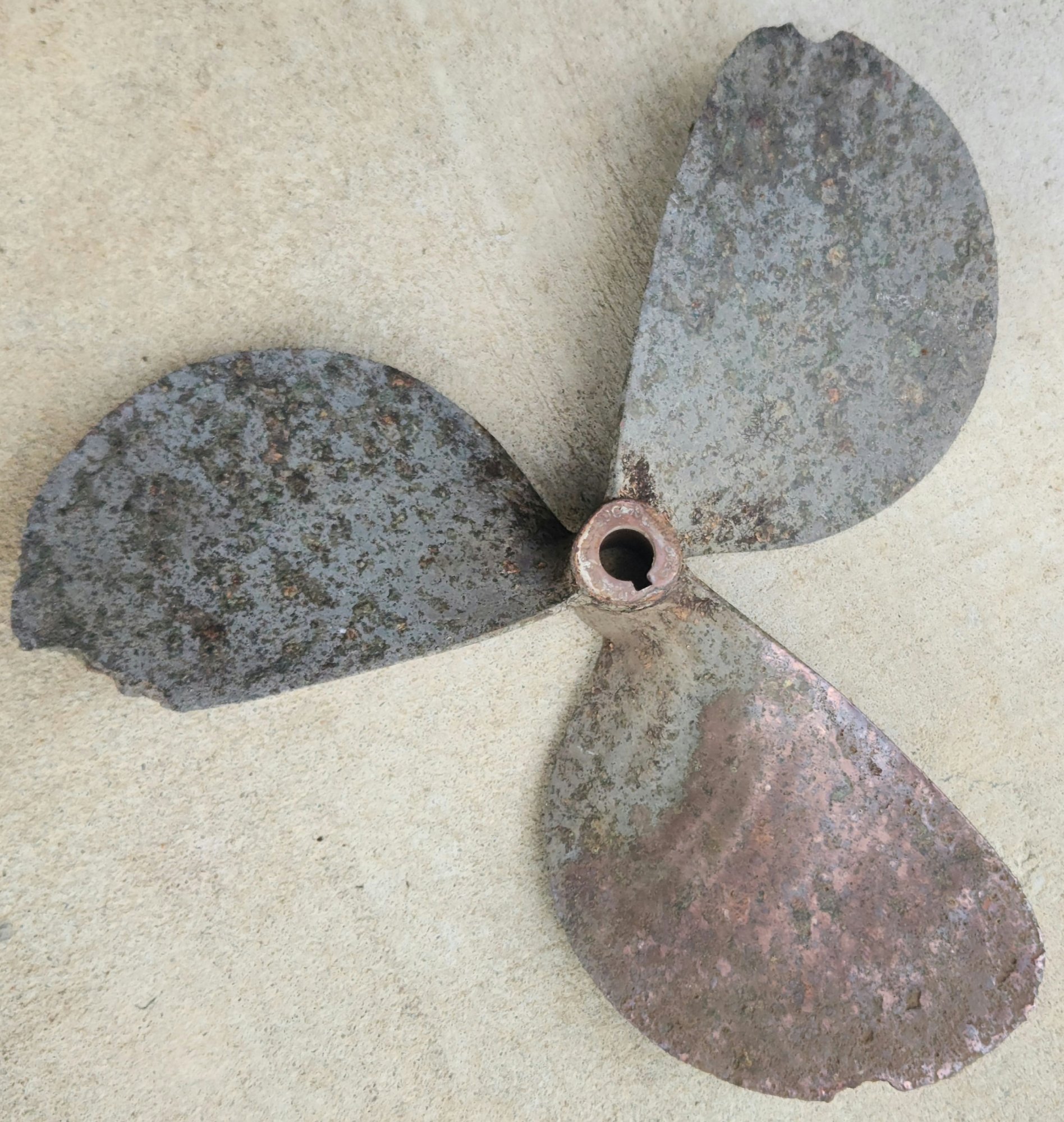

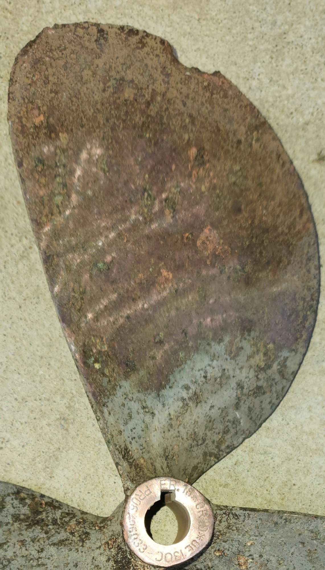

This looks worrisome. I cleaned up one of the blades and it appears that it has suffered from galvanic corrosion or maybe electrolysis. It looked about the same when I purchased the boat 3 years ago. Now I need to inspect all the thru hulls.
Jan 4, 2006
7,769
Just by fact that you are missing a couple of sections of blade while adjacent sections look smooth and solid, leads me to believe that the missing parts are due to mechanical damage caused by an impact with something solid.

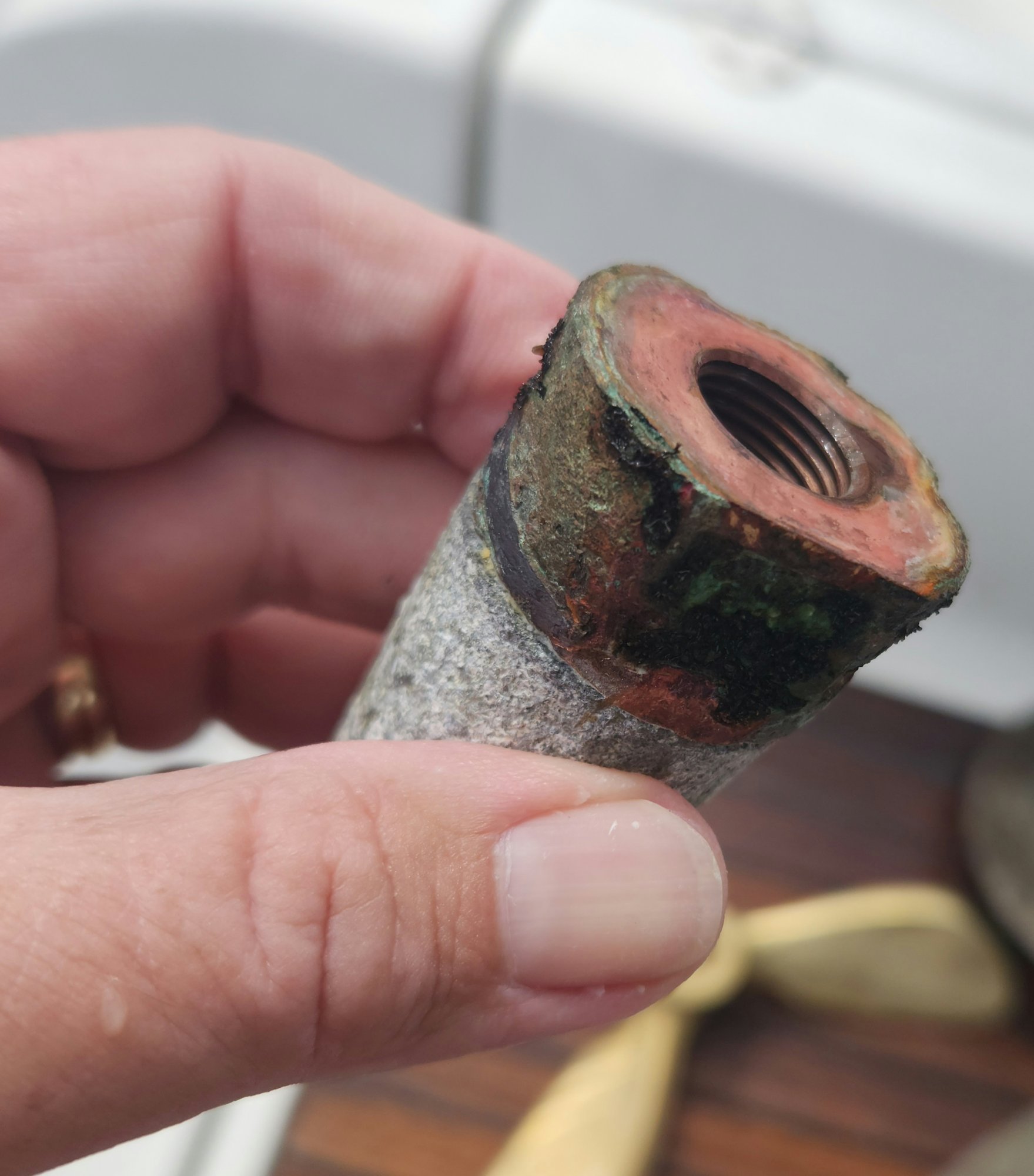

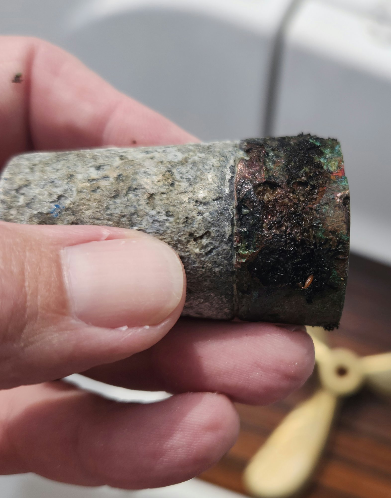

:plus: Yes. Do you have room for a shaft zinc?
I do think the previous owner backed into something at his private dock.

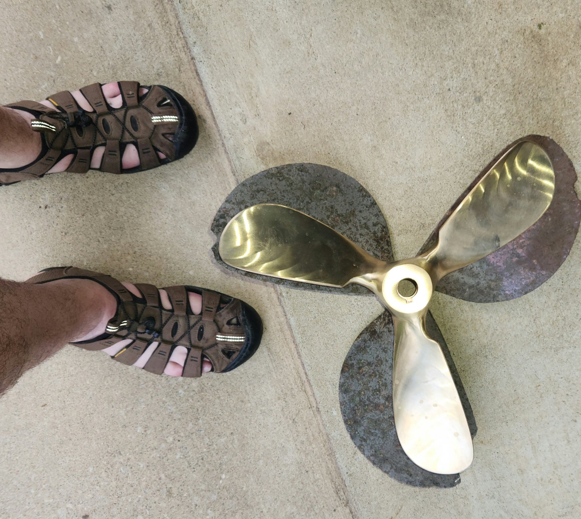

I cleaned up one of the blades with a gasket remover pad and an air grinder. Look how pink it is. The only place that resembles bronze is near the keyway.

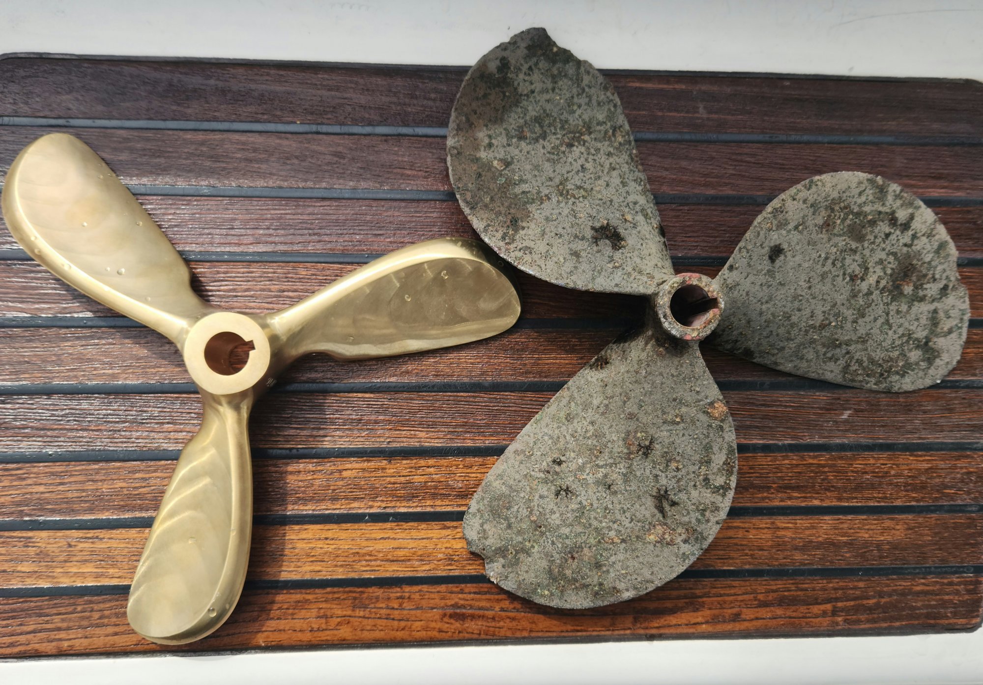

The nut might have been just more than finger tight. The prop came off so easily I don't think I even needed the puller.
The old prop ran smooth and pushed the boat to a peak speed of 7.2 knots GPS. The prop walk in reverse was bad.
I found the new prop nut. Hopefully I can get it installed today.
The old prop is 16" in diameter and appears to be 10" pitch. The new prop is 14 x 8.5, that's a lot smaller.
I saw that. I've got to wonder if the casting metal wasn't quite up to scratch when they cast that specimen.
All I can suggest is to head onwards and upwards from here. Make sure there's a zinc in there somewhere. Any chance to slip on an extra shaft anode somewhere ? I can't remember if you're required to use magnesium or aluminum but it's definitely not zinc unless you're in a salt lake. Maybe that's the cause of the previous corrosion if the wrong anode was being used. Check carefully each time the boat is out of the water to see if there's anything unusual going on with corrosion.

With the backside of the shaft nut pink, I’d replace it. That old prop is in tough shape. It must have vibrated like crazy!

One further question, is the shaft SS or bronze ? If SS, this makes the correct anode material even more important.
