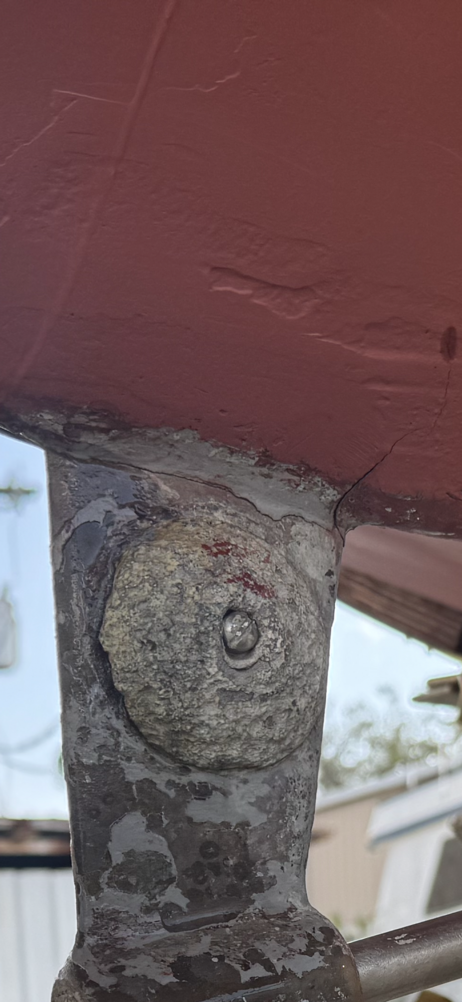

Hi all. I have been looking at boats for about a year and a half. I think I have finally found a good match. The boat is currently out of the water and I noticed something going through the pictures that I would like to run past all you more knowledgeable folks. This is right above the drive shaft support. I know that zinc needs replacing but it’s the crack I concerned with.

That is one of those issues, with mature boats that validates the value of having a professional surveyor look at a boat before purchase.
There are any number of possible answers. They would require investigation to determine the severity of the issue and identify solutions. It could be something easy or difficult to repair. Did something hit the strut?

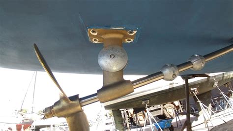

A strut looks something like this.
It is bolted to the hull.
It appears on your boat that a previous owner covered the bolts and upper plate with fiberglass. Perhaps the crack is superficial. On the other hand it could mean there is structural damage. That is why I would get a marine boat professional to take a look and offer an opinion.

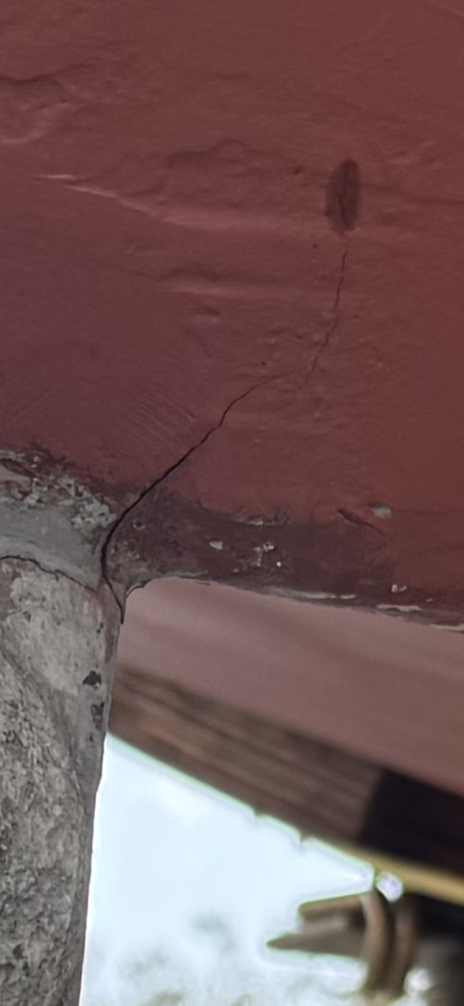

There’s a range of possibilities that are a little hard to narrow down from just the picture. This could be anything from a crack in just the paint to more serious damage running through all of the laminate. A first step would probably be to check inside the hull and see if there’s any evidence of a crack there. If there is I’d say that’s reasonably severe damage and in need of significant repair to redo the laminate. If the crack doesn’t go through to the inside I’d make sure a surveyor took a good look at it to determine how much risk there could be.
What kind of boat is it? I vaguely remember some boats having a more integral strut like that rather than the bolt on like jssailem pictured, but I can’t remember which builders may have done that. Others might know that better to be able to figure out whether the strut was glassed over by a previous owner.

It would be helpful to know the make of the boat.
This could be something really simple, like the polyester fairing compound has shrunk (it does over time) or much more serious involving structural damage.
Given the hull shape, I don't think the base of the strut is flat, it may be V-shaped to match the hull or more likely it is just vertical and held in place by fiberglass. Getting a look at from the inside would be helpful.
A side note, the anode needs to be replaced. It is worn and looks like it has been painted over.

Even if that is a bolt on strut, and even if the crack is in the fairing around the strut mount and not structural, removing the strut immediately leads to shaft alignment issues. These alignment issues can be out of a DIYer's realm.

I too suspect it’s just a problem with the fairing compound, but it needs to be investigated. I would not buy it without having a surveyor look at it. (If you buy it you’ll need the survey anyway, to show an insurance company before they will underwrite it). The surveyor will be able to state how to correct it and estimated cost.
The noninvasive things you can do as an amateur is tap it and compare the sound to the surrounding area, wiggle and shake it to know if it’s firmly attached (by feel and look for slight changes in the width/relief of the crack while trying to move it) and examine the inside of the bilge to see if you can detect any visible cracks or delaminated material there.

ok, i was going to ask what the hull is made from. Normally, we wouldn't fare on top of the strut. The strut is bedded and tiltted to match the shaft to the shaft log and the coupler to the transmission. The bolt holes are sealed. Generally, we avoid putting anything over the bolts, as it makes removal or adjustment much more complicated.
I'd look for photos of other boats of the same model, do they have the same amount of fairing? Any signs of water intrusion inside?
I'm wondering if maybe they wrapped a rope around the prop and didn't bother hauling out, inspecting and repairing. Wrapping a rope puts a huge twisting force on the strut which can crack gelcoat and break fiberglass (before the engine stalls).

I think this has been answered pretty well. I would just add/emphasize that the only way to really know what is going on will be to, at minimum, sand down to whatever is beneath the paint. And, very likely, beyond that. Even if this turns out to be superficial cracking, its repair is not trivial. I see some things that suggest this is fairing over the underlying structure. But, also some things that suggest that the underlying structure was compromised.
Again, just speculation until you sand down to bare material and have a proper look. Ultimately, you will need to grind down to remove all compromised material, at minimum, but you might be able to see what's going on by just removing the paint.
A good surveyor will be able to tell you what is "probably" going on. But, I would not run the engine without doing a proper fix. I would be surprised if this did not involve underlying structural compromise.
One thing that makes me go "Hmm..." is that little wet patch in the upper end of the crack. Very hard to say because I don't have any other context for the photos, but unless we had a good explanation for why there is moisture there, I would be inclined to think that crack runs deep. At worst, that is water making its way from the bilge. More likely, it is water retained in the crack from being sprayed - but even then, it suggests this is more than just a shallow surface crack.

1). Fiberglass is repairable. I had to replace the prop stut on my Catalina. The factory faired around the strut with thickened resin which could be prone to this kind of cracking.
2). Most surveyors will tell you there’s a crack and it’s hard to know what’s really going on without doing something invasive. But they may be able to spot something you didn’t, like a bent shaft.
3). As others have said, you need to figure out how the strut is attached to the hull and if the crack compromises its integrity. Or if is perhaps evidence of some kind of adverse event.

I am in agreement that there is likely fairing compound there. It was repowered so it may have been done then.
The shaft spins easily and seeming true, without a dial indicator.
That water spot caught me also but it had just come in on trailer and driven through the rain on the way so could be from that. And the bilge is dry as a bone.

It looks to me that this strut was repaired at some point, but not well. There appears to be some fiberglass layers that are sitting proud around the area and some low spots that weren’t faired. The cracked areas look like the edges of either fiberglass or filler that are starting to peel up under stress. There is water getting under the areas that are starting to peel. That can freeze (I’m not sure where this boat is) and continue to peel the laminate back.
Regardless, this area needs further investigation in-person by someone that is qualified. The quality of the repair raises questions about how thorough the rest of the job was done. Tapping on the repair area will yield some information about how much of the repair is delaminating, but again, the repair as a whole is suspect. The prop shaft may never have been aligned well after the repair. The prop shaft could be bent. These factors could be stressing the repair and failing it slowly over time. There’s a lot of what-ifs here that need to be investigated. Having someone qualified to investigate it will cost money, which is worth it if you really love the boat.
If you really like the rest of the boat, I wouldn’t think twice about investigating this and getting some estimates of what a quality repair will cost. All of this is negotiable with the seller and really isn’t all that out of routine for an aging boat.
