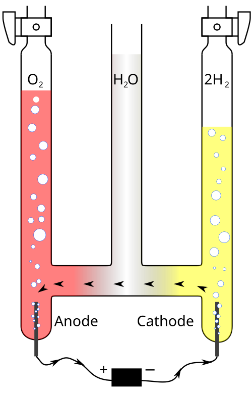

While often used to describe galvanic action, electrolysis isn't the correct term. Electrolysis is a process by which a DC current is applied to a compound to separate the elements. This is often demonstrated in HS science classes by separating water in hydrogen and oxygen.
Source: Wikipedia
