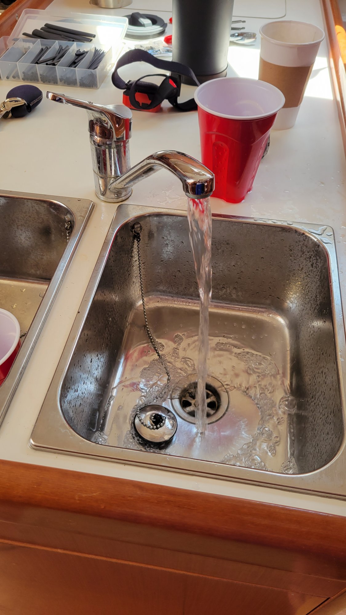

Hot water is fixed. Thank you everyone for the help. I disconnected the hose where it goes into the tank and confirmed that there was plenty of water pressure when the pump was turned on. I noticed an arrow on the fitting that the water inlet hose was attached to. I figureed that might have been clogged so I removed the fitting and sure enough, the one way valve was stuck closed. I freed it up and put it all back together.
The pump ran for about 30 seconds as the tank filled up. I made sure to run enough water through it to completely flush it out. I also turned on the hot water switch and about 10 minutes later I had hot water. Confirmed that the head and swim platform shower both worked too.
24,509
Man that is a success. Follow the water flow and find the clog... Novel concept. Well done.
Works for fuel lines as well should that arise.
May you enjoy warm showers long into the night...
