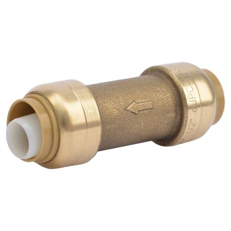

non return valve
Also known as a “ check valve”. It limits the flow to one direction. When working wonderful. Can get clogged and or fail. Or be installed backwards.

The typical check valve that I have seen is often of brass.
The arrow identifies the direction of flow. It would be nice if the install put the valve near the manifold or near the outgo of a tank. But that is not always what happens.

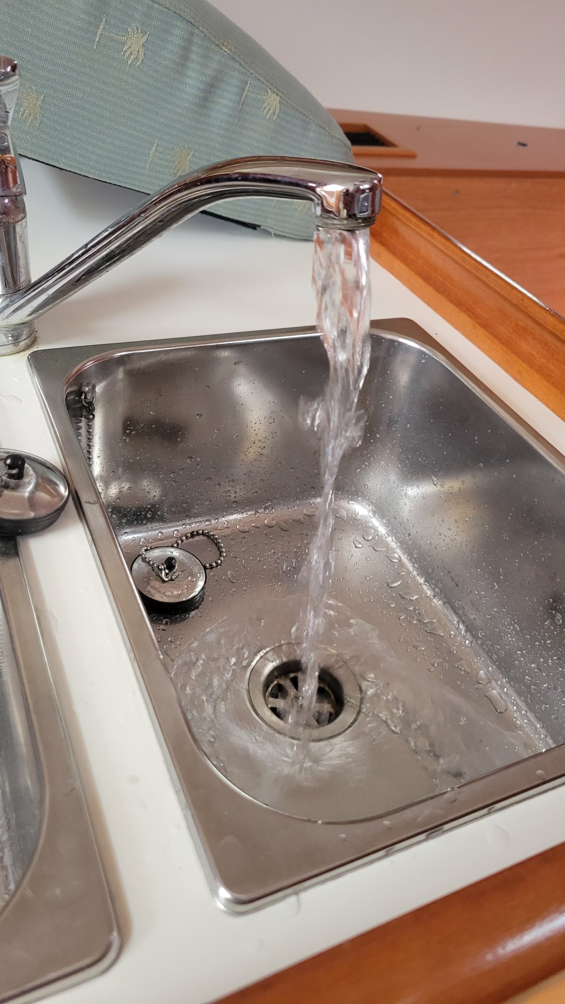

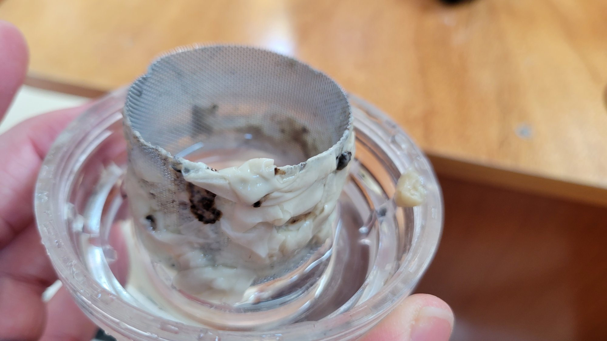

Thanks again for all the help. I got the cold water working, but when I put the faucet in the hot water position, the flow slows and eventually stops. The problem I resolved was a clog at the one way valve right after the manifold and before the strainer. There was some sort of white, almost paper like substance clogging everything up. I had to remove the one way valve, clear it out and reconnect everything. I also disconnected each water line right before the switch on the manifold and let it drain into the bilge until there was no more white paper stuff coming out. I ended up having to clean out the strainer and one way valve several times before I could get a consistent flow of water, but now the strainer is staying clean so hopefully I got it all out.
Not sure what the problem is with the hot water though. There is like a pressure relief or bleeder valve that I flipped, and water comes out.

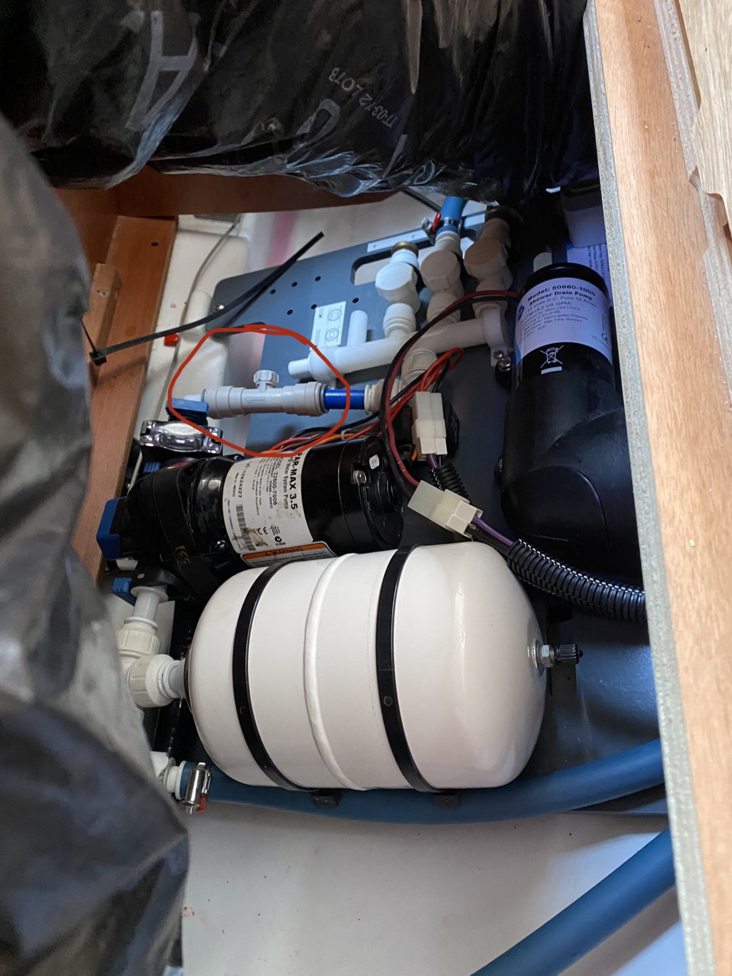

Photo attached. Nothing in terms of a manifold or mixing device that I can tell. It looks like the water goes into the manifold, through the strainer, to the pump, and then from there the line splits with one branch going to the hot water heater. I'm not sure the white stuff is able to make it past the strainer, which is I why I'm not sure it's the same problem. As you can see from the picture, the white stuff is kind of big. I think I need to just disconnect the water line where it goes into the tank and see if that is free. If it is, then disconnect it where it leaves the tank, and see if that is free. And then just follow the line from there until I find a clog. I'm worried the hot water tank is bad and the problem is inside the tank.

It looks like fat scum, or maybe a used condom.. Not something you want in your water system.

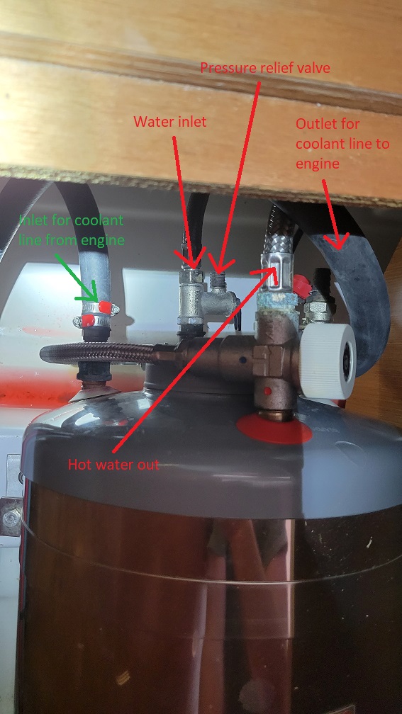

Ok. I meant a photo of the water heater and connections…I need visuals ;-)
if the water pump is on, and you can get to the T&P valve on the tank, you can flip it open and water should come out if water pressure is making it to the tank. Otherwise, you can remove the inlet hose and see if you flood the boat.
Assuming you can get water into the tank, flushing and draining it is a good idea. Will be interesting to see if the water will drain out the water heater drain…

Here is a picture of the water tank with the lines I figured out labeled. When I flip the pressure relief valve arm, water comes out of the outlet. I'm not sure how much water is in there but it definitely smells bad... sort of chemically like perhaps old antifreeze.
