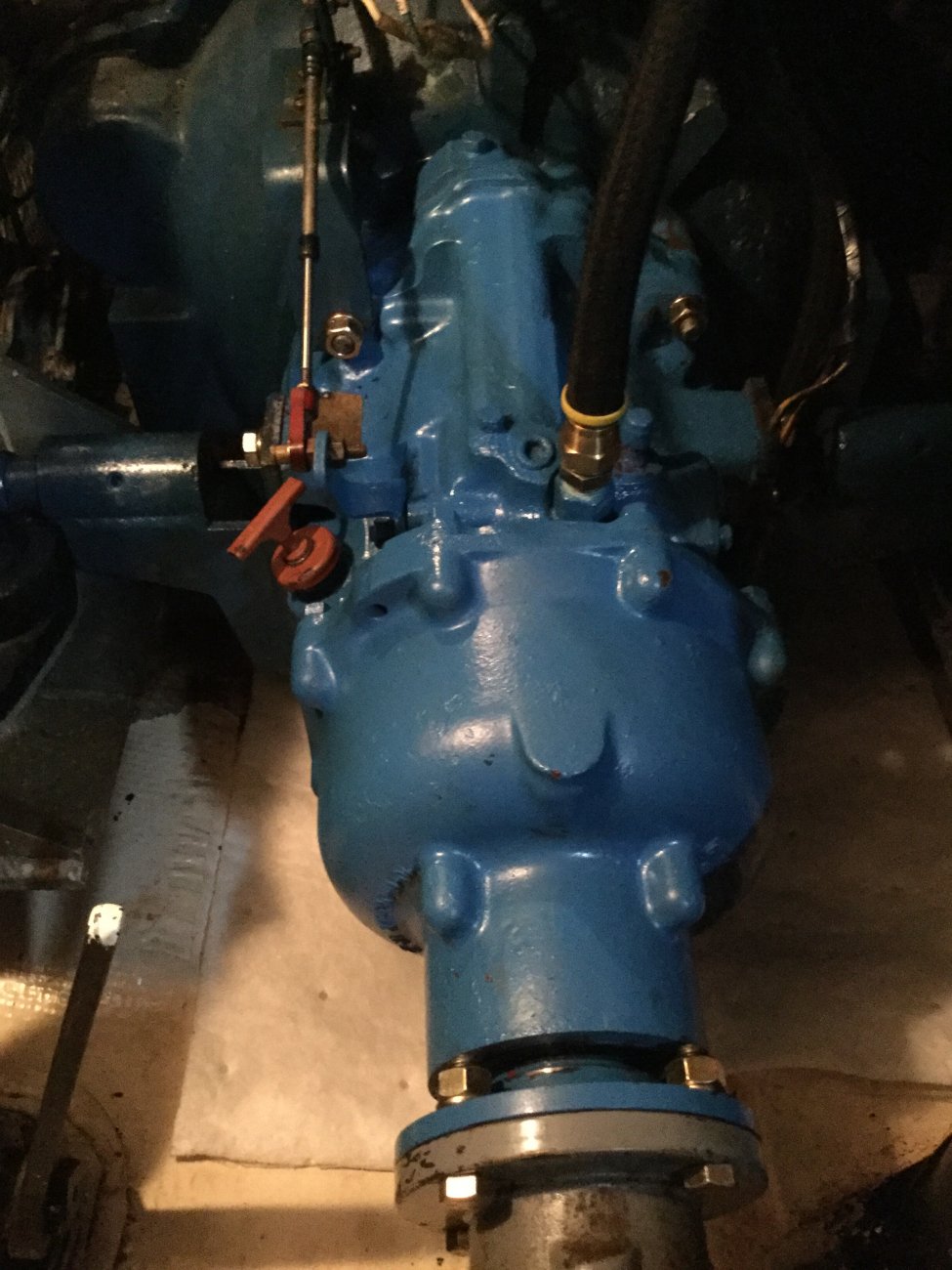

Hi all,
I’ve been having an issue starting the engine and it’s because the neutral lock out switch gets stuck. I have been able to tap the transmission with a little hammer and it starts right up. Does that switch ever need maintenance or should I get a replacement ready just in case? Can that switch be bypassed?

I'd like to know exactly what your tapping. I've never seen an internal switch.
May 20, 2016
3,015
When was the last time you checked/changed your trans fluid?? Without pictures it’s hard to guess, but I’ll take a go anyway.
1) bypass switch is possible 1 the NSS (neutral safety switch) probably has two wires on it - one to the starter switch and one to the starter solenoid. Put a switch across those two wires - when in off position NSS works normally, when on NSS is bypassed.
2) There May be a push rod in the trans under the switch you could clean or the switch may be bad. Fixing either requires much more knowledge of how it’s setup. Try lightly tapping the switch rather than the trans.
“Internal” switch I’ve seen is on a velvet V drive. The switch is external, but the activator is inside the trans.

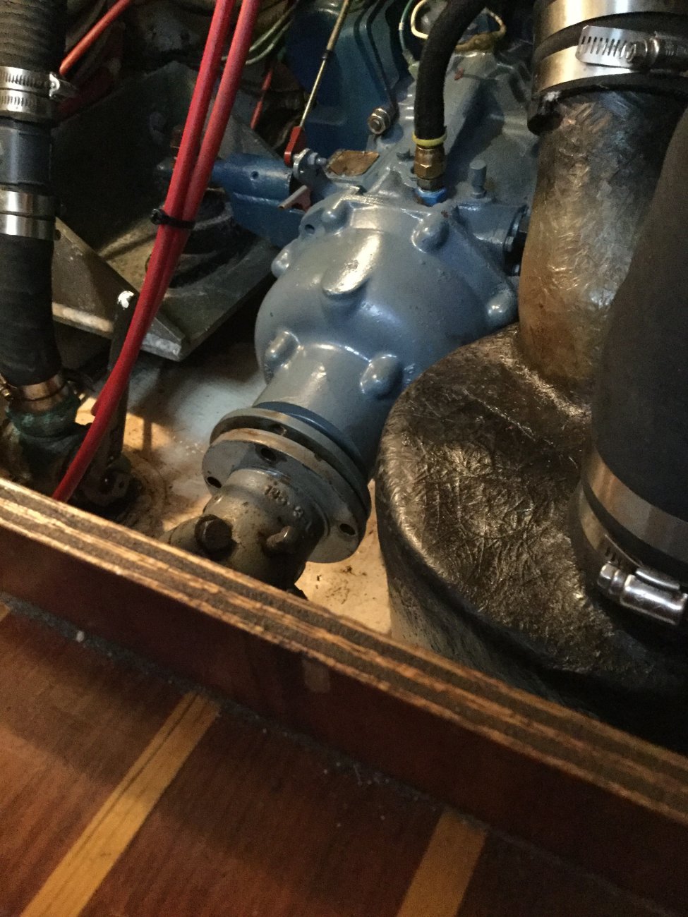

Velvet drive tranny. Perkins engine. My wife says she can hear it click when I press the start button. A gentle tap right by the switch seems to release the solenoid. (If it is a solenoid). One cable pulls the link to forward then through neutral to reverse. The tranny oil gets changed after 500 hours which is almost due.
The switch is just behind the water bubbler.
