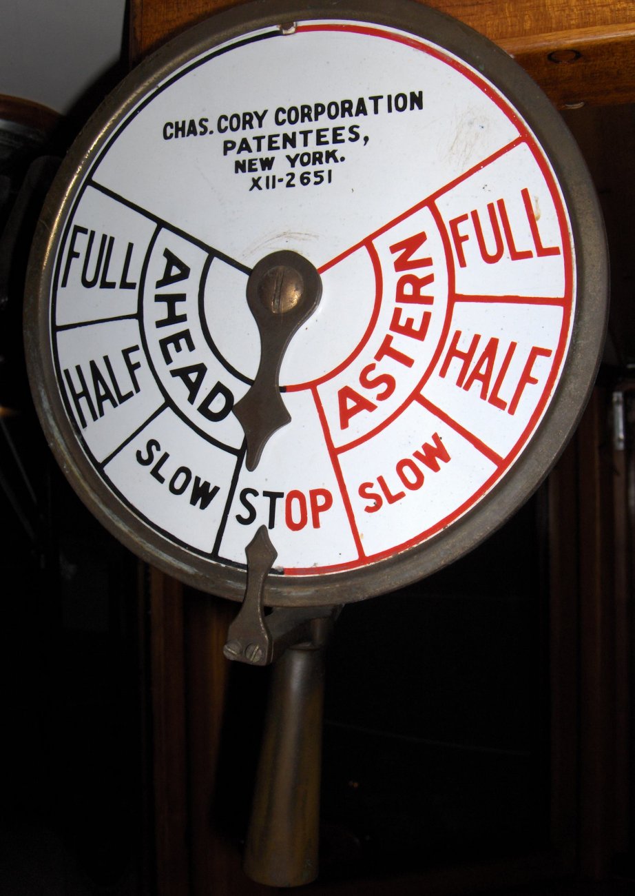

Just for entertainment purposes, here is our gearshift/throttle:
If I were honest, I would admit that THIS was the deciding factor in buying the boat!

Hello NotCook, Impressive! I agree with your thoughts on the reason to purchase based on the gearshift/throttle. Do you also have a "tube" to talk to the crew in the engine room? Is your vessel steam powered? Best Wishes.
