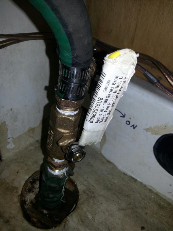

Since I was not able to get the old broken valve off easily while in the water, I went with Allan's suggestion to put the new valve (see pic) in series with the old one. With the help of SteveB, the raw water intake can now be closed! Thanks Steve and Allan! Looking forward to Allan's pictures.
1,676
Hunter 34 Alameda CA
Sweet! You should be able to do that three or four more times before you run out of room. :D

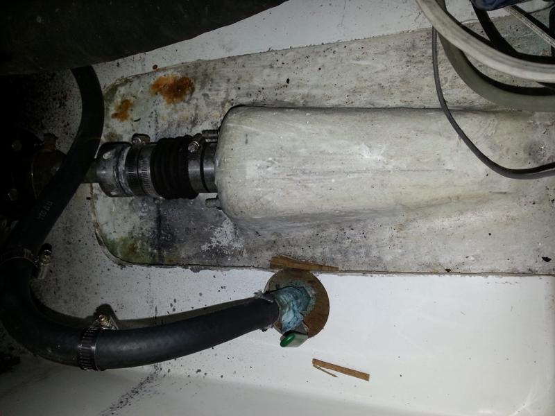

I just finished a write up (with the pictures) of my through hull replacement that will post in the Hunter 34 Owner's Modifications section. As soon as Phil approves it, I will post the link to the article here.
