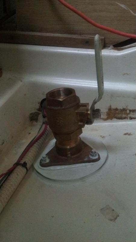

I put Marelon thru-hulls and valves in my 27 as replacements. Be aware that the valves may stiffen up after a couple of years. You'll need to keep after them with lube and work them often. I know of several that wound up having broken levers as a result of this problem.

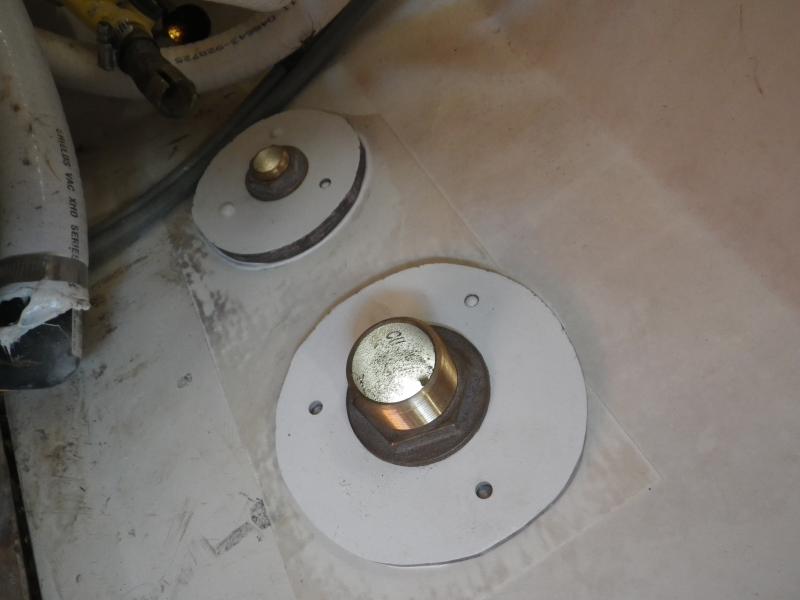

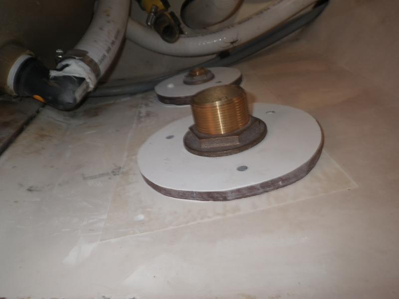

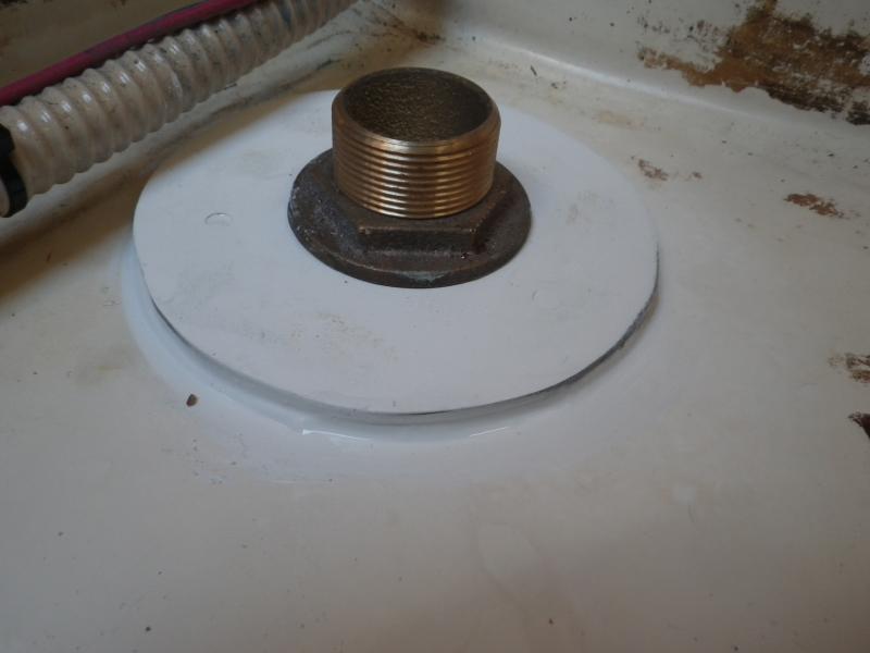

You can use plywood as the valve backer if you seal it up thoroughly on the surfaces and all the exposed edges. A product called "Gluv-It" is a good choice if you don't use multiple resin coats to seal the wood.
Thanks Dan, I'll stay on top of that. You know whats worse than no lube? A thruhull that has had the nut Loctited on. With two of us we barely got a couple of turns before it broke loose from the hull and the nut started rounding over. I may be 50 miles from home but never leave without a Sawsall. And this is only day one of the haulout. And the yard was 3.5 hours late pulling us. There goes Friday splash. But I digress.

With the diver here, I was unable to get a good enough grip on the thru hull without risking a failure. Due to the fact that this was an intake strainer, the diver wasn't able to put his tool inside to hold it still.
Since the only problem is not being able to close the valve, I'm going to take Allan's advice and hook up the new valve in series. That way I'll be able to shut off the water until I haul the boat out.
Thanks Allan! How's your haul out going?
The thru hull part is going fine. I work on it in between tasks that I have to wait for. I have pictures. We are headed to the yard now and first up is to dry fit to get the valve handle turned the right way then install so we can get the first coat of paint on.

The new larger through hull is in. I listened to the others and swapped the bronze through hull for a Marelon one to match the ball valve. Now there is no more thread mismatch or material mismatch. As my first plastic underwater through hull I will have to use caution in the future when prepping the bottom for painting (i.e. dry sanding with 40 grit paper). Don't want to grind that sucker off.
