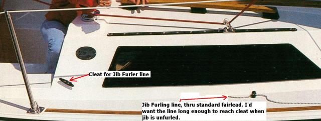

Use a cleat (should already be there, mounted to starboard side of cabin) along with a fairlead to guide the line to the cleat. (I've included a pic below). That said, it you are serious about using a furling jib, find a sucker to take that Schaefer unit off your hands and get a furler that is truly big enough for a 22' boat. HARKEN and Schaefer still make wire-luff furlers and a larger one is a good idea (ex. Schaefer System 550). The particular Schaefer furler (model #100) that came with the 222 and the 192 was never designed to be used on a boat as big as the 222 (or the 192 for that matter). it is designed more for a smaller boat like the Day Sailer (and was standard on the DS III). I heard that direct from Schaefer, they were not happy about O'DAY using that model on larger boats and it really is not strong enough for heavier winds.
