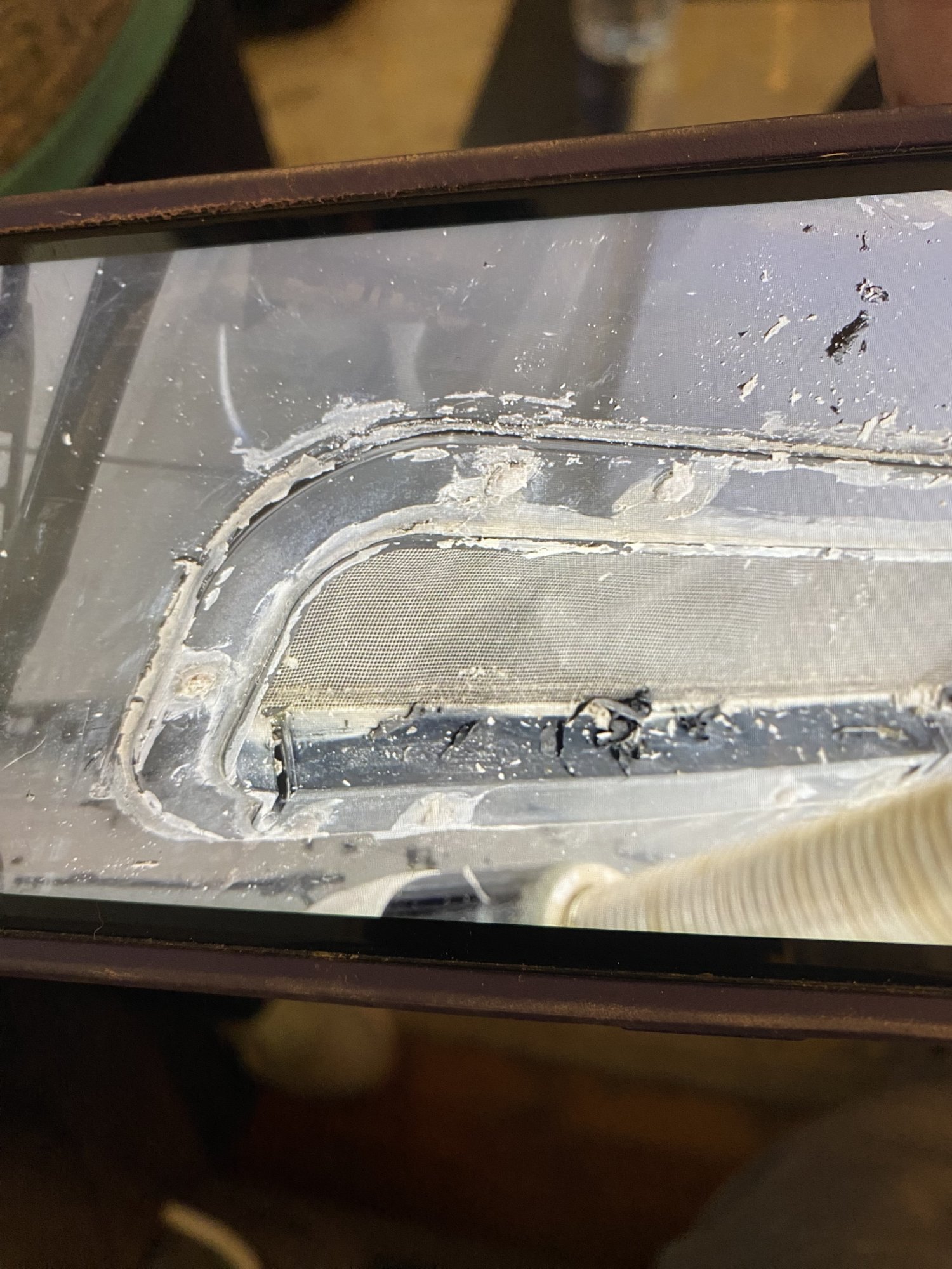

HELP!!! Just bought an older Hunter Passage. The previous owner (a number of years ago) caulked everything (and not well) and anything in sight - and I mean EVERYTHING. Clearly they thought there was a leak - but the clear caulking is cracked, shriveled and a plan old MESS. So, I researched and reviewed a ton of videos on replacing port lights, and thought we could do this easily. NOPE. The Hunter windows extend across gel coat (so it looks like large window on outside - but in the cabin, the window is much smaller). There are also little (what looks like it should be a screw hole - but there is clear silicone over the black caulk) and I'm nervous about digging into this.
The attached pic is just of the port light, but the polycarbonate that extends on either side was sloppily caulked all the way around the edges, so cleaning that up without getting the black caulk is impossible.
HELP!!! HOW does one remove these windows so they can rebed it, recaulk it, etc. I can't find instructions anywhere. All of our windows need to be redone. I'm hoping someone out there has instructions/a video or can show me how to do this! Any information will be greatly appreciated! Safe (dry) sailing :)

I have replaced all of my original portlights on my 1979 H 30C twice over the past 42 years.
And, while mine are slightly different, it appears yours are similar and can be removed safely.
You'll note I didn't say the portlights can be saved...The one in the pic looks shot.
If I am correct, the inner frame/lens assembly is "one component" and the trim ring,
aka 'bezel', is a separate component on the outside.
If I were in your spot, I would use a box cutter and a putty knife to remove the outside bezel.
These are available from Lewmar, Pompanette, etc. and maybe even this site's ship's store
as a replacement item. It will break when you remove it, so be prepared.
Once you get it off, you will see the "spigot" of the portlight nearly flush with the
outside skin of the cabin.
if you decide to remove the port light itself, you will have to dig out as much sealant from around the spigot as possible before using the putty knife on the inside flange along with
a pry bar, chisel, hammer, C-4, etc. to remove it. The plastic gets brittle in UV over the years, it's just the nature of the beast and It will break when you remove it, so ...
But, the good news is, the outside and inside cabin wall can be cleaned up well enough to prep for new portlight install.
Let us know what you decide please and I will give you some tips on prep.
Good luck.
G.
