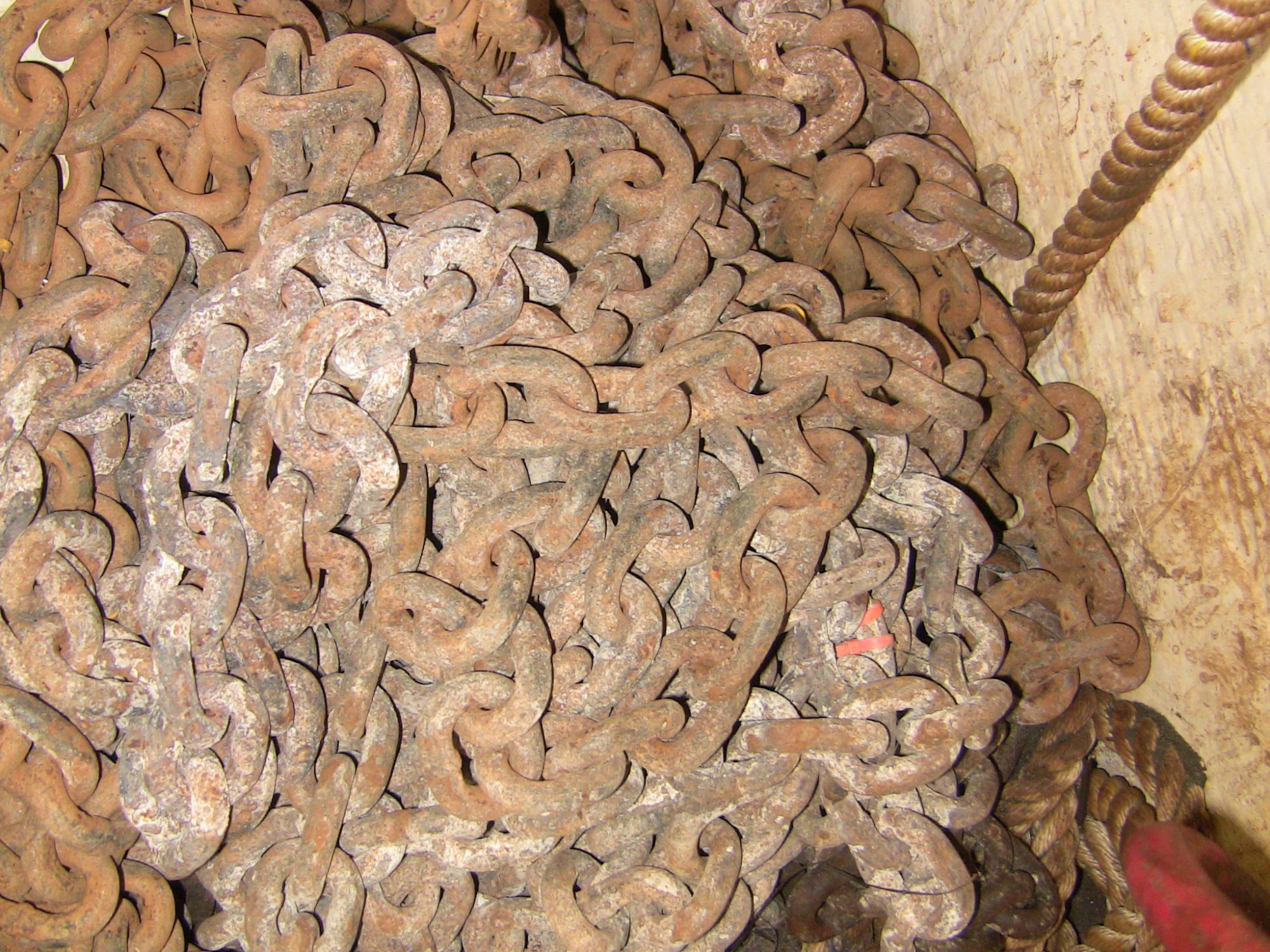

Your Locker.jpg above has a hole that does need big time repair. This is probably the source of your V-Berth stain.
To me, that picture is what I would also call your anchor chain/rode locker.
This is where your hatch, over that Locker, would drain rain water overboard, via the Clam shell outlet.

@Scott T-Bird , yes, to the size of a Locker. My boat has 250 feet of chain plus 200 feet of rode, to allow our boat to anchor in ≈200+ feet of water.
In addition, I have two anchors, second anchor had rode only. This was the Deluxe Anchor package bought by the original owner of our boat.:biggrin:

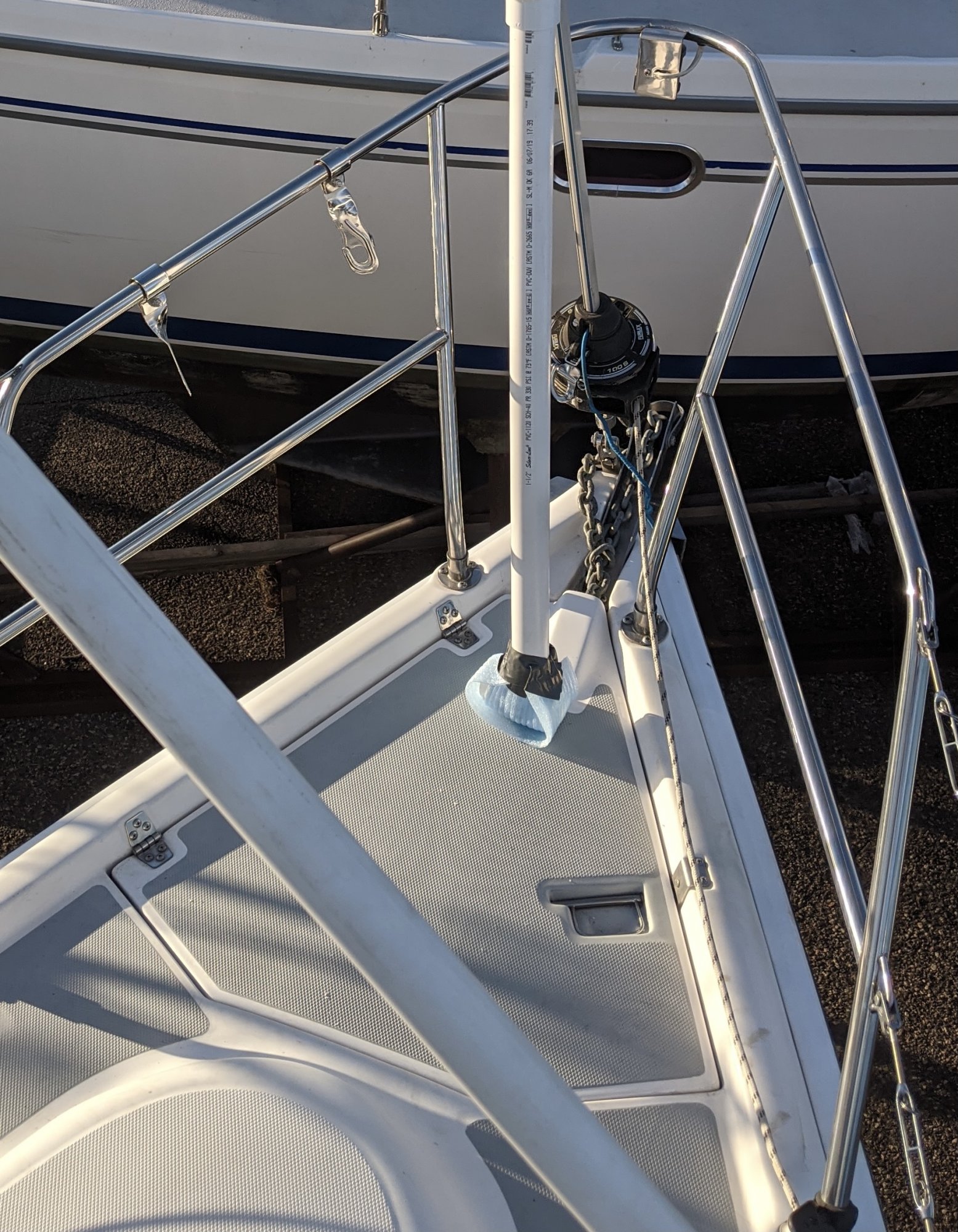

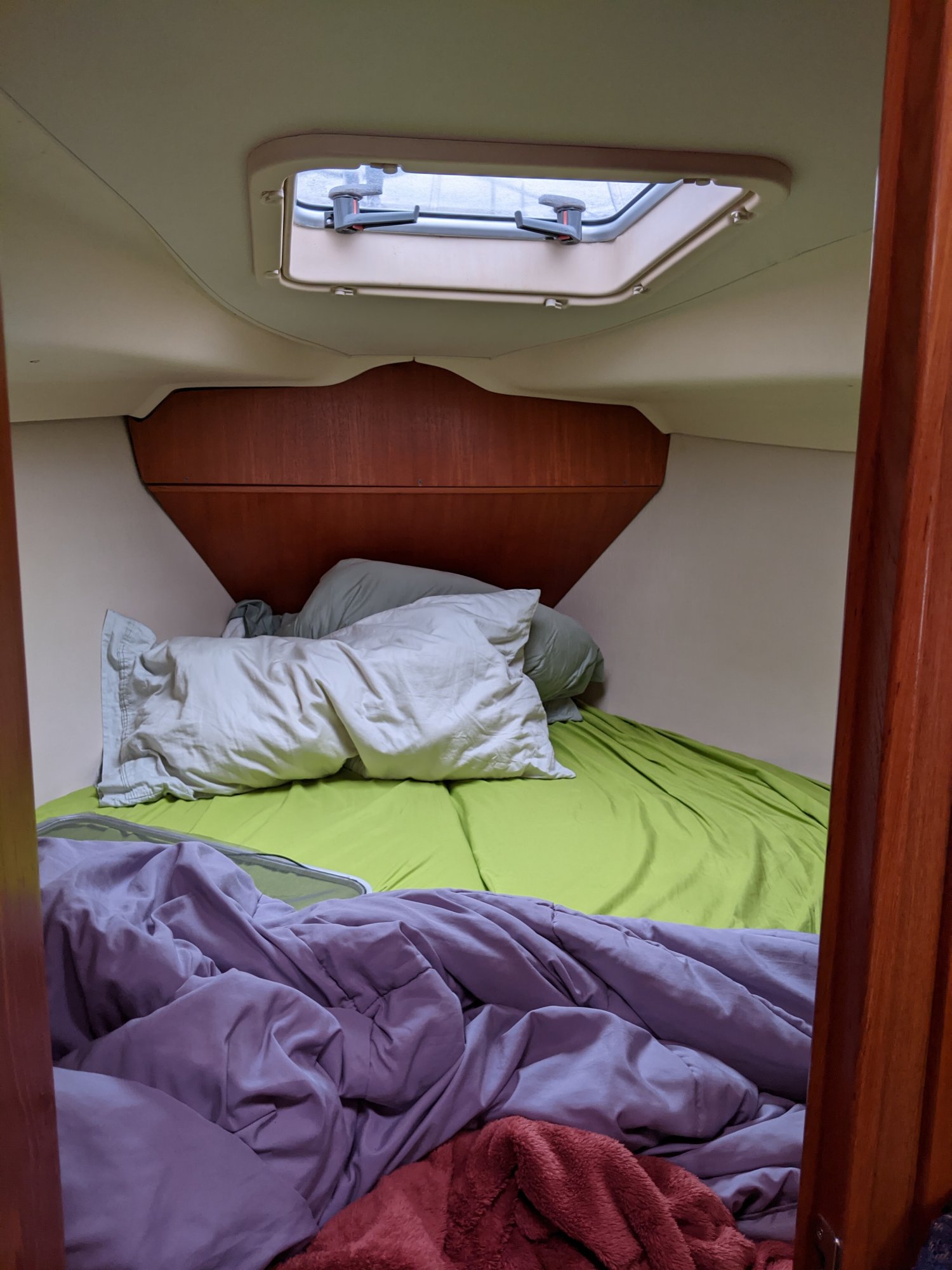

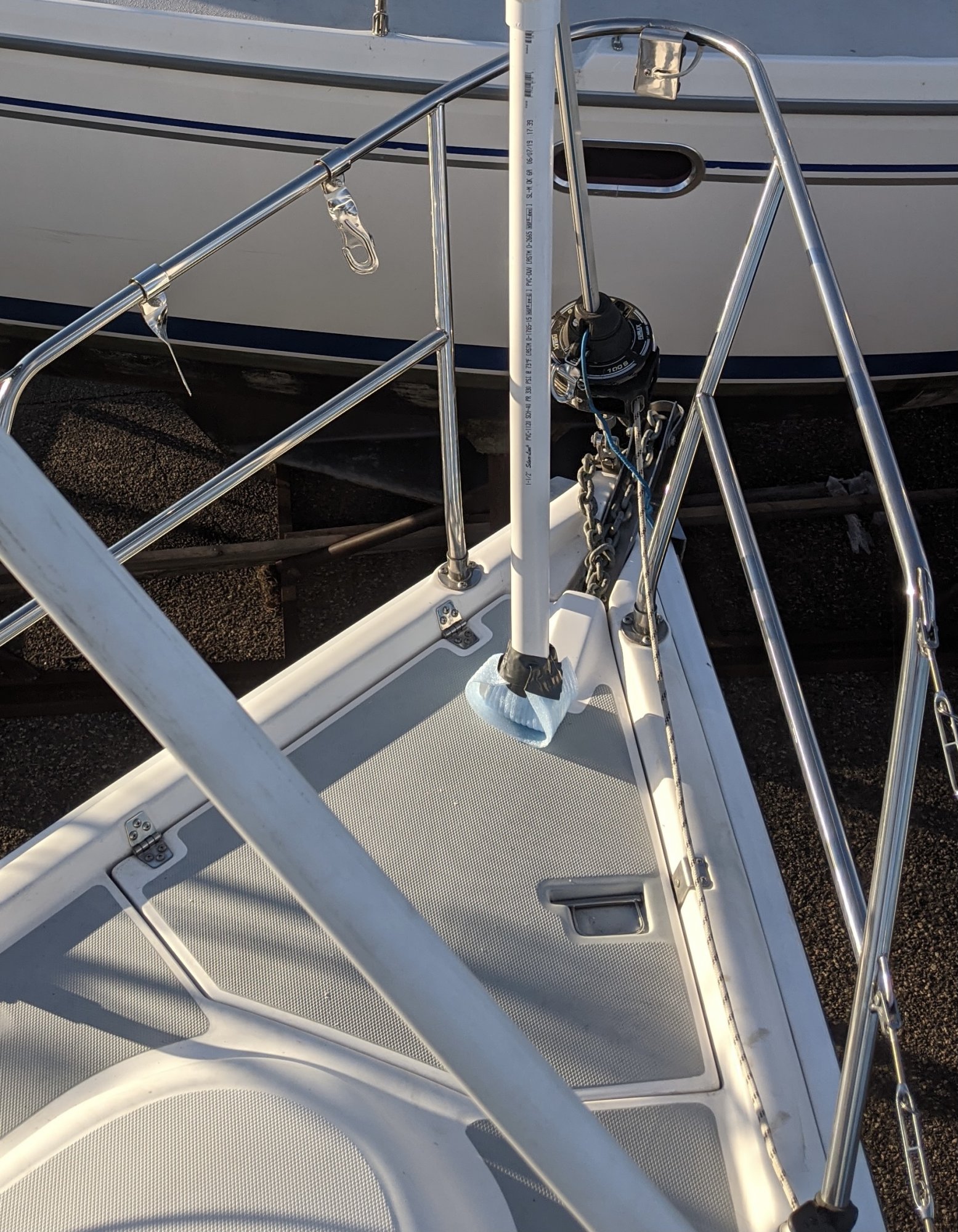

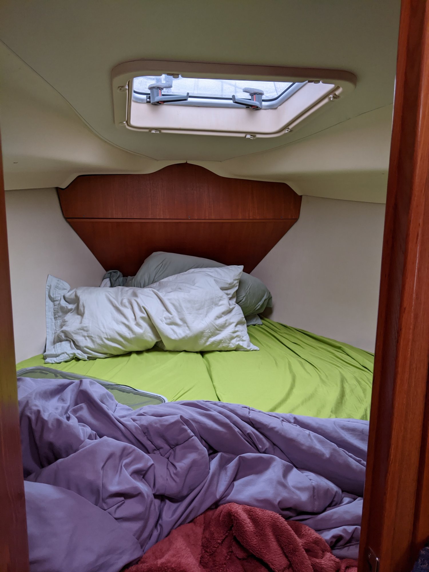

Here's from above the locker taken just prior to putting on the winter cover, and another from in the v-berth. The IMG-2040 photo is just below the pillows. The wood panel is aft of the anchor locker.
Thanks. Looks similar to the setup on my boat. Pretty sure, then, that your anchor locker does not drain into the bilge.
Yes, picture 61880 shows the anchor locker hatch cover, with the port side hinges and lift handle on the Starboard side. [Just like mine]
I suspect that PVC pipe was an attempt to stop the flooding of the locker, with that hole inside.
If that PVC pipe is still there, you have another problem on your hands.
There should be zero holes in that hatch.
Temporary fix is to cut off the pipe low and put a PVC cap on it. Then you can open that hatch easily. Still no issue later.
I assumed that pipe is a support for the winter cover about to go on. It will be interesting to see what the OP says about it. The snorkel concept worked well for WWII submarines, but I don't see the need to prevent the anchor locker from flooding.

Anchor locker snorkel! Might not be a bad idea. But yes, the PVC was my shotgun effort at building something for the cover to hang from two weeks after buying the boat. And I gotta say, the cover is still snug as a bug, so that's something at least. And just to be clear, the photo of the anchor locker with the massive ugly hole was from the previous owner before it was fixed. As it stands now the anchor locker just has the happy little sunlit drain. I kind of assumed all anchor lockers were built that way, but as I'm finding out it seems that some lockers drain into the bilge!
If you look at the pulpit Port Rail you can see a clip on the Railing.
Guess what that clip does?
You clip your Anchor locker hatch OPEN, using the opening lift handle.
Why?
You would find out quickly when the wind slams that hatch on your hand or foot.:yikes:
On my Anchor Locker hatch inside, it has a clips for the Emergency Windlass winch handle and the Anchor Wash down pump nozzle too.:biggrin:
Jim...
PS: Sorry I miss understood the PVC tent pole. Nice job!

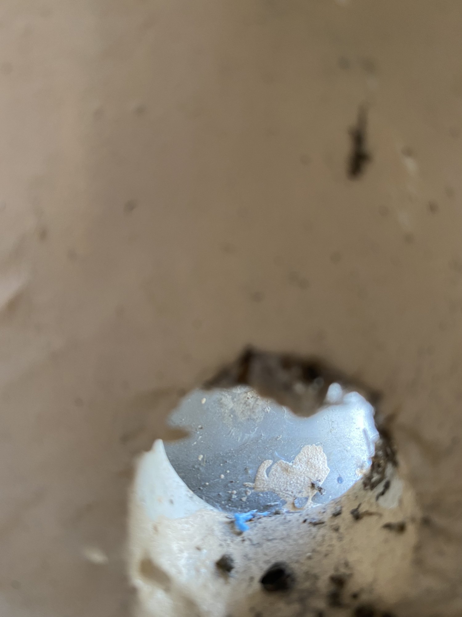

Just a quick follow-up from this past weekend. I took a closer look at the starboard side (bottom) anchor locker drain from the inside of the locker (I’ve attached my best attempt at a photo) and as far as I can see it looks good. I also dumped a gallon of water through but didn’t see anything show up in the bilge or elsewhere inside the boat. So I’ve got to think all the oddities were quick fix attempts by the previous owner.
