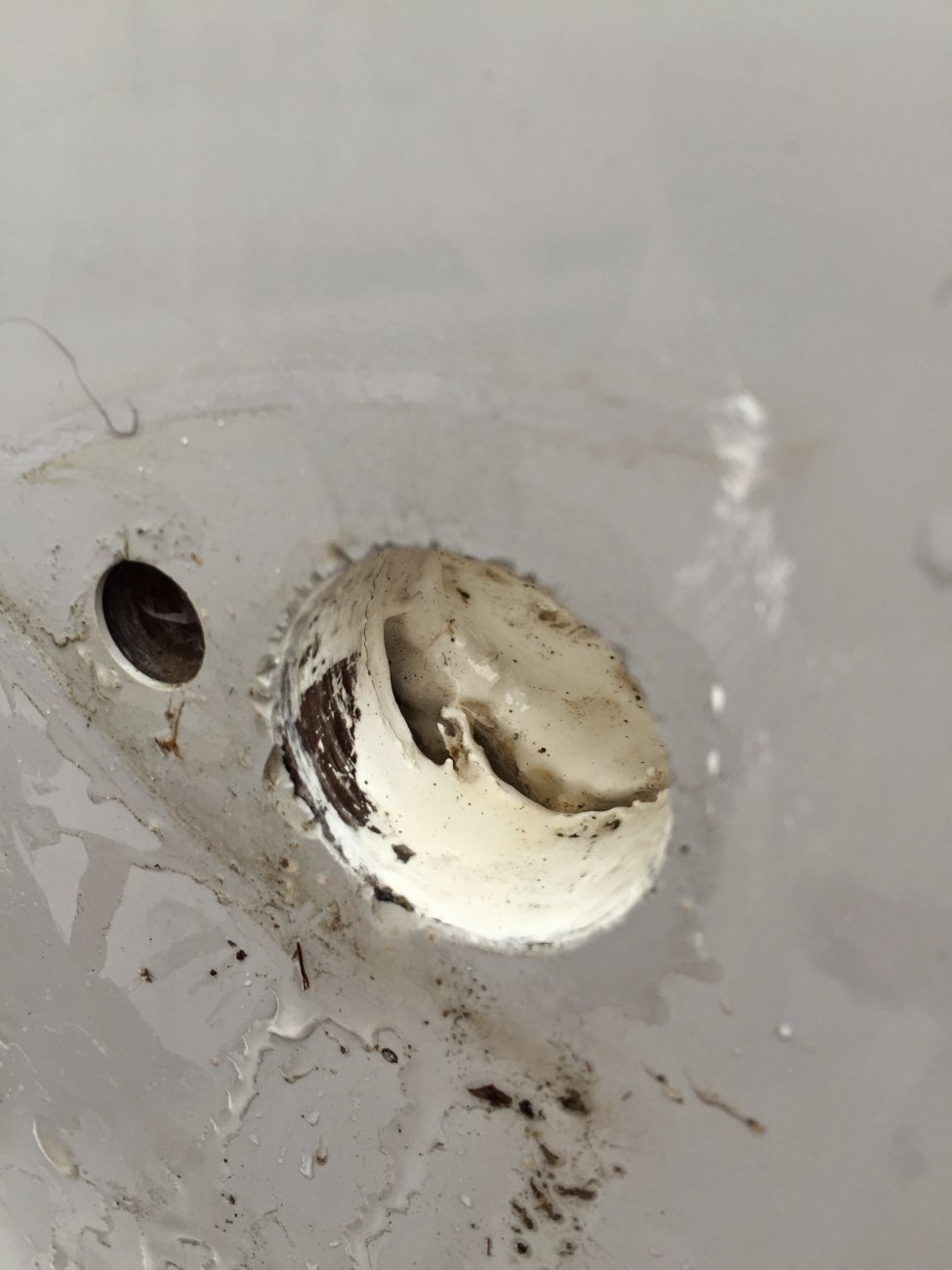

I finally got around to solving how to fix the leak in my anchor locker since the boat is in the yard for a quick paint repair.

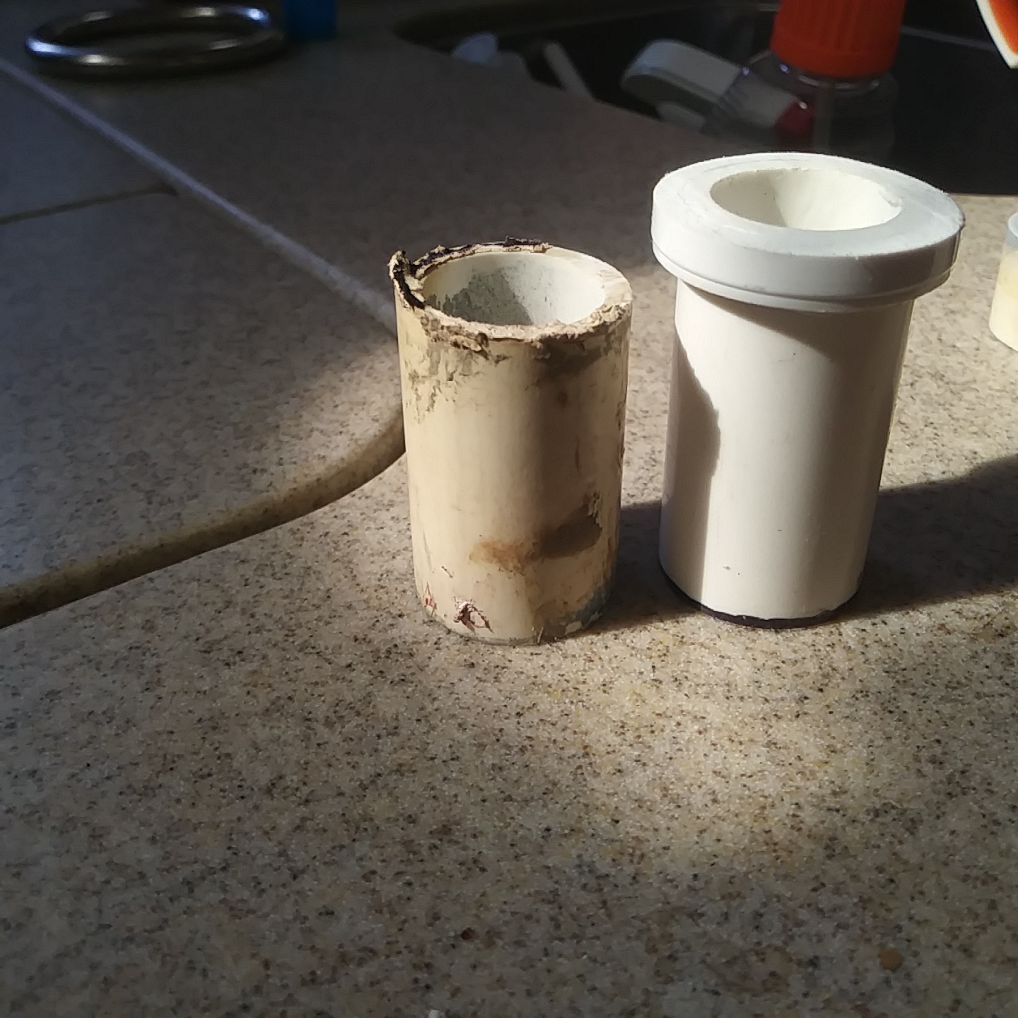

It turns out the drain tube is just a piece of 3/4 inch Shedule 40 PVC pipe cut to span the gap from the inner locker to the hull. It was put in with some sort of sealant but no collar or other way to really assure a seal. I guess over the years the sealant separated and it leaked from both the outside (when the clamshell was submerged) and from the anchor locker when it rained. I removed both tubes for the lower and upper drains and have fashioned a replacement tube with a collar on the inside to provide a sealing surface. I'll post pictures later.

Here are the pictures of my fix.
I was able to remove the old sealant and remove the 3/4 inch original pvc pipe.

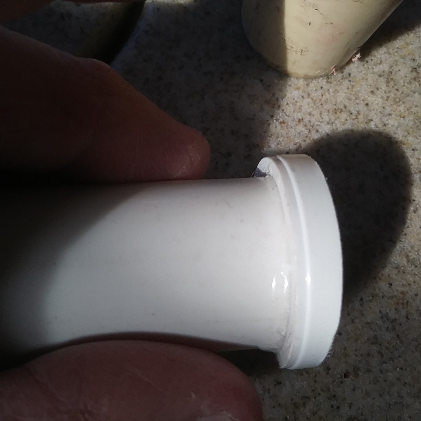

I then fabricated new 3/4 inch pvc with a collar to seal to the inside of the anchor locker with 4200. The collar was made by glueing a 3/4 inch union onto the pipe and then cutting the union down to a narrow rim or collar.

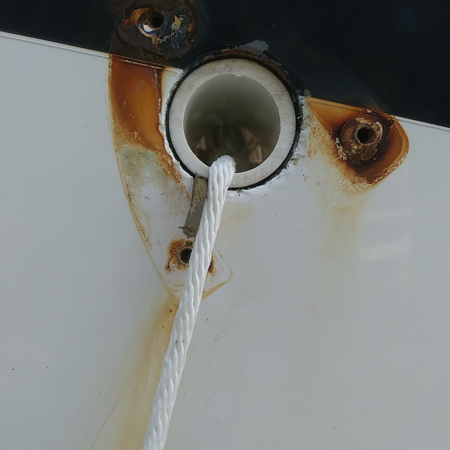

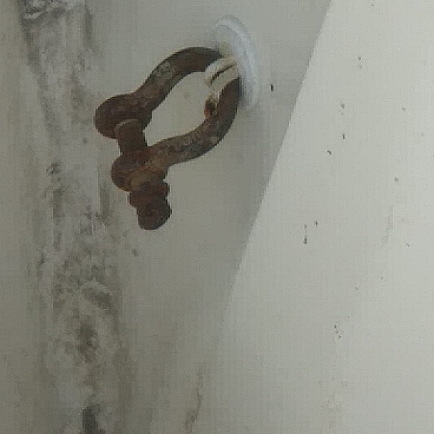

I then applied 4200 around the inside of the collar and inserted it into the hole already in the anchor locker and through the gap and into the hole in the hull. I pulled a string through the hole with a weight on the end to hold the collar with 4200 firmly against the anchor locker to allow it to set up before I sealed the ouside of the hull opening.
This is a shot of the outside (hull opening) with the string/weight in place allowing the inside 4200 around the collar to cure. That way when I apply the 4200 around the pipe I won't force the pipe out of the opening. I thought about a collar on the outside but it would have to be installed after the pipe was inserted. I decided to try sealing around the opening (note the wood scrap spacer to make sure there is room to insert the 4200). If that doesn't work I can remove and start over again. This has to work better than the original.
