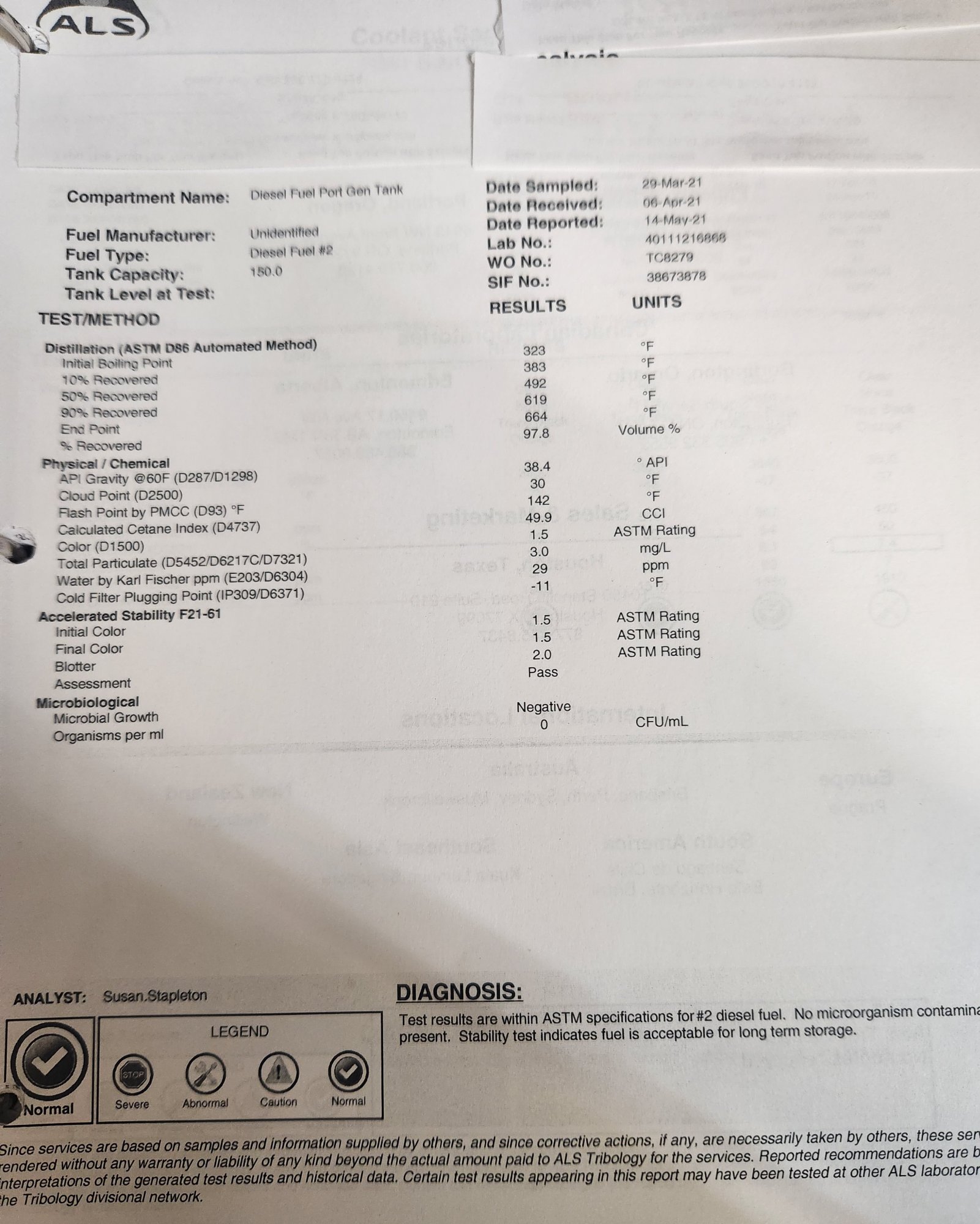

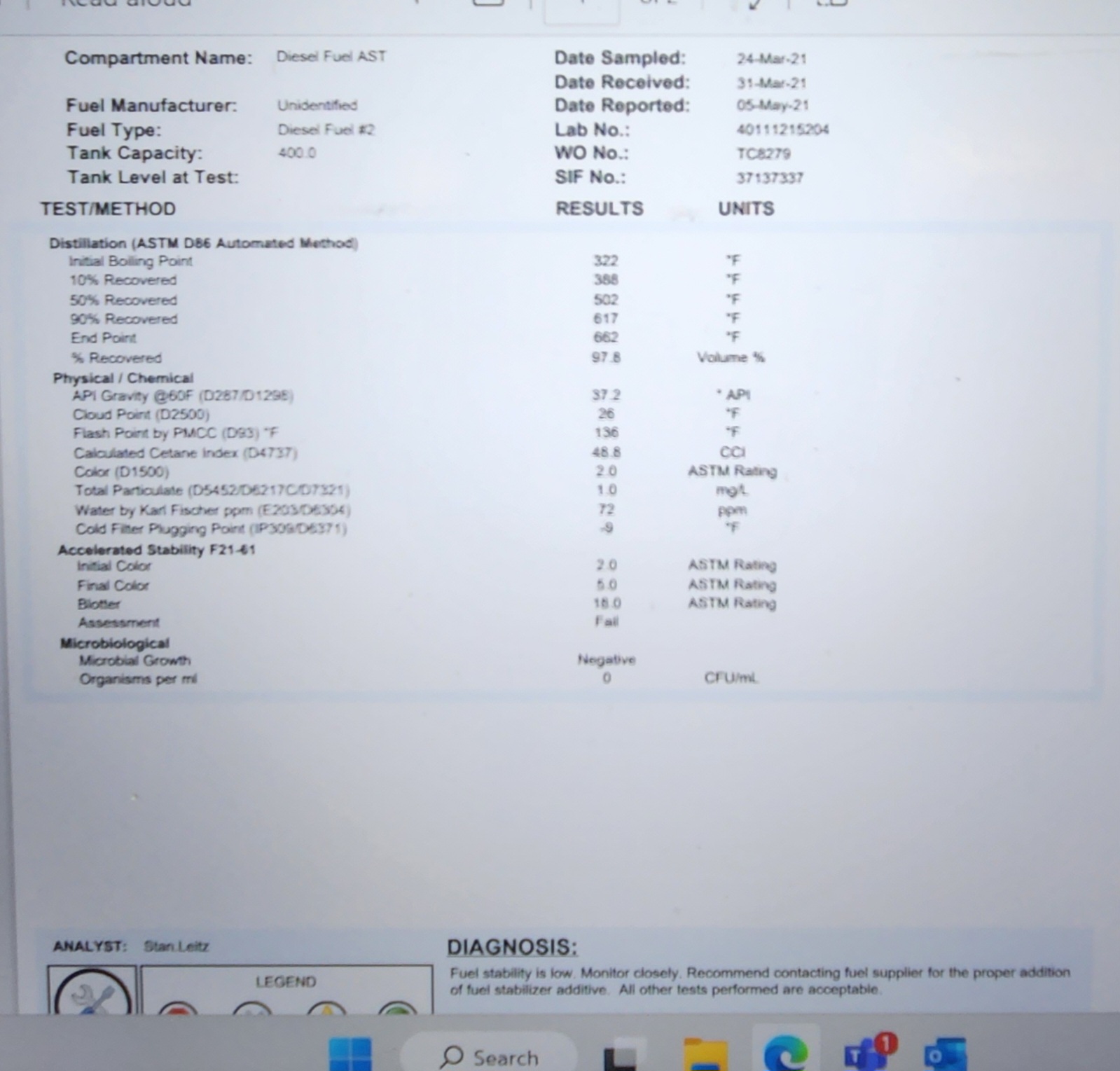

Be sure to use a stabilizer in the fuel too. I like Power Service Clear Diesel. Not all diesel treatments contain a stabilizer, read the label. I treat, and test, thousands of gallons of diesel fuel yearly.
Other than the obvious answer, "it stabilizes the fuel," what exactly does a fuel stabilizer do?
Thanks,
jv
Jul 23, 2009
926
Thanks,
jv
That a really good question. I'll have to do some digging to get a good answer for you.
A few things I can tell you.
1. It's not bioside.
2. My employer and the lab we use to test our fuel make a big deal about it.
Here are some examples of lab reports.
